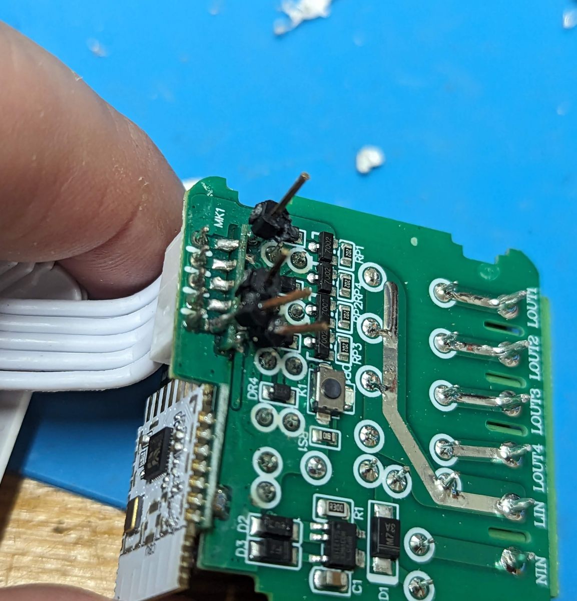

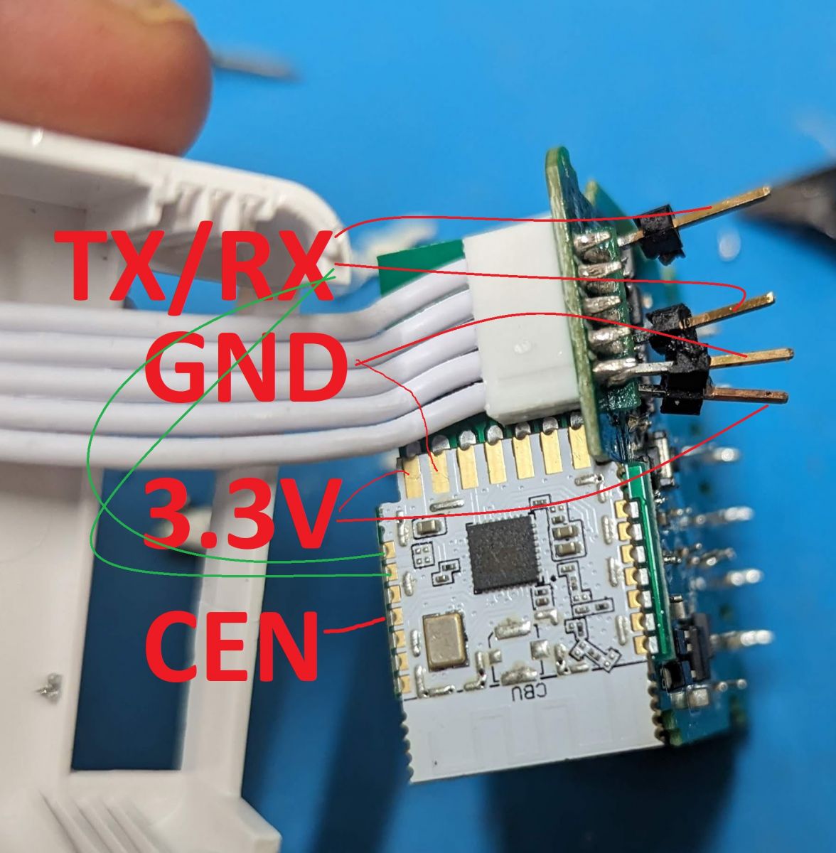

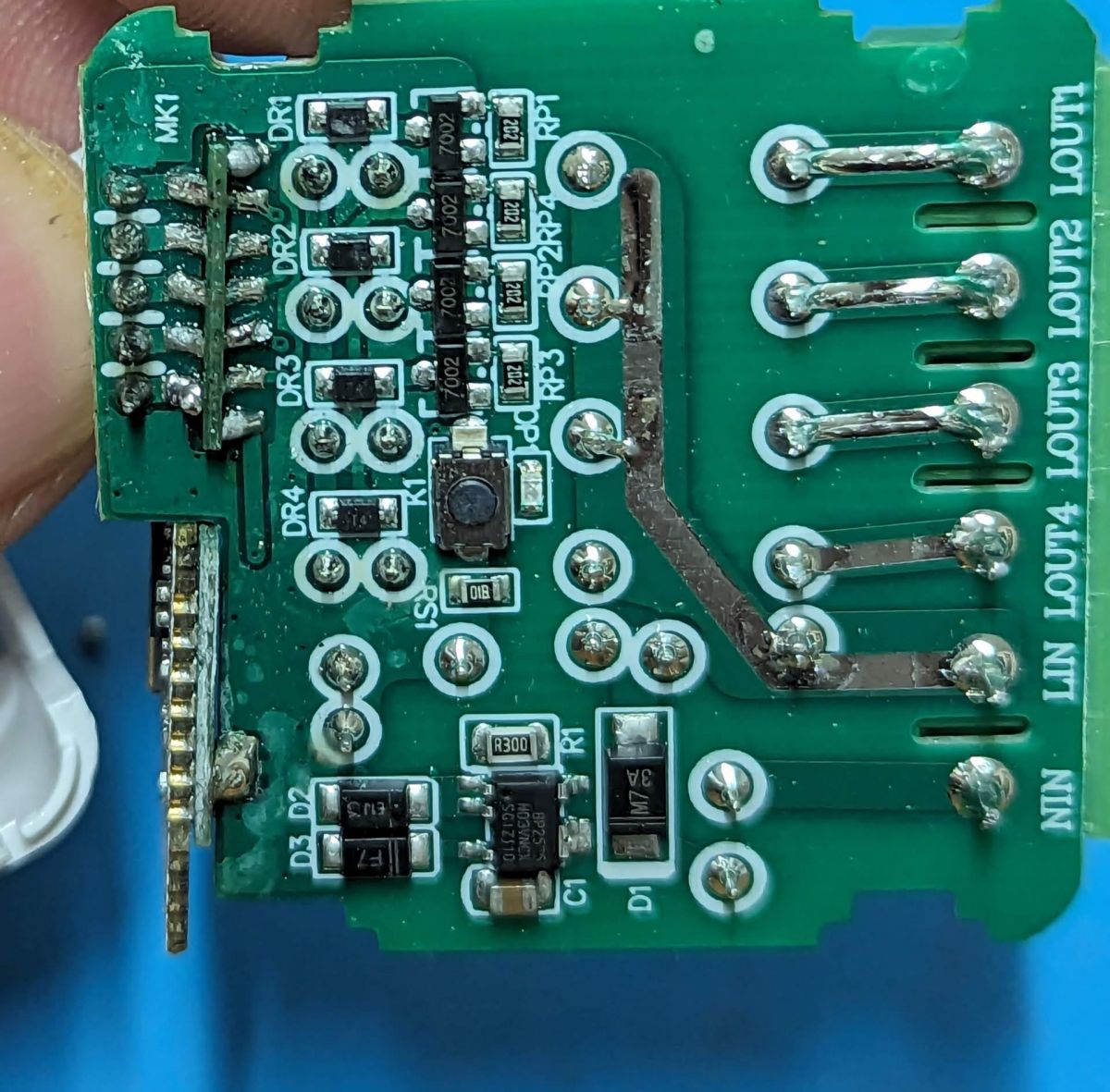

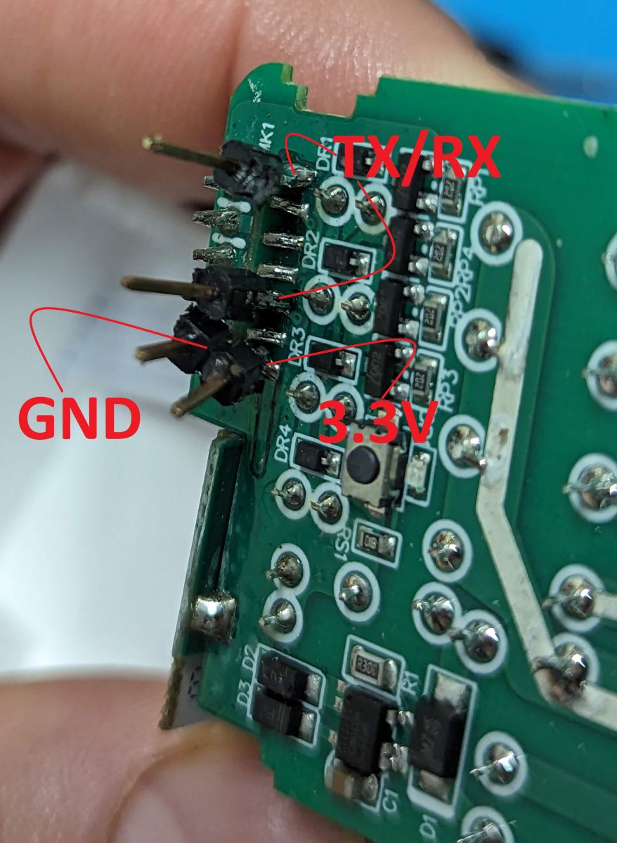

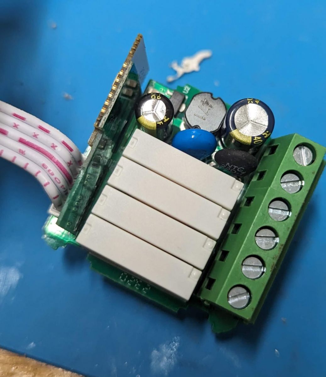

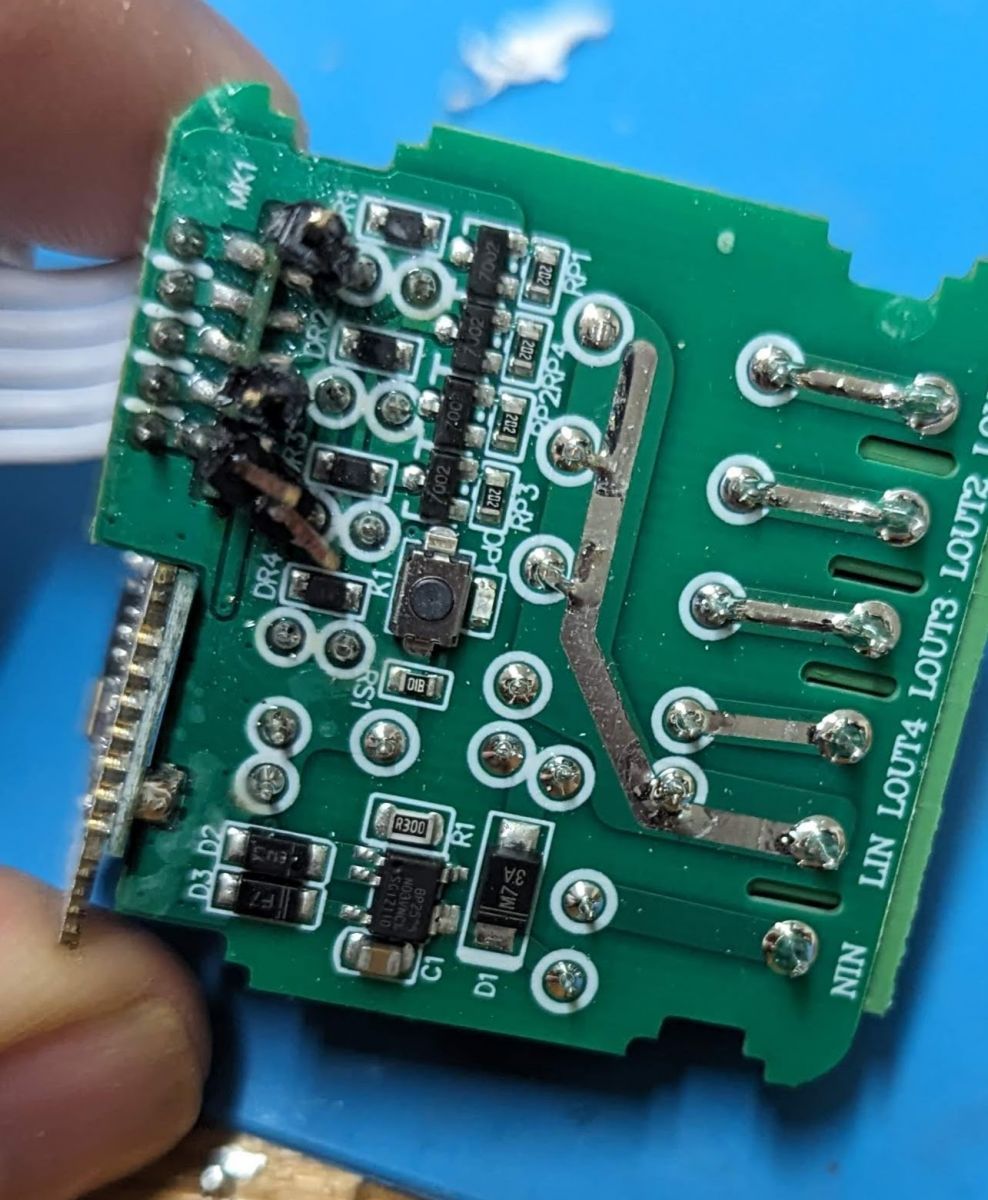

    jnoam
    Detailed Breakdown of 4 Channel BK7231N Switch with High-Resolution Images Detailed Breakdown of 4 Channel BK7231N Switch with High-Resolution Images Detailed Breakdown of 4 Channel BK7231N Switch with High-Resolution Images Close-up of a damaged 4-channel switch BK7231N Close-up of a circuit board of a 4-channel switch BK7231N. Close-up of a 4-channel switch BK7231N circuit board. 4 Channel BK7231N switch

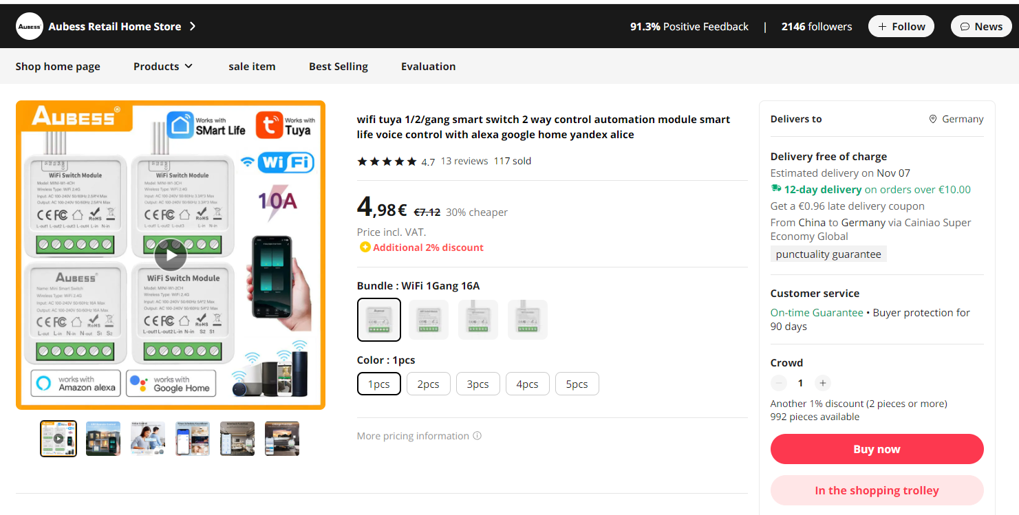

    So here is the link to the product:
    https://s.click.aliexpress.com/e/_EQ2uxgr
    Screenshot of a product page featuring Aubess brand WiFi smart switches.
    I have a backup of the original firmware. But how can I share it?
