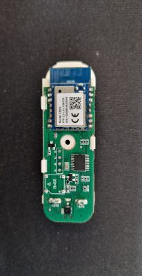

[BK7231T] A simple BLE device project using WB2L. Comments and help welcome.
jitsirakowsk 4107 11
  • A simple BLE device project initializes a WB2L module based on BK7231T.
  • It uses no Tuya libraries and only sends data to the host, so it serves as a minimal BLE bring-up example rather than a useful end device.
  • A long write-up in the doc directory covers BLE basics and related topics, and the archive extraction command should be tar xzvf bk_ble.tar.zip.

  • Planning to reverse engineer Beken BLE profile API
    #3 20654018
    jitsirakowsk
    Posts: 17
    Rate: 10
    We are. I think we have `N' powered devices lying around as well so as soon as we hook it up we should be able to get something similar. In the meanwhile we are planning to use Beken's BLE profile api to get a full `transparent UART' and reverse engineer the lower level calls (setting registers, basically). We try to write about details, we found that it helps beginners ask the right questions.

    Here is a guide for SPI flashing of BK7231. It can be used to reconstruct bootloader if it was overwritten:
    https://www.elektroda.com/rtvforum/topic3931424.html
    I will, however, note here that WB2L may not have easily accessible SPI pins. I remember there was a problem with that. I used SPI method succesfully for WB3S. You need to consult the module datasheet to be sure.
  • WB2L flash access via exposed test pins
    #8 20654654
    jitsirakowsk
    Posts: 17
    Rate: 10
    Yes, we have seen the guide (excellent work by the way) and judging by the datasheet for WB2L pins 20-23, as well as reset are exposed as test pins on the back of the pcb. The datasheet also explicitly says that these pins can be used to read and write flash, so it should be doable. In our case, there is a complication of having to desolder the module itself which is also glued to the mother-pcb it seems. It should be possible but naturally we are putting it off until we are done experimenting with the code (or have to rebuild the bootloader). It is getting more and more tempting though.
