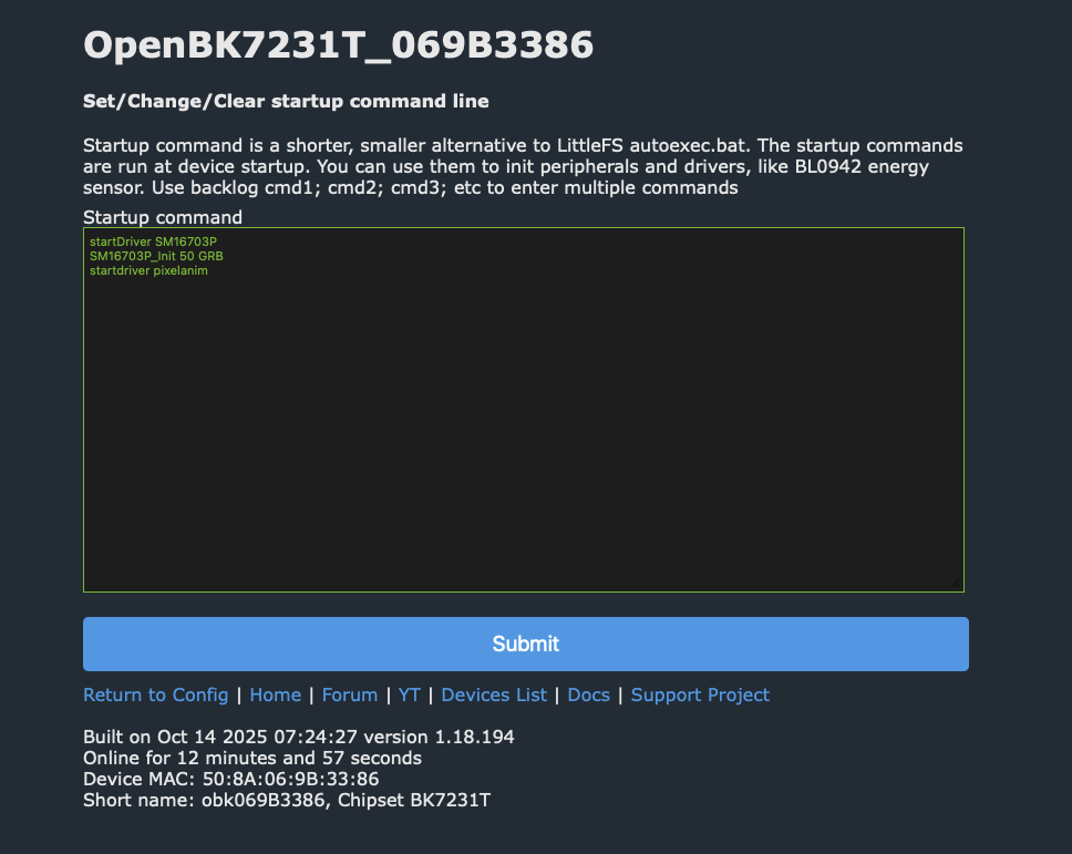

    >>21720688
    It already did 2 months ago, but only in ALT firmware.
    I checked it on BK7231U, which is just an original non-Tuya BK7231T, and it worked fine.
    T OTA image - https://github.com/openshwprojects/OpenBK7231...ownload/1.18.194/OpenBK7231T_ALT_1.18.194.rbl
    And in autoexec or startup command and replace {LEDs} with how many LEDs you have:
    startDriver SM16703P
    SM16703P_Init {LEDs} GRB
    startDriver PixelAnim

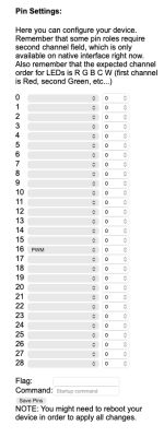

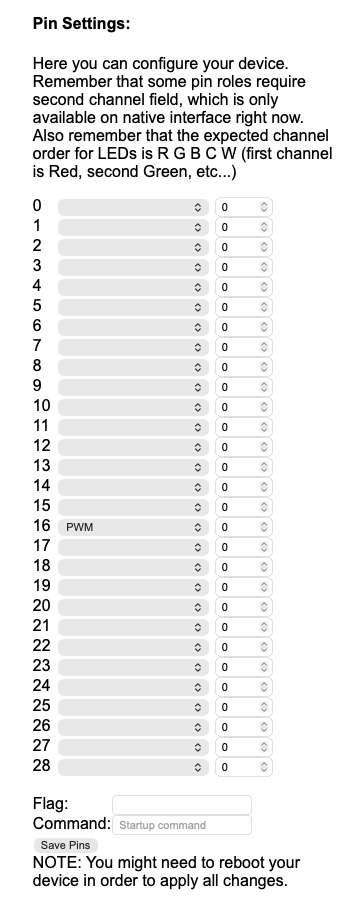

  • #45 21727936
    Nimierkki
    Posts: 10
    @MnM1, could you provide me your GPIO pin settings / flags?
    I still didn't get my fairy light to work / light up, maybe this Christmas :D
    Here is mine:
    Screenshot of GPIO pin settings with PWM assigned to pin 16OpenBK7231T configuration screen with startup commands for SM16703P driver
  • #46 21728138
    MnM1
    Posts: 175
    Rate: 13
    Hi @Nimierkki - I have what you have in autoexec file (but with 33 leds that is what my device has).
    I don't have any other flags/GPIO/Settings done. I resisted moving to ESPHome as I really like the enclosure and power for this device, but come Christmas I will move to it if OBK does not support this device by then.

    >>21728401
    It doesn't matter for beken, since the only SPI output is at P16.
    >>21728138
    As far as i know ESPHome doesn't support addressable leds for BK7231T.
    SPI_DAT is set to SPI_BASE + 3 * 4
    https://github.com/esphome/esphome/blob/6edbb...ponents/beken_spi_led_strip/led_strip.cpp#L28
    Which is a BK7231N and newer address.
    For earlier chips, like BK7231U, BK7231T and BK7252 it should be SPI_BASE + 2 * 4
    https://github.com/openshwprojects/OpenBK7231...bba9f1b1daf0dab3e/src/driver/drv_spidma.h#L33
  • #49 21728421
    Posts: 5068
    Help: 438
    Rate: 894
    sure, but @MnM1's image also showed PWM set, so just to clear that (assuming that would manifest as an issue)
  • #50 21728868
    MnM1
    Posts: 175
    Rate: 13
    >>21728401
    I have downloaded the one you linked and update to it (as I was running an earlier version). So yes I can confirm that.
    Set PIN16 too as suggested - no difference the issue is still there.
    After pressing some of the GUI buttons and rebooting the unit, white lights come (and sometimes RGB lights depending on what buttons I have pressed in the GUI before the reboot). These lights come on after the reboot by themselves and without me pressing anything. GUI shows all buttons off.
