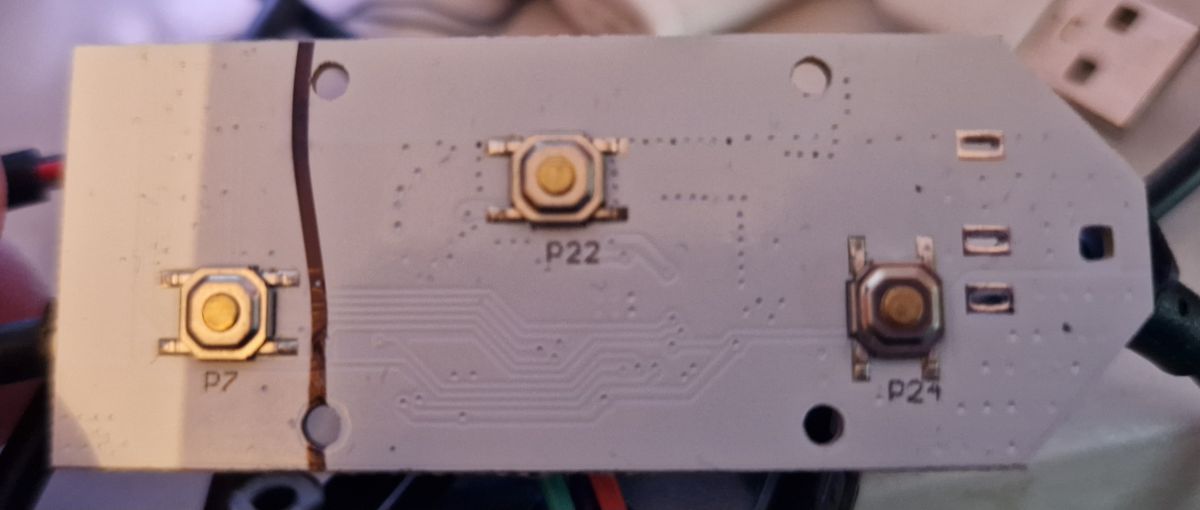

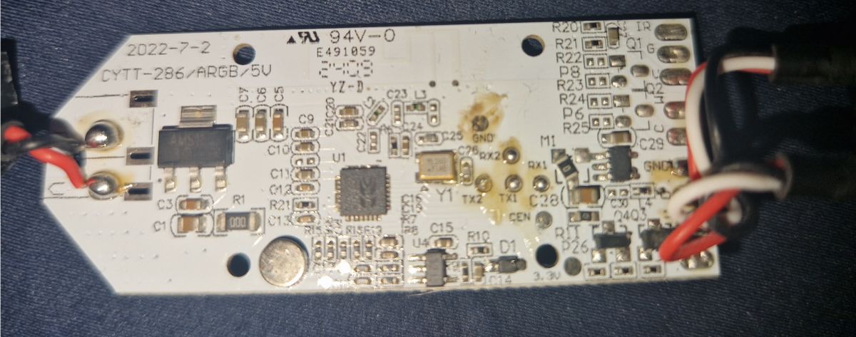

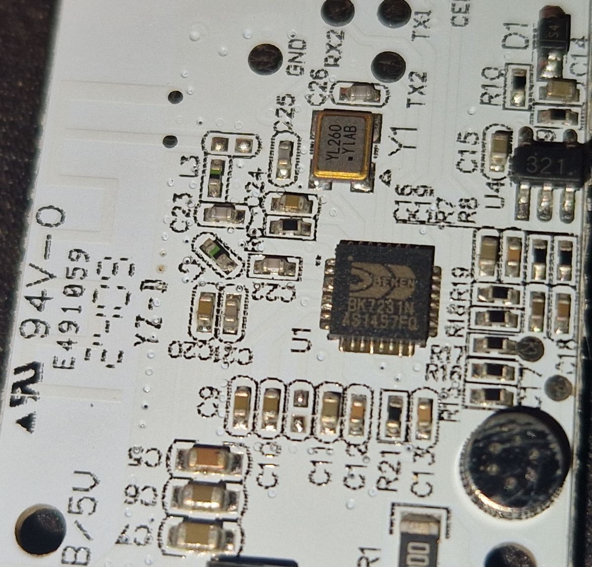

    Device Name: EKVIP Smart Ambient RGB Lamps - ST-LR4311
    Device Type: Desktop Bar Lights
    Device Chip: BK7231N
    Device Purchased: Jula.se - 199SEK
    Manual attached in post
    Manufacture page?: https://yourlite-smart.com/product/st-lr4311-china-factory-manufacturer-of-sync-music-smart-atmosphere-light-with-sizes-option/
    EKVIP ST-LR4311 RGB Smart Ambient Lamps with accessories Printed circuit board with electronic components and wires. Photo of a circuit board with BK7231N chip.

    That looks like SPI (P16) light:
    spi master dma init: mode:0, rate:6600000
    spi_master [CTRL]:0x00c20900
    spi_master [CONFIG]:0x0000000c
    spi dma tx init
    A per-pixel LED system with WS2812 or similiar LEDs.
    Try PixelAnim:
    https://www.elektroda.com/rtvforum/topic4057187.html
    There is no need to guess pins, as only P16 is able to send WS2812 data, as it's the only hardware SPI output capable of providing DMA.

    Posts: 8
    >>21437034 by "k2pin_pin": 24, I guess it refers to the button marked P24?
    Circuit board with three buttons labeled P7, P22, and P24.
    #10 21437198
    Posts: 14771
    Rate: 12914
    They marked your buttons with pin indexes? Wow, that's very nice of them. I haven't seen such a device yet.

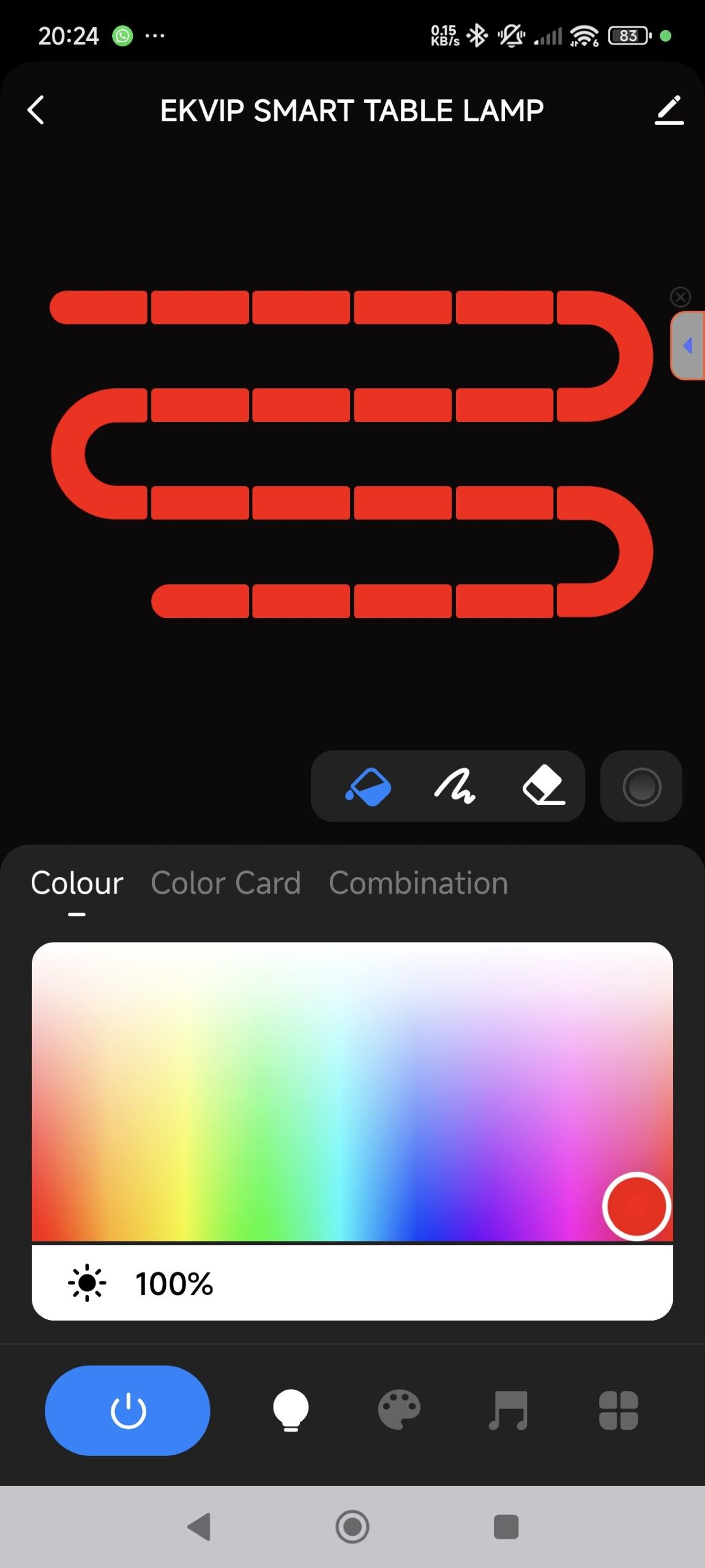

    sorry to intrude but here's a bit more info from that firmware file. I flashed and paired it after resetting. Reset was done with P22 to ground
    paired device storage data
    cloudcutter profile available: https://github.com/tuya-cloudcutter/tuya-clou...-st-lr4311-rgb-desktop-bar-lamps-v1.0.18.json
    Mobile app controlling Ekvip smart lamp with red color selected.
  • #12 21440926
