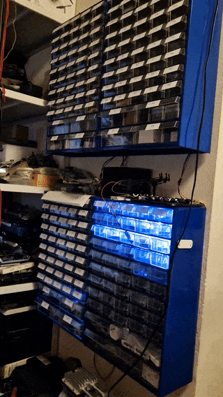

    Now, let's focus on the device configuration.
    You will need to create autoexec.bat, see:
    Here is the required script:
    startDriver SM16703P
    SM16703P_Init 16
    startDriver PixelAnim
    That's really all you need to run your LEDs! No pin setting required. Those LEDs are always on hardware SPI port pin, P16. Well, the only more thing you may want to configure, is the color format. You can use SM16703P_Init command for that:
    Screenshot of a section of instructions for initializing SM16703P LEDs.
    Saving and executing (or rebooting your device) should give you extended HTTP panel:
    Screenshot of LED lighting control interface.
    Here you can either control your device in single color mode or run one of the predefined animations. We will have more animations as the time goes. Keep in mind that settings like led power on/off or brightness are also linked to animations, that means you can control that easily even from Home Assistant.
    Animation setting itself is not yet available for Home Assistant Discovery, but we're working on it.

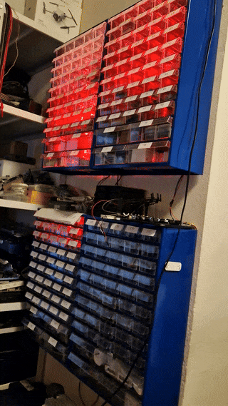

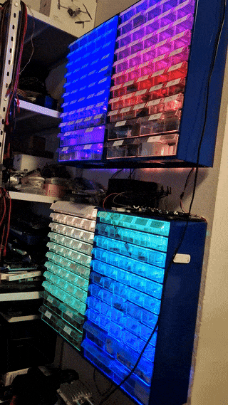

    Ok, here are some sample effects, played on our setup from LED smart drawers organiser topic:
    LED drawers with animated blue lighting
    Animated LED lights mounted on drawers in a workshop.
    LED-lit drawers with light effects.
    As you can see, animations are working correctly.
    It is worth to mention that those LEDs are also working in OBK simulator:
    OpenBeken simulator with connected WS2812 LEDs.
    Ok, that's all for now. Let me know if the animations are working for you! They should work not only for WS2812B, but also for other similiar chips like SM16703P, etc. I will try to add more advanced animations soon, or maybe I will just port a part of WLED? We will see!

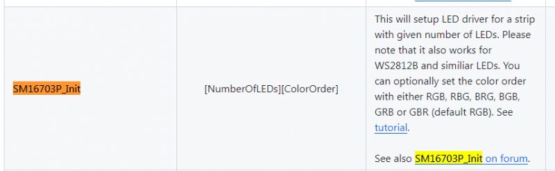

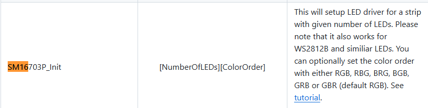

    I hadn't realised that the driver arguments were case sensitive
    Table with SM16703P_Init command and parameters for LED strip driver
    attempting to "Toggle Light" if lowercase causes ESP to panic
  • #22 21637555
    insmod
    Posts: 1432
    Help: 168
    Rate: 455
    >>21637465
    For ESP, that was deliberate.
    It doesn't matter lower case or not, just startdriver sm16703p is enough, without sm16703p_init.

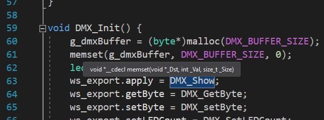

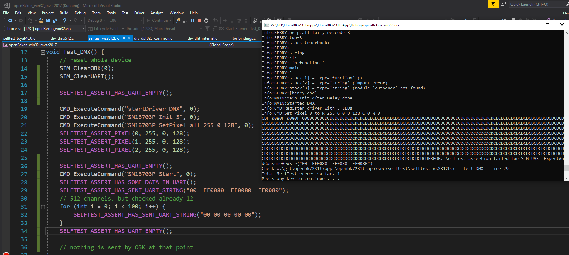

    Self tests are great:
    Visual Studio showing DMX test code with console output indicating UART test failure
    I was on smaller machine with no intelisense and confused memset arguments and they caught it even before flashing:
    Screenshot of code editor showing DMX_Init function using memset in C
    @divadiow how many OBK light bulbs do you have? I have an idea for DDP sender test...
    Ok, soon i will probably rename core per pixel functions to LED_Start, LED_SetPixel, but keep older names as aliases...
