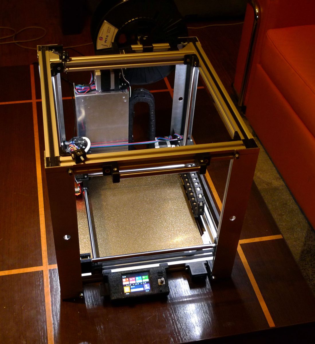

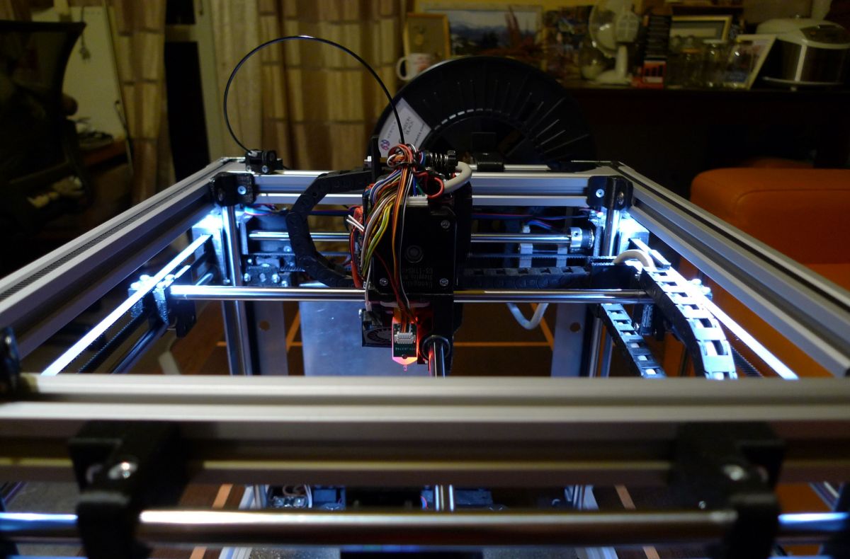

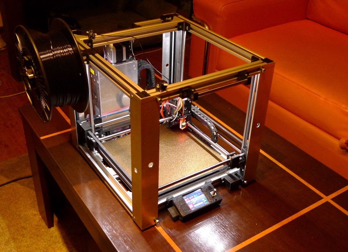

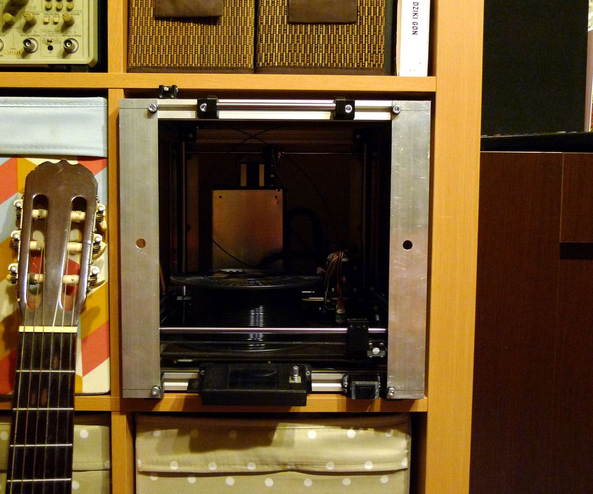

    Hi,
    I would like to present you my latest work: DIY 3D printer, in what I think is a bit of a peculiar kinematics. I was inspired by the design of the Voron 0 printer, which I find elegant and simply pretty. I like the good use of the working volume and the practically lack of empty spaces in its volume. Core-XY kinematics, in turn, did not appeal to me so much, but somehow I was so charmed by the Ultimaker kinematics, so I decided to do it my way and marry these two ideas: perform the kinematics as in Ultimaker, while ensuring good use of volume, as in Voron 0 :) The project is constantly refined, some elements need finishing - sometimes I had to cut something after printing, melt it with a soldering iron, or make some unforeseen hole. But at the moment the printer is working and I am printing the next parts for my own needs with it.
    Assumptions
    - Kinematics as in the Ultimaker: the extruder is located at the intersection of the X and Y axes. From the mechanical point of view, the X and Y axes are treated equally.
    - The extruder and the entire XY mechanism also moves in the Z axis. The stage is permanently attached to the base.
    - Possibly high printing speed.
    - Maximum use of the printer's outline, i.e. the best ratio of the working area to the volume of the printer.
    - Guidance in the Z axis is carried out by a single motor based on belts.
    - The printer is to fit into the space of the Kallax (IKEA) bookcase.
    - Working space about 20x20x20 cm.
    - The table is magnetic from Prusy MK3
    - Direct extruder with gear, silent stepsticks, table auto-levelling.
    - Possibility of building.
    - Easily accessible elements and the minimum required precision of workmanship.
    - Elements printed from PET-G.
    Design

    Frame
    I made the frame based on V-SLOT 20x20 profiles (probably T-SLOT will also work, because the possibility of rolling rolls on the profile is not used here).
    Precision is required for:
    a) cutting the length of the V-SLOT profiles along the X axis (if the precision is not maintained, the rectangular frame will become a trapezoid),
    b) perpendicularity of cutting V-SLOT profiles along the X axis (if the precision is not maintained, the rectangular frame will become a rhombus),
    c) the position of the holes in the V-SLOT profiles along the Y axis (again, lack of precision means a trapezoid).
    d) the same length of hardened rollers for the Z axis (the lack of equal length means unstable support for the printer, it may wobble when placed on a flat surface and there will be difficulty in initial positioning in the Z axis).
    Point c), i.e. the precision of the holes, may not be required due to (ultimately) the use of angle bars connecting the profiles in the X axis with the profiles in the Y axis, which can be moved along the V-SLOT profiles in the Y axis and thanks to this, you can precisely adjust your distances. That is, perpendicularity is ensured by angles, and not by fastening the profiles "to the face". If angle brackets are used, it is then not necessary to make holes in the Y profiles to fix the X profiles. It's always less of a problem because there's less fixated reference. However, this optimization is still to be determined - I currently have both holes and angles.
    In the Z axis, the connection between the frame elements is made using hardened bars with a diameter of 10 mm. The rods are attached to the corners of the V-SLOTs and pressed against them with elements made on a 3D printer. Originally, it seemed to me that such folding of the frame would be enough to maintain its stiffness, but the stiffness gains a lot after using additional profiles, angle bars 40x40x2 mm, in the corners of the printer. Angles in the corners make it difficult to access the adjustment elements for tensioning the belts, so that there was no need to dismantle them to adjust the belts, I drilled inspection holes in them.

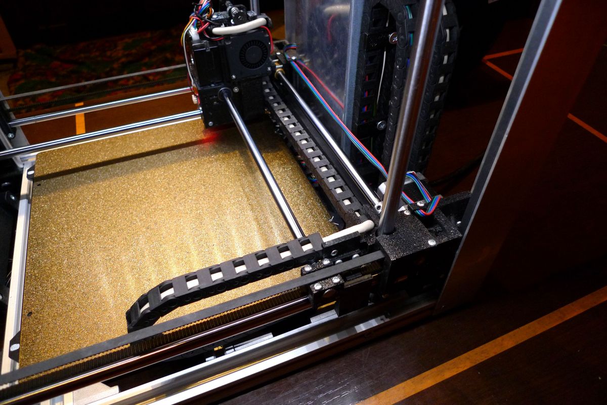

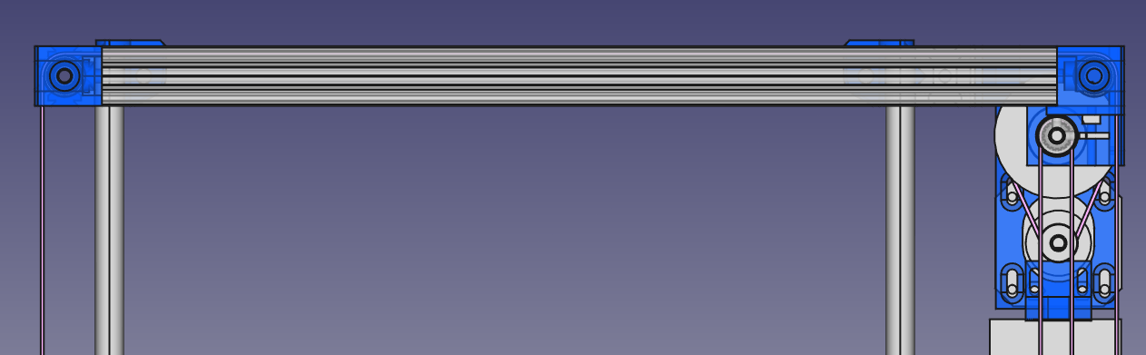

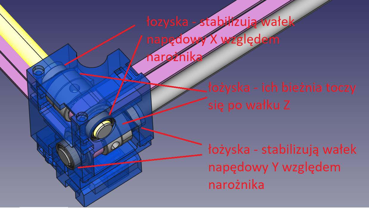

    XY frame
    As in the Ultimaker, the drive shaft of the X and Y axes is also a rail on which the rods move, at the intersection of which the extruder is located. In the case of my printer, additional bearings are threaded on the drive shafts, the raceway (outer part of which) rolls on the rollers in the Z axis. This is one of my ideas :) The whole thing does not fall apart, because the drive shafts fit into the appropriate bearings with a press fit, as well as (or rather primarily) because the drive belts forX and Y axes, when properly tensioned, pull the entire XY mechanism structure together and hold everything together. The rollers have a diameter of 8 mm.
    XY frame - connectors in the corners
    FIMO DIY 3D printer, Ultimaker kinematics, Z axis mobile extruder
    Similar corners are in each of the 4 corners.

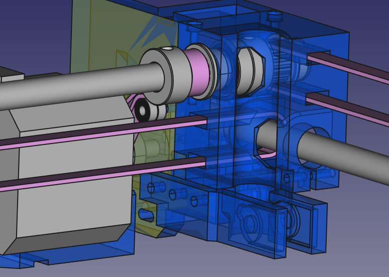

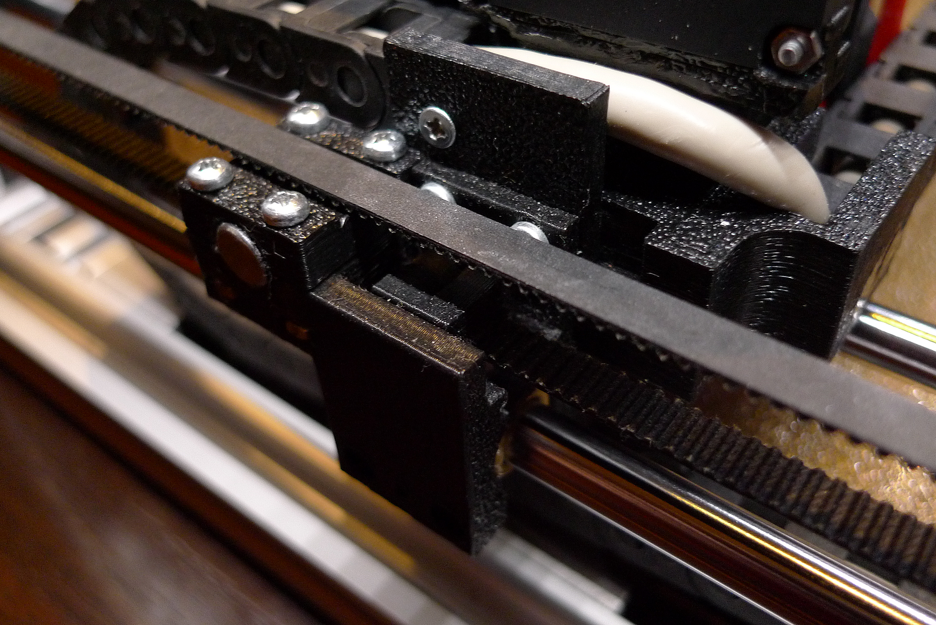

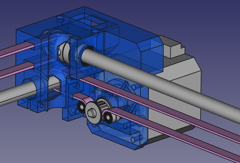

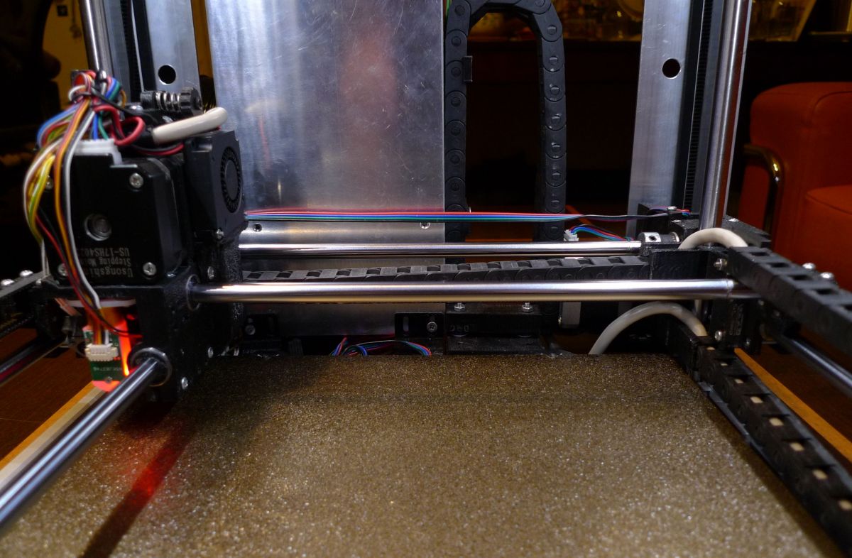

    X drive
    The X drive is carried out by means of a Nema17 motor, and the drive roller of the motor is properly wrapped by the belt with 3x7x3 mm bearings. This seems to be done correctly and the motor does not tend to skip on the belt or pick up slack. The problem I encountered in the first version of this printer is the unstable position of the motor relative to the X-axis drive shaft. Namely, as the entire X and Y mechanism moves in the Z-axis, there is no possibility of any additional fastening to the frame. The motor, when its shaft rotates, tries to move (turn) in the opposite direction according to the principle of action and reaction. Hence, the corner and the motor mount are printed with a solid allowance of material (to maintain its rigidity), while the stable position of the motor in relation to the X and Y drive shafts is ensured by appropriately (possibly) spaced bearings securing the shafts to the corner. This was one of the problems that nearly brought down the project in version one :) Belts are tensioned by a simple mechanism.
    Y drive
    A similar problem with positional stability also affected the Y-axis drive motor. It now works flawlessly. The drive was transferred here using a belt loop and an additional roller.

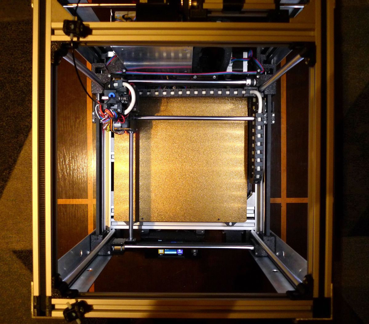

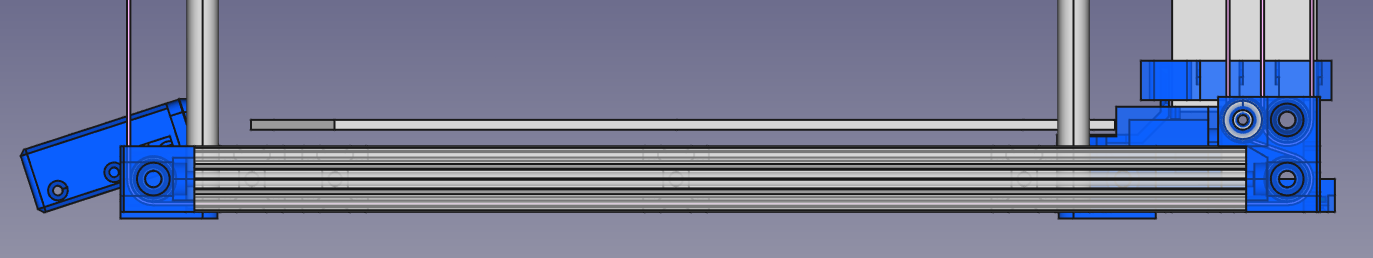

    Z drive
    I consider the drive in the Z axis to be one of the most interesting solutions from this printer :)
    FIMO DIY 3D printer, Ultimaker kinematics, Z axis mobile extruder FIMO DIY 3D printer, Ultimaker kinematics, Z axis mobile extruder FIMO DIY 3D printer, Ultimaker kinematics, Z axis mobile extruder
    Each corner of the XY mechanism must be supported separately, but of course, when moving in the Z axis, they must move concurrently. At the same time, it is necessary to ensure the possibility of tensioning the belts as well as the possibility of pre-adjusting the "zero" position separately for all corners. I realized the drive in the Z axis using two GT2 belt loops. The strips fit the free space in the V-SLOT profiles, so I managed to integrate them into the frame and they do not take up additional space in the printer.
    The way to adjust the Z axis is as follows:
    1) Pre-position the frame, preferably after placing the printer on its side,
    2) Tension the right and left belts (belt tensioning mechanisms are located in the front corners).
    3) Then set the front corners relative to each other, take the table or the lower part of the frame as reference. Adjustments are made on the drive rollers of the Z axis.
    4) Finally, adjust the position of the rear corners relative to the front ones.
    It was quite easy for me to achieve an accuracy of 0.1 mm in the mutual position of the corners. I think that such precise corner setting is not necessary, because the final correction is provided by the BL-touch sensor and table positioning anyway.
    Large belt loops have teeth on the outside, so in the corners I decided to use ordinary 5x14x5 mm bearings instead of dedicated (and too wide for me) drive rollers. The bearing is a little narrower than the width of the belt, but on the other hand, the movement in the Z axis is less intensive than in the X and Y axes. I think this will work in the long run.
    Extruder
    I used a BMG clone as an extruder. As it has a gear, a smaller and lighter pancake motor can be used for the drive, which positively affects the speed of printing. Such an extruder works in my second printer and has not caused any problems for several years. The hotend is full-metal, so you can expect problems when printing with PLA. However, in my case, when assembling the hotend with attention, using paste and ensuring good cooling, I have no problem with it. The extruder moves on guide rollers using extended linear bearings LM8LUU.

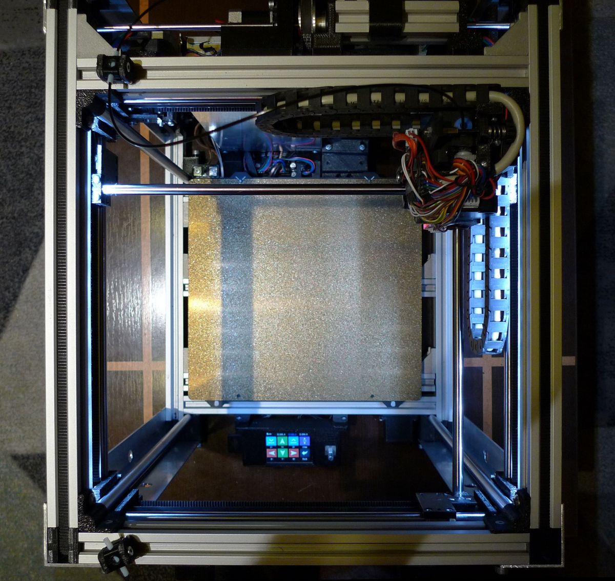

    Electronics

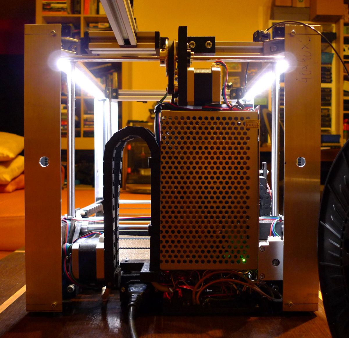

    As the printer driver, I used the Bigtreetech SKR mini E3 board, which is placed in the space under the power supply. I compiled the soft for it using Visual Studio Code with the addition of PlatformIO. In turn, the role of the "control computer" is played by Bigtreetech TFT24. I have no complaints about this setup: it runs quietly, provides sensorless X/Y end-stops, and doesn't hang up.
    Power supply and electricity management
    I power the printer with 24 V from a 200 W power supply. Its capacity is too small for reliable operation, so I will have to replace it with a 300 W power supply of similar dimensions.
    In order to transmit all signals to and from the extruder, I used a flexible cable with 16 wires with a cross-section of 0.14 mm^2. The flexibility of the cable is very important - in my case "Lap Kabel Stuttgart" worked well. The cross-section of the cable is sufficient to power the hotend with a supply voltage of 24 V. As you can see in the pictures, the cable is run in chains. I devoted a lot of attention to the proper guiding of the chains so that they do not take up too much of the working area of the printer and do not interfere with other elements of the printer.
    I used 12V LED strips to illuminate the chamber - I connected two such strips in series. The size of these strips makes it easy to slide them into the space inside the V-SLOT profiles, although it is better to use strips that are not waterproof (they are not flooded with polyurethane) because they are easier to push into the profile.

    The project cost me a lot of nerves, and there were ups and downs along the way. The cost of all the elements exceeded PLN 2,000, and, as it happens in prototypes, many of them remained unused. The speed and quality of printing seem to be fine, later I will update the description with photos of prints with parameters. From the financial point of view, it is certainly better to buy a refined printer, e.g. Prusa MK3, assemble it calmly and consume a few jelly beans. But at the same time I can say that while constructing this contraption I learned something and gained faith in my abilities :)
    Feel free to criticize and ask questions. I will also be grateful for suggestions and advice. I provide all design files and invite you to duplicate the design if you feel like it. I realize that the description is incomplete, I will update it on a regular basis.

    The kinematics is called CrossXY ;) As for the chains, you'll be thinking about the umbilical cord in a moment, looking for a broken vein ;) Linear bearings don't like rotation very much.
  • Brass bushings used on drive shafts only
    #8 20664018
    Fimek
    Posts: 230
    Rate: 355
    Hi,
    @maras52 I know they don't like it, that's why I have bearings only at the extruder, and the rollers don't rotate there. In turn, where they rotate (i.e. on the drive shafts) I used brass bushings. Regarding the naming - something I felt like this must have a name :)

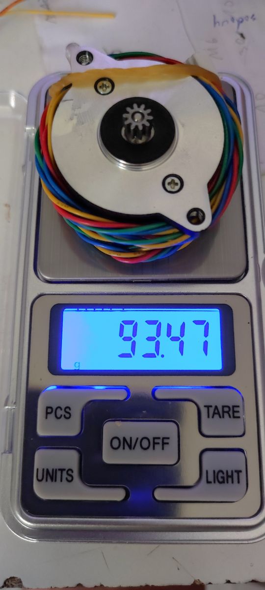

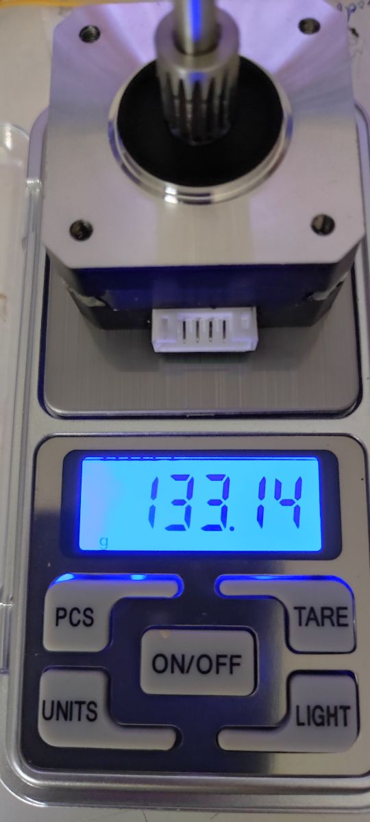

  • Recommend a lighter hextrudort with 36STH20 motor
    #9 20664074
    maras52
    Posts: 273
    Rate: 53
    By the way, you write that you used BMG, which in combination with NEMA17 is a terrible block by weight, look for a hextrudort with a 36STH20 engine (necessarily 20, 17 are weak) the author provides all kinds of "hulls" for various hotbeds from V6 to Dragons ;)
    You have a weight comparison of a pancake and a 36:

    Well, the difference is significant, certainly worth considering. Is this motor still stepper or BLDC? If it's a stepper, it's like an evolution, but if you put a high-speed BLDC with a specific gear there, you could really make the extruder significantly lighter, but it would require modification of the electronics (of course, it would be a bit of a hassle). Hmm...... :)
  • #11 20664090
    maras52
    Posts: 273
    Rate: 53
    Stepper ofkors ;) I will add that the factory engine weighed 177g ;)

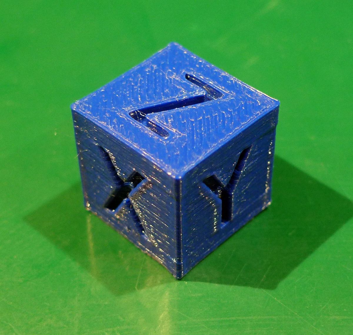

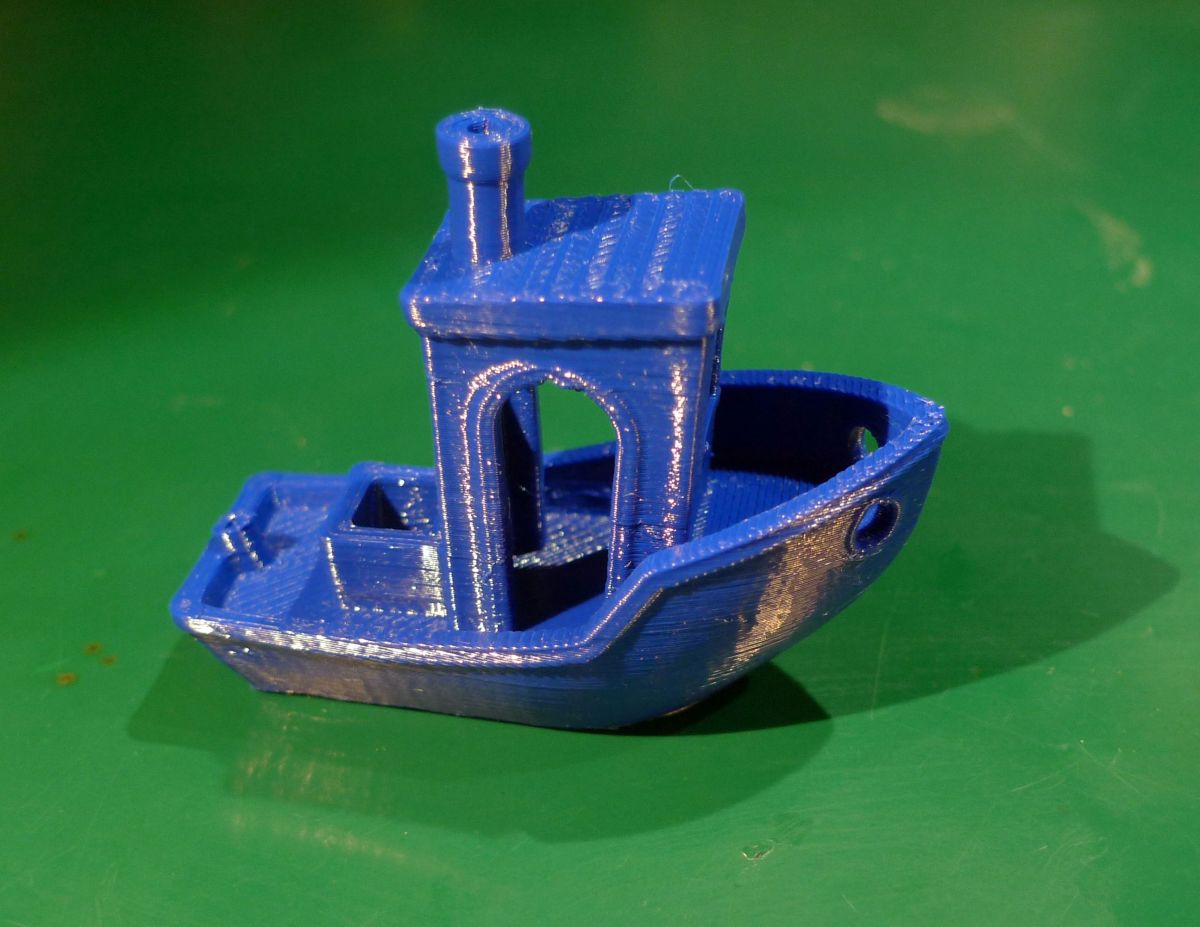

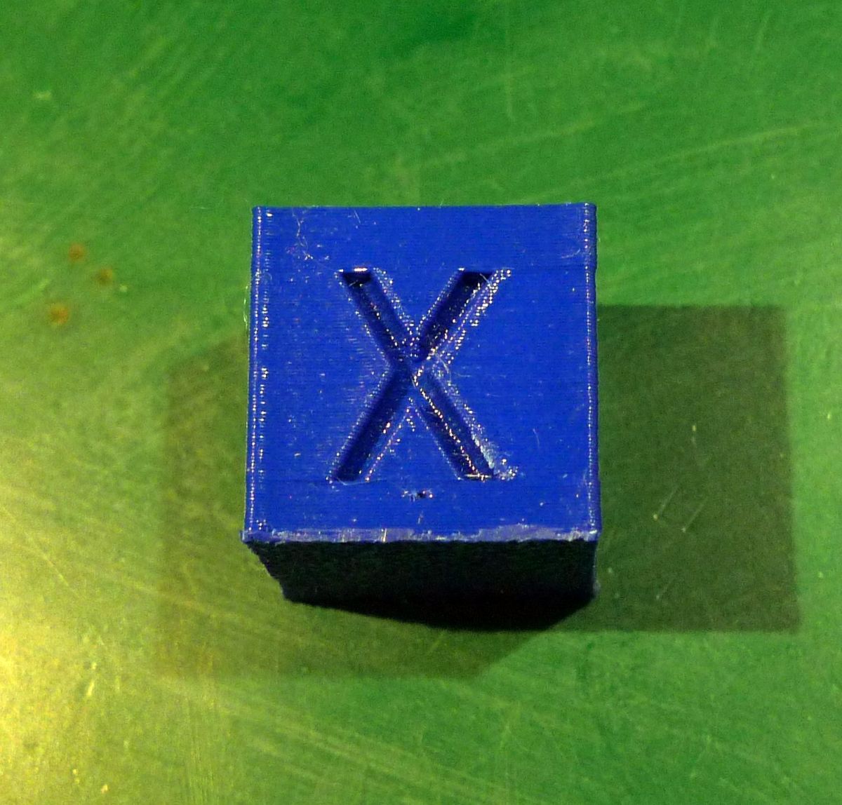

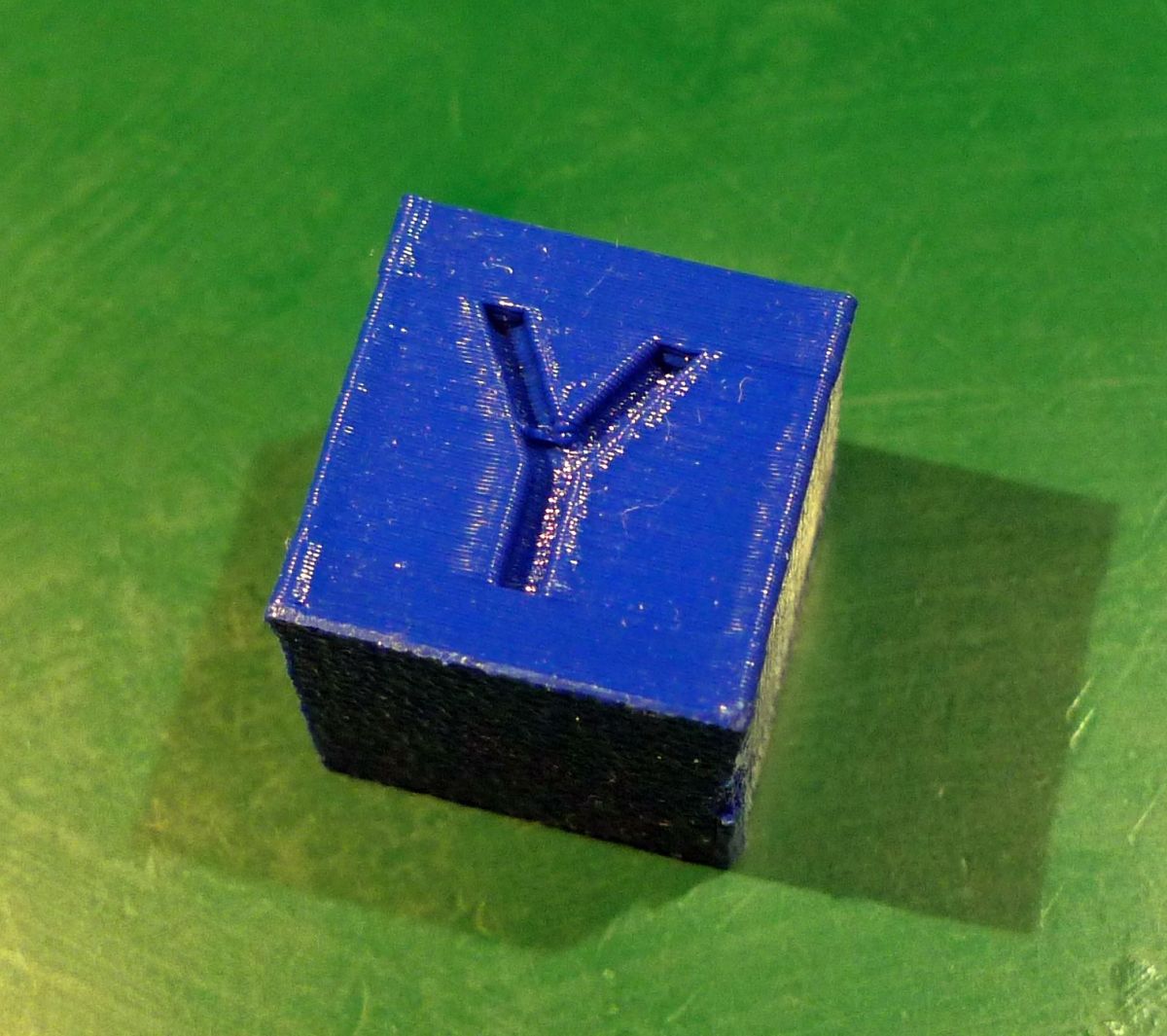

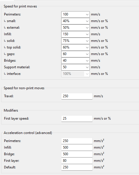

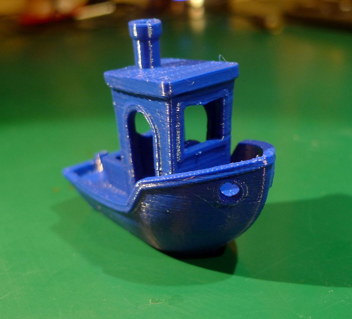

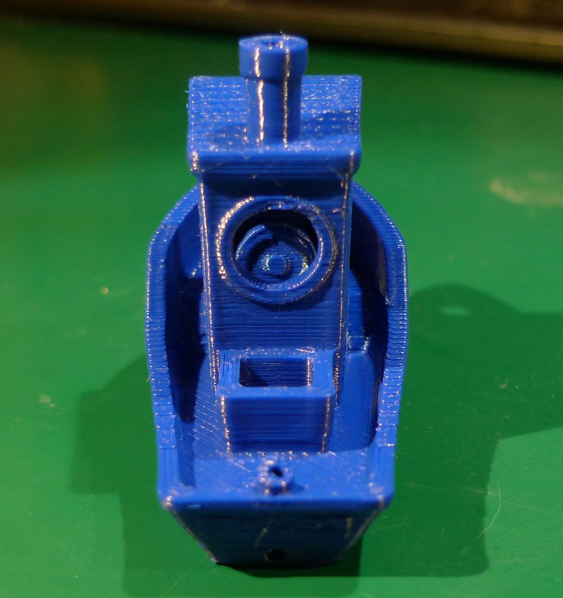

  • X-y axis coupling causing print artifacts
    #13 20694711
    Fimek
    Posts: 230
    Rate: 355
    Hi,

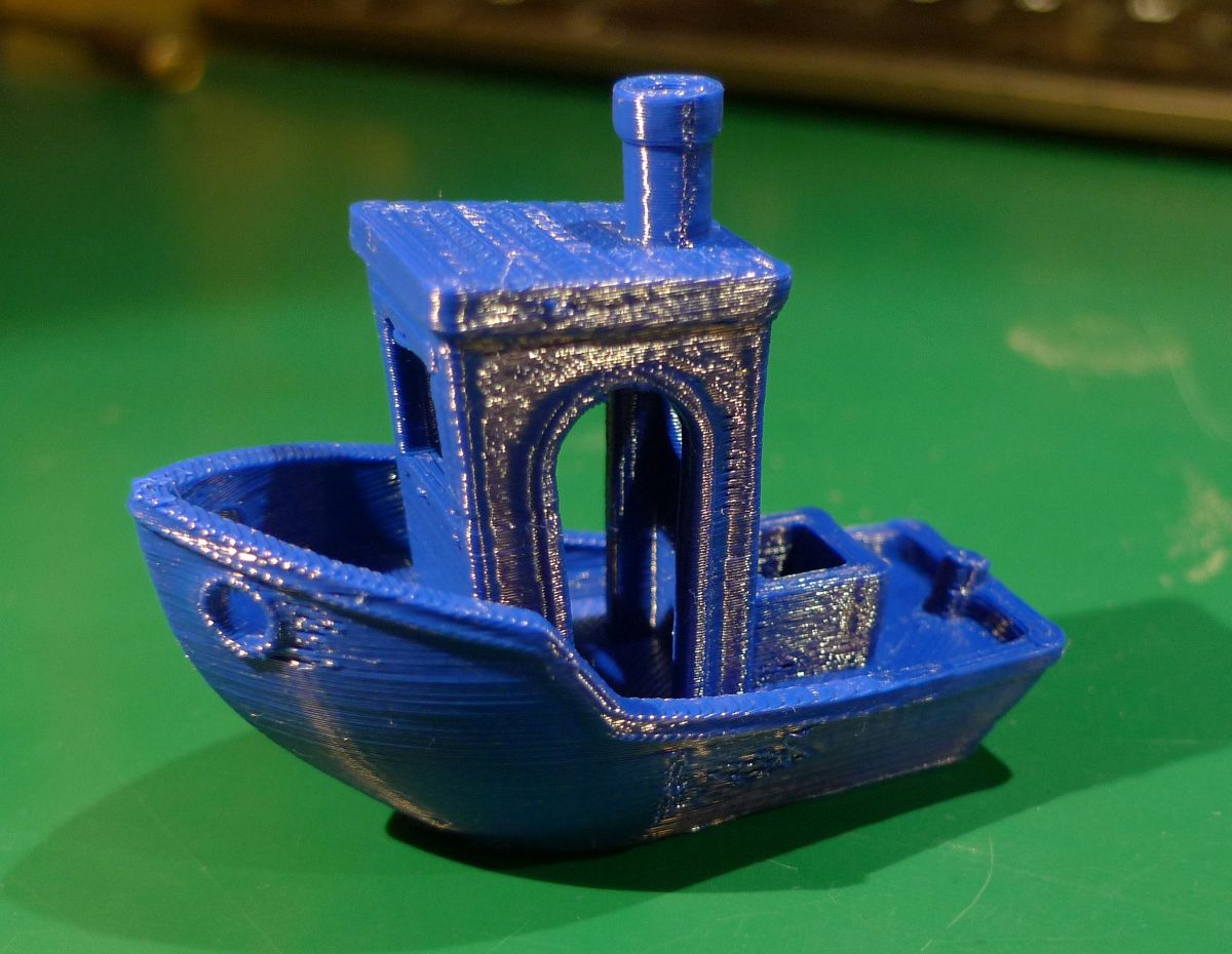

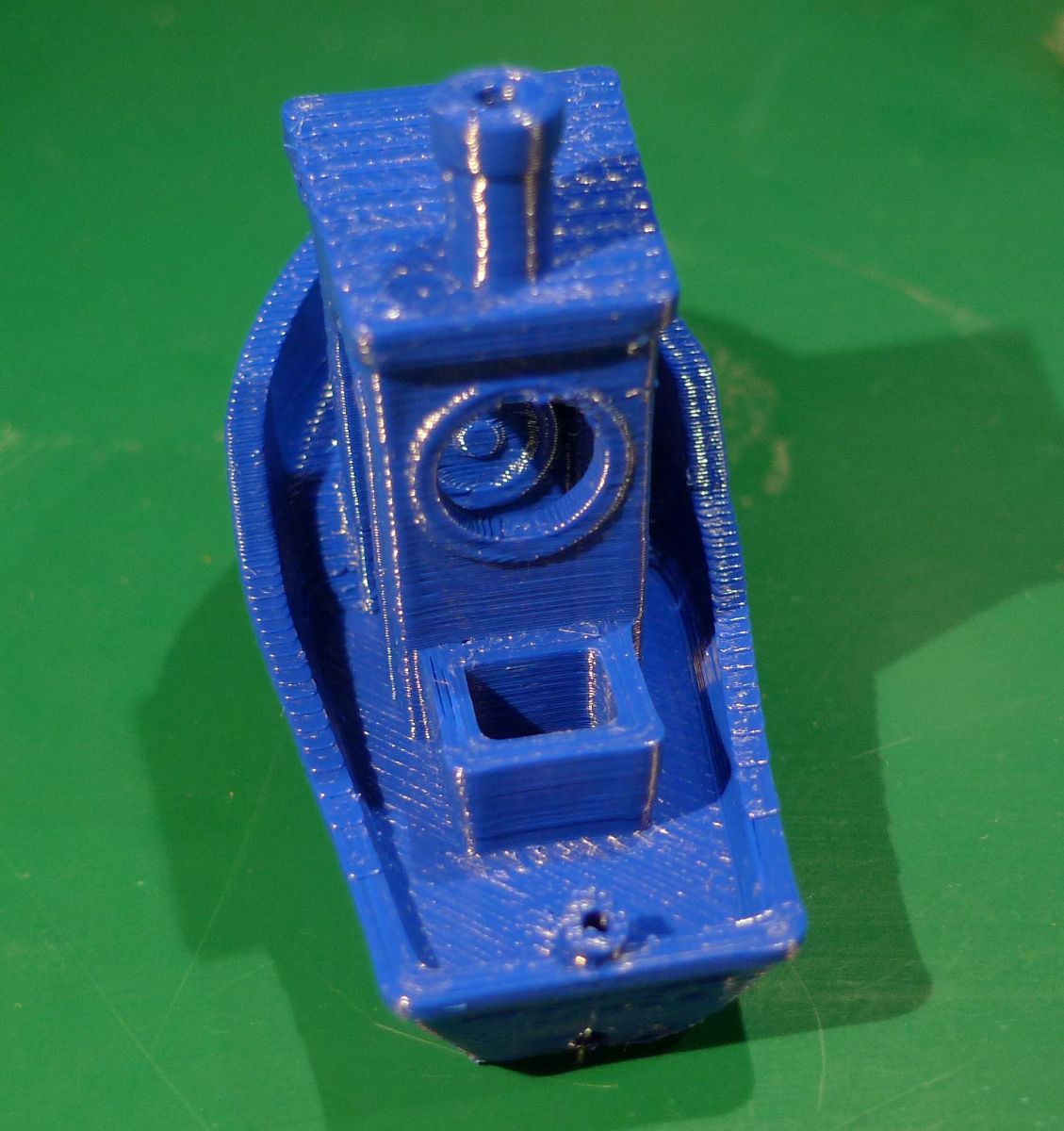

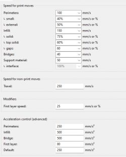

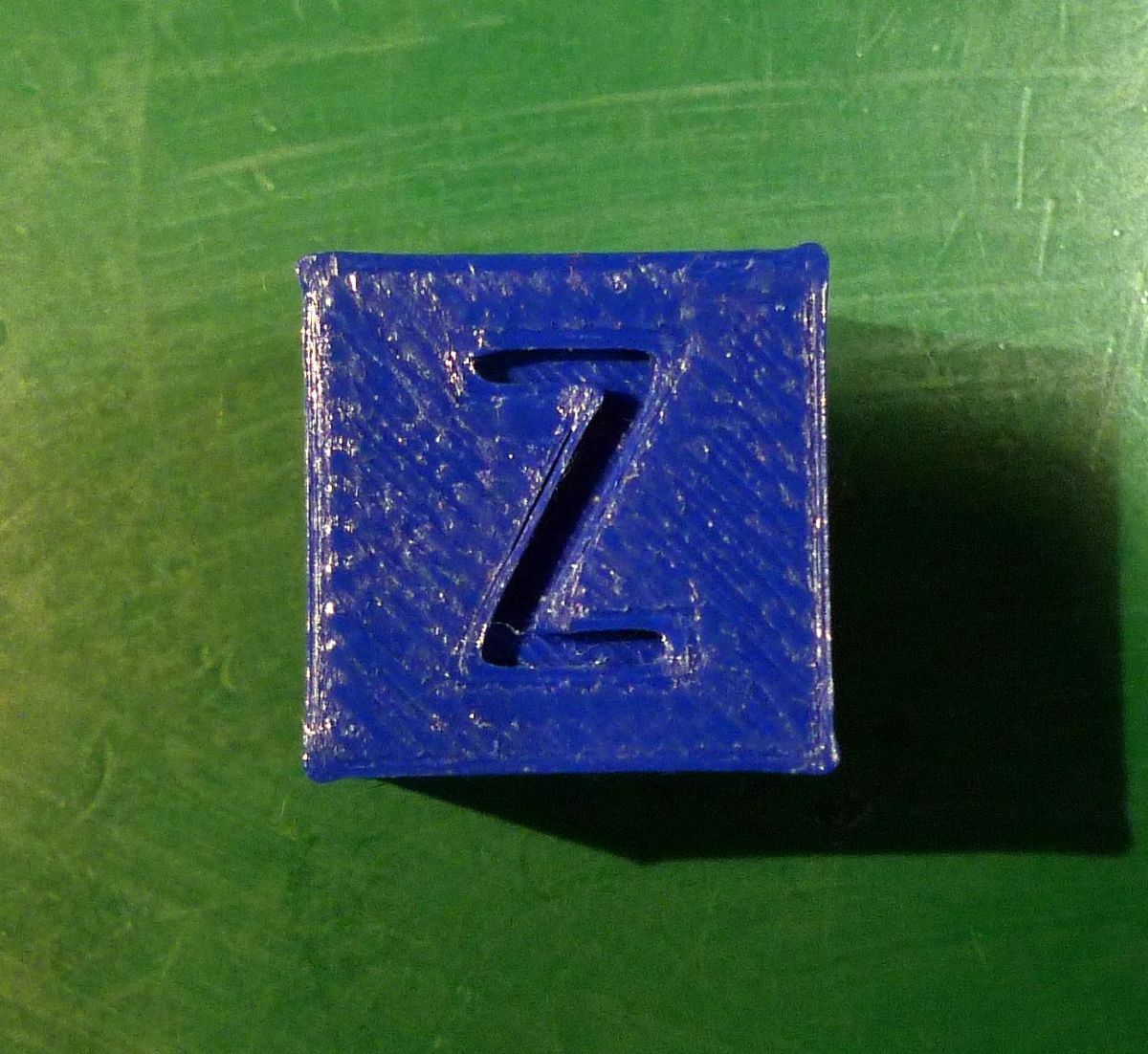

    In the end, I managed to make a fairly correct printout of the Bencha and the test cube. Only now I managed to finish the Bencha printout - earlier a few attempts ended in a fiasco, because when the printer started printing overhangs (at the top of the windows), at some point the nozzle hooked on the overhang and detached the printout from the bed. It turned out that there were two problems:
    - Inefficient airflow, first because of my poor design, and then, after I improved the design, because of the poor efficiency of the fans. The currently installed 4010 ball bearing centrifugal fans are OK.
    - The shape of the nozzle - the previous one was too sharply cut. The chamfer formed a large plane around the nozzle outlet. As a test, I replaced the nozzle with a newly purchased one, which looks more like a triangle in profile, and it's OK, you can't hear the nozzle hooking on the printout.
    The printout was quite fast (the parameters are attached in the picture, a screenshot from the Slic3r program). I printed with PET-G from Nebula (a nice and really reliable filament).
    To improve:
    - There is some visible interdependence between the movement of the extruder in the X and Y axes, which I want to eliminate. This can be seen in the form of bulges on the edges of the test cube and in the form of a rounded interior in a rectangular shape (trough) below the line of the back window of the Benchy and in the form of a rounded letter Z on the test cube. Probably the printing parameters also have a role here, but the correlation (minimal, but visible) was noticeable when manually moving the extruder along the X axis, and then Y (where the movement in the Y axis, which followed the movement in X, caused a slight shift also in the axis X - and vice versa). Maybe it's a matter of friction on the guide bushings, or maybe the X and Y motors wobble slightly on their mounting points. I did not register this swing earlier, but there is some reason for this interdependence - so it needs to be checked and eliminated.
    - I need to fine-tune the printing parameters, because the seam is visible and looks bad. It seems to me that here the mechanism of the printer is less important, and more important - the material and printing parameters.
    I am attaching Benchy printing videos and pictures of the prints. Regards :)
    https://youtu.be/DnT7nxemFZc
    https://youtu.be/KUBd8TYOLXg
    Screenshot showing print speed settings in Slic3r software.
    3D printed Benchy boat made from blue filament. 3D printed model of a Benchy boat in blue on a green background. Blue 3D printed model of a boat on a green background. Blue 3D print of a Benchy boat on a green background. 3D test cube with the letter X on a green background. Blue test cube with embossed letter Y on a green background. Image of a blue test cube with the letter Z, printed using a 3D printer. 3D test cube with letters X, Y, and Z printed from blue filament. Blue 3D printed Benchy model on a green background.

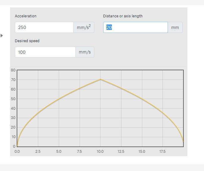

  • Prusa calculator shows only 80 mm/s peak speed

    @jarzabek666 Well, I must admit that your post would be more informative for me (and in general anyway), i.e. if it was the so-called constructive criticism, and not just the criticism itself.
    I realize that there is still a lot to do here - I write about everything without coloring. Nevertheless, I think that my idea for this printer has potential, but as I am a total amateur when it comes to 3D printing, mechanics and CAD, I'm getting tired of it, slowly removing imperfections and treating it as a hobby. And yes, despite the still imperfect results, I am happy that I was able to build what you see here in real life.
    I can print the cube at a higher speed, it's not a problem and I'm convinced that it will come out no worse than in the pictures. But at the moment it doesn't make sense, because I have a feeling that the degradation of quality is caused by the interdependence I mentioned, which I want to eliminate and which I wrote about. There are probably other problems, but I will eliminate them one by one.
    Regards,
    Fimek
  • Low acceleration prevents reaching set print speed
    #16 20694892
  • #17 20694896
    Fimek
    Posts: 230
    Rate: 355
    @jarzabek666 OK, thanks for the info, you're probably right. Recompiling Marlin is not a problem, so acceleration can be increased and check how it affects the printout. But what does this have to do with the problems I wrote about in previous posts?
  • #18 20694901
  • Lower X/Y acceleration improves print quality and linear advance compensation
    #19 20704067
    Fimek
    Posts: 230
    Rate: 355
    Hi,

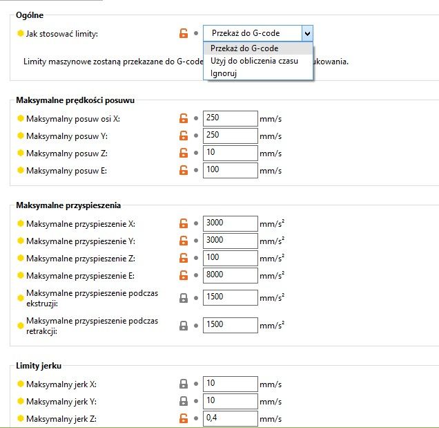

    Thanks to my friend @jarzabek666 I made a lot of progress in starting the printer. Previously, I had a bad intuition, as it turned out that limiting the acceleration of the X/Y movement will result in a printout with less artifacts. I was wrong :) As I understand now how Marlin works: the introduction of a limitation on the acceleration of movement does not go hand in hand with what the extruder releases. I was convinced that the movements of the head and the work of the extruder are synchronized. Yes, I know that the filament compresses and this effect can be compensated for, but I don't really buy it, because there is no room for compression in the direct extruder, and the melted filament is incompressible. I can only see the possible inaccuracy of the stepper motor, which introduces its errors (because it is asynchronous). Unless it's about the asynchronous operation of the motor + additionally expanding (or just reducing the volume?) of the filament while melting it. But that's probably a topic for another discussion :)
    returning:
    - the introduction of the acceleration limiter reduces "mechanical" artifacts such as snake skin on the surface and reduces noise, but causes artifacts such as dripping on the corners. Well, but reducing the acceleration is necessary, because at some point the printer will stop "kneading" and, for example, shake and lose steps.
    - in turn, the introduction of linear advance compensates for the effects caused by the software acceleration limitation.
    I started with an acceleration of 500 mm/s^2, which, as my colleague @jarzabek666 rightly pointed out, causes the head to accelerate for a long time and the printout has no chance to reach the speed of 100 mm/s. With such acceleration I got nice effects of linear advance for the coefficient k = 0.1 ... 0.12.
    Then I started playing with the acceleration and experimentally came up with 2000 mm/s^2 for X/Y and 200 mm/s^2 for the Z axis. For a randomly set acceleration of 10000 mm/s^2 I had step loss. For an acceleration of 2000 mm/s^2, the optimal k factor was 0.025 for me.
    My conclusions so far:
    - acceleration in the Z axis improved the appearance of the seam,
    - acceleration in the X/Y axes paradoxically reduced the amount of artifacts, which was the biggest shock for me :) Goosebumps (wobbling) problems have started to emerge, and here we will continue to play with speeding up and optimizing. For now, I can write that the current printer is actually about 2x faster than my previous printer, the converted Renkforce RF100, the adventures with which I described in one of the threads on the electrode.
    One more note: in the case of my SKR mini + Bigtreetech TFT 2.4 tiles, the acceleration settings, neither resulting from Marlin settings, nor selected in Slicer, matter. TFT always "wins" and you have to enter these values with your finger on its screen, because they will dominate the printer's work anyway.

    Hi,
    I'm uploading a video from printing after optimization. The printing parameters are in the video description. Of course, slower printing yields better quality :) If you have any ideas what could be improved, let me know.
    https://www.youtube.com/watch?v=NrBtfCKOoGY
    https://www.youtube.com/watch?v=RauPpPLwE_4
    https://www.youtube.com/watch?v=UAfh85p1Af8
    Regards!
