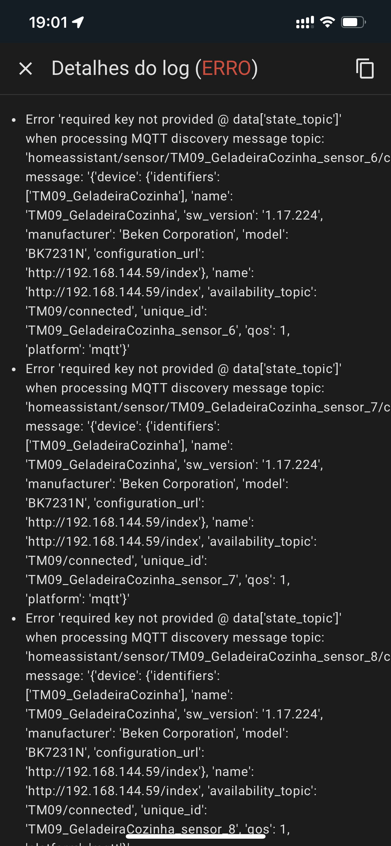

  • #6 20701723
    pedropaislopes
    Level 4  
    Hi!
    Unfortunately, it didn't solve the issue. The following screenshot is from the HA log viewer.
    HA log screenshot showing MQTT errors after updating to version 1.17.224.
    As it can be seen in the image, I've updated the device to the latest version available (1.17.224).
    Thanks a lot!
  • #7 20703113
    iprak
    Posts: 19
    Rate: 7
    Do you see Voltage/Current/Power entities attached to the device in HomeAssistant? These errors are most probably for OBK_CONSUMPTION_YESTERDAY, OBK_CONSUMPTION_TODAY, and OBK_CONSUMPTION_CLEAR_DATE sensors which don't seem to be completely implemented, and now HomeAssistant is being more strict about such entities.
    #8 20749651
    Posts: 14771
    Rate: 12914
    It seems I've found a problem with a help of @DCG . I was totally not aware that HA discovery would push entities without stat_t and having old HA on my side does not help.
    It should be now fixed, can you check?
  • #9 20750509
    pedropaislopes
    Level 4  
    Hi! Congratulations! This release solved the issue. Everything is OK now.
    Thank you!
    Cheers!
  • #10 20750617
    DCG
    Posts: 37
    Thanks @p.kaczmarek2 for your support.. I can confirm this issue is now resolved for my smart plug, after updating to v260
