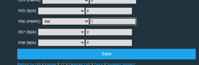

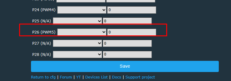

    ok so you can see that P26 is Relay index 1, so in OBK, go to Config->Module, find P26:
    Screenshot of the OBK configuration interface highlighting the settings field for pin P26 (PWM5).
    Select role, enter index, save. Do the same for other pins..
    A section of the OBK configuration interface showing GPIO pin settings, with P26 set as “Rel” and index set to 1.
