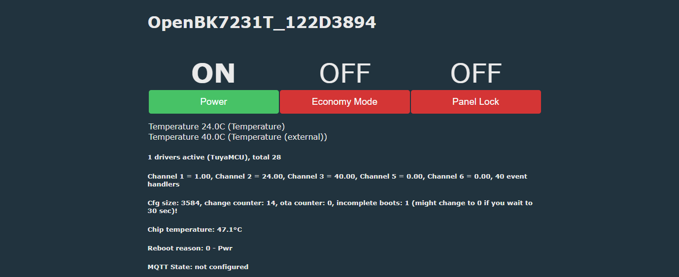

    The temperature is shown exactly 2 times higher (look at the screenshot, it shows 24 and 40 degrees, but it should be 12 and 20 degrees)
    And I don’t know how to add temperature control.

    When setting channel type for temperature, try using Temperature_div2 instead of Temperature.
    What exactly do you mean by control? I haven't yet looked precisely into this device. Do you mean a field where you can write a temperature?

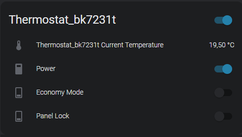

    Now Home Assistant only shows the sensor and switches, I can’t even change the temperature.
    Thermostat interface with various settings, including current temperature, power, economy mode, and panel lock.
    Thank you!

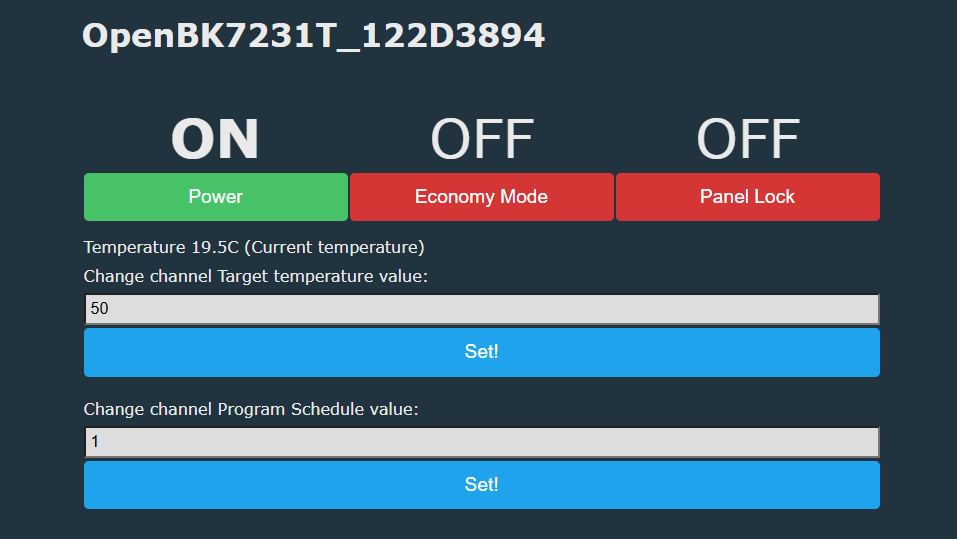

    Added after 49 [minutes]:
    I managed to make a command to set a new temperature.
    // set temperature
    setChannelLabel 2 "New Temperature"
    setChannelType 2 Temperature_div2
    linkTuyaMCUOutputToChannel 102 val 2
    // currenttemperature
    setChannelLabel 3 "Current Temperature"
    setChannelType 3 TextField
    linkTuyaMCUOutputToChannel 2 val 3
    Unfortunately there is no choice of slider command for temperature, as for example for dimmer - Dimmer, Dimmer256 and Dimmer1000.
    For example SetTemp, SetTemp_div2, SetTemp_div10 etc.
    User interface of OpenBK7231T temperature management system.
