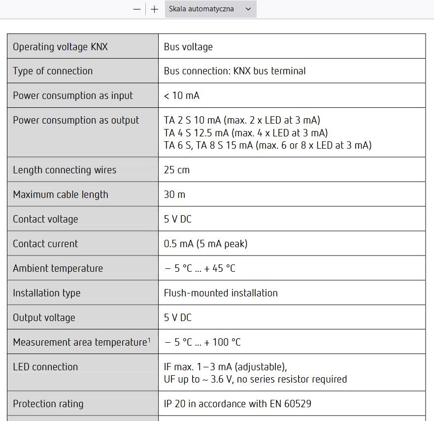

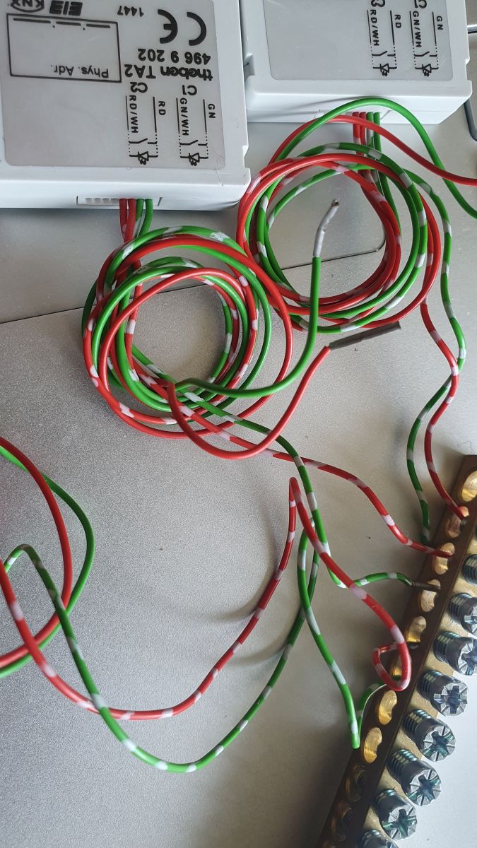

    Hello, I would like to simplify the installation a little, by bridging all COMs of the Theben TA2 modules, which will give me a saving of wires and a less complicated installation. I would like to make sure if such a connection would be correct:
    Technical specification table for Theben TA2 modules.
    Theben TA2 modules with red and green wires on a table. .

    Hello, I have bridged everything and it works!
