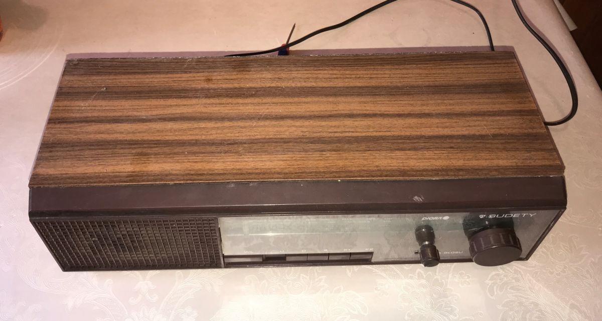

  • Vintage monophonic radio Unitra Sudety R-208 from 1987-1990 on a table. .
    Today another short presentation of an old Polish monophonic radio, this time Unitra Sudety R-208 produced by Dior from the years ca. 1987-1990. This radio offers AM and FM reception and sound recording to an external tape recorder, supports the ranges of long wave (148.5-283.5 kHz), medium wave (526.5-1606.5 kHz), short wave (5.95-9.9 MHz and 11.65-21.85 MHz) and FM (65.5-74 MHz). Detailed sensitivity, power and power supply parameters can be found in the original manual attached to the subject.
    Top view of Unitra Sudety R-208 radio from 1987-1990. .

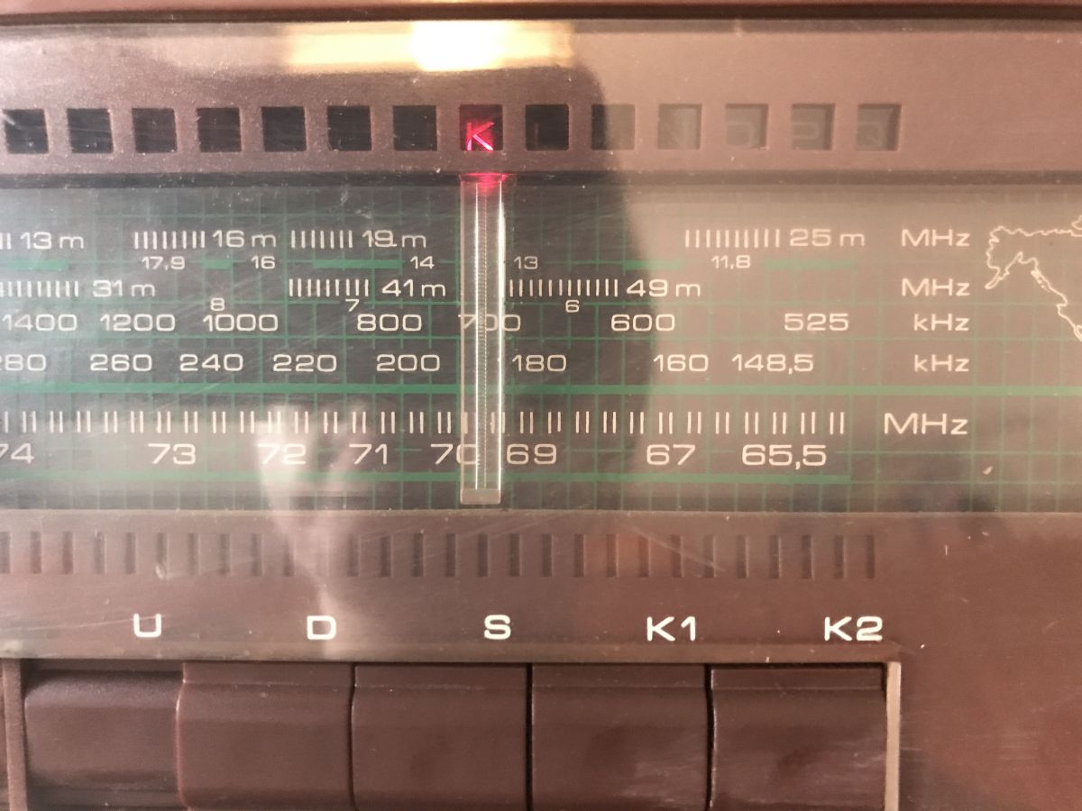

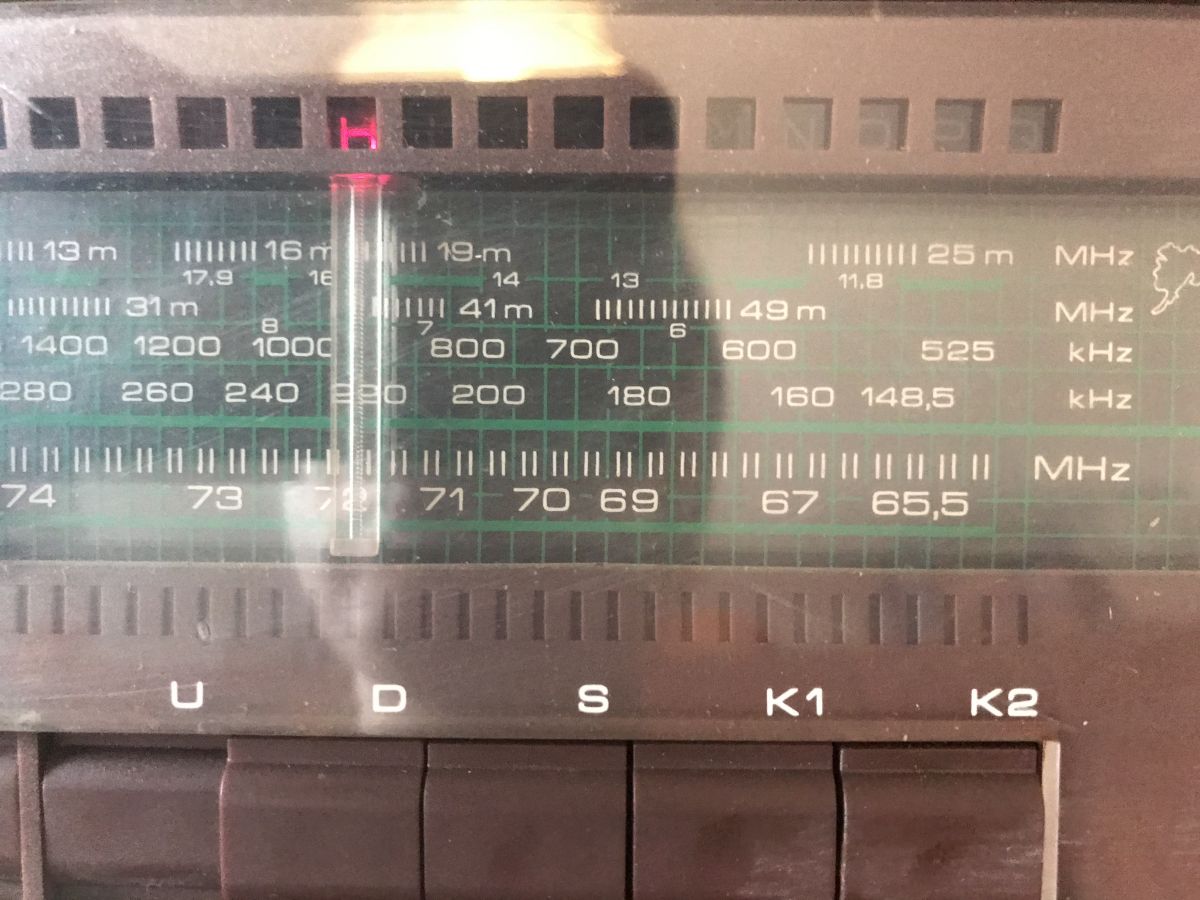

    First, let's take a look at the front end, which houses the bare minimum of functionality, namely the on/off switch, D, S, K1, K2, U band selection, tuning and volume control.
    Vintage Unitra Sudety R-208 monophonic radio receiver from 1987-1990. .

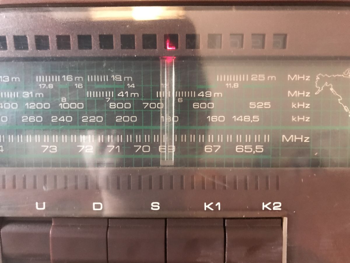

    In addition, when tuning, we have red illumination of the ranges:
    Unitra Sudety R-208 radio display showing frequency ranges and illumination. Frequency scale of Unitra Sudety R-208 radio with AM and FM bands. Close-up of the front panel of a Unitra Sudety R-208 radio with visible scales and band selection buttons. .

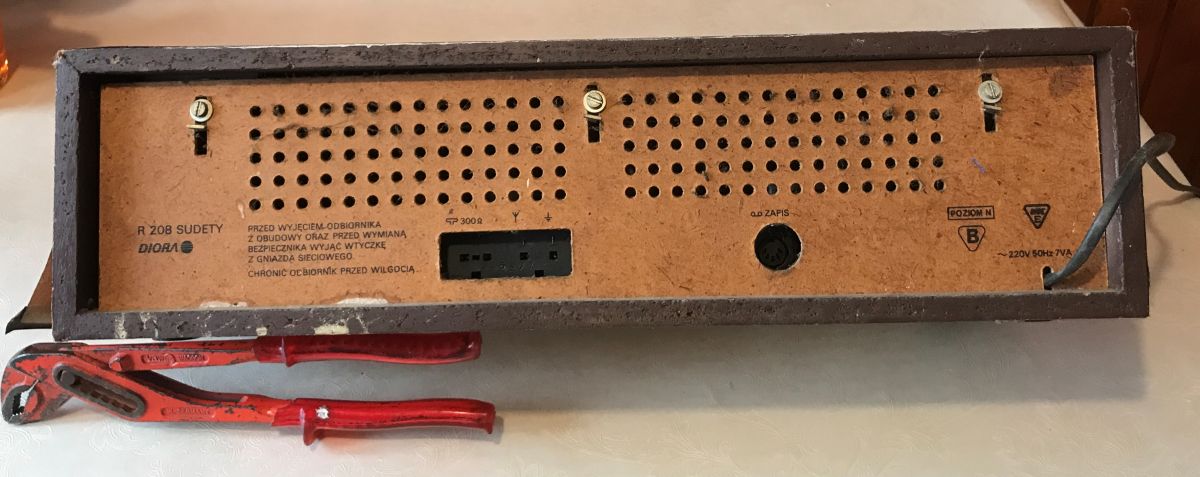

    A glimpse of the rear, connector for aerial, cassette slot, for recording only:
    Back of the Unitra Sudety R-208 radio with visible connectors. .

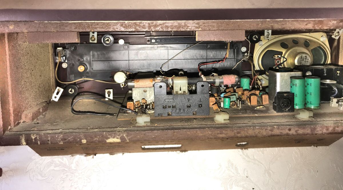

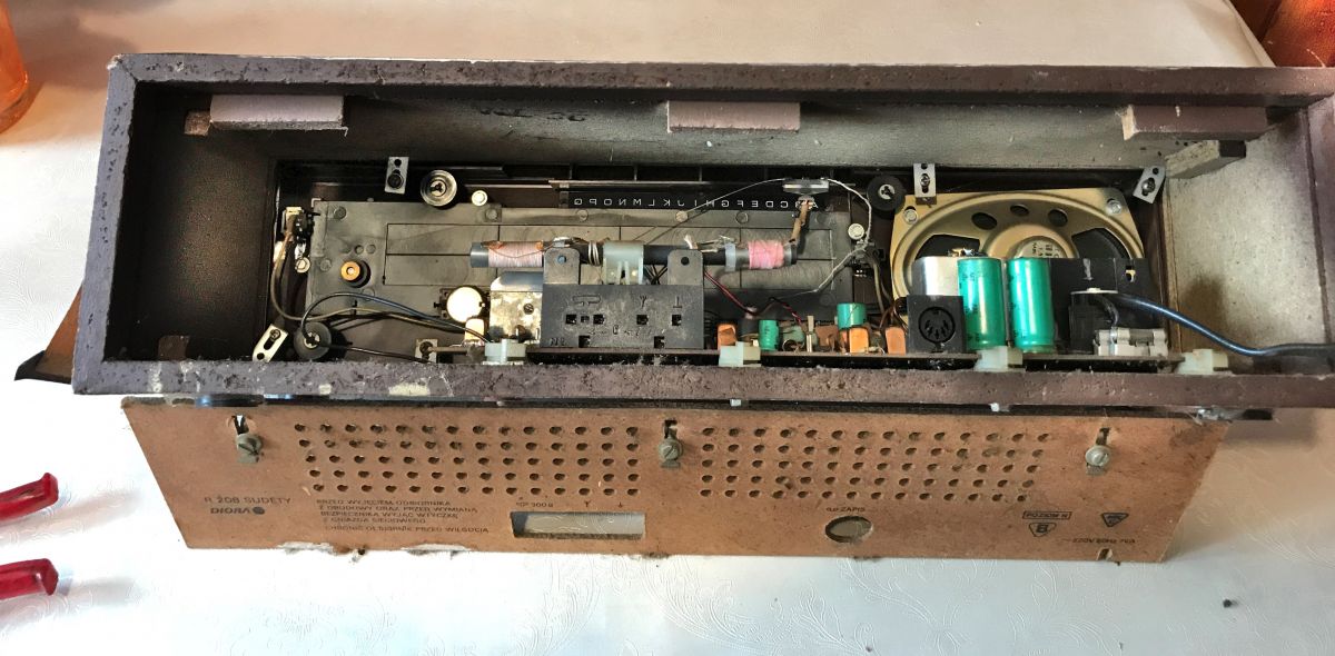

    Looking inside:
    View of the interior of the Unitra Sudety R-208 radio receiver from 1987-1990. .

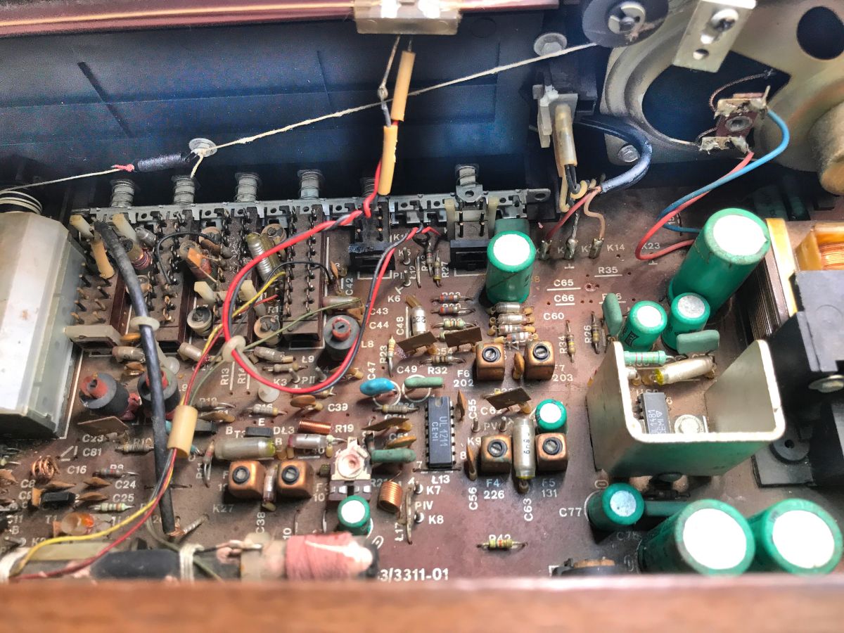

    Doesn't look too bad, but there is a broken tuning string:
    Interior of Unitra Sudety R-208 radio with visible electronic components and speaker. .

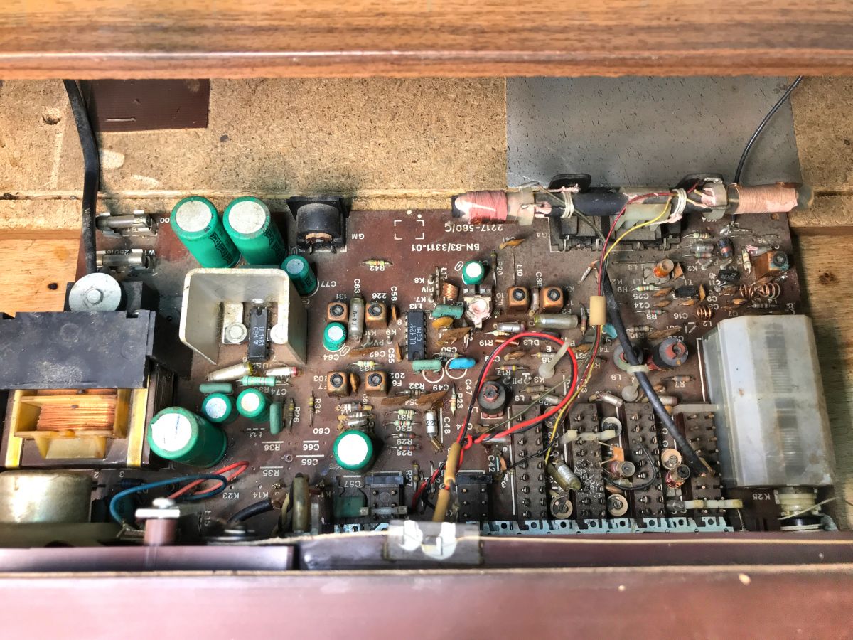

    You can then release the catches and slide out the front panel including the PCB:
    View of the interior of the Unitra Sudety R-208 radio receiver with electronic components. .

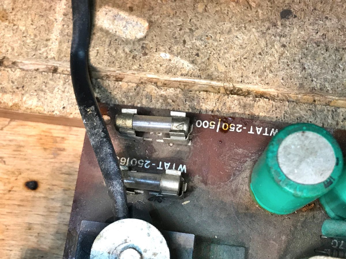

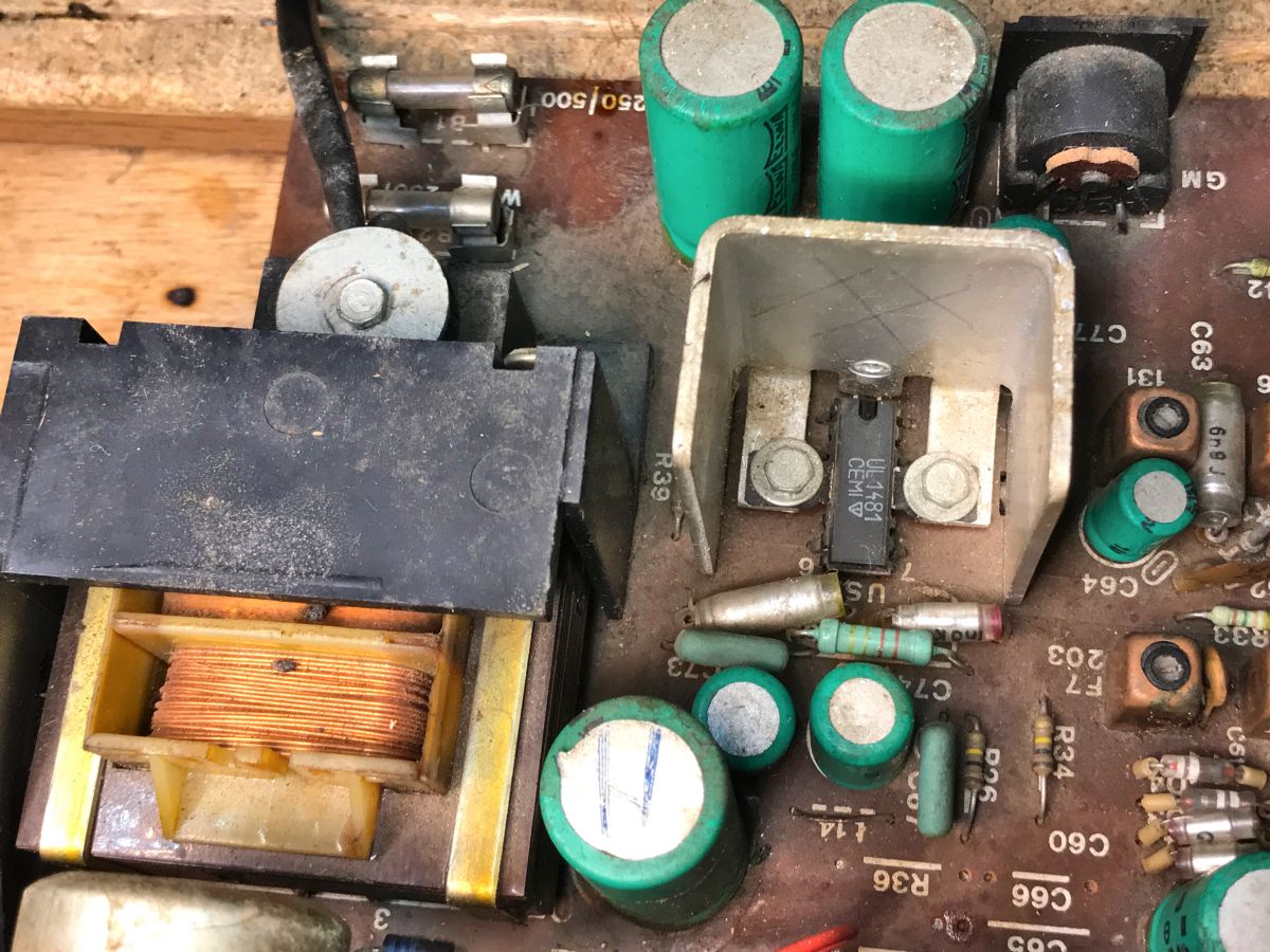

    Let's take a look at the PCB. This design is characterised by the presence of a switch on the secondary side only. Here in the picture the fuses.
    Close-up of fuses on the printed circuit board of an old Polish radio receiver. .

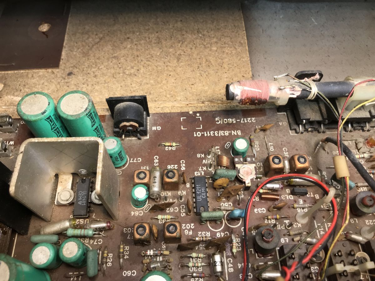

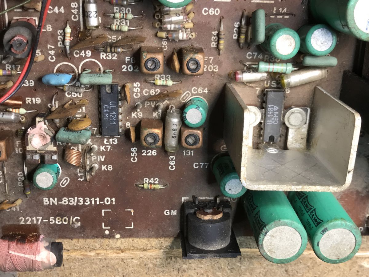

    UL1481, audio amplifier:
    Close-up of the internal circuit board of the Unitra Sudety R-208 radio receiver. .

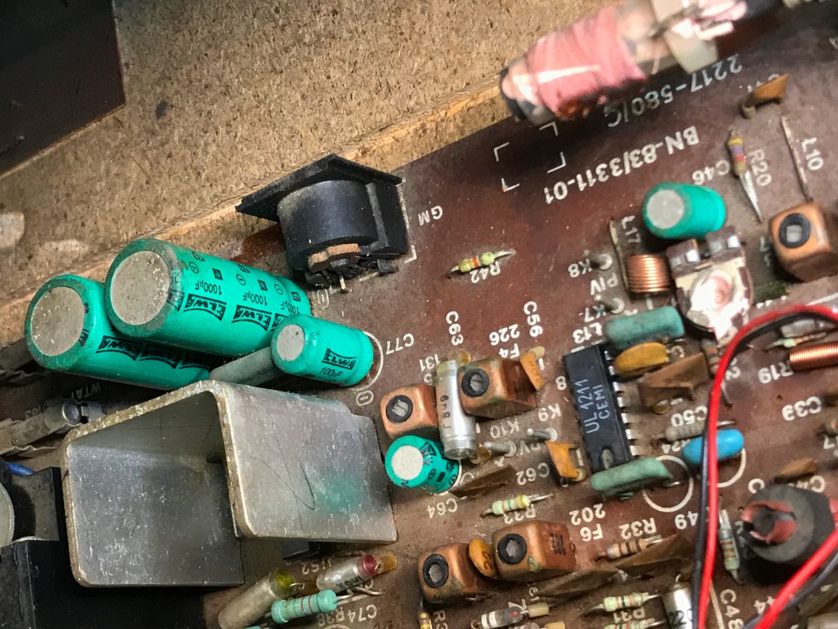

    UL1211, audio amplifier including two AM/FM amplifiers with AM detector, FM amplifier with limiter and voltage stabiliser:
    Close-up of the interior of a Polish Unitra Sudety R-208 radio receiver with visible electronic components. .

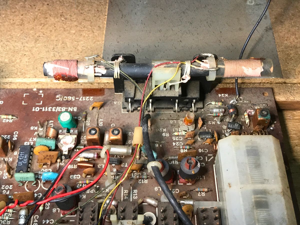

    Ferrite antenna, BF194, BF195 transistors:
    Close-up of the internal components of the Unitra Sudety R-208 radio receiver with a visible ferrite antenna. .

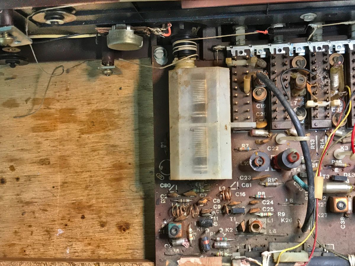

    Tuning capacitor, isostats:
    Interior of Unitra Sudety R-208 radio with visible PCB and components.

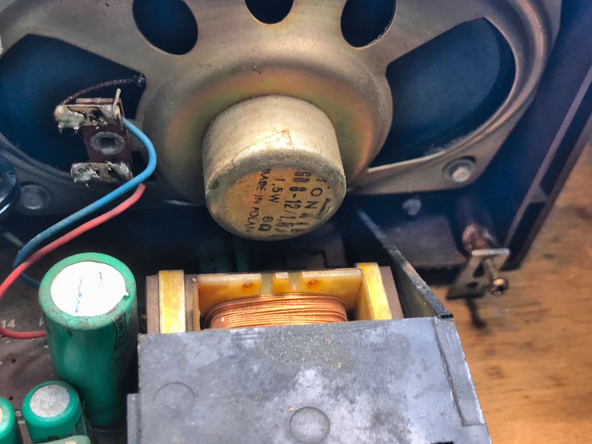

    Tonsil loudspeaker 1,5 W, 8 Ω, Made In Poland:
    Interior of Unitra Sudety R-208 radio with visible Tonsil speaker. .
    Elwa electrolytic capacitors:
    Close-up of a circuit board with Elwa electrolytic capacitors in the Unitra Sudety R-208 radio receiver. .

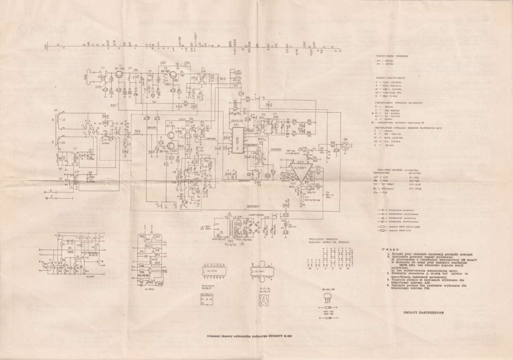

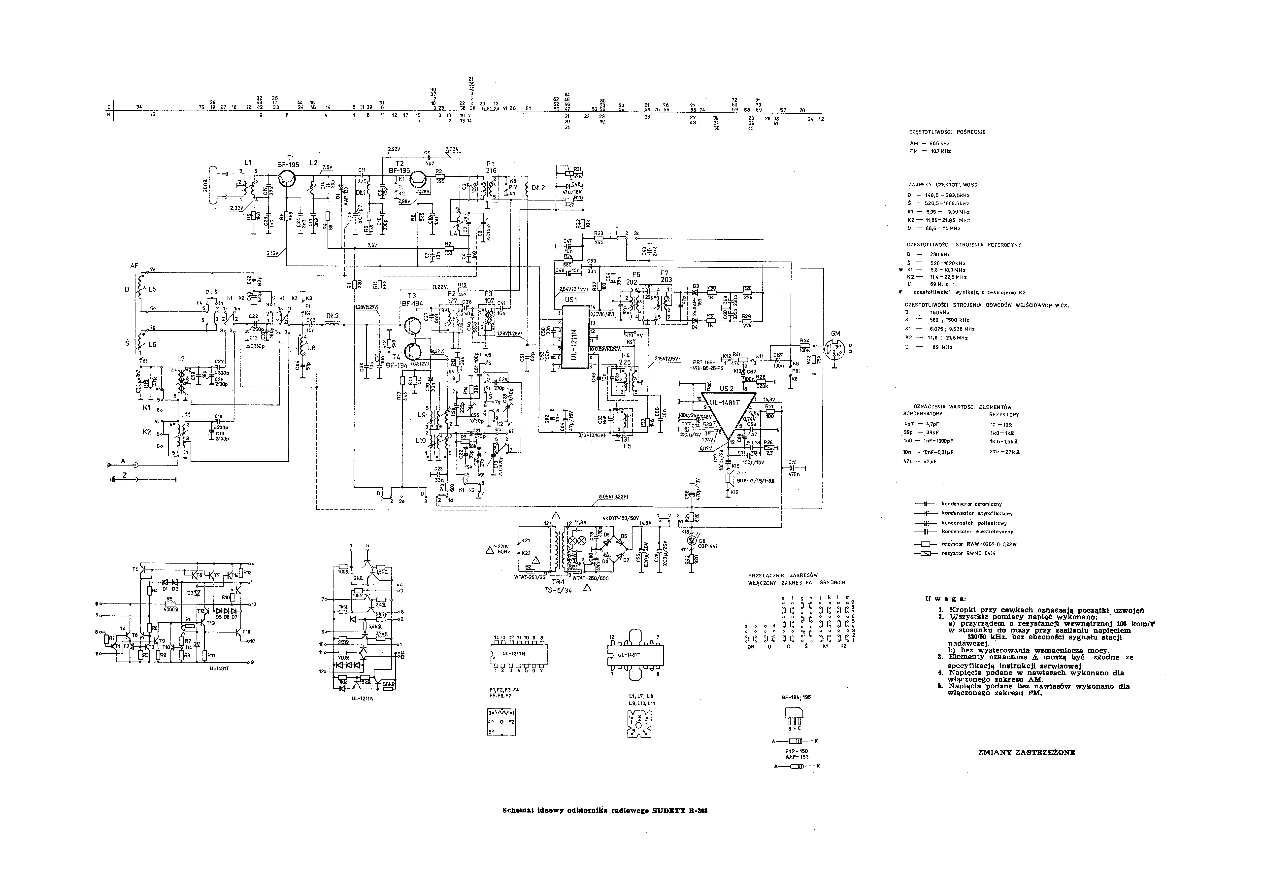

    Schematic:
    Circuit diagram of the Unitra Sudety R-208 radio receiver.

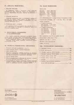

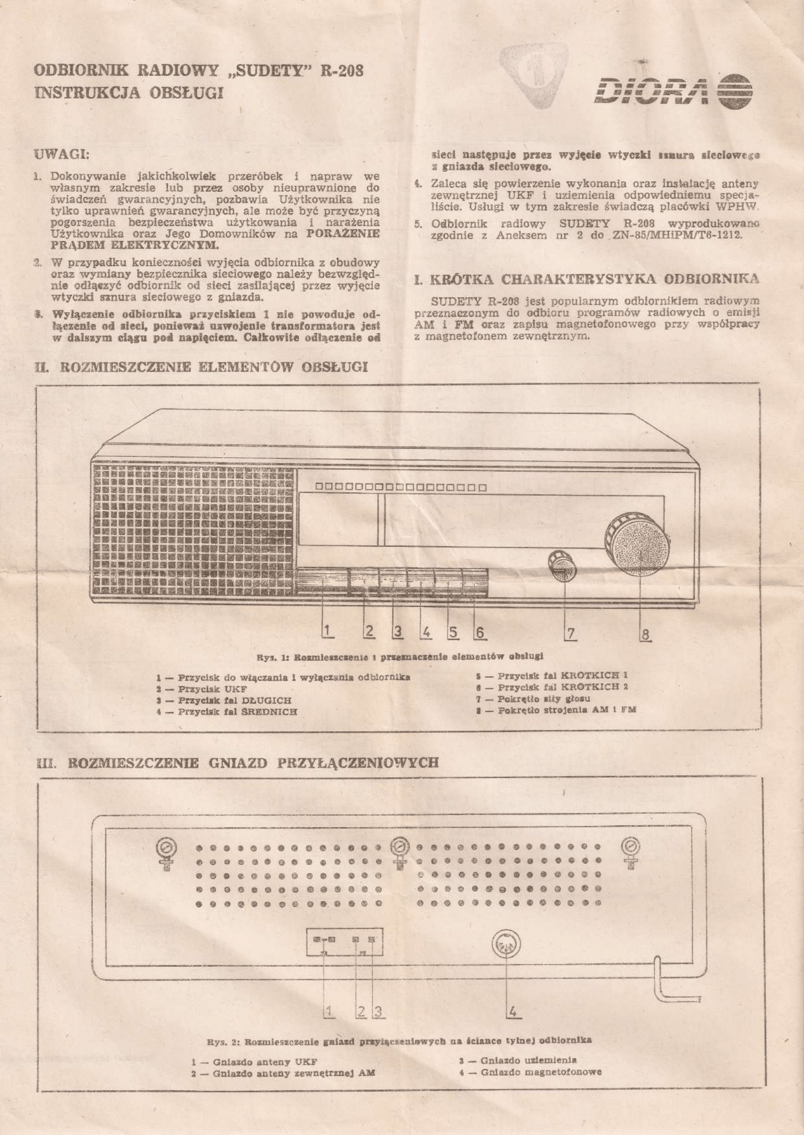

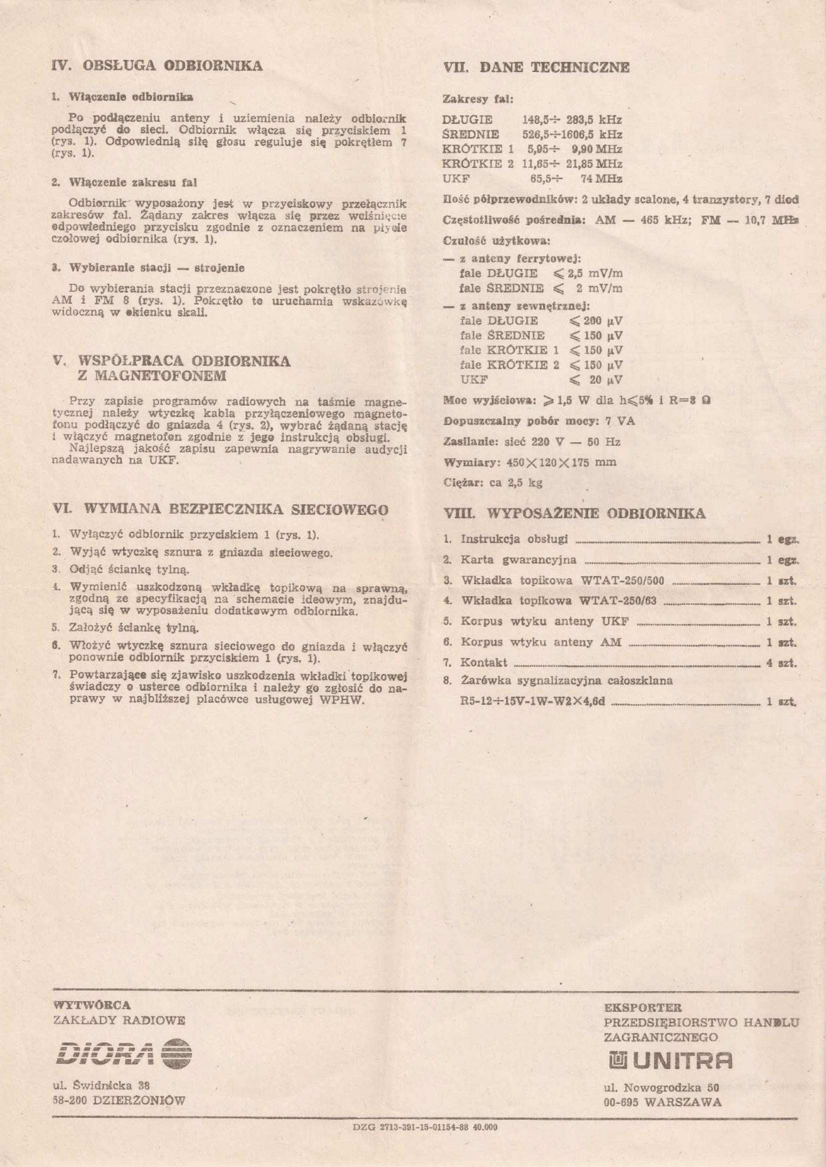

    Instructions with specifications:
    User manual of the Unitra Sudety R-208 radio receiver with illustrations. User manual of the Unitra Sudety R-208 radio with technical specifications. Insert for the user manual of the Unitra Diora Sudety R-208 radio receiver. Electrical schematic of the Unitra Sudety R-208 radio. .

    I'm looking at the schematic and I don't understand why the m.cz signal is routed to the secondary winding of the head unit p.cz filter?

    Additionally, when tuning, we have red highlighting of the ranges:
    In my opinion, these are rather meaningless next letters from the alphabet. Such a fiddly thing, like the mass-mounted blue LEDs in mini-towers twenty years later.

    All in all, the most interesting thing about this radio is the nice scale with a drawn map and the red letters indicating the location. Quite an impressive gadget for such an archaic receiver. It looks good especially when illuminated with a white led. All the rest of the technology is secondary and popular to a fault.
