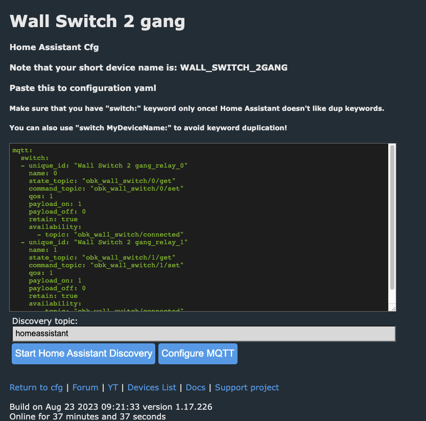

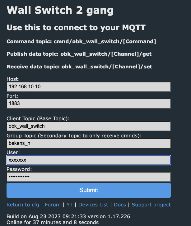

    I have flashed the device with openbeacon. The device is working and I'm able to listen and set the MQTT topics from Hass MQTT config page. The relays are responding well! But the device is not getting discovered. What am I missing? Configuration interface for Wall Switch 2 gang with MQTT settings. MQTT configuration form for a wall switch with two sections. User interface for Wall Switch 2 gang with toggle options.

    Hello, do you click "Start home assistant discovery"?
  • #3 20713373
    soubhikkhan
    Posts: 13
    Yes, I did! It shows, MQTT discovery queued.
  • #4 20713380
    Posts: 14771
    Rate: 12914
    What do you have in HA logs?

    Ah, thanks for pointing that out! I don't know why it's taking space between characters!
    Received message on illegal discovery topic 'homeassistant/switch/Wall Switch 2 gang_relay_0/config'. The topic contains not allowed characters. For more information, see https://www.home-assistant.io/integrations/mqtt/#discovery-topic
    9:19:31 AM – (WARNING) MQTT - message first occurred at August 28, 2023, at 5:16:52 PM and shows up 6 times
    Even in the obk, it shows like this!
    mqtt:
    switch:
    - unique_id: "Wall Switch 2 gang_relay_0"
    state_topic: "obk_wall_switch/0/get"
    command_topic: "obk_wall_switch/0/set"
    qos: 1
    payload_on: 1
    payload_off: 0
    retain: true
    availability:
    - topic: "obk_wall_switch/connected"
    - unique_id: "Wall Switch 2 gang_relay_1"
    state_topic: "obk_wall_switch/1/get"
    command_topic: "obk_wall_switch/1/set"
    qos: 1
    payload_on: 1
    payload_off: 0
    retain: true
    availability:

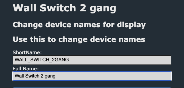

    I think I found out.. in the device naming, I used spaces
    Settings interface with options to change the device name Wall Switch 2 gang.

    Yes, I removed the spaces from "Full Name" and clicked on the discover again. Now the device popped up on HA!
