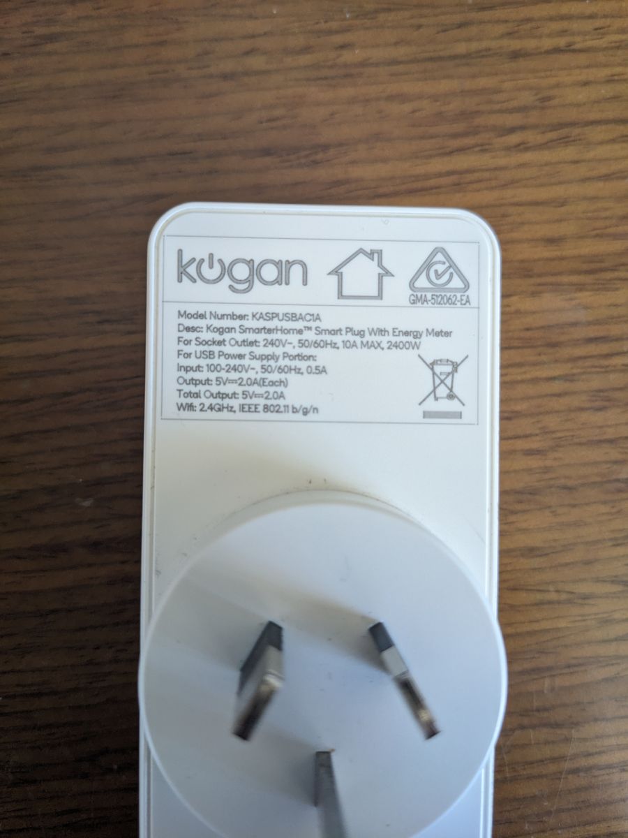

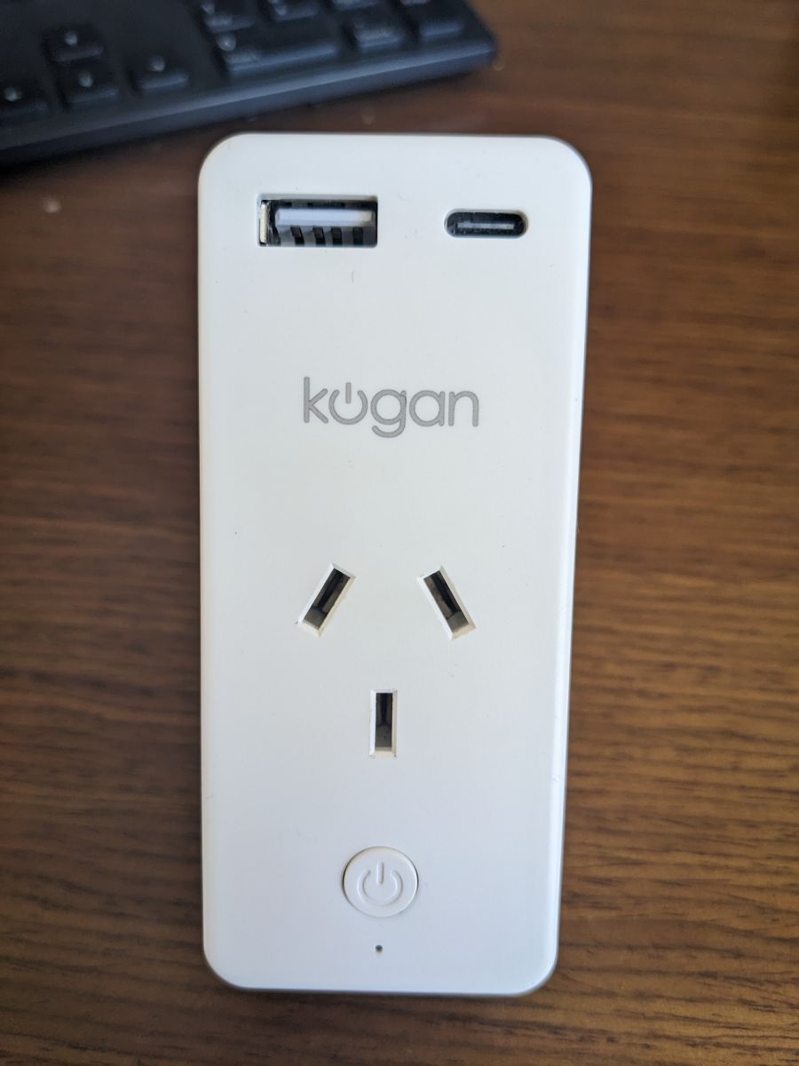

    I managed to get this plug flashed OTA using the other Kogan profile KASPEMHA.
    However, mine is BK7231N, not BK7231T. Also, the physical button was on a different pin, in this case P7.
    Kogan SmarterHome smart plug with energy meter on a wooden surface
    Kogan smart plug with USB ports lying on a wooden surface.
    Official device to buy from: https://www.kogan.com/au/buy/kogan-smarterhometm-smart-plug-with-energy-meter-5v-2a-usb-ac-ports-kogan.
    I've got the Tuya binary to JSON, but it doesn't seem to tell me what the pins are for energy monitoring.
    However, if I type in
    startDriver BL0942
    , then it starts energy monitoring and reporting. But after power cycling the plug, it no longer reports the energy.
    Regarding the plug itself, it works quite well. The USB ports aren't controllable, so if the plug is off, the USB ports still provide power.
    Anyway, here's the JSON code from BK7231 Easy UART Flasher
