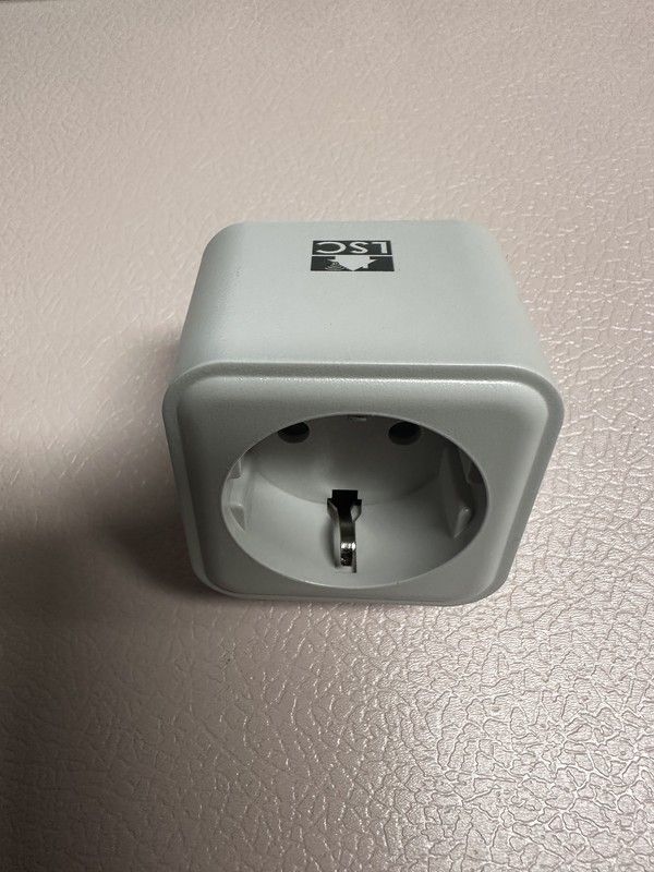

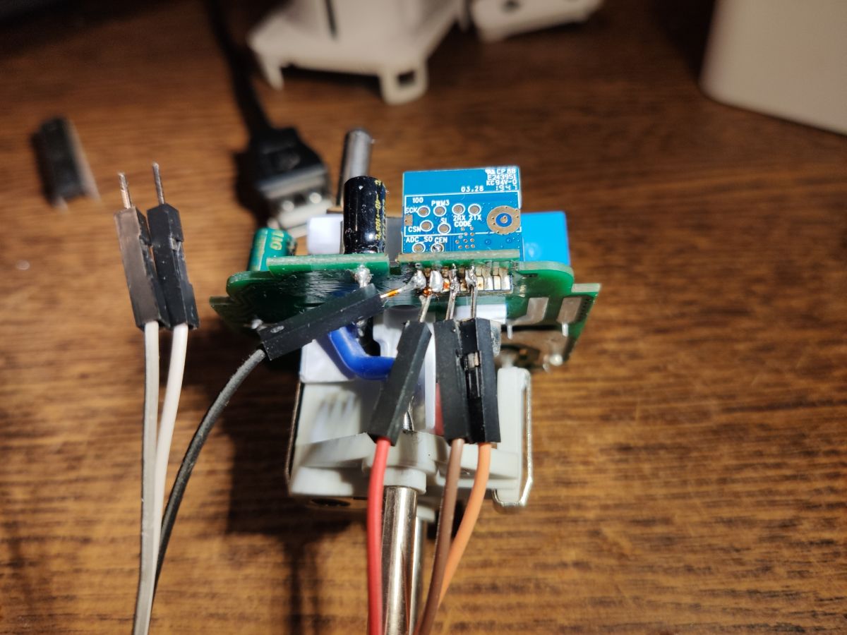

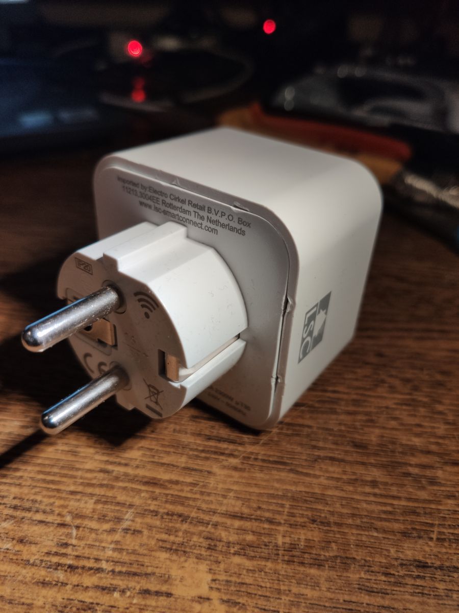

  • Teardown and flashing guide for the LSC Power Plug (ACTION) ArtNO. 2578685, a BK7231T smart plug without an energy meter.
  • Open it with Torx 8, remove two PCB screws, lift the PCB slightly, and solder the flashing lines before loading OpenBK7231T_UA_1.x.x.bin.

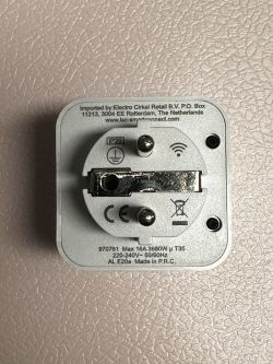

  • The plug is rated 16A, 220-250V ~ 50/60Hz, with EAN 8712879146575 and version 970761 v1.0.
  • Configure OpenBeken MQTT with flags 7, 10, 19, and 21, then map P6/P7/P8/P24 to Bt, LED, LED_n, and Rel.
  • LSC Power Plug (ACTION)
    ArtNO. 2578685
    970761 v1.0
    EAN: 8712879146575

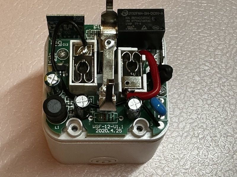

    Opening: Torx 8
    Open the plug
    2 PCB screws
    Lift off (a little) the PCB
    Solder the lines for flashing
    Flash device by OpenBK7231T_UA_1.x.x.bin
    Close plug correctly

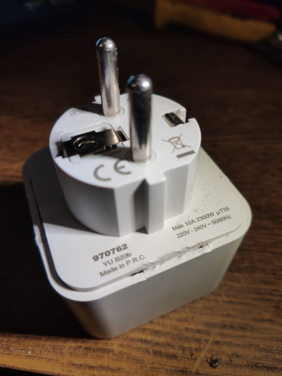

    Mam gniazdo LSC Smart Power Plug w wersji 2.0 (Art. No. 970762 v2.0) kupiony kilka lat temu w polskim sklepie Action.
    Zastosowałem następującą konfigurację:
    P7 (PWM1) - LED 0
    P24 (PWM4) - Rel 0
    P26 (PWM5) - Btn 0
    Działa bardzo dobrze z MQTT i homeassistantem!

    Hey @robkry , we don't have 970762 device on our database yet. Would you be able to provide a device photo or a photo of a packaging? Thanks!

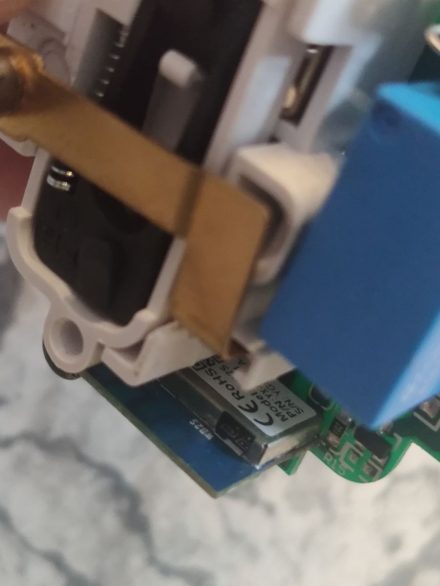

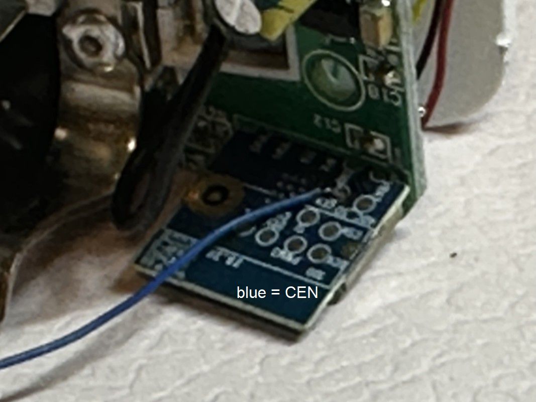

  • Desolder WB2S module to fix flash read errors
    #5 20399901
    robkry
    Posts: 59
    Help: 11

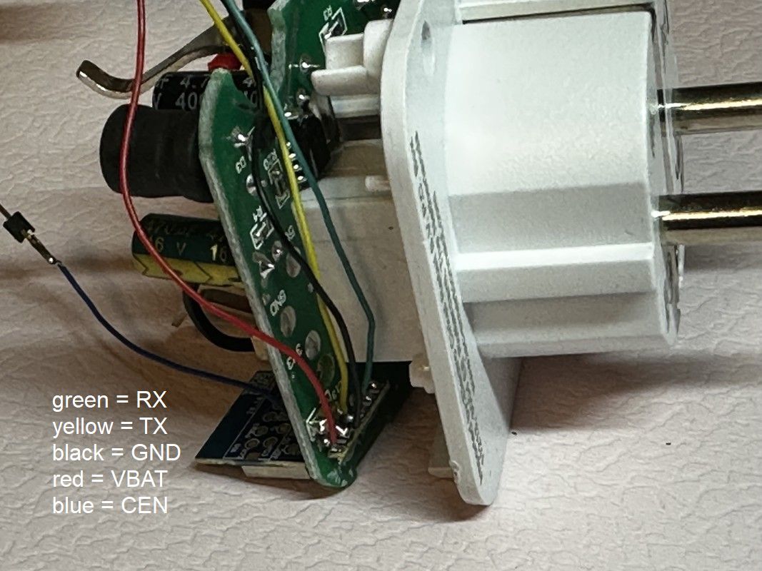

    Dodaję zdjęcia wersji 970762:
    [BK7231T] Teardown Action LCS Smart Plug (without Energy Meter) 2578685 [BK7231T] Teardown Action LCS Smart Plug (without Energy Meter) 2578685 [BK7231T] Teardown Action LCS Smart Plug (without Energy Meter) 2578685 [BK7231T] Teardown Action LCS Smart Plug (without Energy Meter) 2578685 [BK7231T] Teardown Action LCS Smart Plug (without Energy Meter) 2578685
    Gdyby pojawiały się błędy przy odczycie bądź programowaniu pamięci, proponuję wylutowanie modułu WB2S (tak było w moim przypadku).

    And here's a repost of my short description how to do desoldering/soldering WB2S:
    Just desolder CB2S.
    First add some flux to the pads and remove solder with soldering wick:
    Desoldering process on a green circuit board using a soldering iron and solder wick.
    Then solder the wires:
    Close-up of an electronic module with visible pads and pin labels.
    Then power module from 3.3V and connect to USB to TTL:
    Then use BK GUI flasher. If it doesn't work for you (there are some rare reports that BK GUI doesn't work with certain USB converters, but hid_download_py does), use hid_download_py method from this video:
    Make sure that OBK access point shows up.
    Then desolder wires, and clear the module pads:
    Electronic module with soldered wires and a holding clamp.
    Then prepare to solder back the module, add some flux to the pads:
    Desoldering braid over a circuit board with electronic components.
    And solder back the module:
    Soldering a component onto a printed circuit board using a soldering iron.
    I hope that somebody will find that useful. Have fun soldering!
