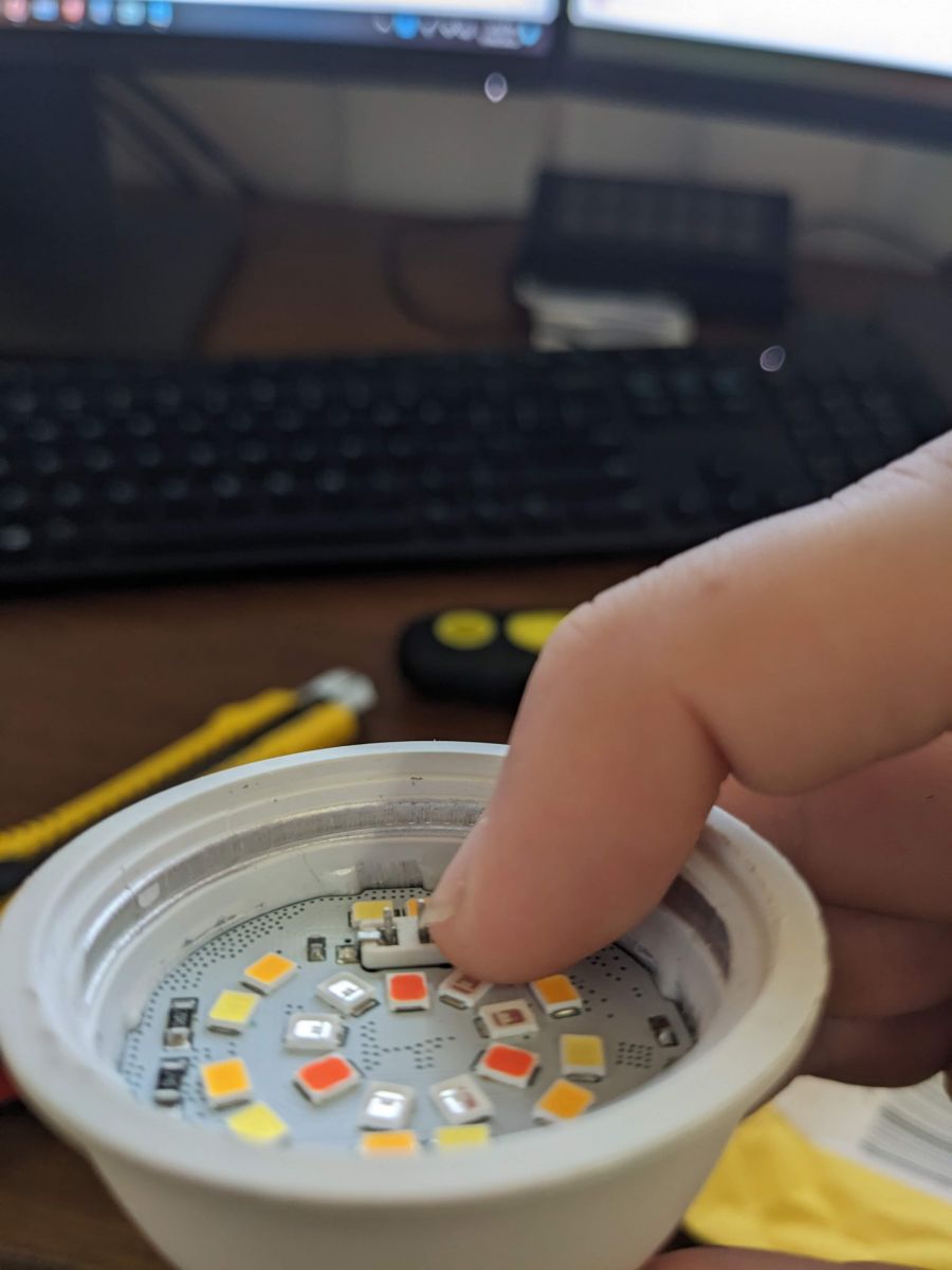

  • Teardown starts with delidding the translucent cover
    #6 20717058
    Posts: 14797
    Rate: 12954
    This is the worst possible bulb type to open. Some of those bulbs have base contacts made in such a way it's hard to put them back it. I know @ferbulous was trying to convert some of those bulbs with some success, but maybe he can tell more about it. I personally don't have that kind of bulb sockets in Poland.
    The first step would be to delid first the translucent cover to see the LEDs, and then try removing the board with LEDs.
    Please make photos along the way, we like to document IoT devices here. This will make a good entry for our list:

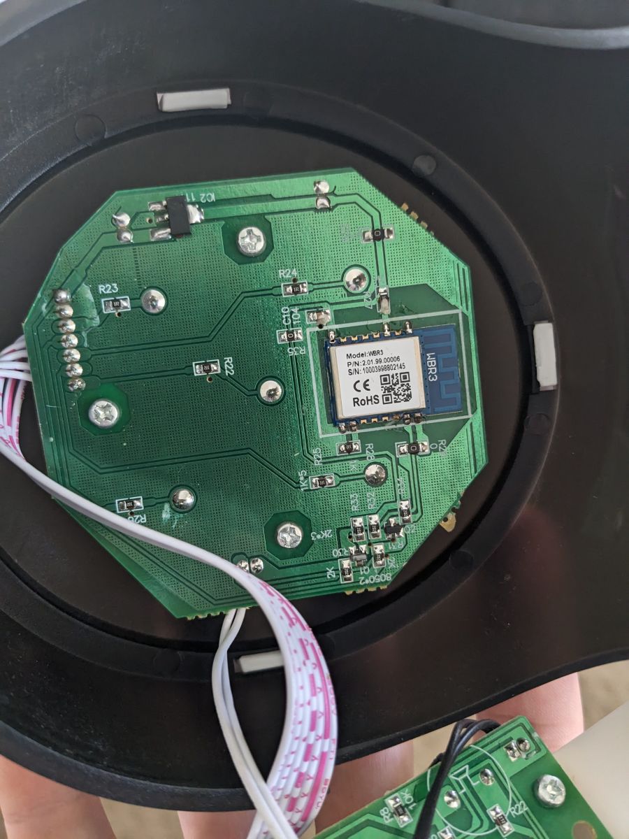

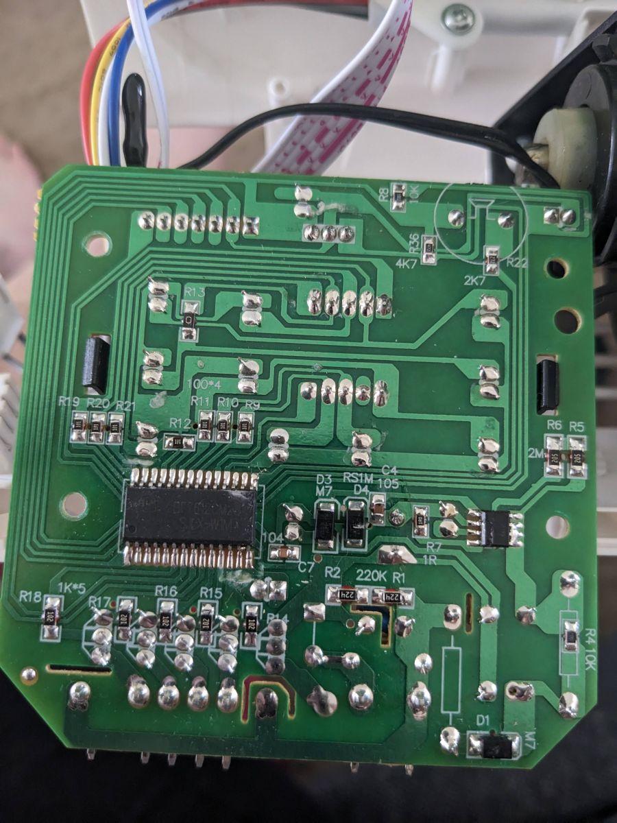

    Now, regarding the tower fan. Opening it up was actually very straightforward. Unfortunately, it has a WBR3 chip. I've never done any soldering in my life, so I'm gonna have to get some practice first before I think about swapping it out. However, if WBR3 gets official support in OpenBeken, that'd be awesome.
    I read that getting WBR3 chips on their own is quite hard. But I've found one available for purchase on Aliexpress. https://www.aliexpress.com/item/1005003735356193.html
    I understand that these are pretty rare and there are likely more urgent things to work on. But if donating a chip will help, let me know.

    ferbulous
    Posts: 419
    Help: 8
    Rate: 56
    Hot air would be easier for this.
    You could get a cheap hot air gun, point it to a soldering wire.
    Once it starts melting, that’s when you start heating up the pins around the chip and slowly lift the chip.

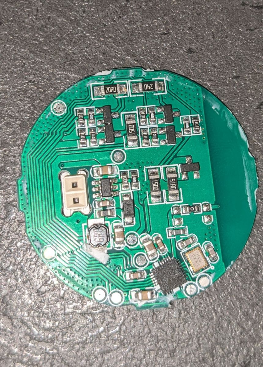

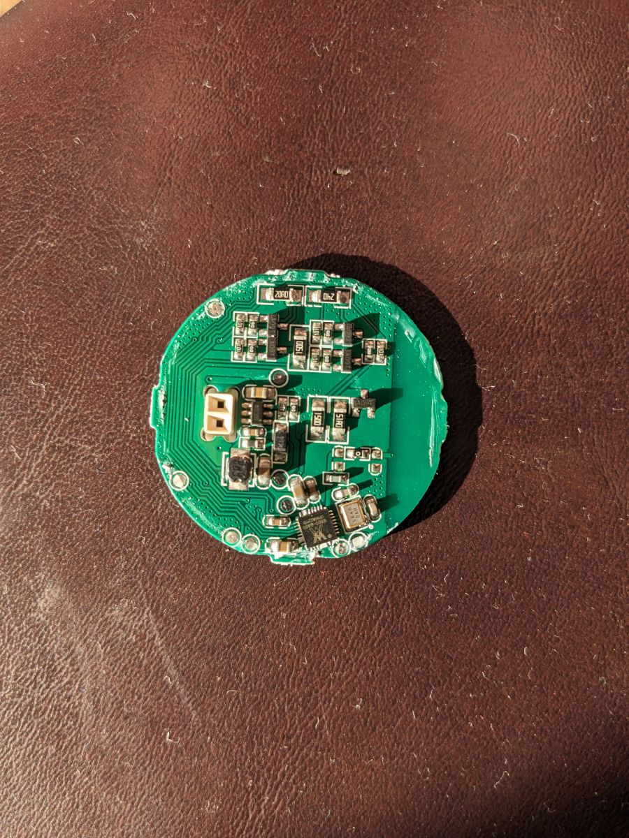

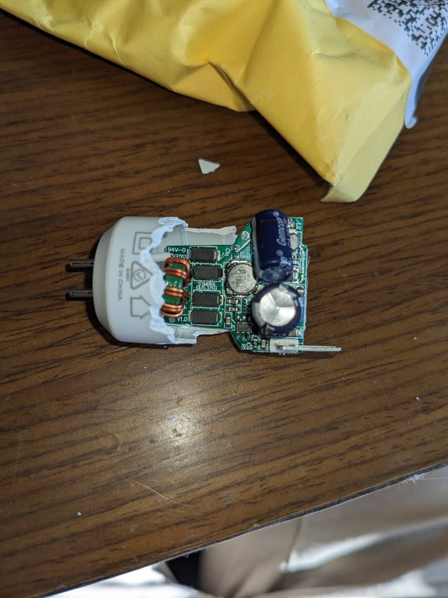

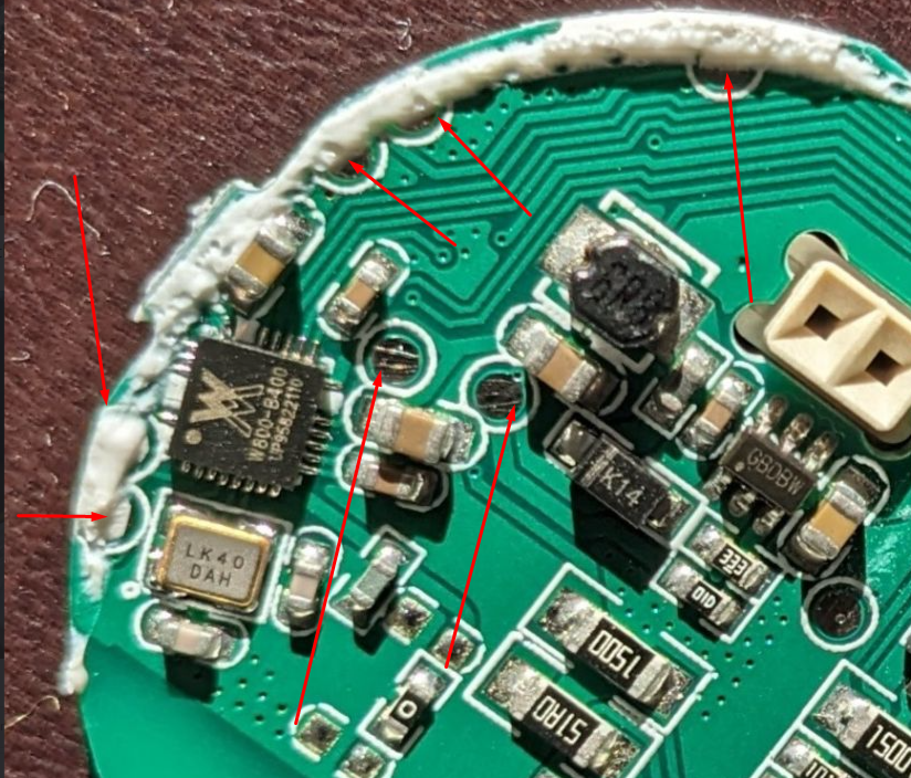

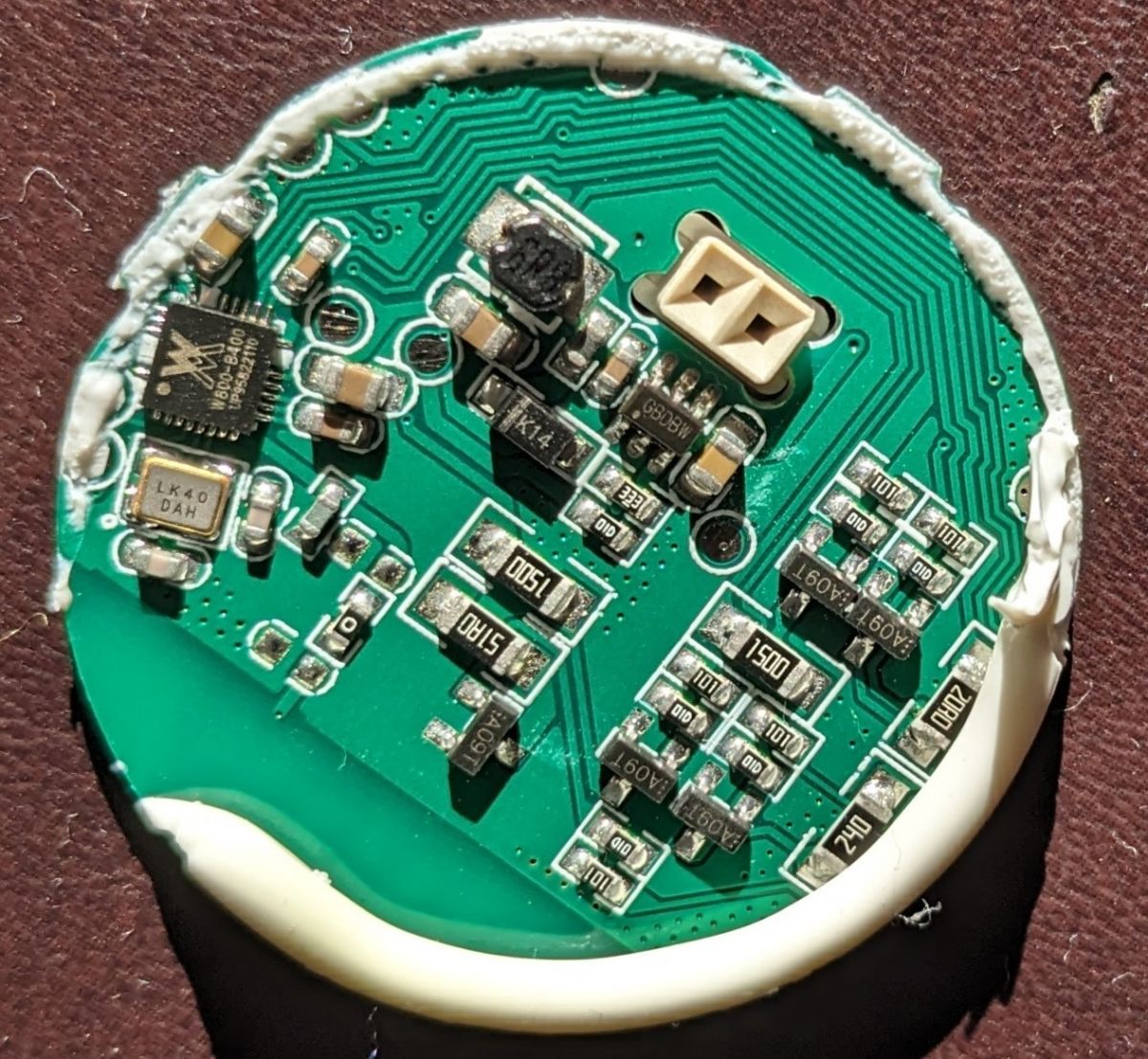

    I opened up the GU 5.3 Smart bulb. It has a W800-B400 Wifi chip. I've not heard of the B400 version mentioned anywhere, only the C400.
    Dismantled circuit board of a GU 5.3 smart bulb with W800-B400 Wifi chip.
    Can this be flashed OTA? If not I'm not even sure where to plug any serial adapters in.
    Person holding an open GU 5.3 bulb showing LED diodes and W800-B400 WiFi chip. Opened smart bulb GU 5.3 showing a circuit board with a W800-B400 Wifi chip.
  • #12 20724017
    Posts: 14797
    Rate: 12954
    There is no tuya_convert currently for W800, but OpenBeken runs on both W600 and W800 and once you flash once by wires, then you can update firmware remotely.
    It seems there may be UART pads on the board. Clean the board and do more detailed photo.

    Where would I attach the wires on this particular board?
  • #14 20724025
    Posts: 14797
    Rate: 12954
    It seems there are pads under the glue here:
    Close-up of a green circuit board with visible integrated circuits and glue, highlighted by red arrows.
    Can you remove the glue first so we can investigate?
  • #15 20724032
    BenAndo
    Level 4  
    Posts: 13
    Oh yes, you're right. There are pads there.
    Round printed circuit board with electronics on a dark background.
  • #16 20724057
    Posts: 14797
    Rate: 12954
    Can you get somewhat better quality out of it?
    We need to know where do they connect, namely to which QFN pins of W800 they are connected.
    It seems that... we also need to find a datasheet of W800-B400 or at least of W800-C400 .
    Interestingly enough, it seems there are no mentions of W800-B400 over the web?

    Yes, it seems W800-B400 is not mentioned anywhere on the internet. I guess I made a new discovery :)
    Below is a higher-res photo of the board.

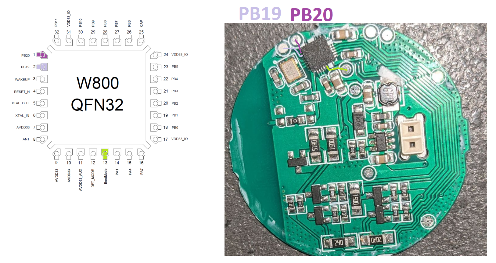

  • #18 20733926
    Posts: 14797
    Rate: 12954

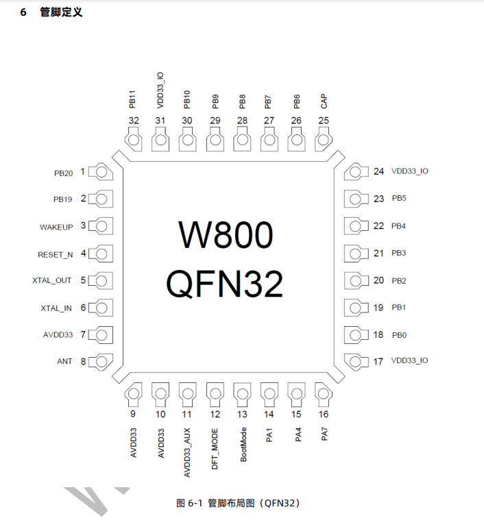

    Here is the pinout:
    Diagram of the W800 QFN32 integrated circuit with labeled pins.
    Now you can match crystal oscillator pins:
    W800 QFN32 pinout diagram next to a PCB image.
    i have started mapping the pins in paint, I've already found boot pin. Can you finalize the mapping?

    Regarding the tower fan, I desoldered the WBR3 and swapped it out with an ESP12-F.
