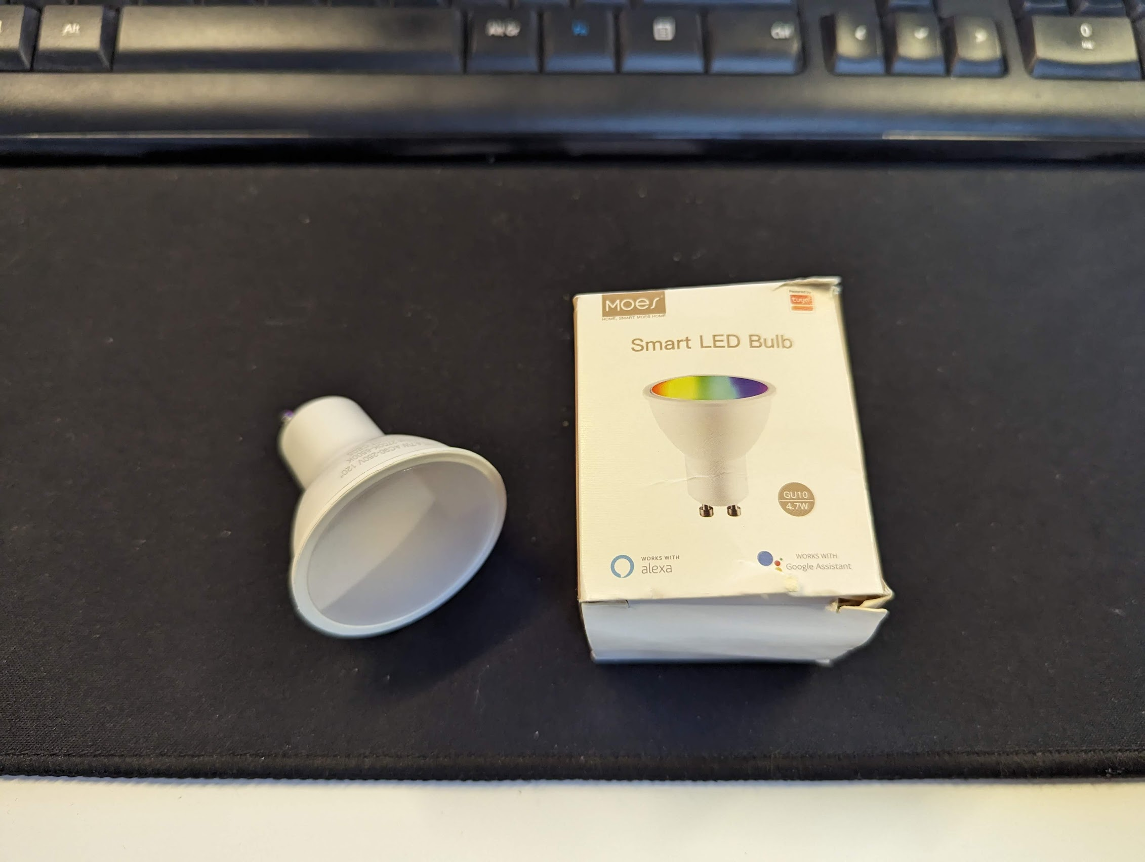

    I purchased these smart bulbs from AliExpress, assuming they'd be the WB-YL5 bulb that was flashed successfully in this Topic.
    Moes Smart LED Bulb WB-TD5-RWW-GU10-MS (BP5758): Flashing Troubleshooting & Tips
    I tried flashing them with tuya-cloudcutter but didn't have any success yet, so I opened one of them up. The front glass lifts off easily and there's a chip on the board that says BP5758. I didn't find a non-destructive way to remove the PCB.
    I connected one of them to the Tuya app and it shows the version 1.3.21.
    Can someone give me directions on how to go from here? I assume I'll have to dump the firmware first to go further?

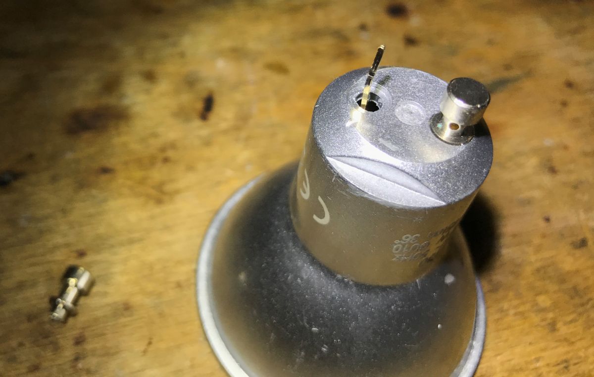

    I couldn't get the PCB to move at all from the top. How would I remove the pins from the bottom?
  • GU10 pins may be removable but risky
    #8 20449988
    Posts: 14743
    Rate: 12839

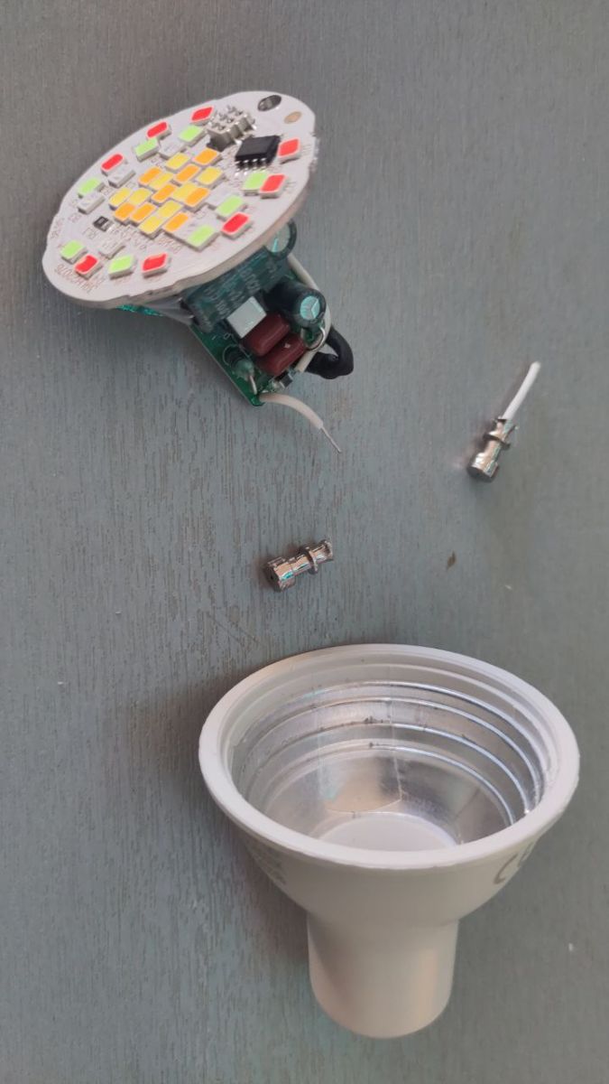

    GU10s are very problematic when it comes to this, but in theory, the pins should be removable:
    Moes Smart LED Bulb WB-TD5-RWW-GU10-MS (BP5758): Flashing Troubleshooting & Tips Moes Smart LED Bulb WB-TD5-RWW-GU10-MS (BP5758): Flashing Troubleshooting & Tips Moes Smart LED Bulb WB-TD5-RWW-GU10-MS (BP5758): Flashing Troubleshooting & Tips
    there is a real risk that the pin will not come back into it's place but I don't know any better method. It depends on the exact bulb model you have, some are harder to put back together than others

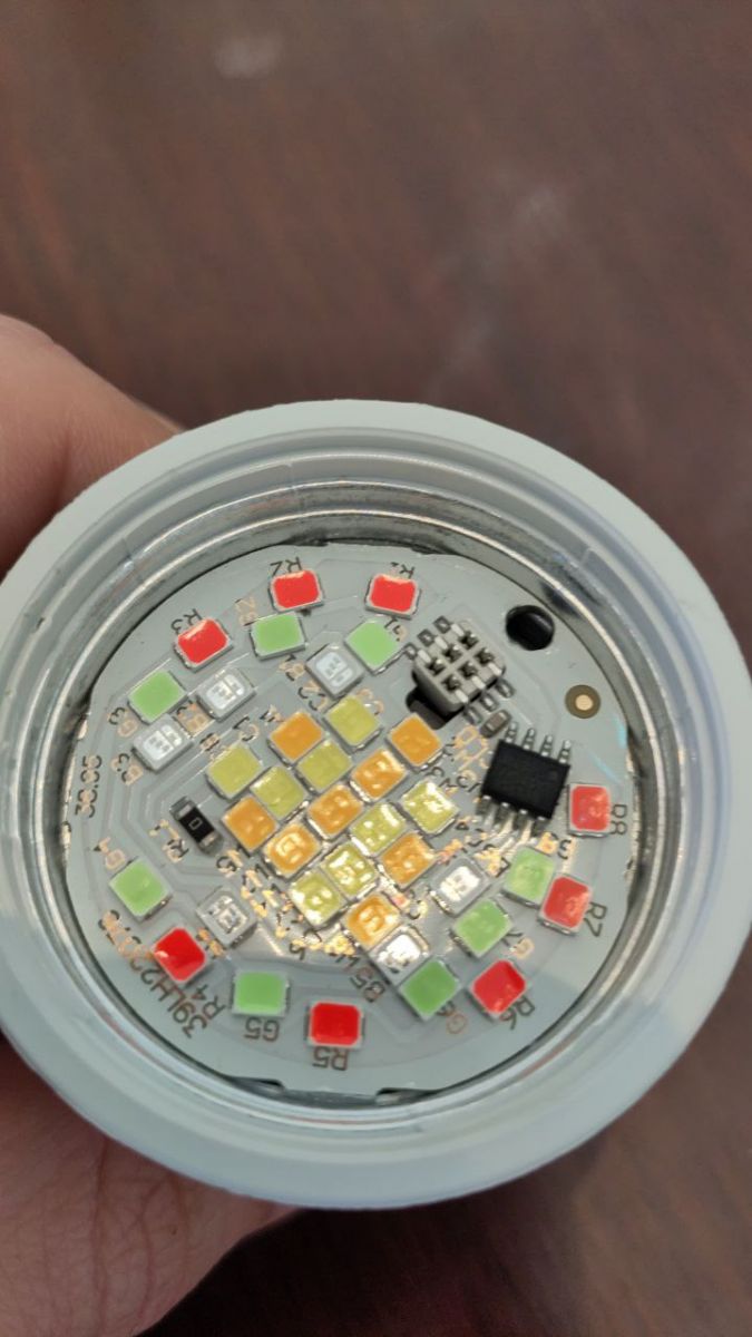

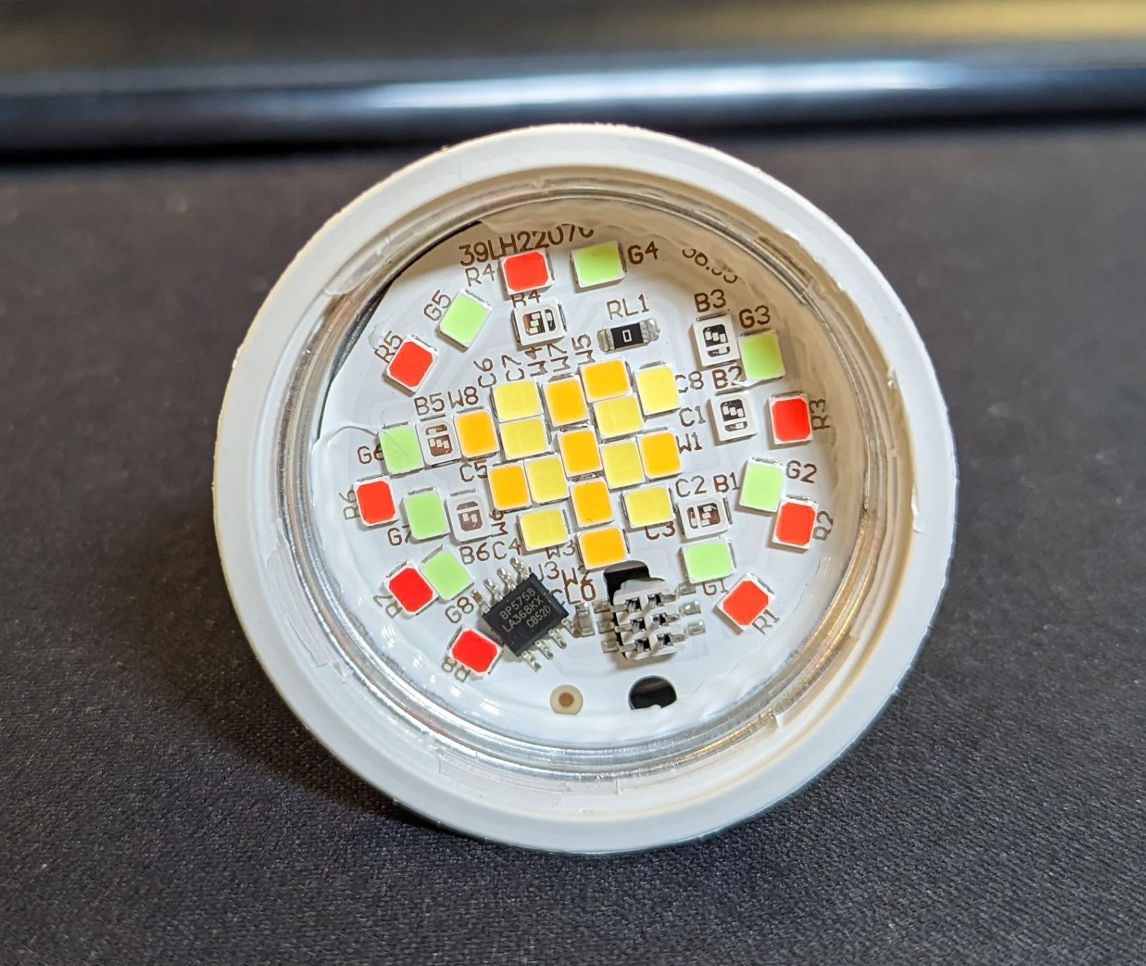

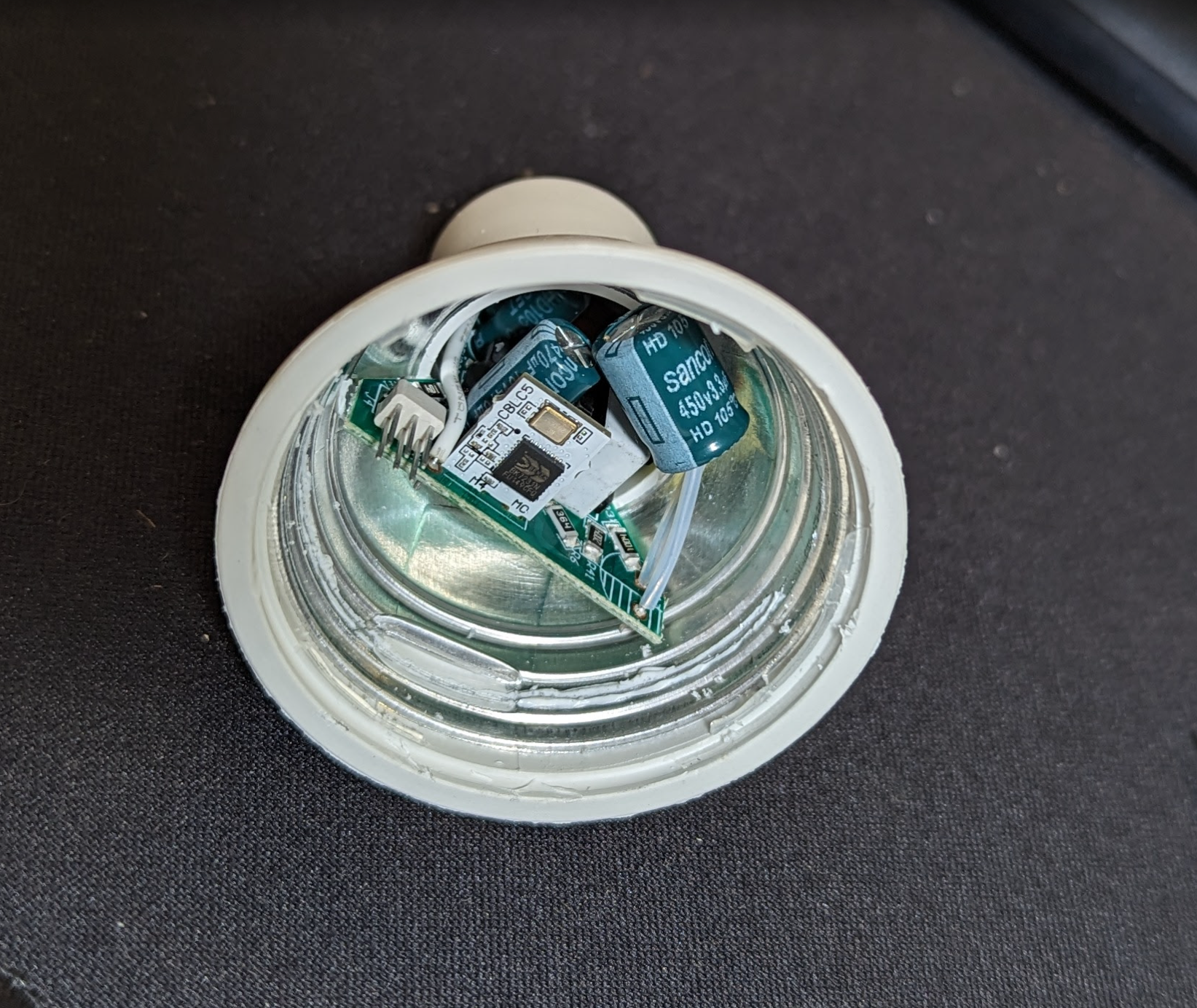

    I got one of them apart now and the Chip is BK7231N and the PCB says CBLC5.
    With that information, I tried to flash a firmware using the Immax 6W E14 bulb profile and it seems to work. Would a dump still be of interest though?
  • #10 20450654
    Posts: 14743
    Rate: 12839
    Huh, you are lucky, well done. If you've found a matching profile, then there is no real need to do the dump, maybe just to extract the pins config or something... BP5758 requires two pins, SDA and SCL and you need to know which pins are used for that.

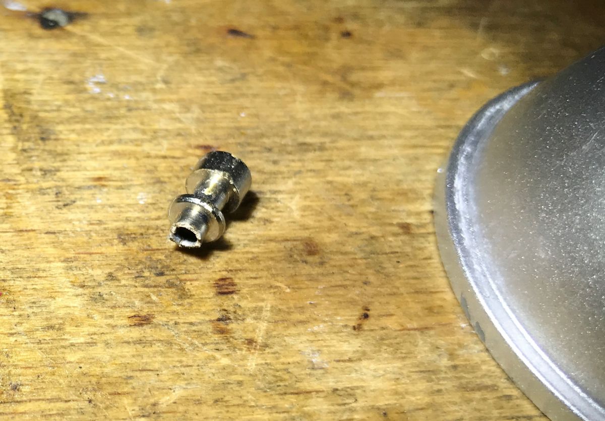

    @p.kaczmarek2 Is there something I can measure to determine the pinout before trying to reassemble?
    @ferbulous I twisted them with some pliers until they came off, the case didn't crack but I ripped apart one of the wires and a piece remains stuck in the "leg".

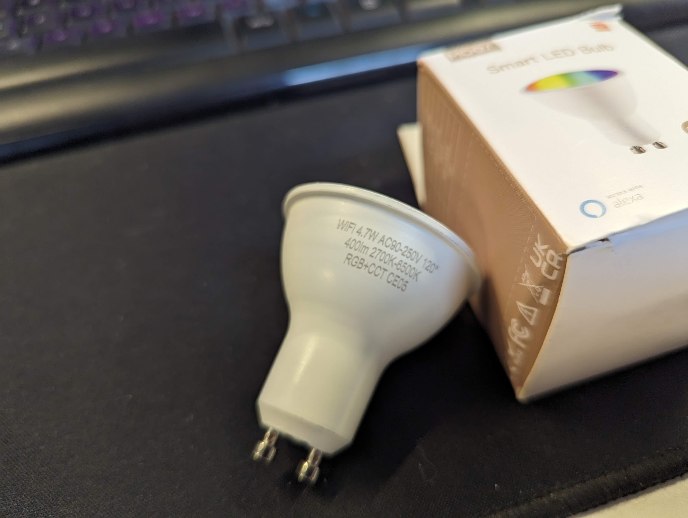

    I've got a very similar bulb - can't seem to flash it via cloudcutter.
    4.7W Moes RGB CW
    Tuya app gives version as 1.5.21
    Managed to do some dismantling.
    BK7231N on a CBLC5 board
    Any suggestions on profile? I don't mind sacrificing one bulb to dump the firmware but will that help me flash my other bulbs without dismantling?

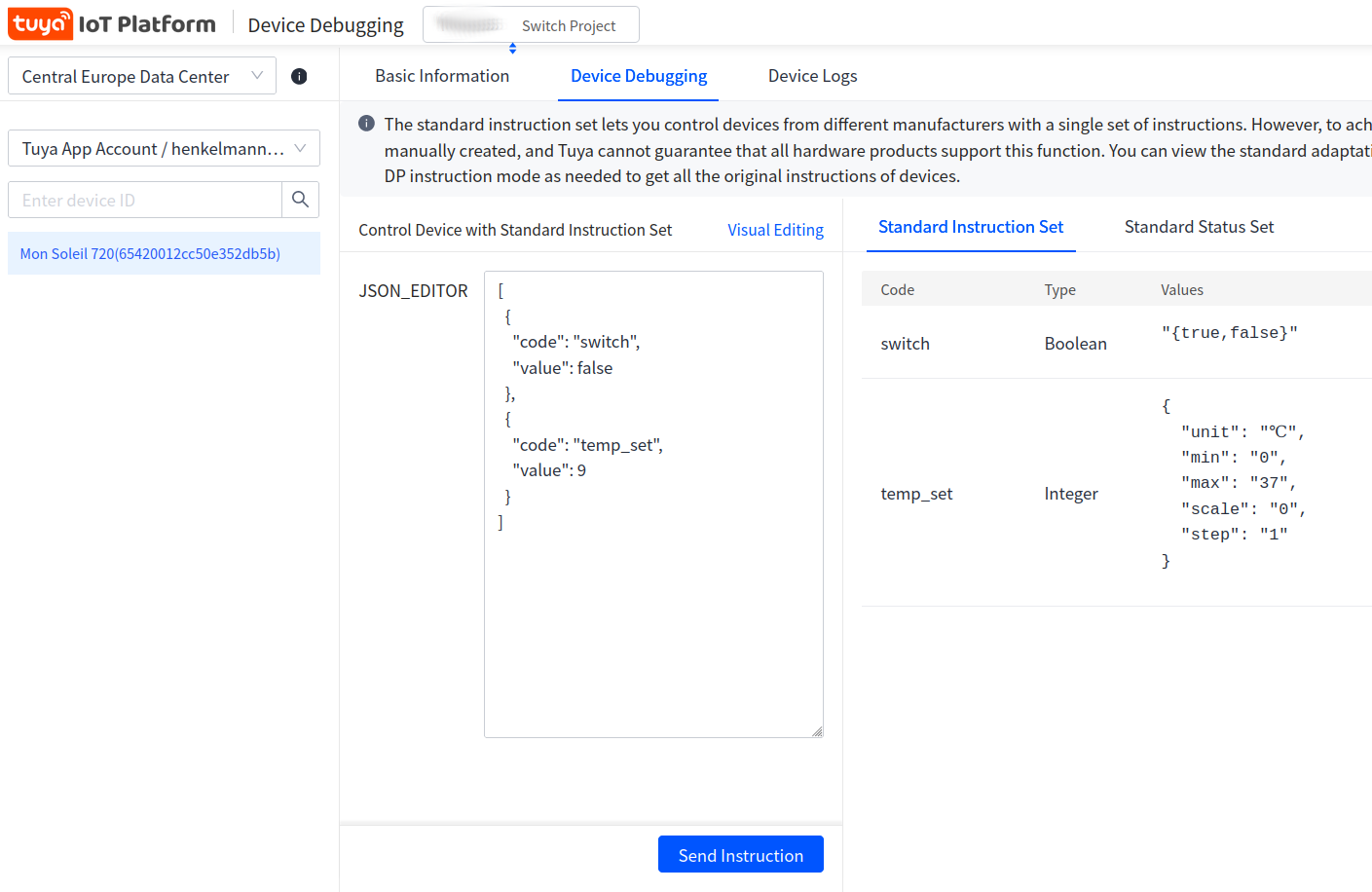

    Seems my lucky tuya cloudcutter streak is also over :/ the moes gu10 shown above used to have the tuya firmware 1.3.21 which seems to work fine, but it is now shipped with 1.5.21, which cannot be exploited with tuya cloudcutter which is why it is also not listed as an option in cloudcutter.
    Seeing how fragile these devices can be, I was wondering: Is there maybe a way to downgrade the firmware in tuya devices? Tuya offers this free iot developer platform and there is a page where you seem to be able to send instructions to devices (see image), which could potentially offer a possibility to downgrade to an exploitable firmware. I could imagine that for developers changing version needs to be an option, yet I haven't done enough research yet to know how.... maybe someone else did?
    Device debugging interface on the Tuya IoT platform with a JSON editor for sending instructions.

    On Reddit, someone suggested that I look into the profile builder and add the version I want upstream on the Tuya IoT platform... sounds promising that there might be a way. I hope I find some time during the weekend to look into that.
  • #30 20730094
    Posts: 14743
    Rate: 12839
    Interesting, I haven't tried that yet. But does it allow to downgrade the firmware?
