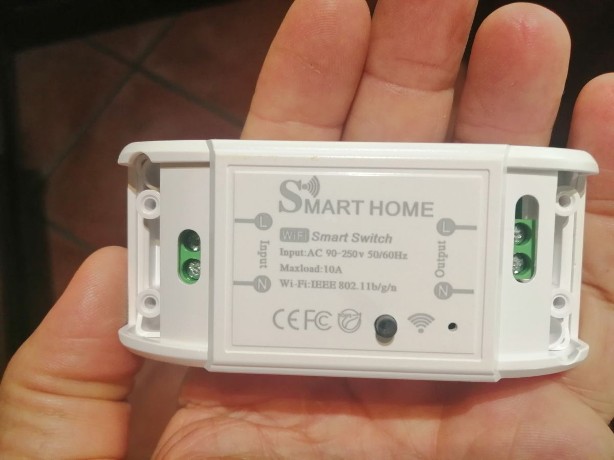

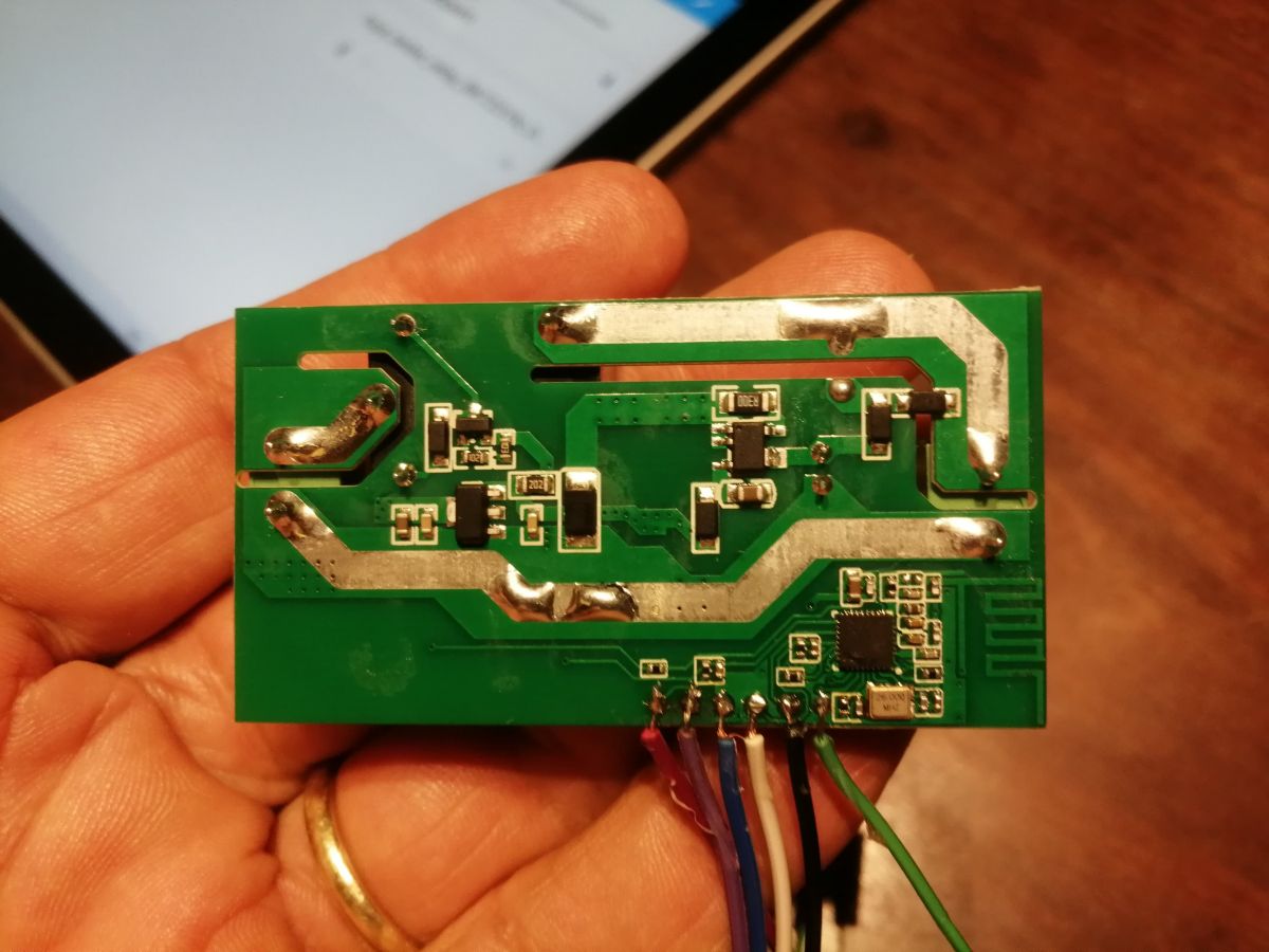

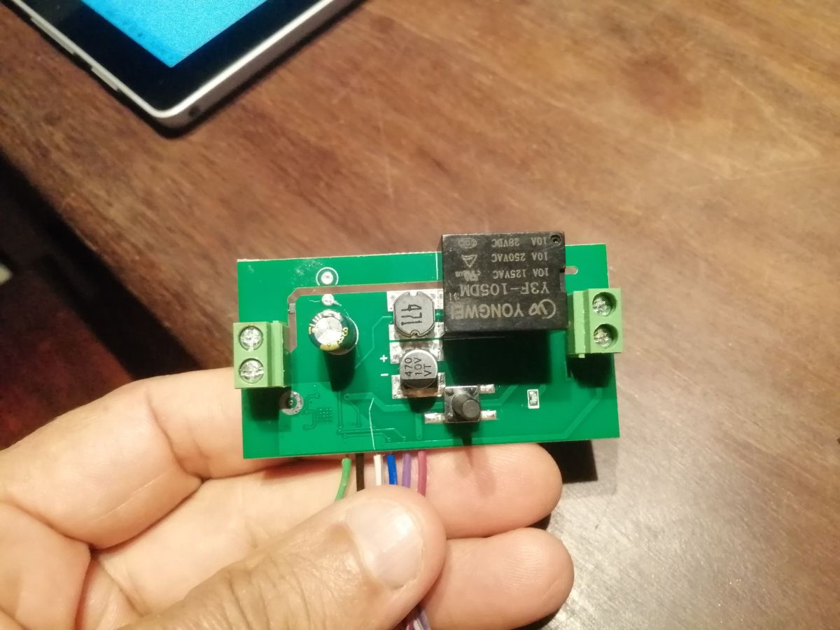

    if this can help someone, could not find this particular model in your database
    cheap: 3.5$ Amazon
    a simple relay switch Sonoff form factor

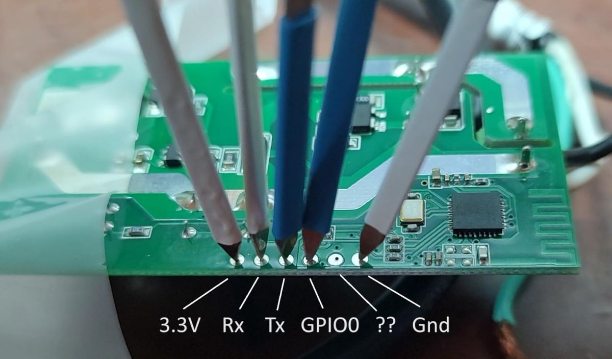

    NOTE: in the pinout image GPIO 0 = CEN
    uses BK7231N, and your firmware tool works perfectly on this device.
    love the HA discovery tool, thanks
    - Pair/Toggle All Button on P23
    - WiFi LED on P26
    - TglChannelToggle (channel 1) on P6
    - Relay (channel 1) on P7
    Device seems to be using CB2S module, which is using BK7231N.

    Thank you for sharing, but why did you mark GPIO 0 on Beken device? GPIO0 is only for ESP. By the way, I'm sure I saw this device in ESP version in the past. I recognize this board layout. We had user asking about it, here on forums.
    PS: Remember to enable PowerSave, this device has low quality power supply.
  • #3 21112641
    ehcabarete
    >>21112431i will make a new updated wire image, and i added a capacitor and varistors myself
