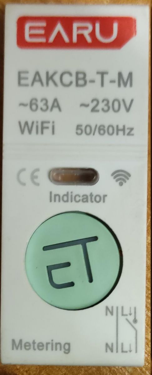

    I have a device as in the subject
    WiFi relay EAKCB-T-M labeled with EARU, showing technical specifications.
    the template fits from this topic
    https://www.elektroda.pl/rtvforum/topic3934580.html
    only the relay is on 12V
    CBU restarts after switching the relay, on Tuya was ok.
    After disconnecting the relay, there is no restart and the CBU remains connected to the wi-fi.
    Maybe someone can suggest something ?

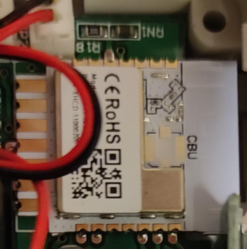

    Yes it's about the openbk, again I was imprecise, I will check today, and I wanted to add a capacitor under the Vcc CBU for testing.
    And if I may ask one more thing on the subject of the device.
    This switch in tuya had a temperature
    in the photo under the ADC there is a voltage divider and probably a thermistor, am I thinking right ?
    Electronic module with CE and RoHS markings and circuit components. .

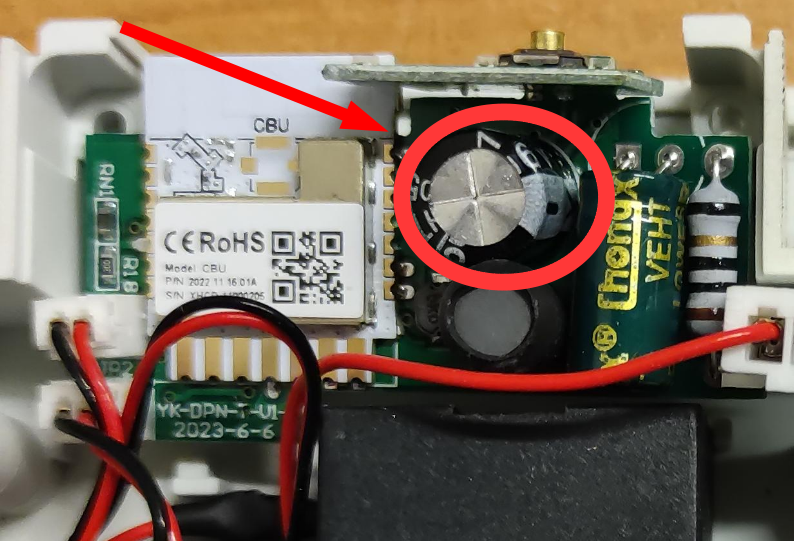

    And when it comes to
    PowerSave 1
    the reboots still occur
    once I managed to switch on and off, then reboots, I disconnected the relay and the CBU does not reboot.
    I wonder what's wrong with this power supply ???? I think I will throw in a capacitor

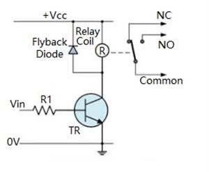

    It's strange, I've only had reports saying that PowerSave helps in this situation. And how many months old is this device? Maybe the capacitors have already flopped, like here:
    https://www.elektroda.pl/rtvforum/topic3898805.html
    Does the relay have a protection diode?
    Circuit diagram of a relay with a flyback diode.
    You could try with a capacitor...
    But it could also be a matter of how the bridge is used there, as it's probably not a typical relay there? I didn't have the device and haven't delved into how it works yet, the Bridge driver was made by @valeklubomir

    The equipment is new, on tuya it was ok. , but with Chinese capacitors it is known that it is sometimes different.
    I have seen implementations with relay 5V and 12V , I have an Earu for 12V and a Tongou for 5V, in addition to the performance of the electronics themselves I have seen two versions at home and one on the web.
    in both cases the relay is bistable and switched by a momentary change of polarity and left unpowered, I look at the photos and the diode is not seen, and probably should not even be there because in one direction would short circuit and the relay would not work at all, what happens to the impulse from the coil after disconnection of power supply do not know, maybe this bridge hardware somehow extinguishes it.
    Earu differs from Tongou by the board and the fact that additionally it has this thermometer.
    I have some ESR meter on atmeda, I will call the capacitors.

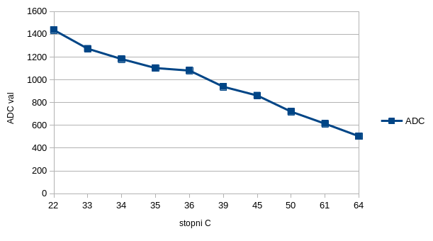

    Temperature comes out linear, with the increase of its value, the value of ADC decreases, so rather will not be a problem to run it.
    Tomorrow I'll upload tables with values and graph, and hopefully repair the via to run the contraption
    I have the values from ADC in relation to temperature change.
    stopnie C	ADC
    22		1437
    33		1273
    34		1182
    35		1103
    36		1081
    39		939
    45		862
    50		720
    61		614
    64		504
    Graph showing the relationship between ADC values and temperature in degrees Celsius.
    #### as for restarts
    With the pulse length there may be something to it, on the original Tuya there were no resets.
    I soldered 2.2u/400V - still the same
    I soldered 220u/35V - still the same
    I unsoldered both capacitors

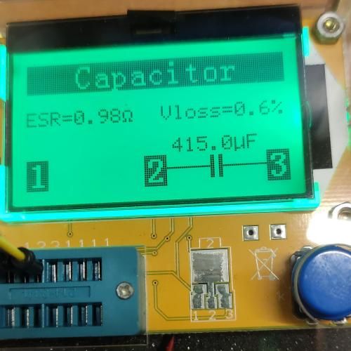

    I started to measure the original ones: 4.3u and 415u - so-so

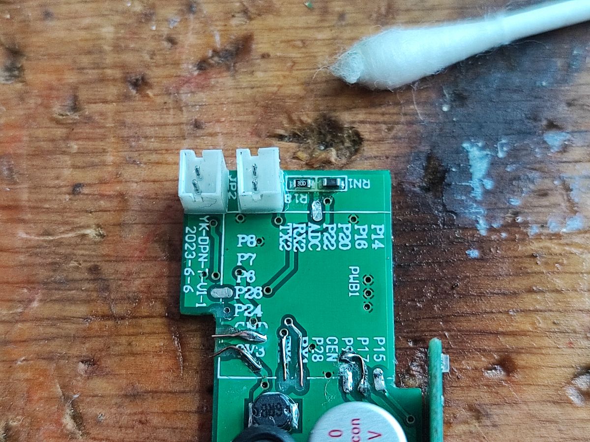

    I soldered them back
    then I switched pins
    "24": "BridgeFWD;1",
    "26": "BridgeREV;1"
    on
    "24": "Rel;1",
    "26": "Rel_n;1"
    the relay started to be powered all the time , not just at the moment of switching
    the power supply became loaded in continuous mode, I had a pyrometer and thermocouple at hand
    I measured the 470u/16v capacitor in the configuration for bridge operation had about 30 deg.C
    Close-up of the interior of an electronic device with a highlighted capacitor. Capacitor tester display showing ESR and Vloss values.
    with the relay continuously energised, after a few minutes of lying around and my deliberation it warmed up to 50 deg.C and voilà
    interesting fact I soldered 220u to it and the device continued to make resets when switching on the relay, I threw it out completely because I found that it has a small internal resistance, I had 2x220u on hand, which I soldered briefly and the restarts stopped
    now I'm waiting for a new capacitor, unfortunately it must be fi8 x 8mm high
    if I manage to do something with this temperature reading after the ADC , then it will be possible to make a template

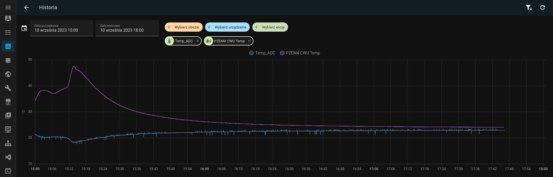

  • #14 20728658
    przemsi_ele
    Posts: 62
    Rate: 15

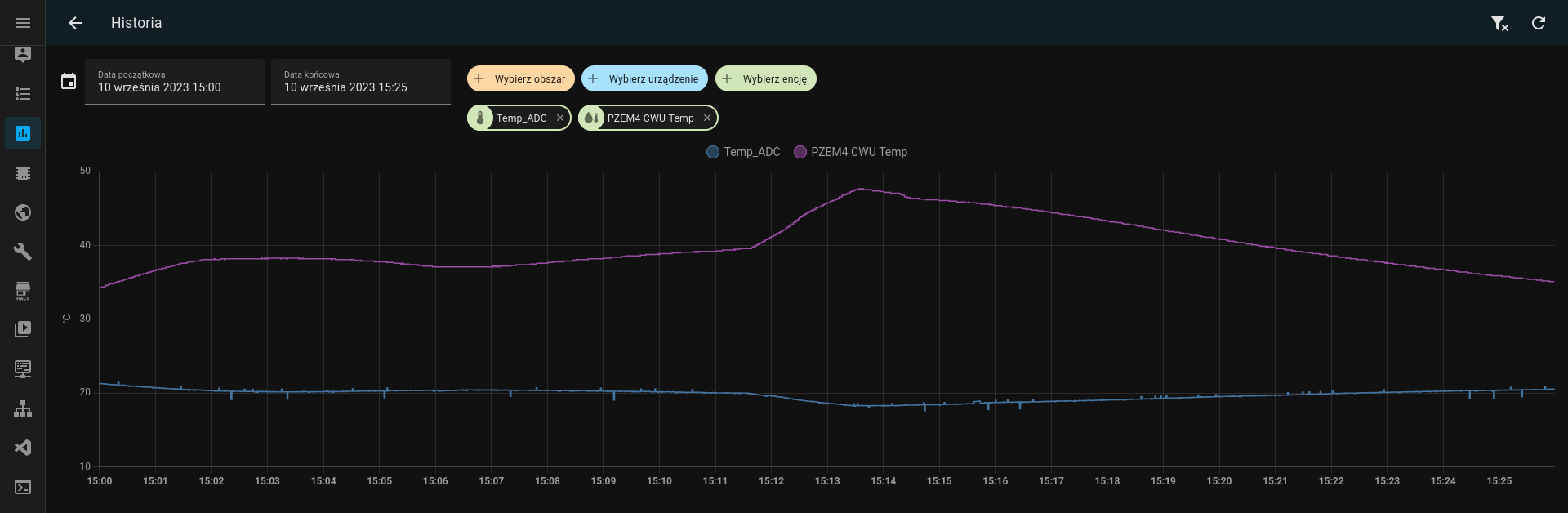

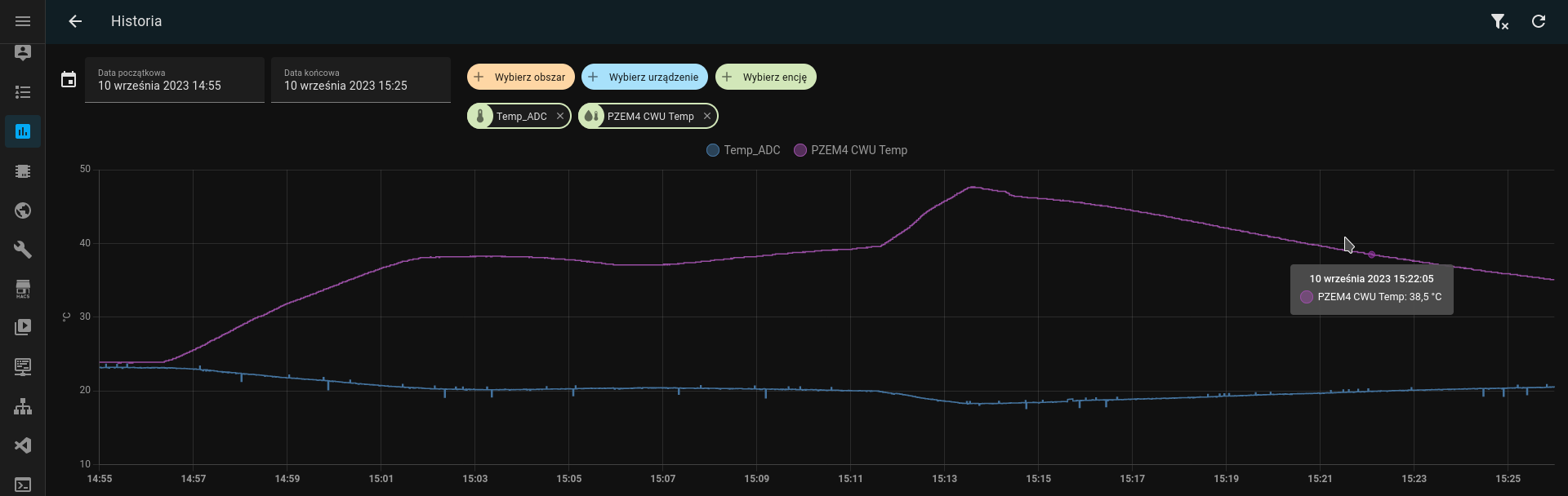

    I managed to do something like this, but I haven't yet figured out how to make a data table out of it (export from HA to table :) ).
    Into the electrical box I put the guts from the switch and DS18B20 from another thermometer , then slowly heated the closed box. The only thing was that I multiplied the reading from the ADC * 0.01 and then added 10, so that the ADC values and the real temperature were not so scattered along the Y axis of the graph.
    Temperature chart showing Temp_ADC and PZEM4 CWU Temp readings over time.
    Temperature graph from Temp_ADC and PZEM4 CWU Temp sensors over time.
    Graph displaying temperature changes recorded by Temp_ADC and PZEM4 CWU Temp sensors.
    from this graph I will manage to do some mapping of ADC values to temperature

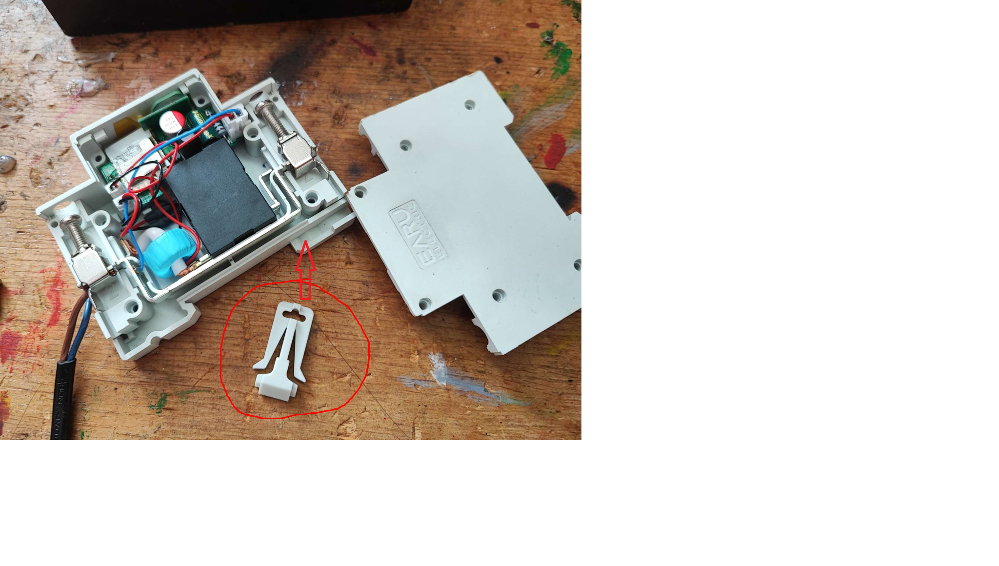

    Posts: 14649
    Help: 655
    Rate: 12661

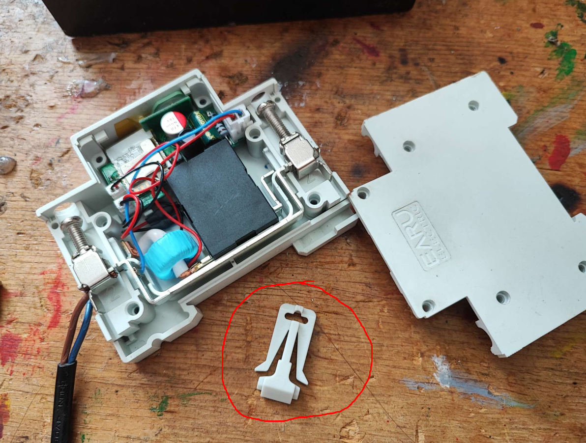

    I'm assembling this relay from you, I've repaired the tracks, but maybe do you know where the plastic part was?
    Open relay with visible electrical components and a plastic clip nearby. .
  • #21 21179231
    tos18
    Level 42  
    Posts: 7077
    Help: 1097
    Rate: 1841
    Disassembled electrical box with a red-circled plastic component. .
  • #22 21179251
    Posts: 14649
    Help: 655
    Rate: 12661
    Thanks, that is indeed it.
    I fixed the paths and the unit started up, indeed, even with PowerSave 1 when switching the relay a reboot can happen. I will just look for the cause and check the capacitors. Maybe the pulse timing needs to be changed, although it works fine on other devices:

  • Measured capacitor values were about 4.3uF and 415uF after desoldering, versus nominal 4.7uF/400V and 470uF/16V parts, and the board still reset during relay switching. [#20725555]

  • One heating test produced ADC readings from 1437 at 22°C down to 504 at 64°C, showing that higher temperature lowered the ADC value. [#20725555]
