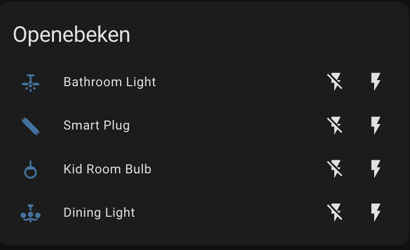

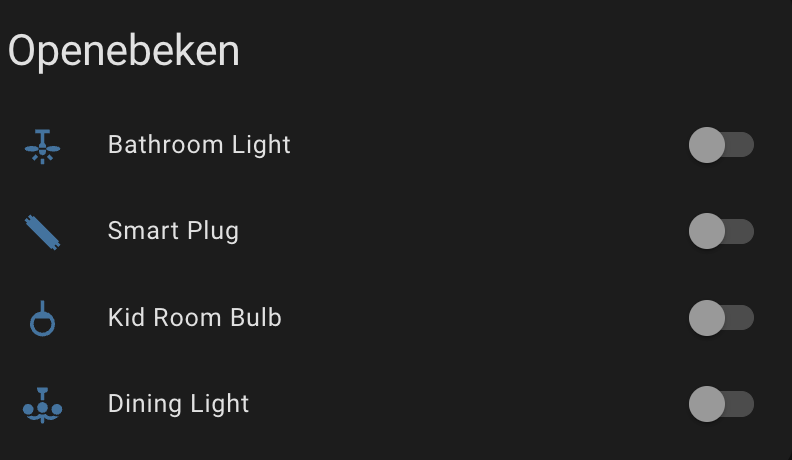

    Hi team,
    Every time when I restart Home Assistant, I have observed that all my Openbeken devices show multiple switch (energy) toggle icons, as seen in the below screenshots, this goes off and moves back to normal single switch toggle once I click on either one of the two toggles.
    Openbeken interface showing devices with toggle icons.
    Display of Openbeken devices with light switch and plug icons.
    How do I sort this?

  • Issue does not affect switches converted to lights

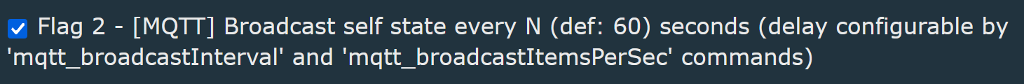

    I noticed this issue too, enabling Flag 2 helped solve it for now
    Screenshot of Flag 2 settings for MQTT, showing it is enabled.
    But with Tasmota, devices' states are shown within seconds after Home Assistant boot.
    But with Tasmota, devices state are shown within seconds after homeassistant boot
    Thanks, enabling Flag 2 has helped, the response is slow after reboot, but it's a workaround for sure.
    if flag 2 helps, then maybe "broadcast self state on connect" can also help?
    Broadcast self state - Flag 10 is by default enabled on all my devices... but it hadn't solved this issue for me..
    so enabling both Flag 2 & 10 is fine ?

What does OpenBeken Flag 2 do, and why does enabling it help with wrong or delayed switch states after Home Assistant restarts?
In this thread, Flag 2 acted as a practical workaround because it made affected devices recover their visible state after HA restarted. One user explicitly said enabling Flag 2 solved the problem “for now,” while another confirmed it helped but still felt slower than Tasmota after reboot. That makes Flag 2 useful when you want a device-side fix before adding HA automation. [#20743791]

Why do OpenBeken devices return to a normal single toggle after I click one of the duplicated controls in Home Assistant?
They return to one toggle because your click forces a fresh MQTT state update, which makes Home Assistant redraw the entity correctly. Multiple users observed the same pattern: the duplicate control appeared only after HA reboot and disappeared after toggling from Home Assistant. That behavior fits a stale-state display issue, not a permanent entity duplication. [#20734156]
