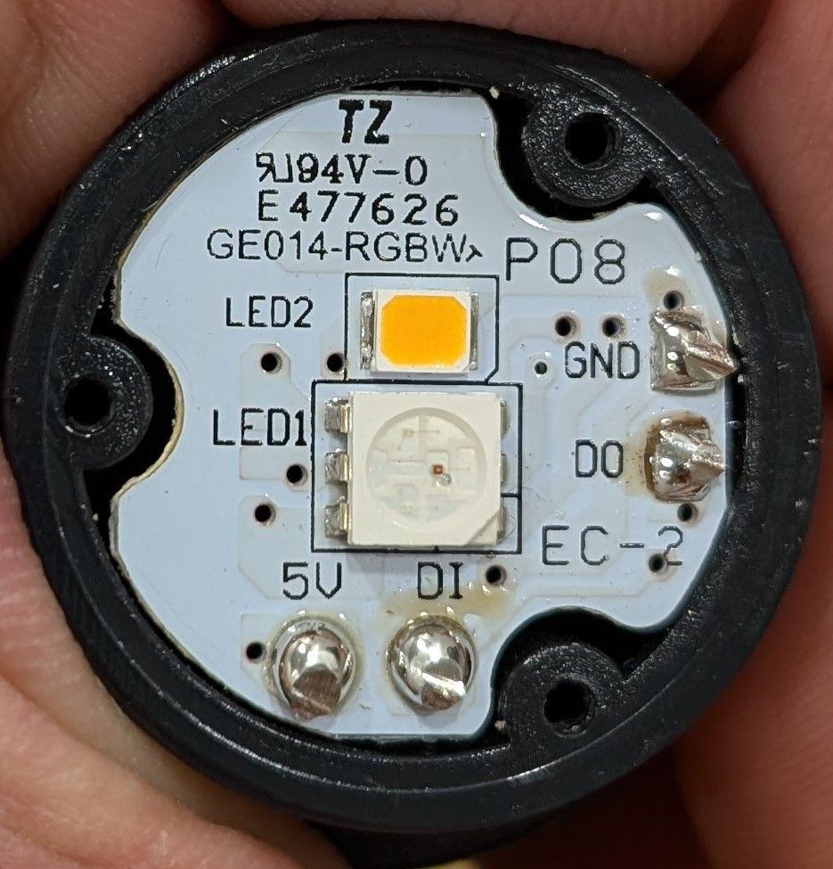

    My goal is to get all functions of these lights working locally in home assistant.
    Jasco Enbrighten Café WiFi lights are sold in 12 and 24 strand sets. This teardown is for the 12-strand set, but I presume the 24 strand set is similar. They are controlled by the Tuya cloud with a custom app written by Enbrighten, but of course can also be fully controlled by Tuya Smart which is what I will be using in the teardown.

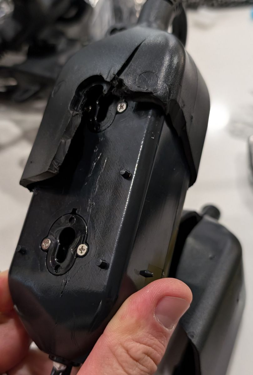

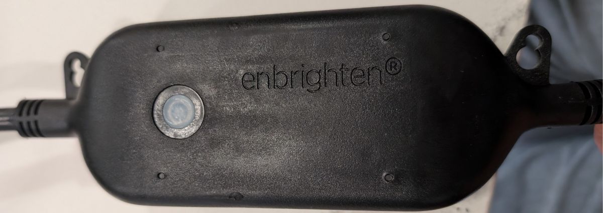

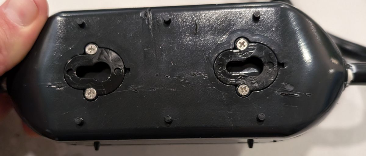

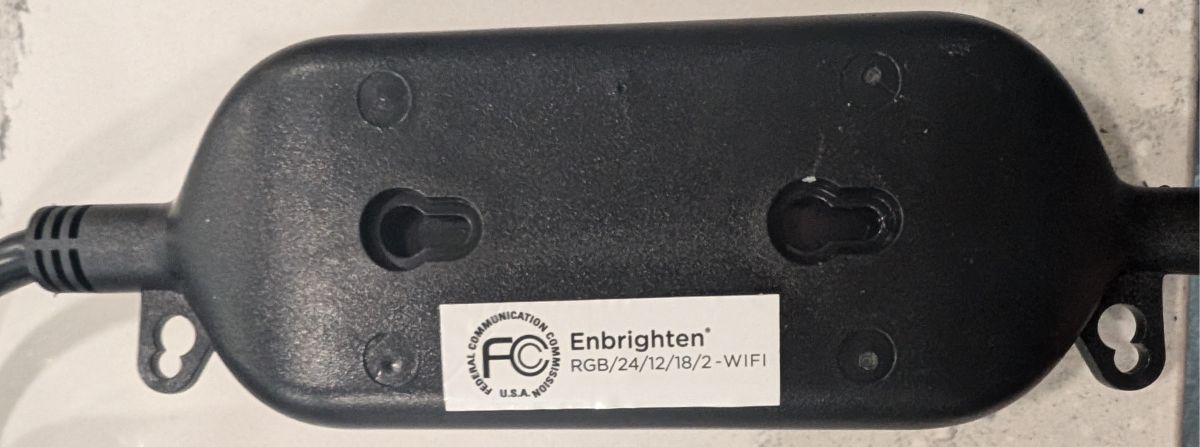

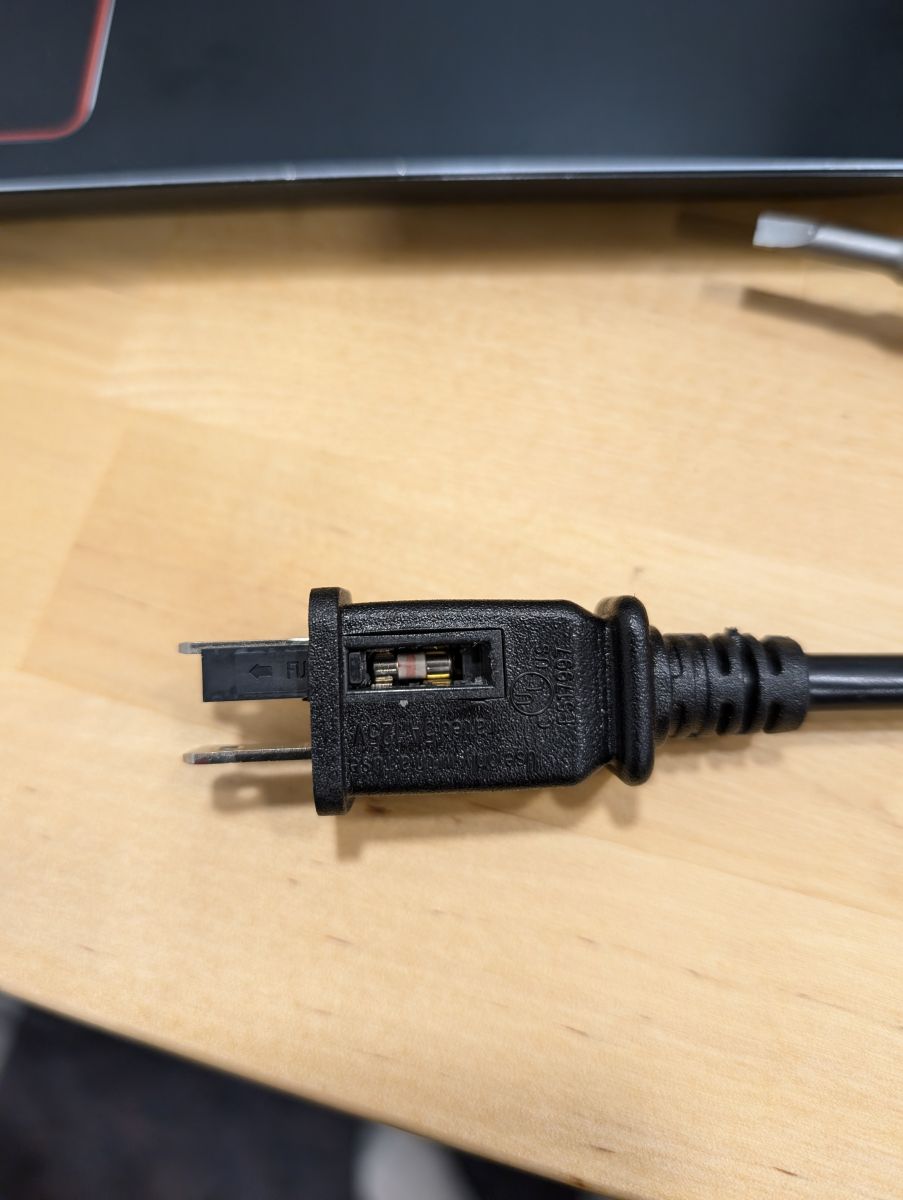

    The plug on the power cord has a 250V5A glass fuse. The plug connects to a large enclosure by 18" of 18AWG 2-wire cable. The enclosure is wrapped in thick rubber via an injection molding process - presumably for waterproofing. The rubber was thick and difficult to cut, but thankfully not adhered to the plastic enclosure. Once the rubber was removed we can see several screws that need to be removed to gain access.
    Plug with removable fuse in power cord. Black casing with Enbrighten sticker and FCC markings. Black enclosure of Enbrighten lighting module with a button and logo. Close-up of the Jasco Enbrighten Cafe WiFi lighting housing with an exposed section under the panel. Unscrewed device housing with visible screws. Part of a black lighting module housing with visible screws and a button on the panel. Close-up of a black housing with two screws on the side.

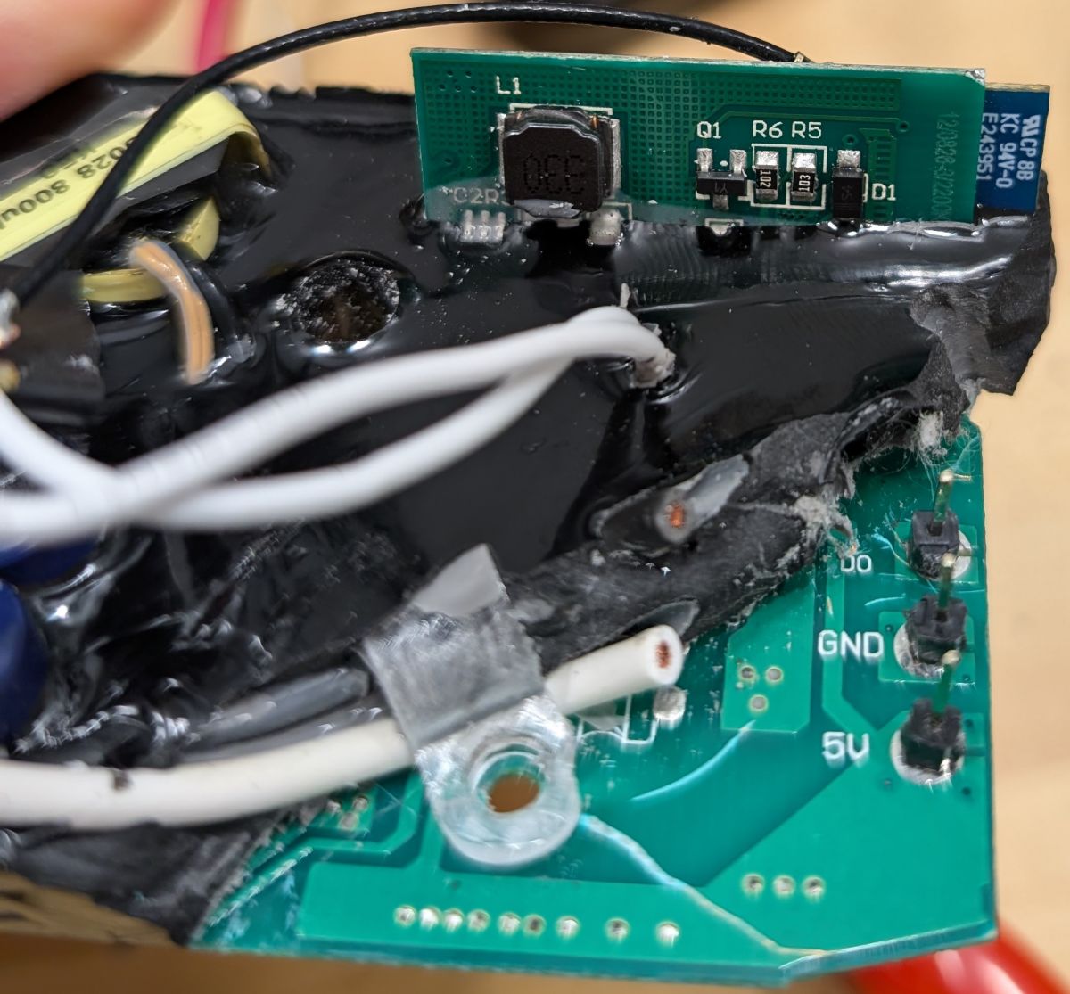

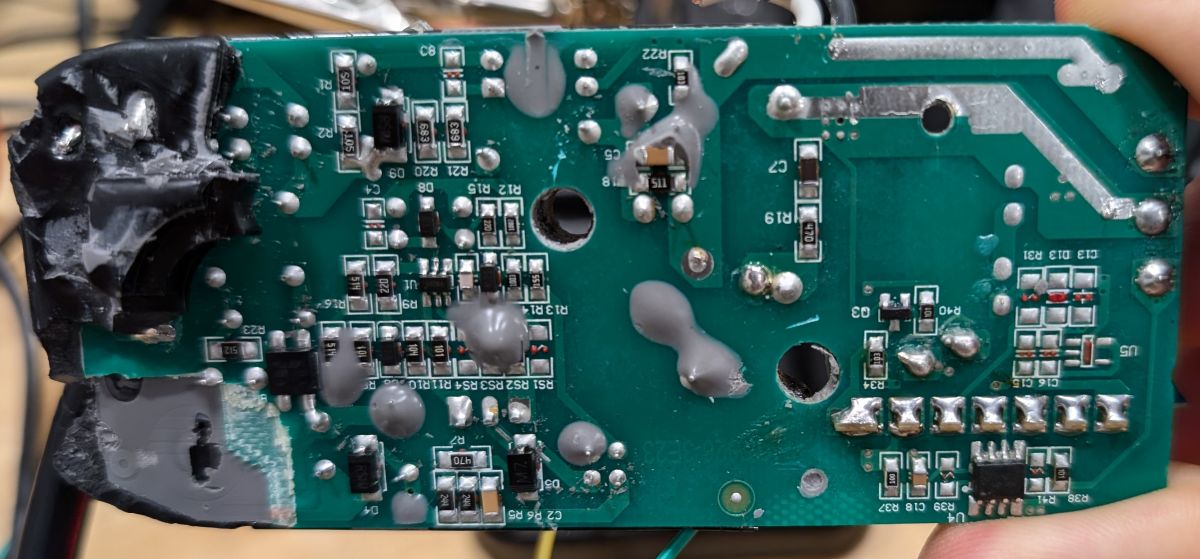

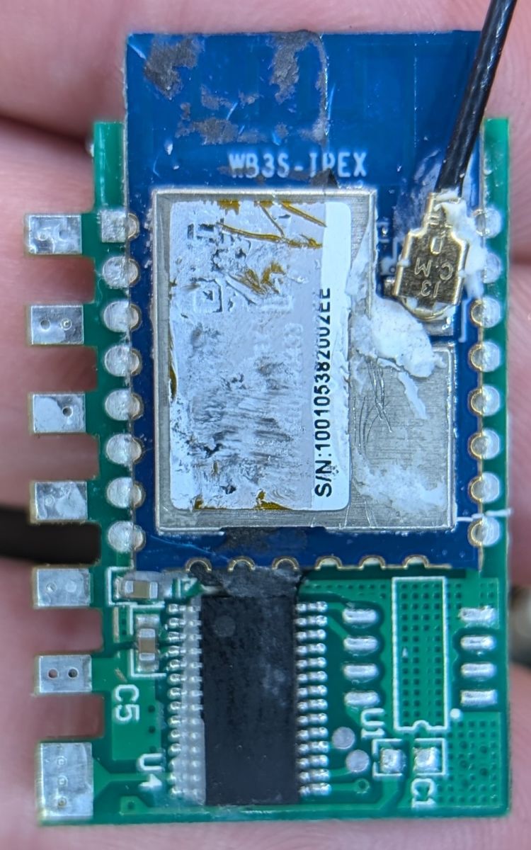

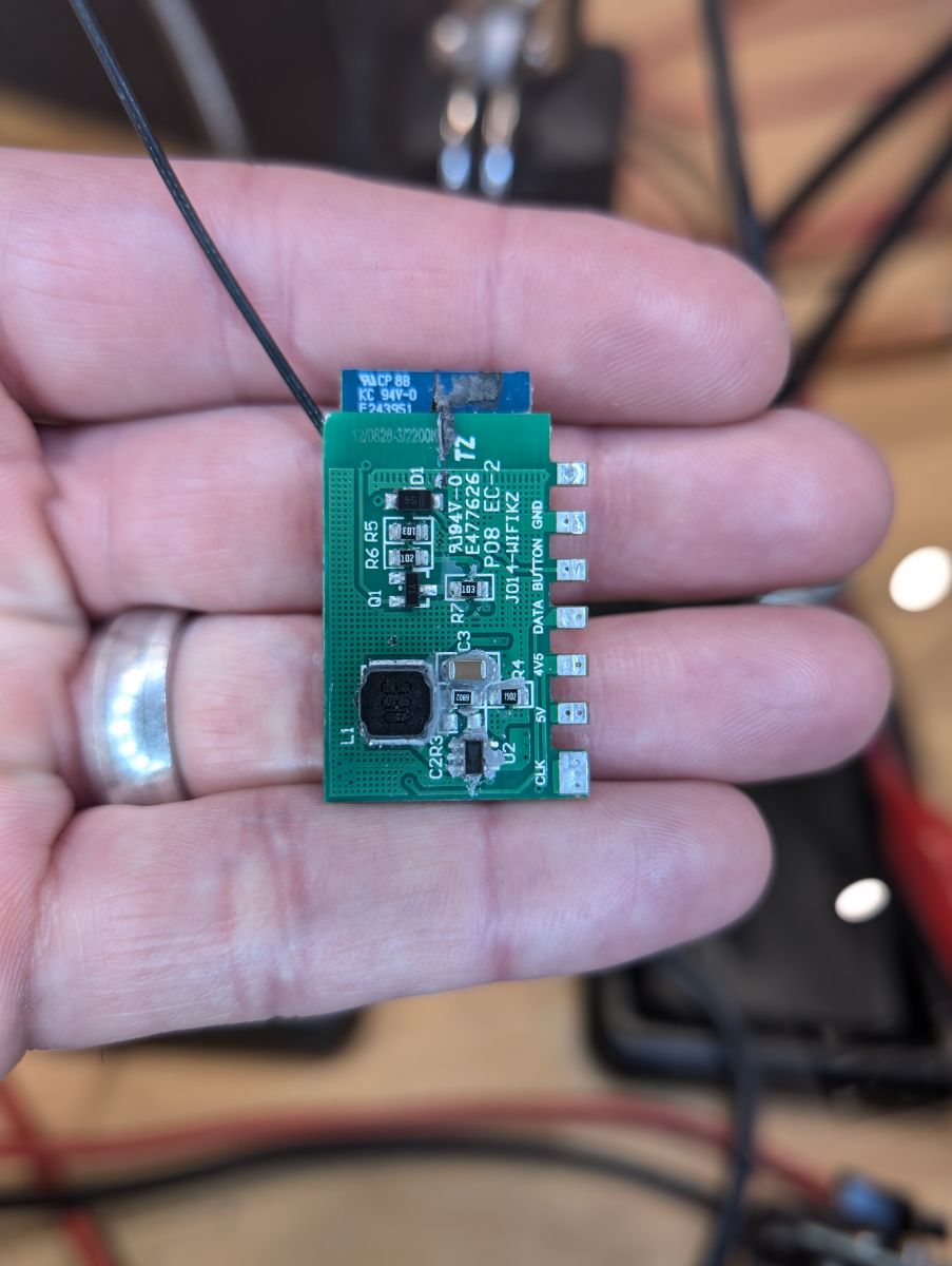

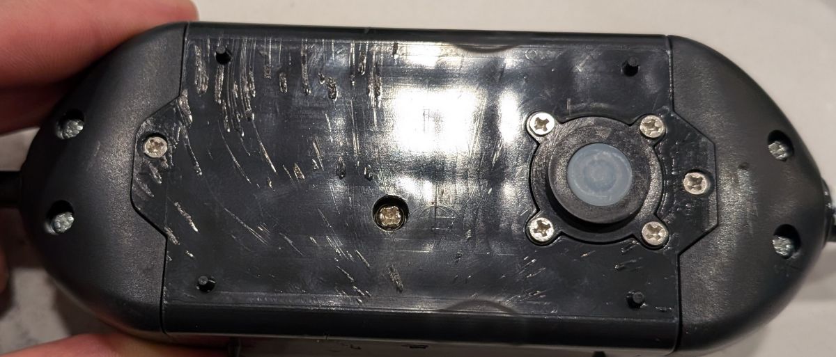

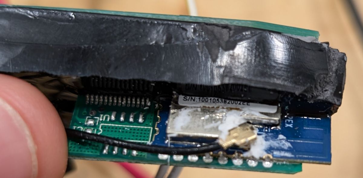

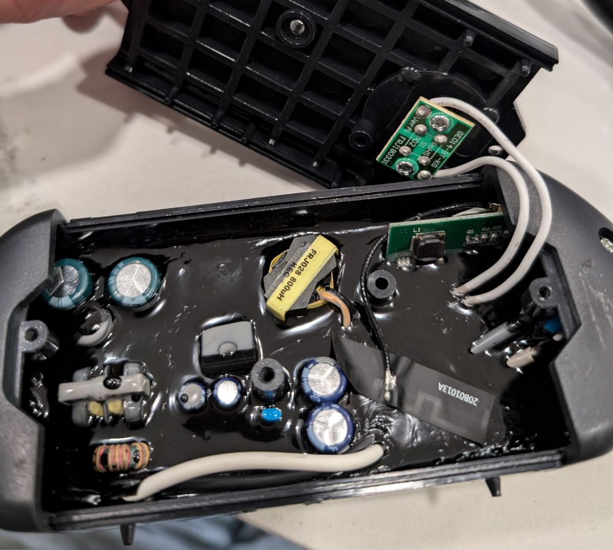

    The enclosure contains the power supply, a daughterboard containing a Tuya WB3S-IPEX wifi module with external antenna and an unlabeled MCU, and a 2 wire button that shorts to enter pairing mode (long-press) or manually cycle through colors (short-press). The motherboard is secured to the bottom of the enclosure with two screws and was then filled with 10mm of epoxy - presumably for waterproofing. Note in the last photo I had already removed the wiring going to the lights and installed header pins.
    Interior of disassembled Jasco Enbrighten Cafe WiFi light casing with visible electronic components. Close-up of a Tuya WB3S-IPEX module with visible solder connections. Close-up of a circuit board with electronic components, including the Tuya WB3S-IPEX Wi-Fi module.
    The hard epoxy obscured almost everything. It was very difficult to remove the motherboard from the enclosure. After much prying and cutting I was able to remove it, but in the process I damaged part of the high voltage power supply. Once removed from the enclosure, I was able to use a heat gun, knives, scrapers, and plastic trim tools to remove enough epoxy from the motherboard to see the necessary low voltage components. I discovered I was able to back feed 5V and ground on the low voltage wires heading to the lights to get everything to function - hooray! I plan to repair the power supply or just feed the lights with an external supply.
    Close-up of the WB3S-IPEX Wi-Fi module on a green circuit board with attached antenna. PCB of Jasco Enbrighten Cafe lighting with visible electronic components. Electronic module in a person's hand showing the Tuya WB3S-IPEX chip with an antenna. Close-up of a circuit board with wires and exposed electronics. Image of a circuit board with visible components and traces of removed epoxy resin.

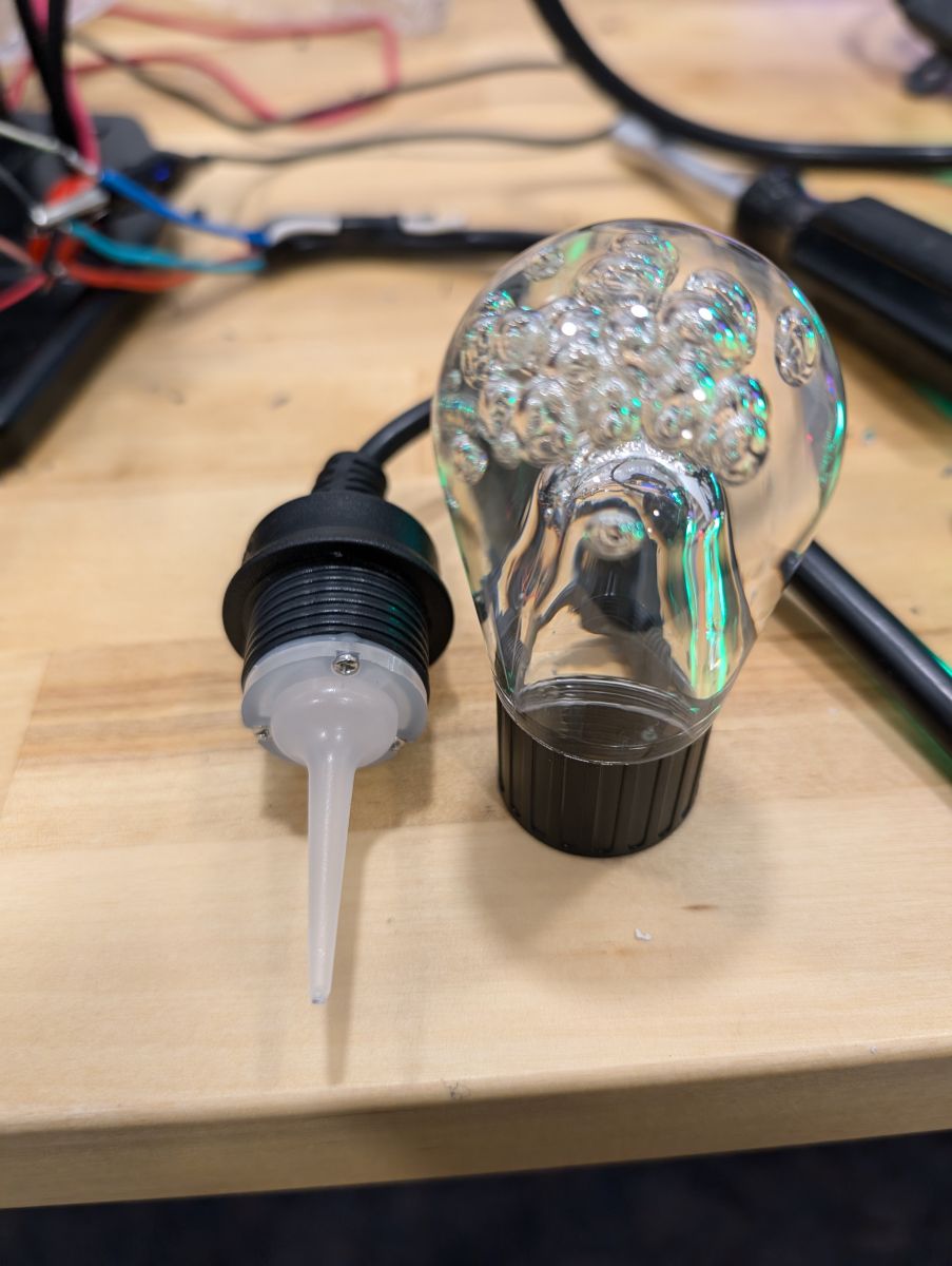

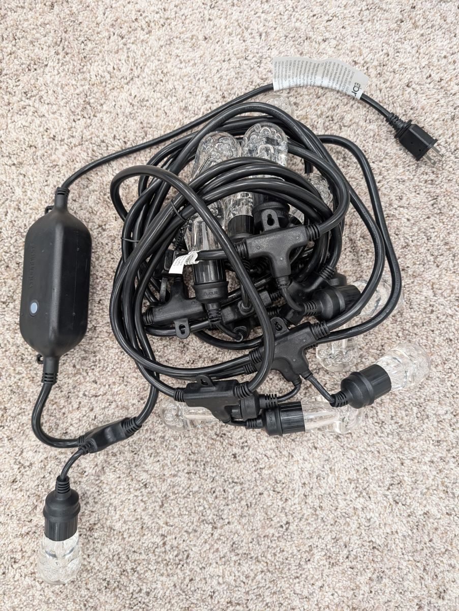

    The other end of the enclosure connects to the lights via a main cable. The main cable is 5-wire 18AWG and very thick. Two wires (black and white) are mains passthrough to the female plug on the end of the strand. The other three are 5V (red), ground (green), and data (blue). Each bulb tees off the main cable with a smaller diameter 4-wire 20AWG cable containing 5V, ground, and two data lines for daisy chaining Din and Dout to each bulb.

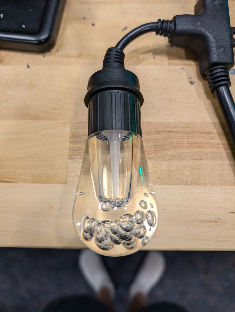

    Jasco Enbrighten Cafe WiFi bulb with a clear lens, visible during disassembly. Jasco Enbrighten Cafe light with cable on wooden table
    Each bulb unscrews to reveal a translucent dispersion lens secured to the base by three screws. There is a rubber gasket between the lens and base. The LED PCB has a RBG LED and a white LED. We can also see 5V, Din, Dout, and ground terminations from the 4-wire cable. The backside of the PCB contains an IC labeled OT1024B and what looks like FAZ1-7491MT along with various resisters and components. I was unable to find documentation on the IC. If you can find something, please share!

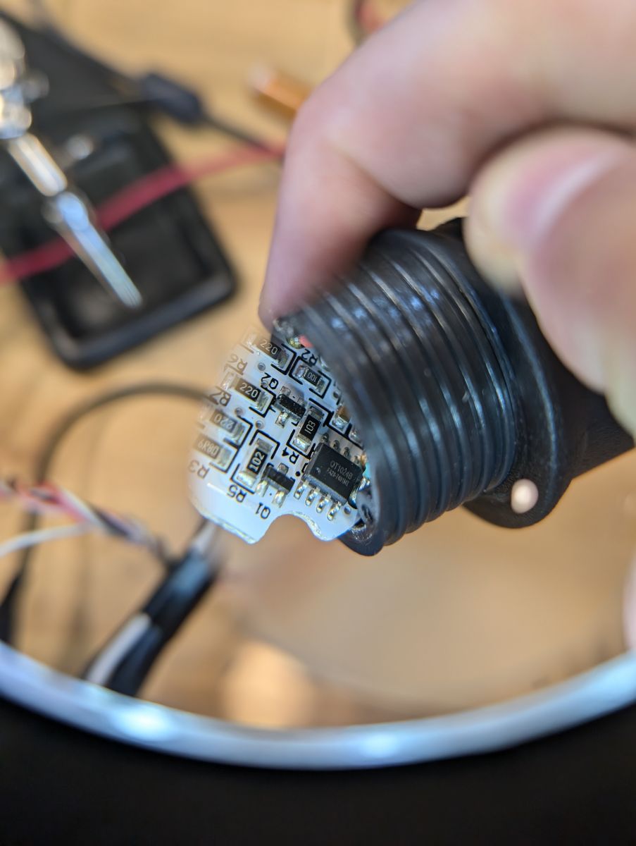

    LED board with GE014-RGBW marking and LED diode Close-up of the internal structure of a Jasco Enbrighten Cafe bulb.

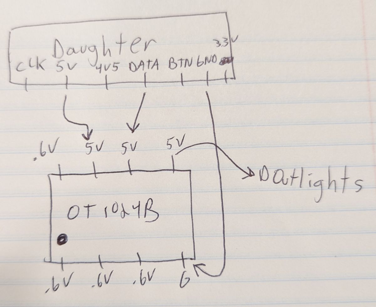

    Interestingly, there is also the same OT1024B IC on the backside of the motherboard which is where some of the Tuya+MCU daughterboard Data pin connects. Probing the IC shows it is a 4-channel RGBW driver using an unknown protocol with the voltages below. I don't have a proper Oscilliscope and wasn't confident that my Arduino scope (https://projecthub.arduino.cc/Ameduino/diy-arduino-oscilloscope-56d4c0) output was accurate. I suspect the OT1024B is a generic IC using a common protocol, but have yet to discover which one. If you know, please share!
    A hand-drawn wiring diagram for the OT1024B chip and daughter board.

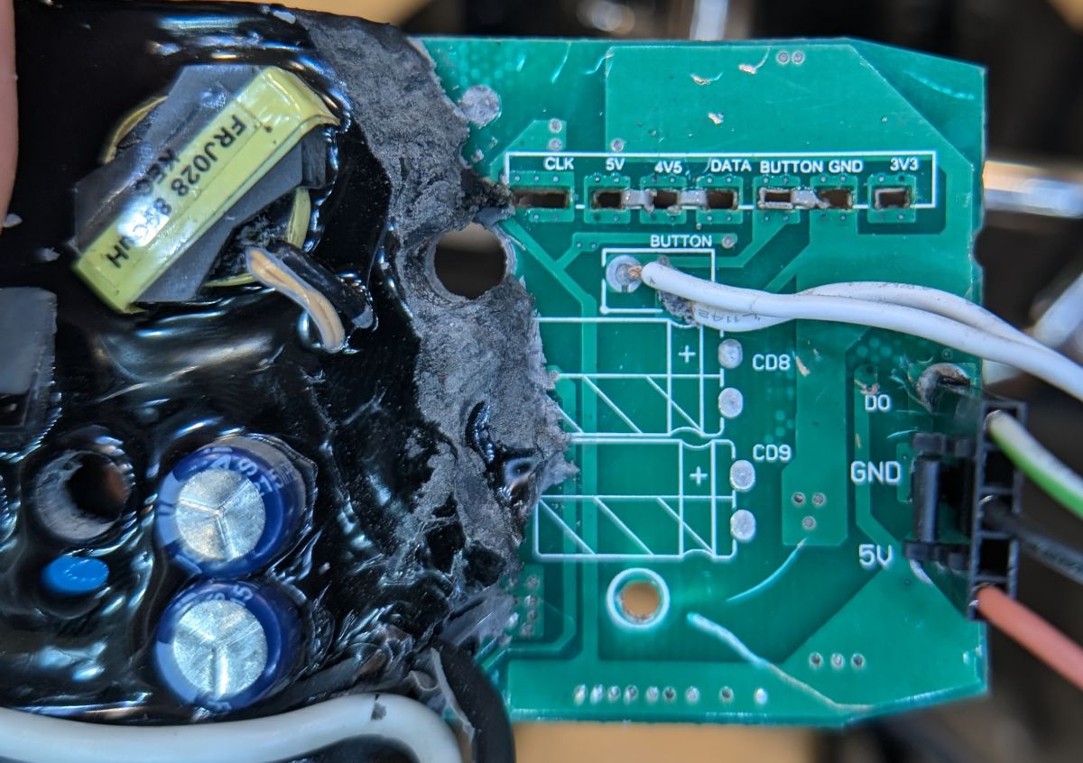

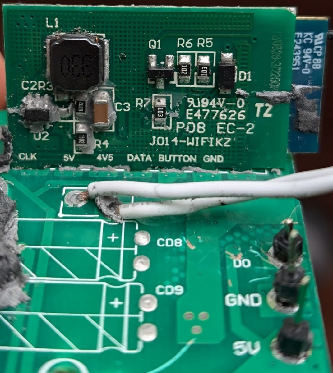

    The Tuya+MCU daughterboard has 7 pads that physically pierce the motherboard and are soldered to corresponding pads on the backside of the motherboard. I removed the assembly to clean up with some IPA and photograph. I then reattached it at a better angle in order to access all the Tuya pads. We can clearly see the part number for the Tuya Wifi chip is WB3S-IPEX which is detailed at https://developer.tuya.com/en/docs/iot/wb3sipex-module-datasheet?id=K9irq0laun21z

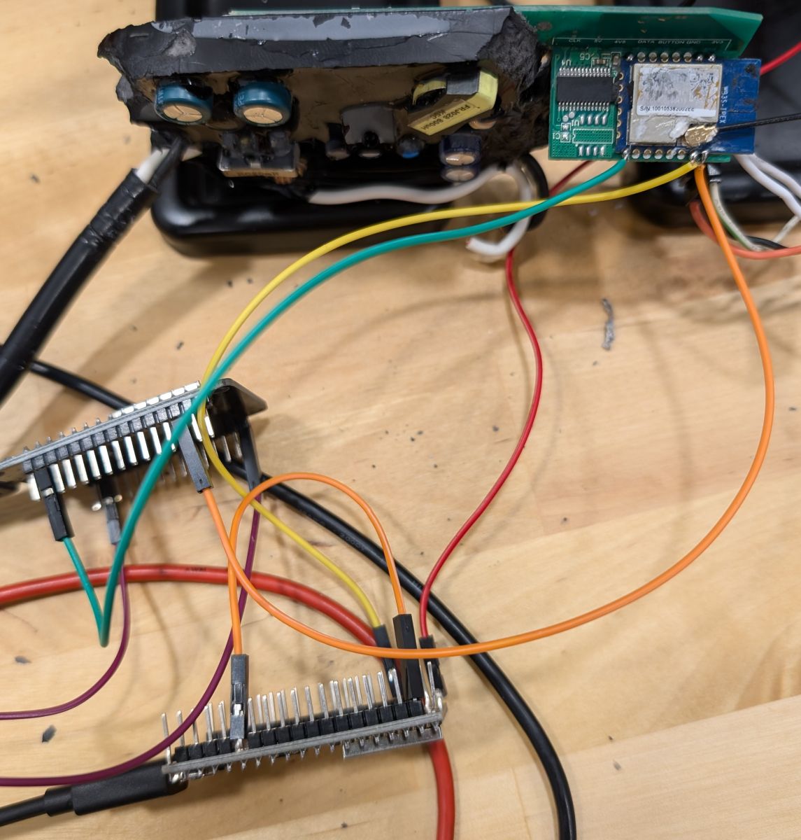

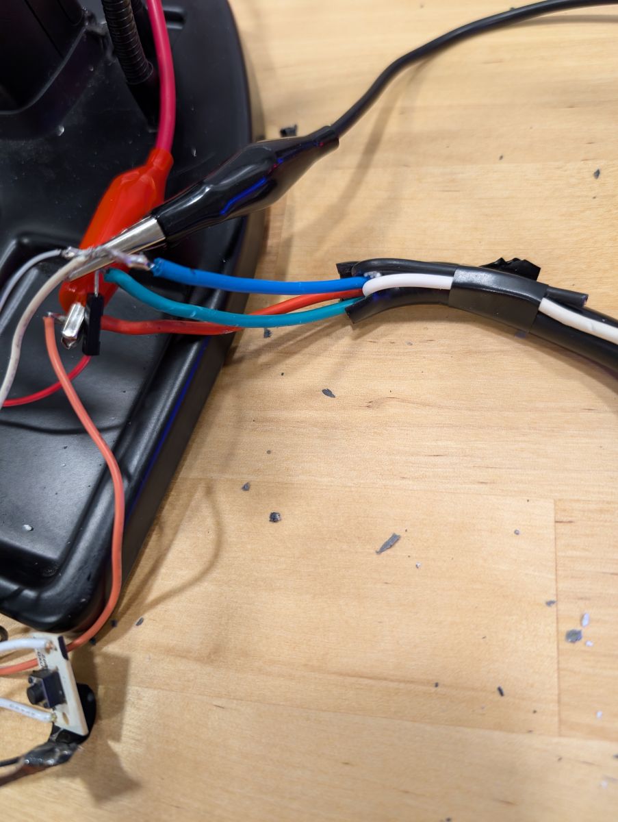

    At this point, I soldered wires to TXD1, RXD1 and GND then used two ESP32s in UART passthrough mode with TuyaMCUAnalzer.
    Close-up of cable connections to the Jasco Enbrighten Cafe WiFi housing, showing multicolored wires connected with alligator clips. Close-up of Jasco Enbrighten Cafe WiFi main board with connected colorful wires.
    Upon power-up we see the MCU info: {"p":"2q0e3h56uzb0sxbv","v":"0.2.11","m":0}. We also see two useful dpIds showing current value of the lights:

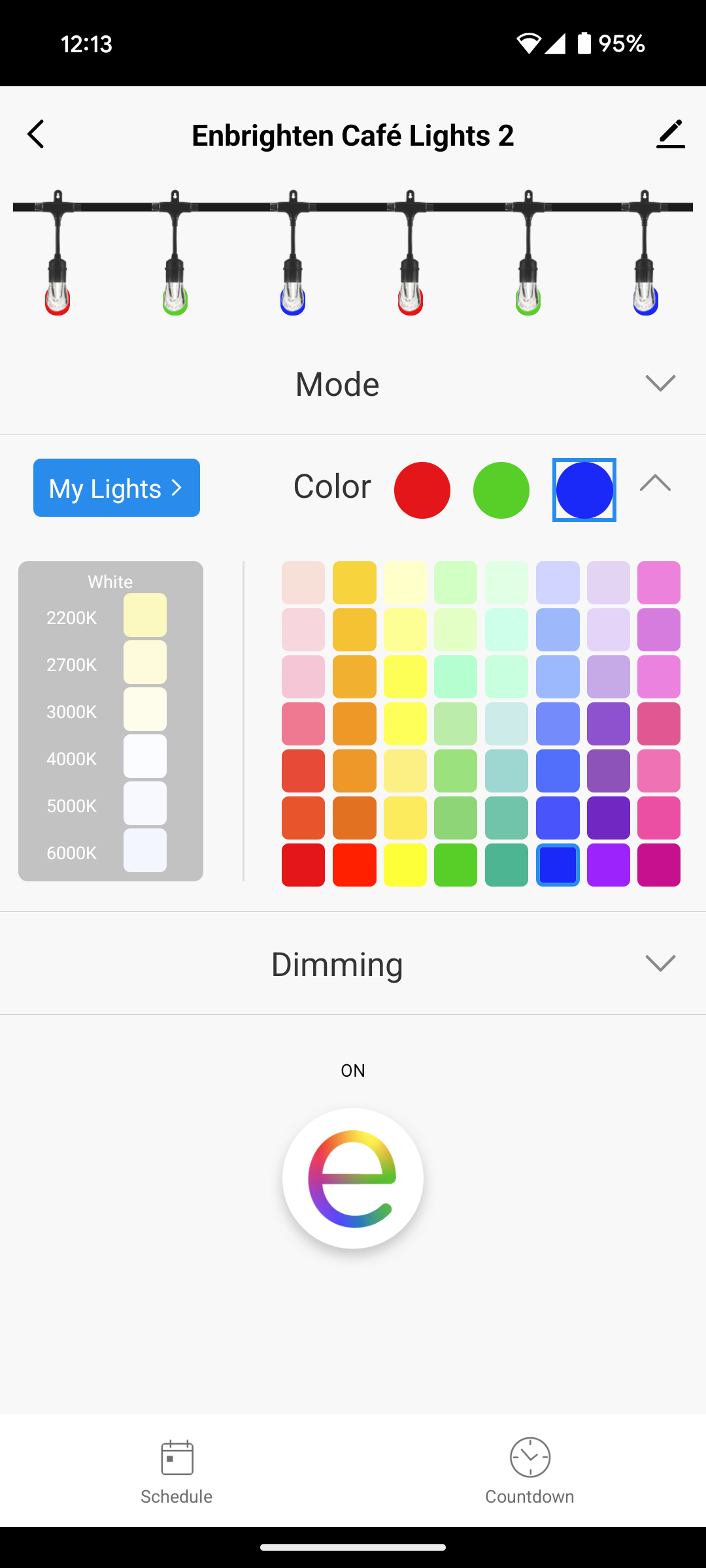

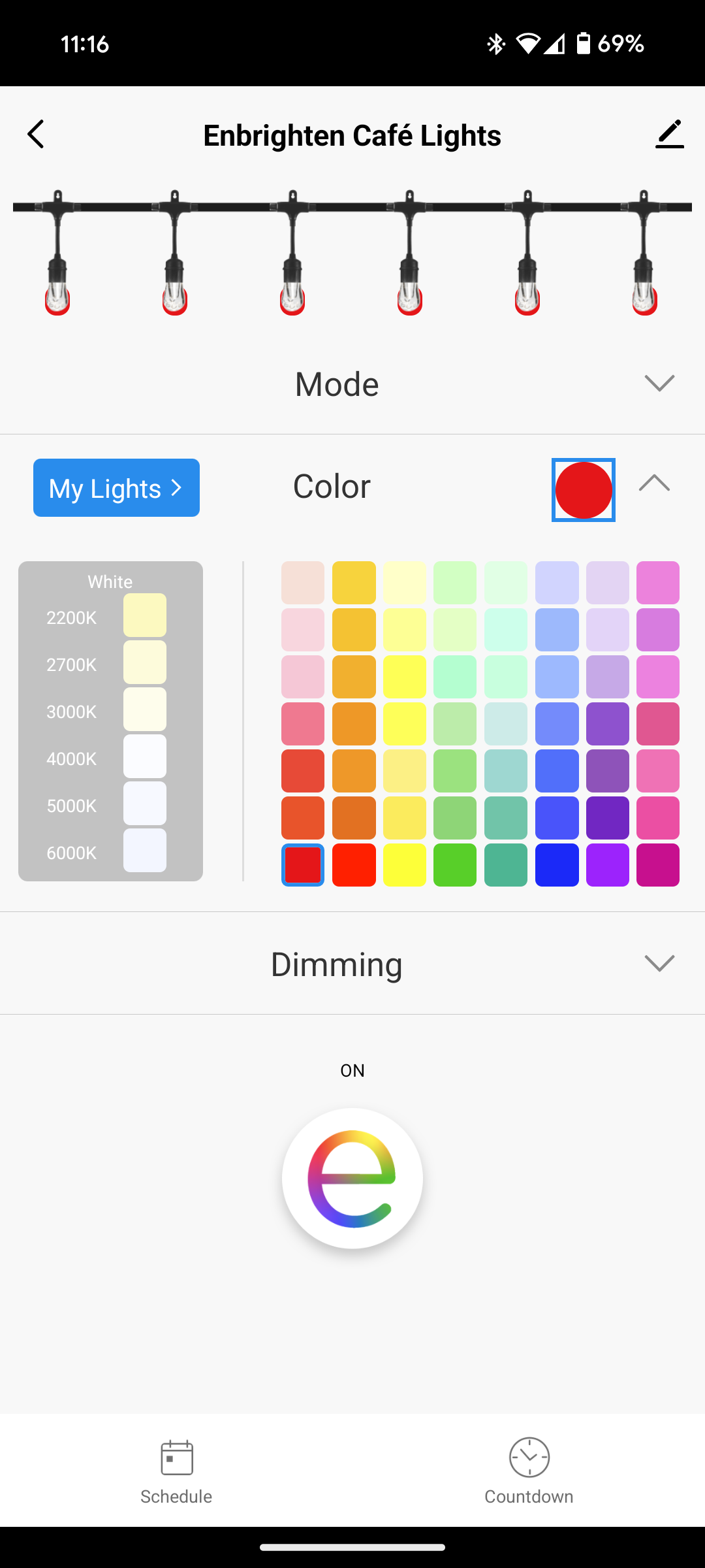

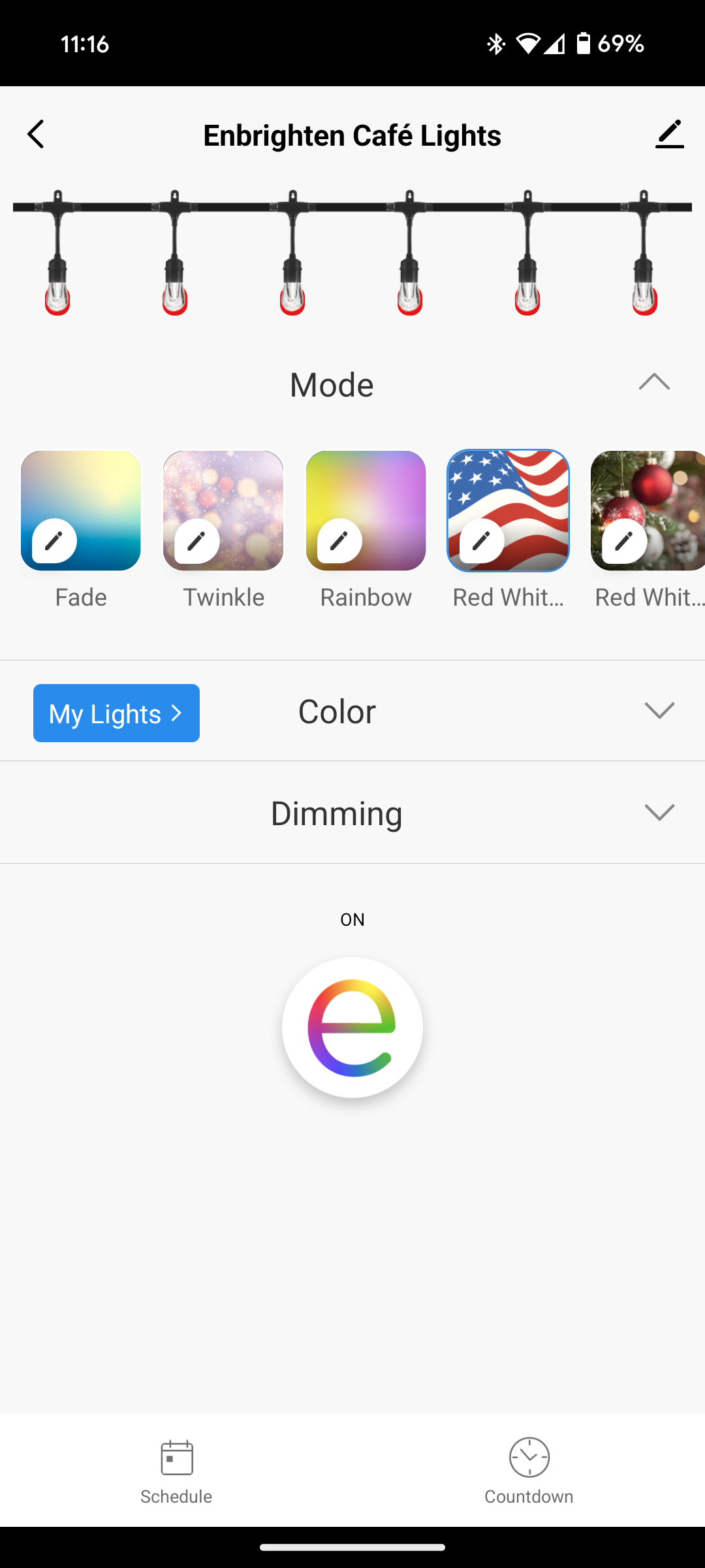

    I thought it'd be helpful to show some app screenshots.
    1. Colors section. Note one red orb and 62 colors per the box. Also note the My Lights button explained in 2. This changes dpId 106.
    App screen for controlling Jasco Enbrighten Cafe lights with mode, color, and dimming options.

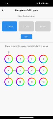

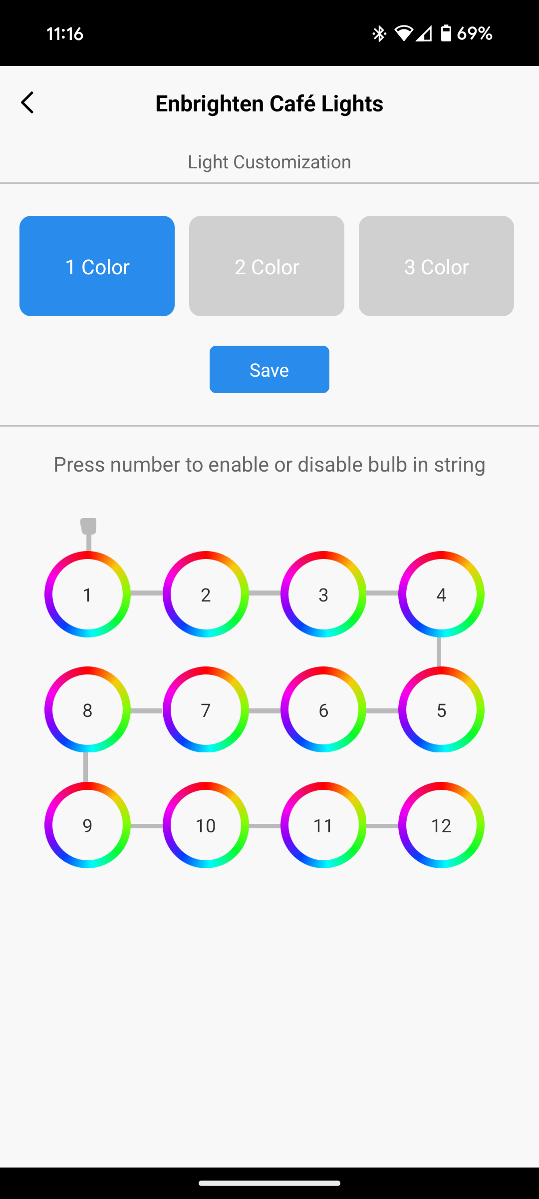

    2. My lights screen where you can add up to three orbs and set color for the repeating pattern, or toggle power to each bulb. This changes dpId 104.
    Screenshot of the Enbrighten Cafe Lights customization app.
    3. Mode which contains presets (effects, brightness and speed manipulations). This changes dpId 106.
    Screenshot of the Enbrighten Café Lights app control interface.

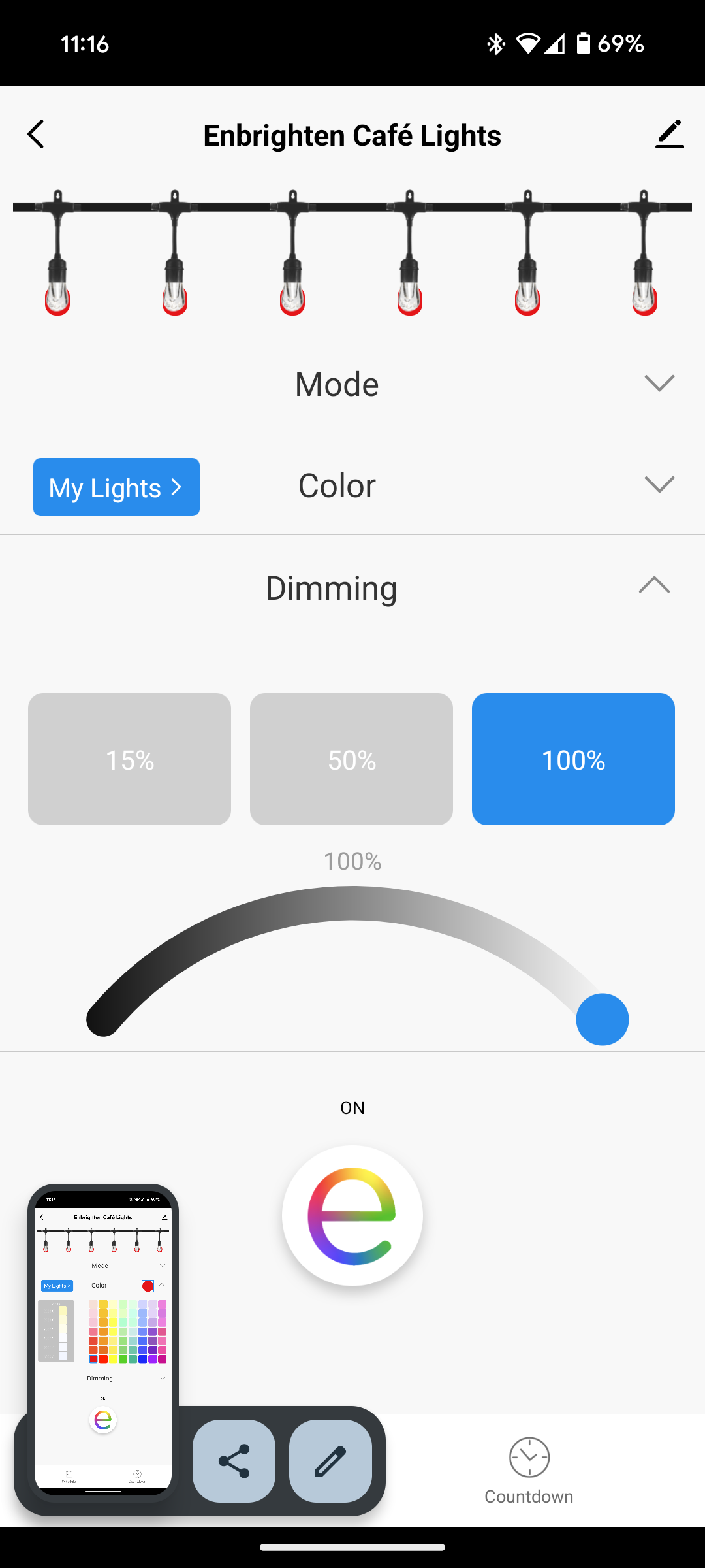

    4. Dimming with range of 1%-100%. This changes dpId 106.
    Screenshot of the Tuya app showing settings for Enbrighten Café Lights.

    Only 4 pins on the WB3S are in use - TXD1, RXD1, Ground, and Vcc.
    The button cycles the lights with no Tuya chip present at all (just the daughter board with MCU). Thus, the button directly shorts a pin on the MCU. Interestingly, QueryInitStatus does not reflect the actual color change by the button.

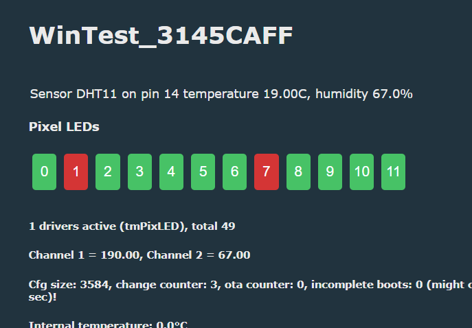

  • tmPixLED driver added for dpID 104 control

    Nice, I see you already figured uartSendHex. For the record, there is an easier way to do this:
    We have a command: tuyaMcu_sendState
    For example:
    //Customize ([red][empty][empty], dimming at 50%, effect solid) - All 12 bulbs are solid red.
    //dpId=106 Str V=b001f401f40#00ff0000
    tuyaMcu_sendState 106 3 b001f401f40#00ff0000
    Also, dpID 20 is a bool - on and off state, right? I think you can already map it to gui in autoexec.bat.
    Now, I need to look into making a simple driver for 104 and 106 dpIDs...
    Added after 35 [minutes]:

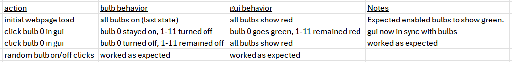

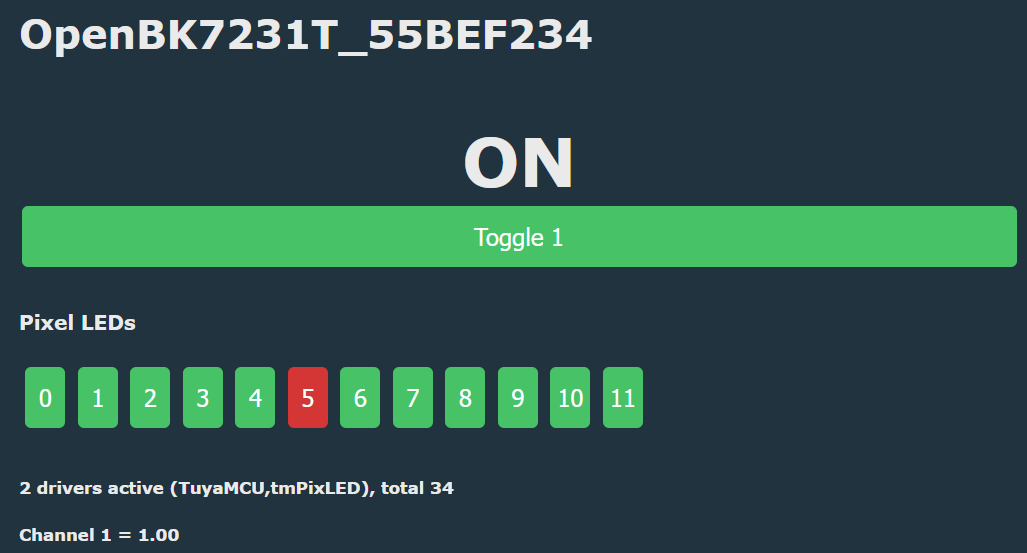

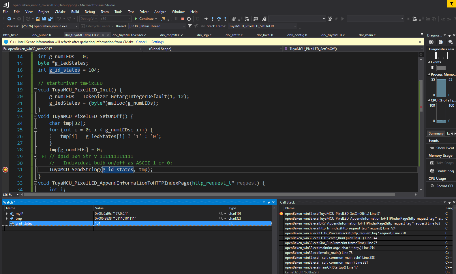

    Initial PR test:
    https://github.com/openshwprojects/OpenBK7231T_App/pull/1373
    Only gui and backend for dpID 104.
    Tested on windows so far, only data sending implemented.
    Command:
    startDriver tmPixLED 12
    Result:
    Screenshot of application test with pixel LEDs.
    This should be able to send:
    dpId=104 Str V=111111111111
    - Individual bulb on/off as ASCII 1 or 0:
    Would you be able to give it a try already? I will try to add more to that soon.
    Tested only on Windows:
    Screenshot of Visual Studio software displaying C language code.

  • Toggle works; dimming is global across all orbs
    #11 21247824
    steelincable
    Posts: 11
    >>21246179
    1373_merge_42e243d51e32 flashed and tested with Firefox. Results in the screenshot below. Other than the GUI being out of sync with the bulbs upon load, everything worked from a basic functionality perspective.
    Table showing GUI functionality tests for light bulbs.
    Other test observations:
    - I don't see the wifi send in logs, just mcu received - I assume this is expected behavior?
    - Occasionally clicking on a bulb number wouldn't work, seems like the buttons are refreshing every second (I see them flash when I mouse over) and clicking on a bulb number during a refresh doesn't transmit the event. This issue happened less frequently in Firefox incognito.
    - Would it be possible to show the computed string value in ASCII on the web page? Or is there somewhere I can see this?
    Regarding your interface question, I like your color picker idea for each orb. Below is a screenshot of the app with the max 3 orbs selected. I think showing 3 orbs at all times with a way to disable only orbs 2 and 3 would be the most logical. When you click an orb the currently selected color is highlighted on the picker. The lights are limited to 62 colors, but I'm not sure if that's a soft or hard limit. In other words I'm not sure if we have to limit the color picker to 62 colors as well and map them individually (well, 56 colors and 6 shades of white). I'll have to do some more testing there when I get some time.
    Screenshot of the Enbrighten Café Lights app with color selection for bulbs.
    Also note that dimming (and speed) is a global value, you can't dim each of the 3 orbs independently. Hopefully that makes it a bit easier.
    I'll test the boolean on/off and report back, but yeah looks like it should be an easy one.
    EDIT 1:
    Toggle created and works as expected:
    User interface for controlling LEDs with a toggle switch.
