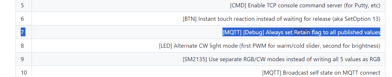

    Is there any option like flag 21 to retain relays and power channels for TuyaMCU switches?
    I tried with Flag 19 but it does not retain the values so when I restart HA the buttons do not work
    Added after 19 [minutes]:
    or something like this when Home Assistant starts?
    - alias: "Tasmota State on HA Restart"
    trigger:
    platform: homeassistant
    event: start
    action:
    - service: mqtt.publish
    data:
    topic: "cmnd/tasmotas/backlog"
    payload: "power1 ;power2 ;power3 ;power4 ;power5; dimmer; state"

    Thank you, I will try that. I didn't see that flag,
    but I solved it this way... for now.
