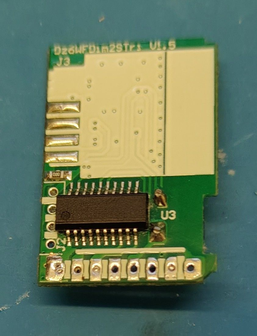

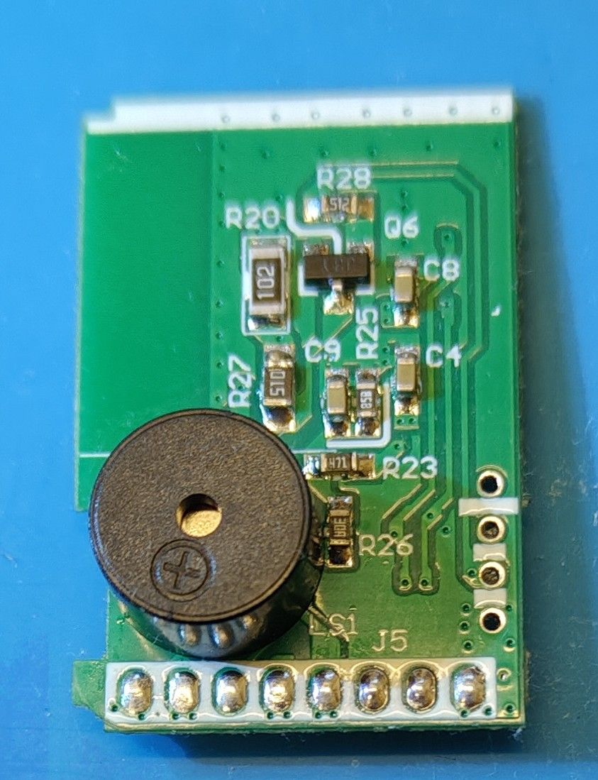

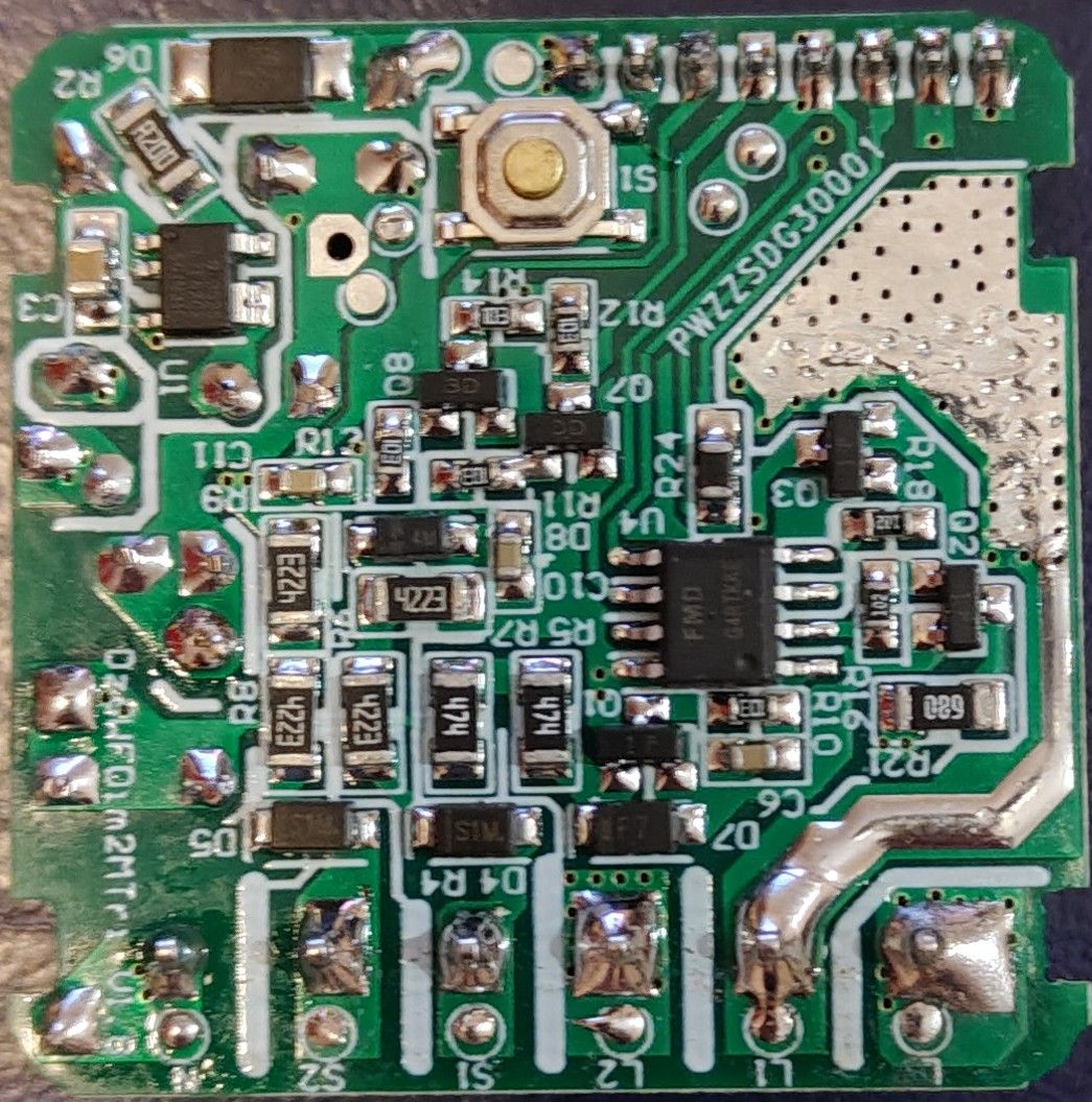

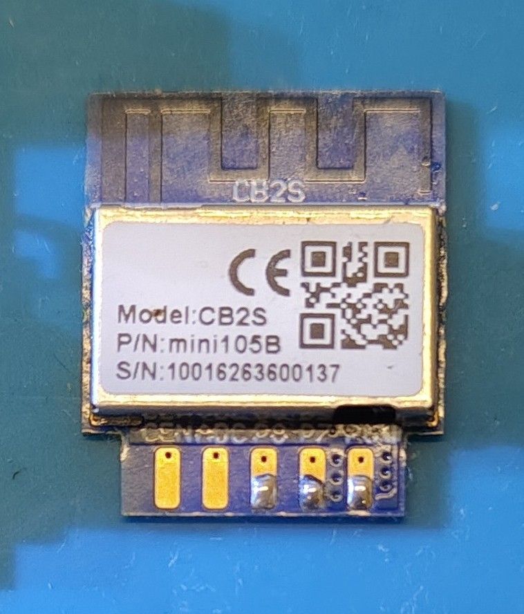

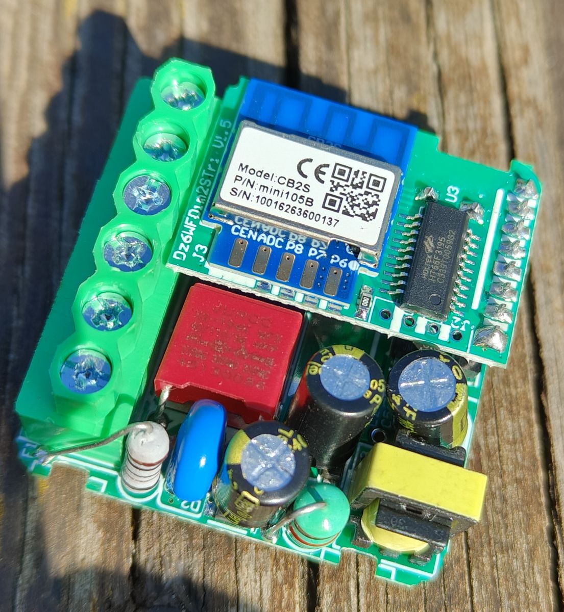

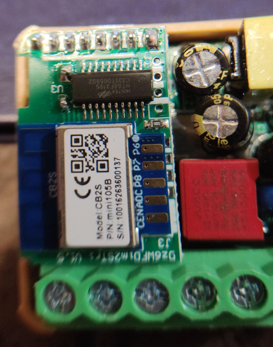

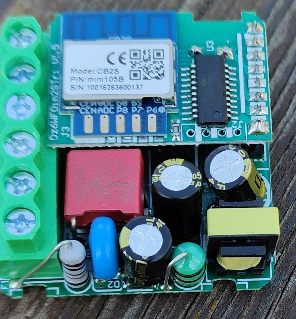

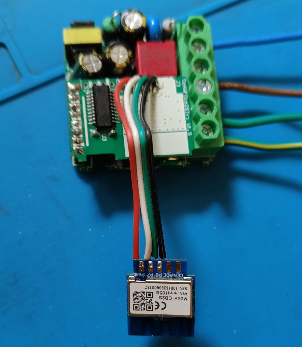

    Podmiana z Tuya na OpenBeken i Tasmota w MOES 2CH WiFi WM-105B-M WIFI prawdopodobnie mniejszy brat WM-105B
    W środku CB2S (Tuya fwv. 3.1.17) i TuyaMCU HT66F3195 (MCU fw v 2.3.0)
    Moes Smart Dimmer Module WM-105B-M with visible terminal markings and technical specifications.
    MOES 2CH WiFi controller module with visible CB2S module on PCB, showing model label, screw terminals, and electronic components. Close-up of the MOES WM-105B-M module PCB with visible SMD components and circuit traces. CB2S module with model name and serial number on a blue background, visible solder pads. CB2S module desoldered from PCB, visible traces and connection pins. CB2S module with QR code label and HT66F3195 chip on a PCB in a MOES 2CH WiFi device. MOES 2CH WiFi WM-105B-M module PCB with visible elements: CB2S module, capacitors, and relay. Small green printed circuit board with electronic components and a black buzzer.

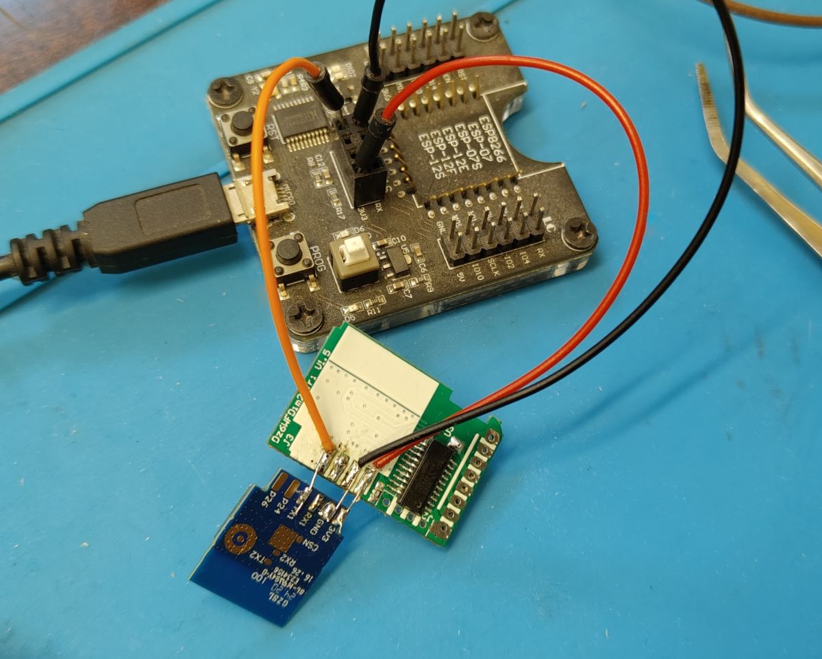

    Do flashowania oczywiście wylutowałem CB2S z TuyaMCU:

    flash + analiza TuyaMCUAnalyzer:
    Close-up of an ESP development board programmer connected to an electronic module with a blue PCB.

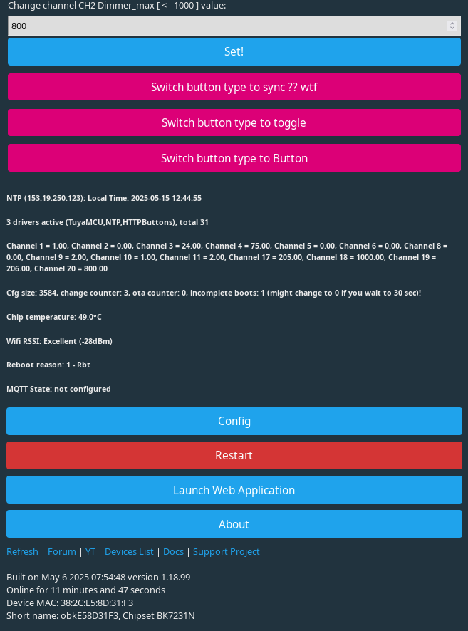

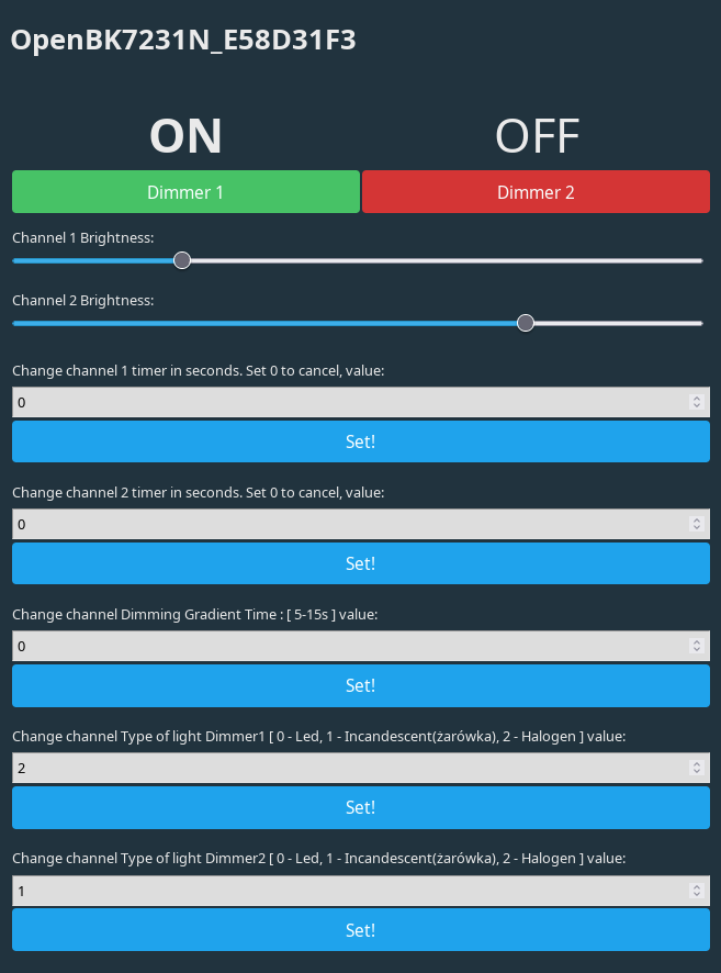

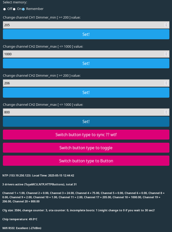

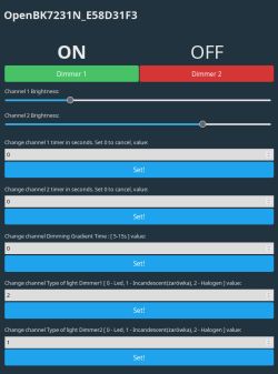

    Screen:
    Control panel for two light dimmers with brightness, timer, and lamp type settings.
    Control panel for configuring dimmer channels and button settings in an IoT device.
    Control panel of a BK7231N device with various configuration and diagnostics options.

    autoexec.bat
    startDriver TuyaMCU
    tuyaMcu_setBaudRate 9600
    tuyaMcu_defWiFiState 4
    startDriver NTP
    ntp_timeZoneOfs 2
    ntp_setServer  153.19.250.123
    tuyaMcu_setDimmerRange 200 1000
    setChannelType 1 toggle
    setChannelLabel 1 "Dimmer 1"
    setChannelType 2 toggle
    setChannelLabel 2 "Dimmer 2"
    setChannelType 3 dimmer
    setChannelLabel 3 "1 Brightness"
    setChannelType 4 dimmer
    setChannelLabel 4 "2 Brightness"
    setChannelType 5 Textfield
    setChannelLabel 5 "1 timer in seconds. Set 0 to cancel,"
    setChannelType 6 Textfield
    setChannelLabel 6 "2 timer in seconds. Set 0 to cancel,"
    setChannelType 11 OffOnRemember
    setChannelLabel 11 "Power-On State"
    setChannelType 8 Textfield
    setChannelLabel 8 " Dimming Gradient Time : [ 5-15s ]"
    setChannelType 9 Textfield
    setChannelLabel 9 " Type of light Dimmer1 [ 0 - Led, 1 - Incandescent(żarówka), 2 - Halogen ]"
    setChannelType 10 Textfield
    setChannelLabel 10 " Type of light Dimmer2 [ 0 - Led, 1 - Incandescent(żarówka), 2 - Halogen ]"
    // min max
    //ch1
    setChannelType 17 Textfield
    setChannelLabel 17 " CH1 Dimmer_min [ >= 10 ]"
    setChannelType 18 Textfield
    setChannelLabel 18 " CH2 Dimmer_max [ <= 1000 ]"
    //ch2
    setChannelType 19 Textfield
    setChannelLabel 19 "  CH2 Dimmer_min [ >= 10 ]"
    setChannelType 20 Textfield
    setChannelLabel 20 "  CH2 Dimmer_max [ <= 1000 ]"
    startDriver httpButtons
    //Switch Type dpId=47
    alias switchtype1 uartsendhex 55AA000600052F040001003E
    setButtonEnabled 1 1
    setButtonLabel 1 "Switch button type to sync ?? wtf"
    setButtonCommand 1 "switchtype1"
    setButtonColor 1 "#DC0077"
    alias switchtype2 uartsendhex 55AA000600052F040001013F
    setButtonEnabled 2 1
    setButtonLabel 2 "Switch button type to toggle"
    setButtonCommand 2 "switchtype2"
    setButtonColor 2 "#DC0077"
    alias switchtype3 uartsendhex 55AA000600052F0400010240
    setButtonEnabled 3 1
    setButtonLabel 3 "Switch button type to Button"
    setButtonCommand 3 "switchtype3"
    setButtonColor 3 "#DC0077"
    //                       dpId    element number
    linkTuyaMCUOutputToChannel 7 bool 2
    //dimmer
    linkTuyaMCUOutputToChannel 2 val 3
    linkTuyaMCUOutputToChannel 8 val 4
    // timery
    linkTuyaMCUOutputToChannel 6 val 5
    linkTuyaMCUOutputToChannel 12 val 6
    // type of light
    linkTuyaMCUOutputToChannel 4 val 9
    linkTuyaMCUOutputToChannel 10 val 10
    // power on state
    linkTuyaMCUOutputToChannel 14 enum 11
    // min max ch1
    linkTuyaMCUOutputToChannel 3 val 17
    linkTuyaMCUOutputToChannel 5 val 18
    // min max ch2
    linkTuyaMCUOutputToChannel 9 val 19
    linkTuyaMCUOutputToChannel 11 val 20

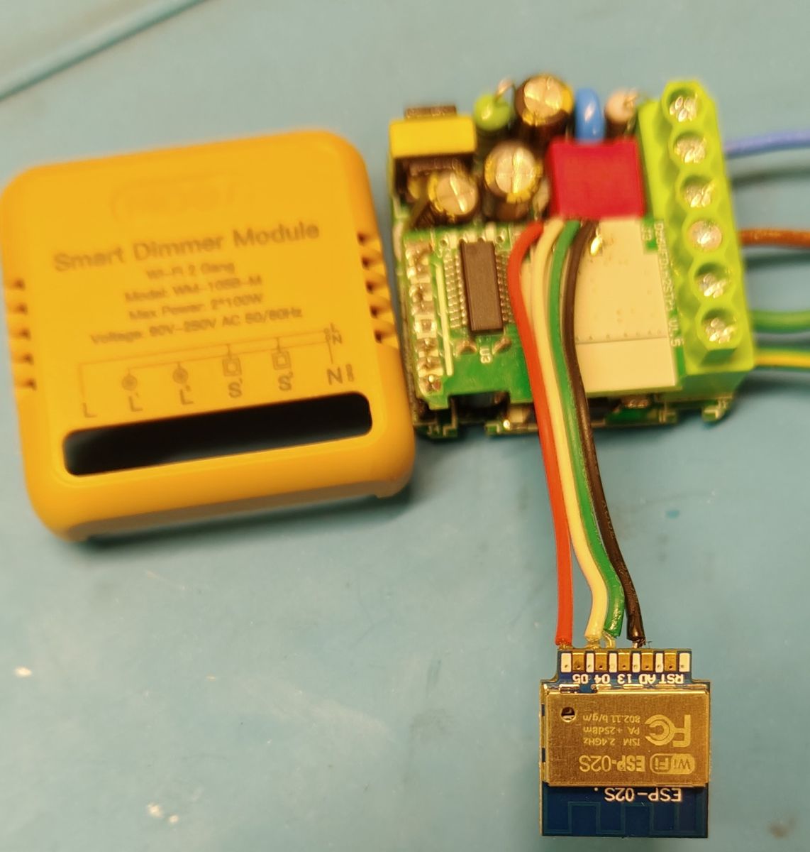

    Tasmota po przeszczepie na ESP-02 też działa, jak podrobie to postaram się wrzucić.
    Do zrobienia pozostaje:
    1. zmiana przełączania typu źródła światła , tak jak enum OnOffMemory czy LowMedHi
    2. zmiana przełączania typu przycisku zewnętrznego, tak jak enum OnOffMemory czy LowMedHi
    3. ustawienie brightness_min i brightness_max albo w jeden pasek (slider) z ruchomym początkiem i końcem, lub w dwa osobne slidery, jak to było poruszane gdzieś przez @p.kaczmarek2 , nie wiem jak to ogarnąć więc zrobiłem na typie Textfield.
    4. może ewentualnie countdown time też obsługiwać za pomocą slidera.
    Za błędy i niedociągnięcia z góry przepraszam :)
