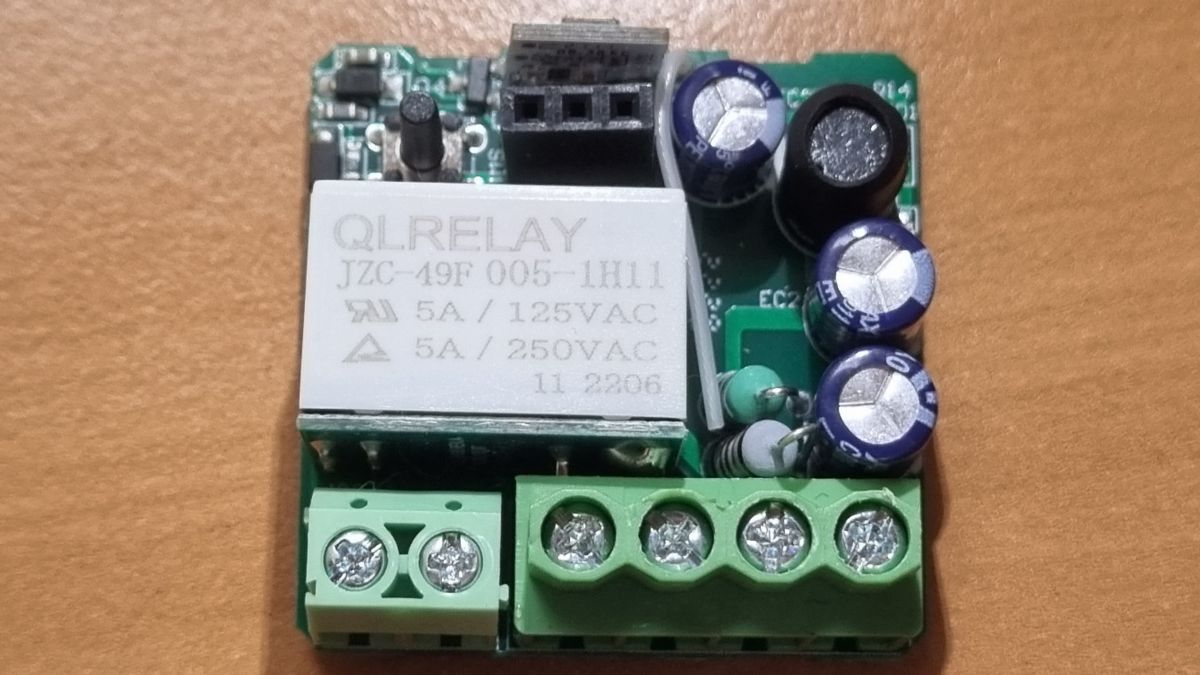

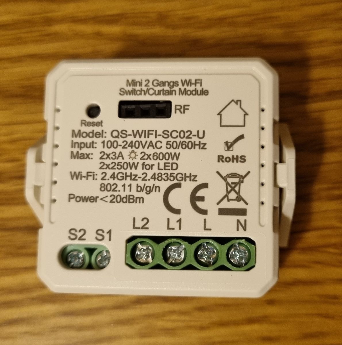

    Recently I've ordered a mini switch module from Aliexpress: Link
    Mini 2 Gangs Wi-Fi switch module with technical markings and connectors.
    Unpacking:
    I was expecting to see something usual, but it was a surprise..
    Mini Wi-Fi switch module QS-WIFI-SC02-U on a wooden surface.
    Photo of a mini switch module with QLRELAY JZC-49F relay.

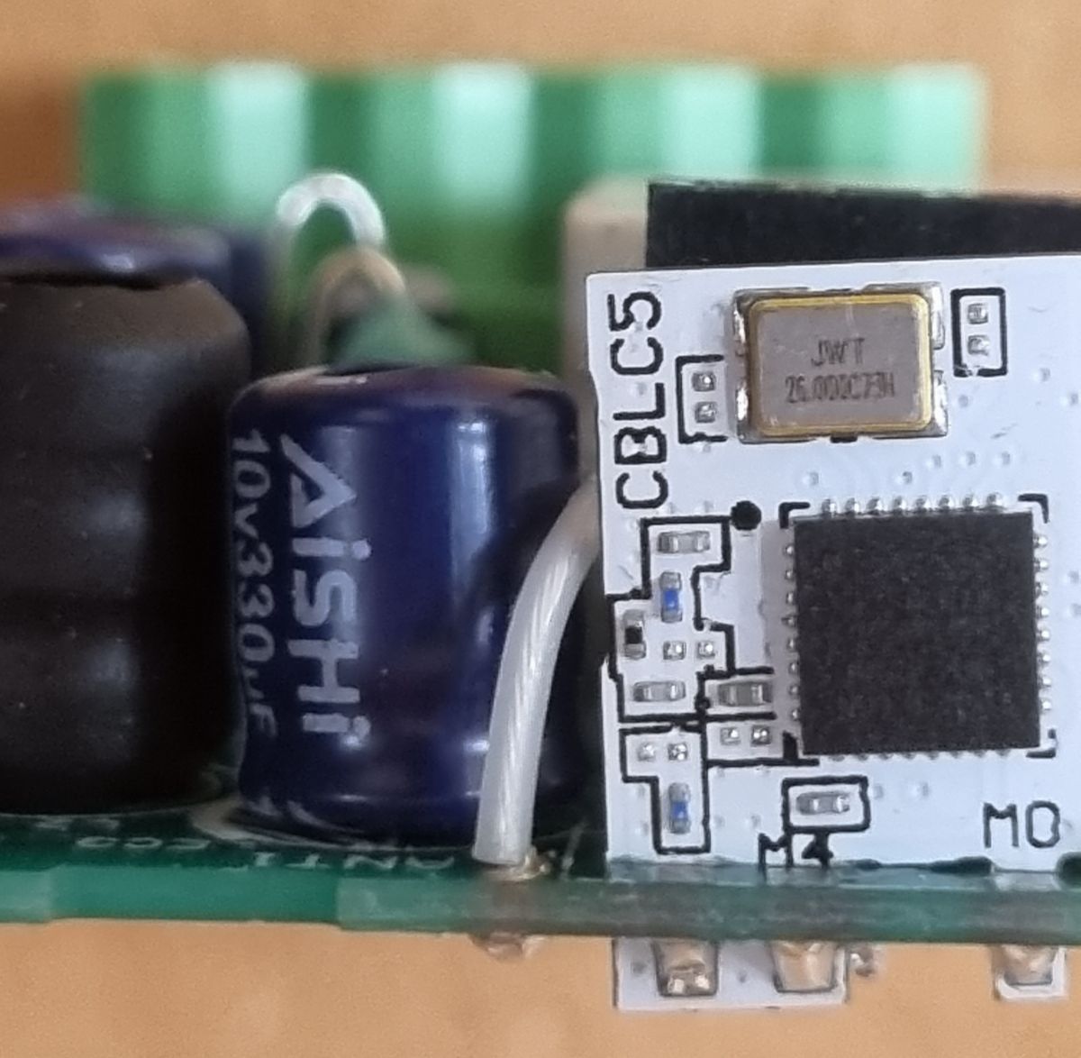

    Close-up of electronic module CBLC5 with visible components.

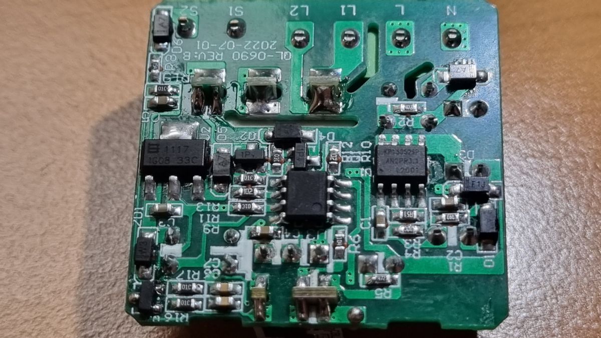

    Close-up of a mini switch module with visible electronic components on the PCB.

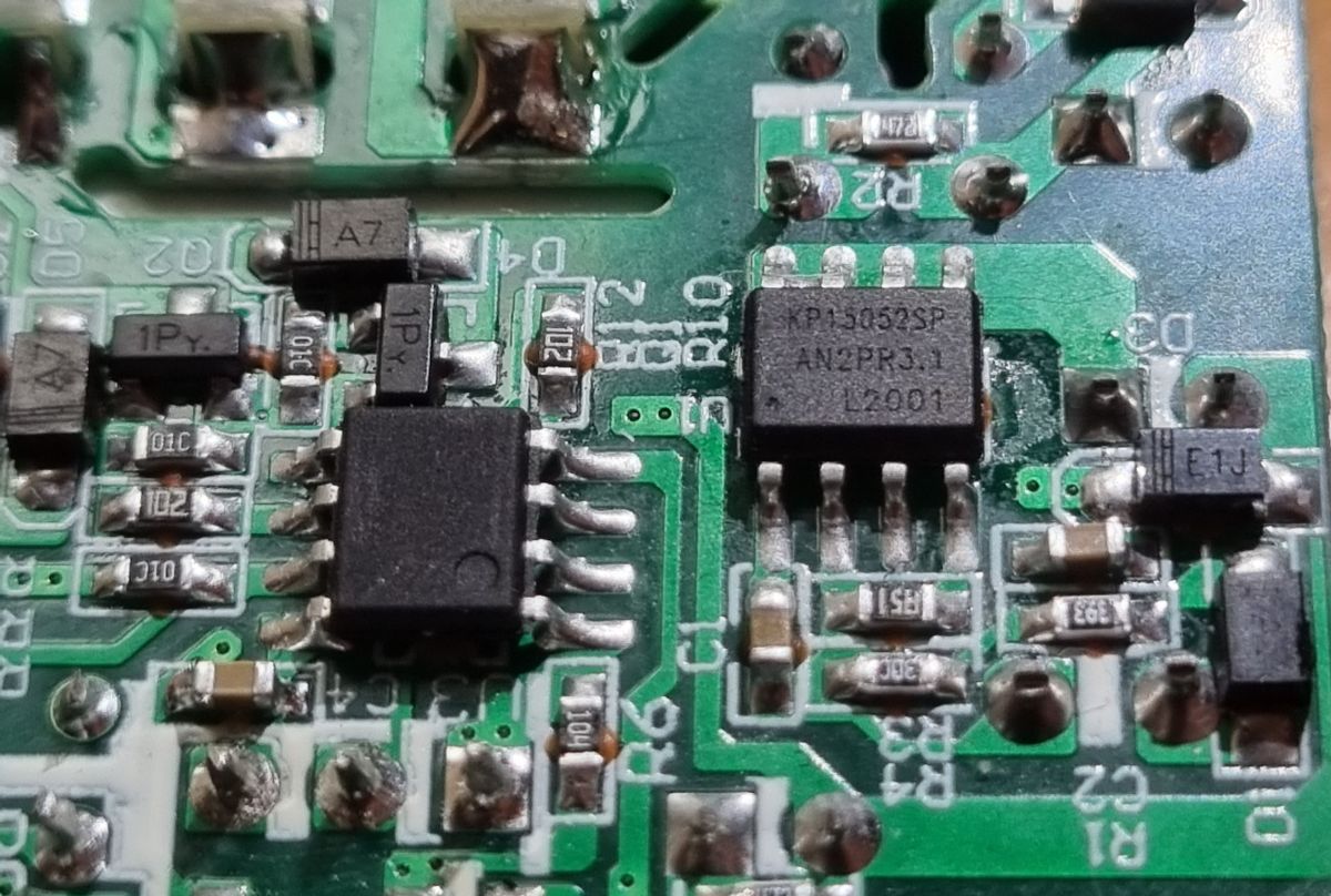

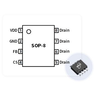

    Close-up of a mini switch module with a KP15052SP chip on a green PCB.
    After unpacking, I've realized that this switch is using BK7231N on CBLC5 module with KP15052SP I2C LED driver, which, unfortunately, is not supported in the current release :(
    The flashing process was straightforward and was successfully done with UART and hid_download_py without any errors.

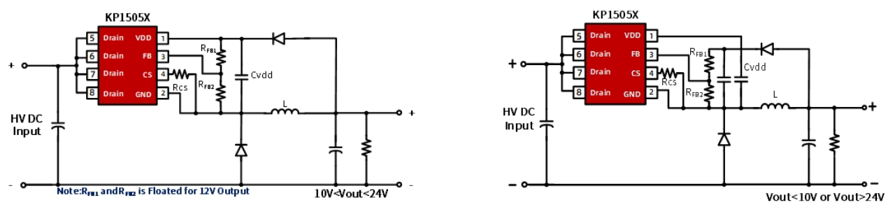

    I've tried to import existing templates and to use KP15058 driver, but it looks like it's not compatible with KP15052SP and the scheme is different compared to KP15058.
    KP15052SP scheme.
    Circuit diagrams of the KP1505X chip with different output configurations.
    Diagram of the KP15052SP chip in SOP-8 package with pin descriptions.
    The full datasheet is available upon request on their website (Chinese):
    http://www.kiwiinst.com/productinfo/1249744.html

    Hello, the following chip is not a LED driver. It's a power supply controller, it has no digital interface. It can't be driven from MCU, and there is no need for that.
    Please try to do the GPIO template extraction so we can know more about this device:
