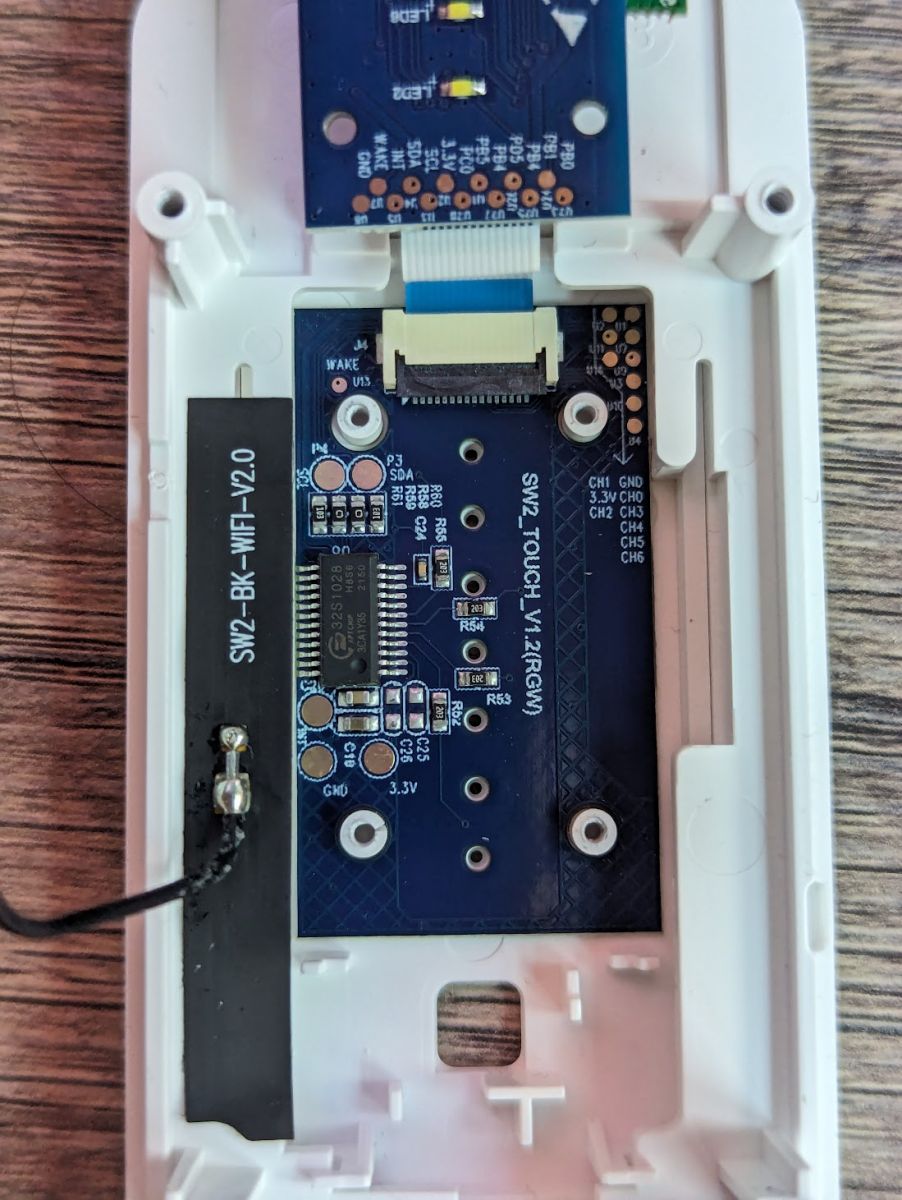

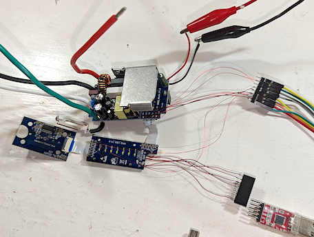

    Following from the excellent SW5 teardown and template which works well for me, I am now struggling with the Gosund / Ghome SW2.
    It's a dimmer with both a traditional US Decora style press-button but also a touch front panel with a row of LEDs. Generally a high-quality product, as with all Ghome I've seen so far. Purchased from Amazon, also sold direct, $15-$20.
    FCC ID 2APUZ-SW2 UL listed ES09666 Model SW2 Date 05/2022. 120 V 4 A.
    GHome smart dimmer with voice and app control features.

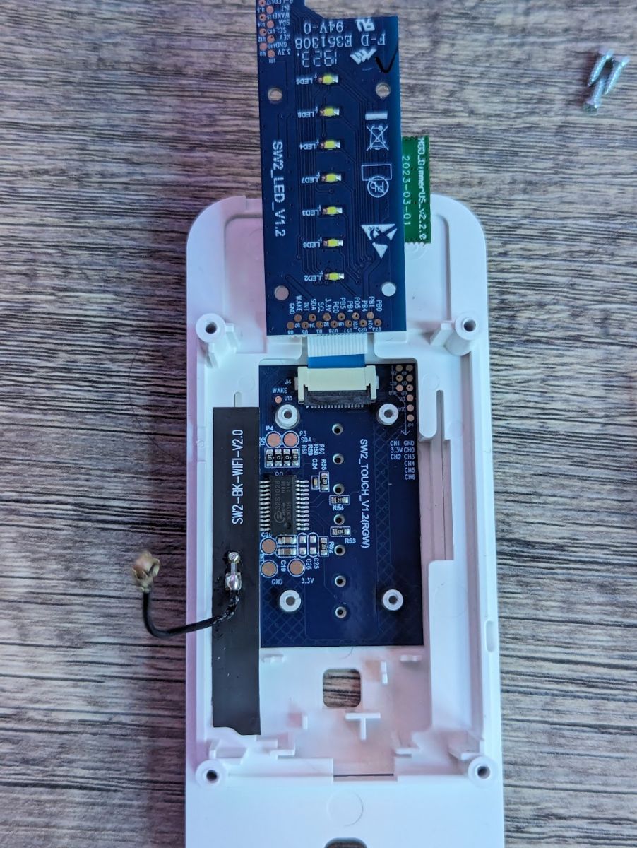

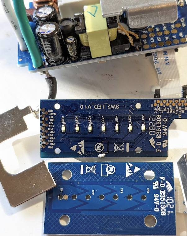

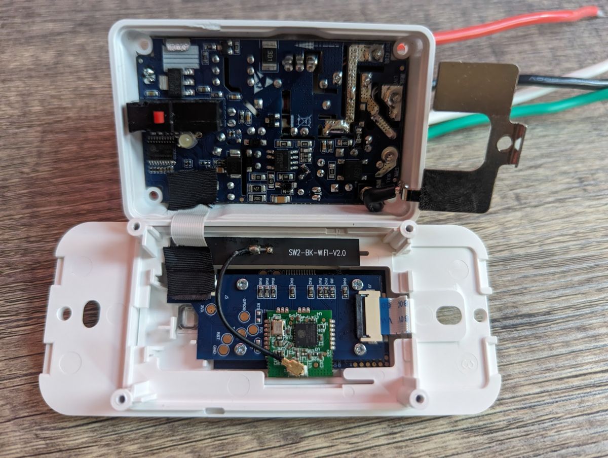

    It contains FOUR PCBs connected by thin flex cables:

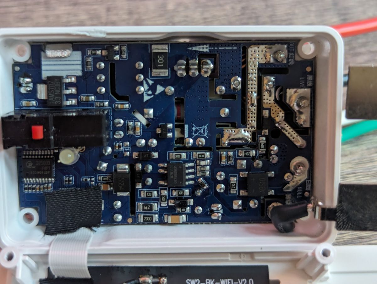

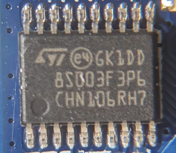

    - Main switch/relay/psu/dimmer board, including a mysterious IC "GK1DD8S003F3P6" which must do the dimming.

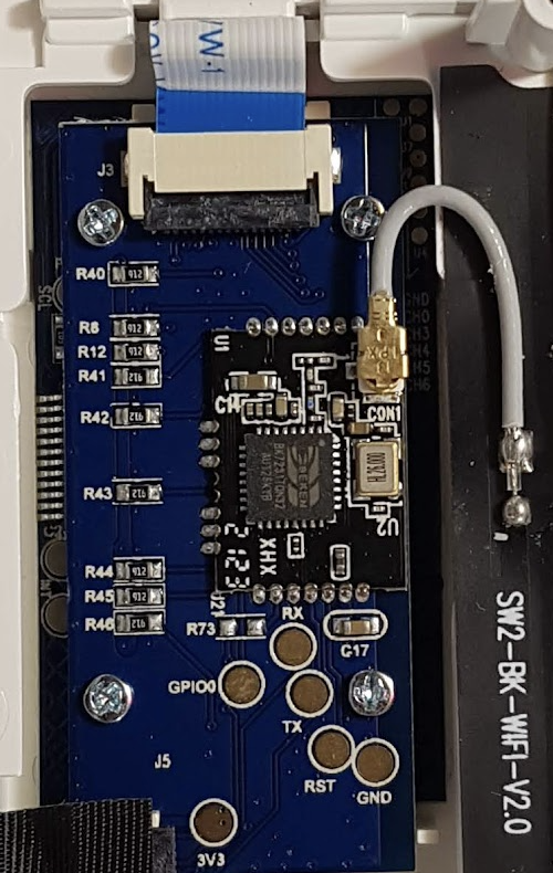

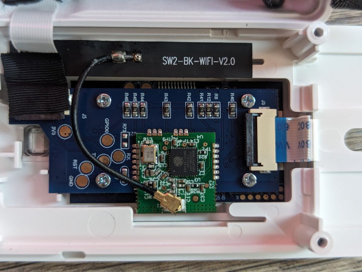

    - CPU board containing the BK7231T (module) and the seven LEDs

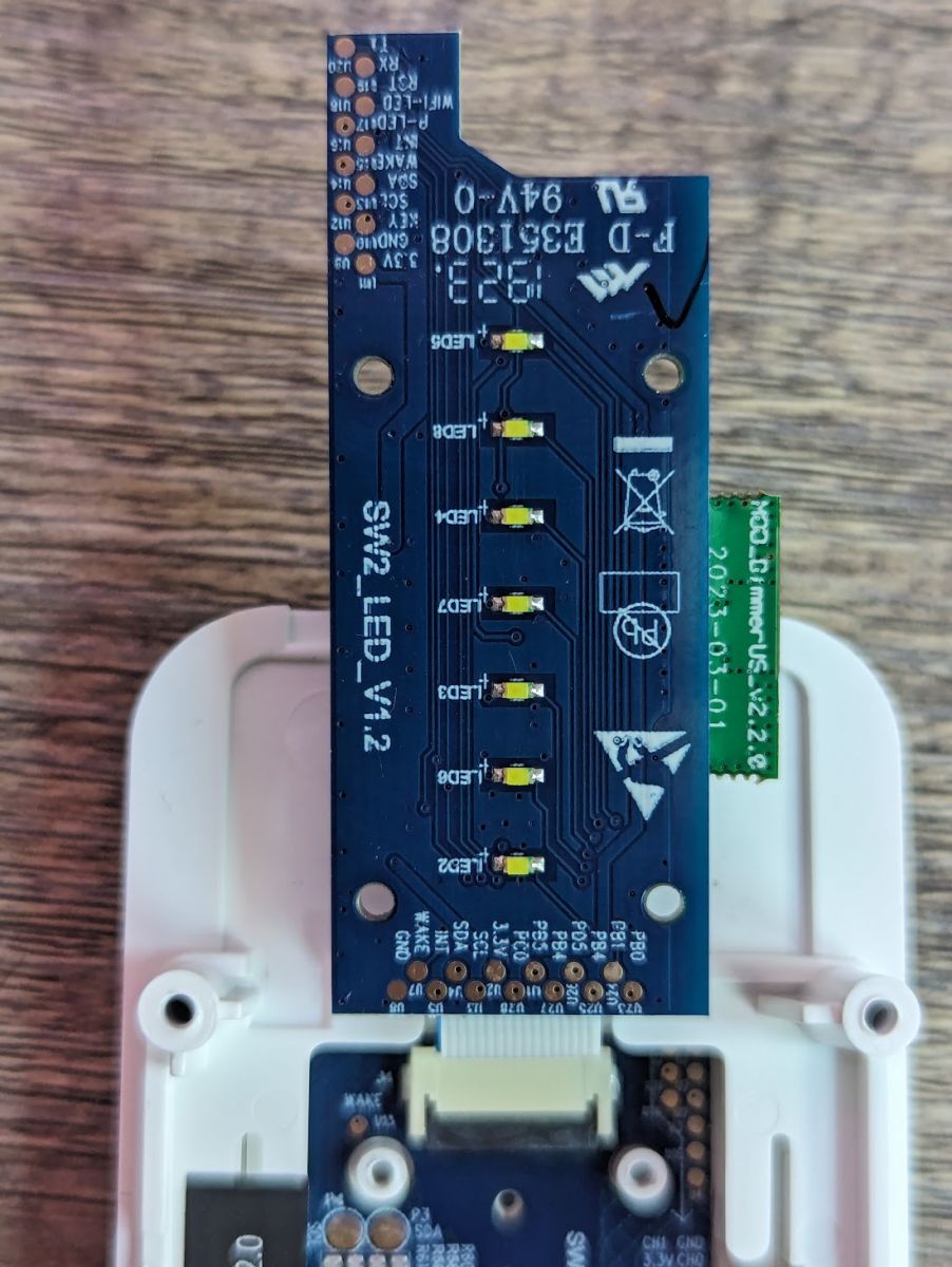

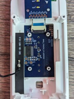

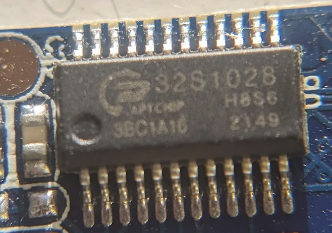

    - Touch board with an APTchip "32S1028H8S6" microcontroller.
    - 2.4 GHz antenna with coax and U.FL or IPEX
    Stock firmware offers on/off, dimming by touch / sliding finger, bar graph of LEDs, very nice.
    But it needs to run OpenBK and talk to HA.

    I can flash the BK7321 fine, but there is firmware on the other parts, which it would be best to use as-is.

    Does the S in the APTchip indicate that it has no flash, needs to be programmed on power-up?

    Touch board IC:
    Close-up of a microchip with visible markings and numbers.
    Dimmer board IC:
    Close-up of an integrated circuit on a printed circuit board, labeled as BL602T.
    CPU board (nice programming pads)
    Electronic circuit board with components and wiring
    General assembly:
    Teardown of Gosund SW2 LED V1.0 electronic circuit with visible components and board.
    TuyaMCU likely, with UART1 used for programming

    Thank you!! This pointed me in the right direction. After much investigation about TuyaMCU...
    With the stock firmware, I have found serial communications at 115200 to/from the BK7231, but not TuyaMCU packets.
    Also I2C between various things on the boards, not yet sure which parts are talking.
    A bunch of information that doesn't yet completely make sense (all values are hex)
    1) I2C seems to control the bargraph LEDs.

    BK7231 serial protocol for dimmer and touch state
    #4 20825305
    bkespoke
    Posts: 16
    I've finished decoding most of it now.
    tl;dr is it worth trying to get OpenBeken to speak to this dimmer?
    It's definitely not the usual TuyaMCU protocol. Is it fairly simple to write something that receives and sends these messages, updates its internal dimming state etc? The LEDs and Button are easy, but how would it parse the 5-byte serial messages to get the touch input, and send the serial dimmer and LED commands?
    Have you seen a device like this before? Shall I flash it with OBK and try sending some of these commands? Thank you!
    The gory details:
    TouchController (APTchip) - reads the touch, controls the 7 LED bargraph.
    PowerDevice controls the relay and the Triac.
    PowerDevice and TouchController speak by I2C - one message A6 00 bb is the LED mask. The other A6 01 A7 tt is the touch position.
    Also an INT line for APTchip to tell PowerDevice it's been touched
    And a WAKE line for PowerDevice to tell TouchController to listen to I2C.

    the BK receives the touch position from PowerDevice by serial, 115200, with this 5-byte packet:
    0x24 0xTT 0x01 0x69 0x23 where TT is the touch position, approximately 0x01 to 0x96
    It then usually sends out a new dimmer setting and LED bargraph (which is then relayed by i2c...)

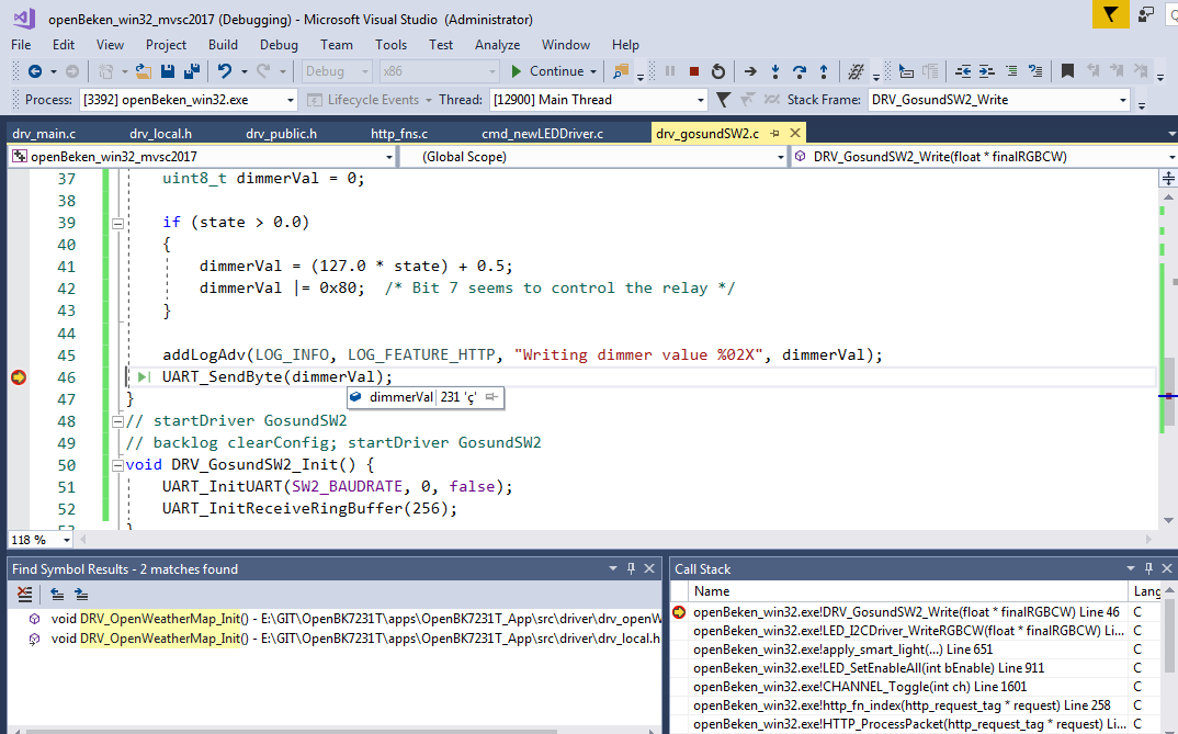

    Hi, I think I could get the HexSend working, and make it function as a dimmer and indicate its state on the bargraph.
    It's easy to flash, because the BK board can be isolated by disconnecting the flex cables. I'll try this tomorrow.
    Is there a way to receive the 5-byte packets, to receive the touch input?
    Or is that a major rebuild like cloning the TuyaMCU driver?

    What about creating a driver directly in C? Maybe this would be easier to support this device.
    We are usually using Tasmota apps to control OBK, like Tasmota Control, etc.

    Sorry, I'm not up for writing a new driver in C, I'll get lost.
    Ha ha if only my internet search was as good as my logic analysis. Blakadder took the SW2 apart and decoded the protocol years ago (when it was still made with an ESP).
    Thanks for all your work on OBK, it's doing well on my other switches. I hope this post helps someone else trying to figure out the SW2.
    Time to put it back together.
    Disassembled electronic circuit board with connected wires on a white background.

  • LN882HK1 and touch MCU identified on SW17
    #18 21593400
    hardware4200
    >>21593208 re: Boot.log. I am not sure how to capture this other than watching the UART. I have a connection to the device when it boots and I see nothing on the serial console.
    re: Chips. SW17 has a LN882HK1 (which I've successfully flashed with OB) and a 32S1028H8S6 which is the capacitive touch MCU.
    I think this could be a significant game changer if this device were adopted, as it costs roughly $7-9ea in quantities of 4.

    http://en.aptchip.com/list_112/655.html#gongju
    Part NO.Op.VoltTempFreqPinGPIOHSIOFlashRAMDflashHWDIWDTWWDTBTCNTARTCLPTEPTGPTUARTIICSPINOTTTLPWMADCTouchDeep SleepPACKAGE
    APT32S1028H8S61.8v~5.5v-40~8548MHz2422464k4k2k11211111311116bit,12ch12bitx16ch17ch5uASSOP24
    looks like a CK-Link type chip http://en.aptchip.com/tiaoshi

    There seem to be some confusion, the linked driver is a simple UART byte send, I can port it easily.
    I've started porting it, but it's not I2C so it may not fit your device, but anyway...
    Gosund/Ghome SW2 [BK7231T] wifi dimmer switch - subsystem identification
    https://github.com/openshwprojects/OpenBK7231T_App/pull/1702
    Futhermore, on which platform should I enable it? LN882H?
    I am also missing one more thing - what is the baud rate there?

    I still have the .logic captures for various operations of the dimmer, but my summary in >>20825305 contains everything I could figure out. I never tried sending the various codes from openbk to the dimmer controller.

    Well, that does not match the SW2 driver I ported... maybe we could do driver according to your specs, but I am not sure if info is complete. Do you know C basics?

    The BK sends only these bytes, 115200bps:
    OFF: 0b 0000 0aaa where aaa is 1 to 7 depending on the brightness before turning off
    ON: 0b 1ddd dddd where ddd dddd is the dimmer setting, 0-100 (percent)
    LED: 0b 0100 0ggg where ggg is the LED bargraph 1 to 7.
    To explain my earlier writing a bit more carefully:
    On every power state change the BK should send something like this at 115200 bps
    1. the LED byte which is 0x40 | (state*7)
    2. pause 14 ms (this is 200 characters, a non-trivial delay (could experiment to see if it needs to be so long. Perhaps the dimmer micro can't receive serial while talking to the display on I2C?)
    3. the dimmer setting which if the power is on, should be 0x80 | (state*127).
    If the power is off, send 0x00 | (state*7) (I can't remember why the state is required. Perhaps this takes precedence over the LED byte if power is off. Dimmer LEDs??)
    4. Repeat the above a second time after 100 ms of idle time (guarding against corruption?)
    5. Max rate of about 100 ms, even if the touch input is coming in every 40 ms.
    This isn't quite what's in DRV_GosundSW2_Write() in your new code. - you're only controlling the dimmer, not the bargraph LEDs.
    DRV_GosundSW2_RunFrame() looks OK. No idea if it will stay synchronised, maybe that's taken care of by a short timeout. From my logic analyser captures, the 5-byte frames arrive about every 39 - 50 ms when sliding your finger on the touch strip.
    You'll need to adjust the touch strip limits to ensure you can get 100% and 0%. I got values up to 0x96 which is 150, so maybe use float dimmerVal = constrain(buff[1] / 145.0, 0.0, 1.0) or something.
    The original Ghome firmware has some further neat functionality for the bargraph:
    - at least one dot always showing
    - remembers the brightness when you switched off by pressing the button
    - displays this last brightness so you know what you'll get when pressing
    - possibly accepts touch inputs to change brightness while the light is off, so you can pre-dim it before turning on with the physical switch
    These could be emulated in various ways.

    #27 21601119
    bkespoke
    Posts: 16
    @hardware4200 The BK7231 doesn't use I2C - it only speaks on the serial port, to the dimmer controller ST Micro.
    Here's a sketch of the whole unit.
    It looks like it was cobbled together from existing / working parts, not designed from the ground up (some risk of it being redesigned...)
    Edit: We may be talking about different units - there's also a "shelly" ESP32 version. Though from the photos it is likely the same control arrangement. Maybe Mike can confirm this. It took me a while to figure out that the I2C passes through the main board, even has test pads there, but it's not a common bus, not even connected to the BK7231.
