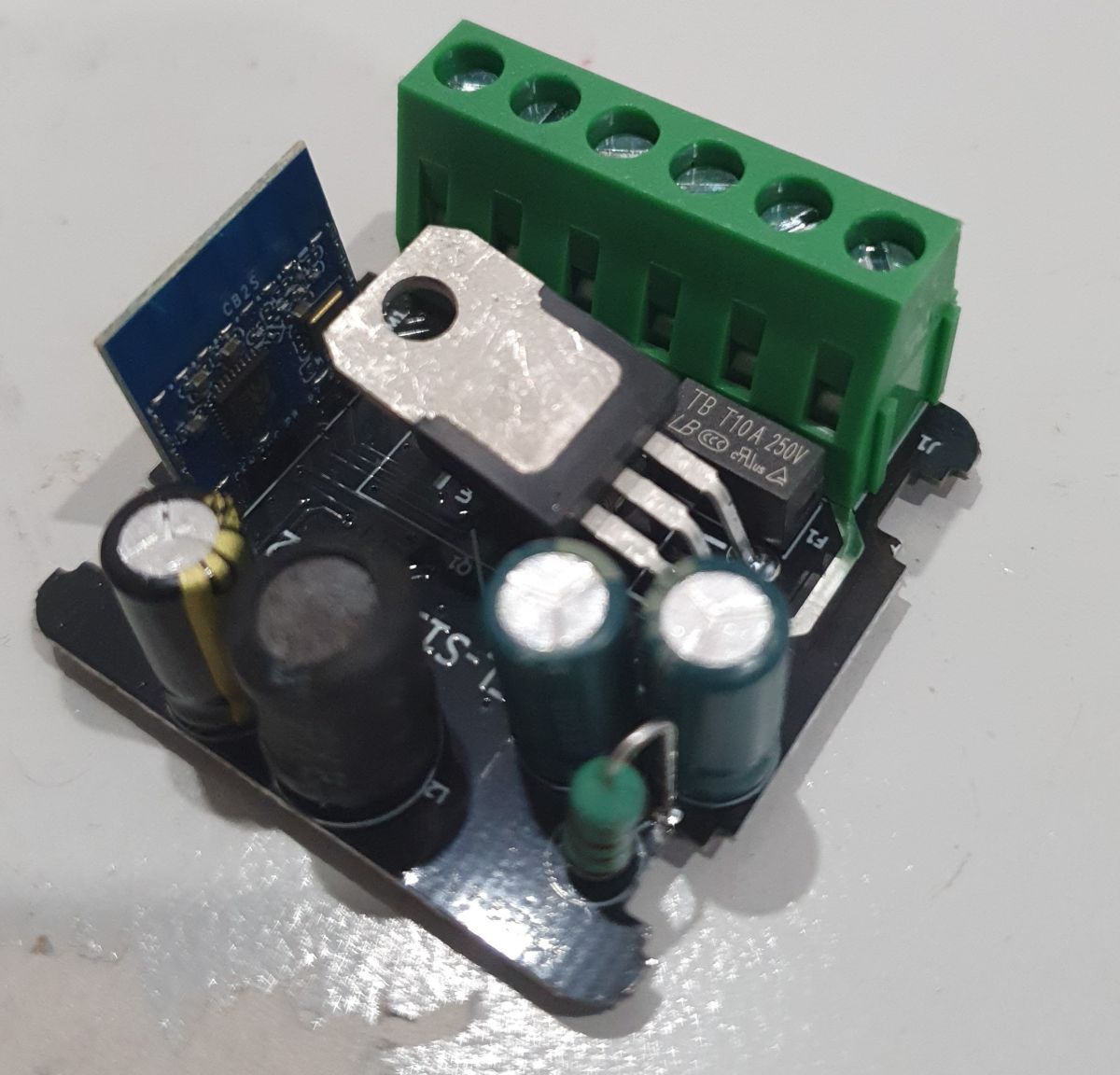

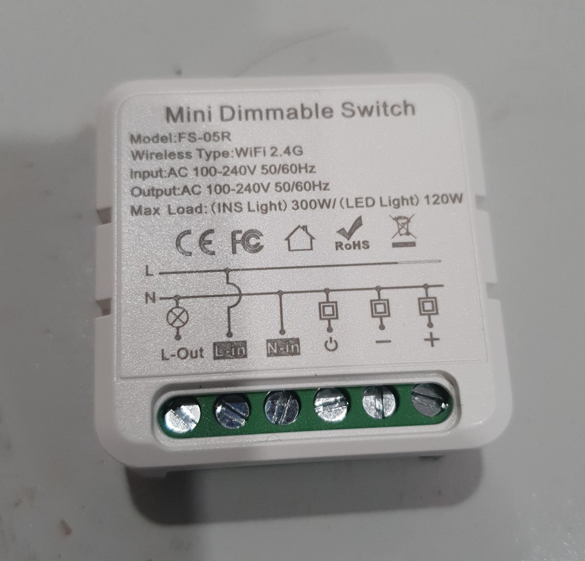

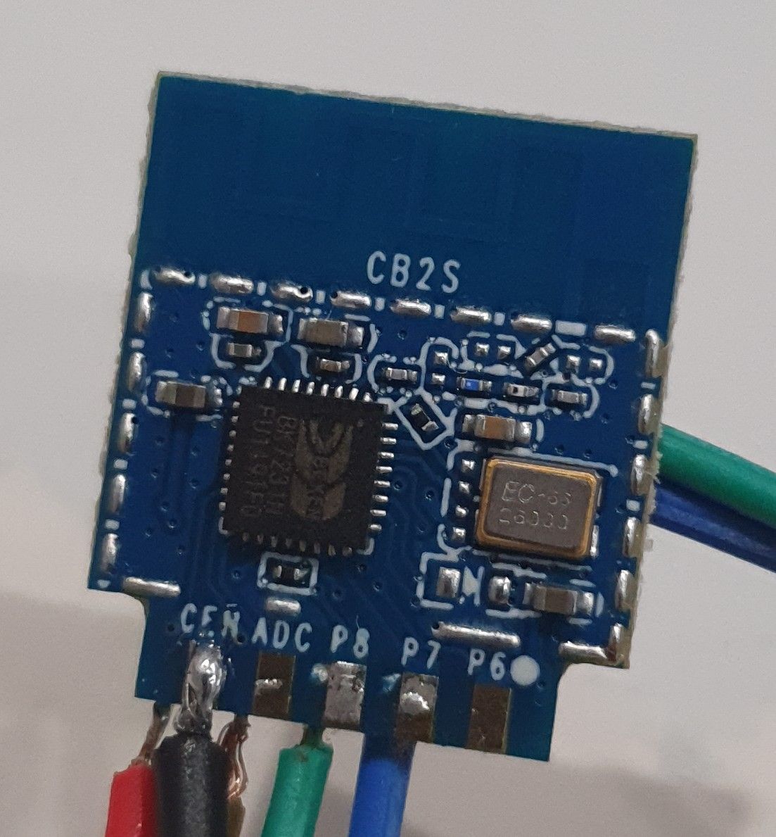

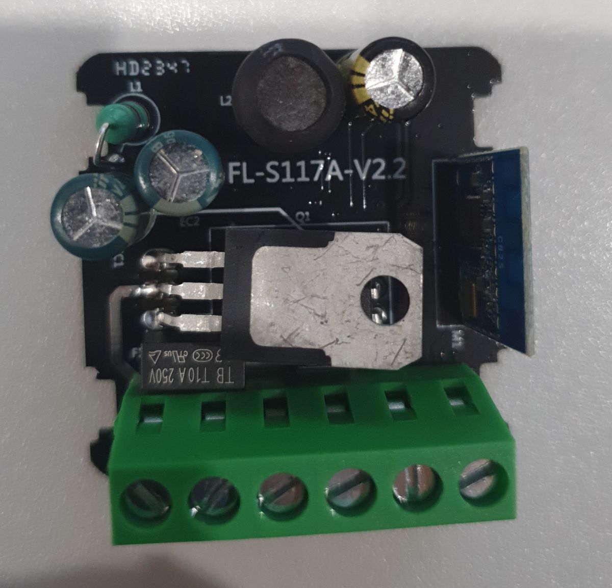

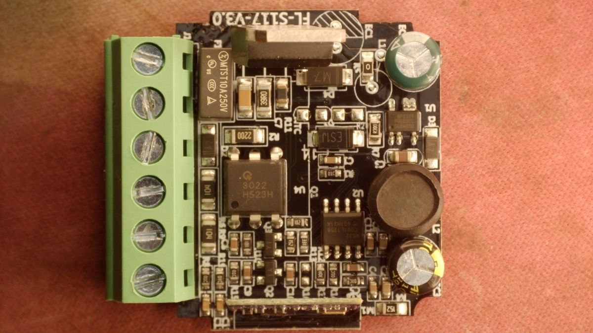

    I bought a couple of cheap Aliexpress Mini Dimmable (FS-05R) switches, hoping to either flash OpenBeken, or at worst replace the CB2S with an ESP alternative.

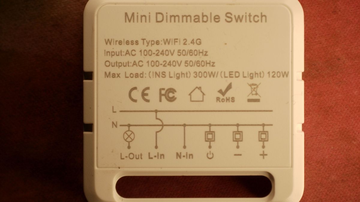

    Mini Dimmable Switch model FS-05R with technical information on the casing.

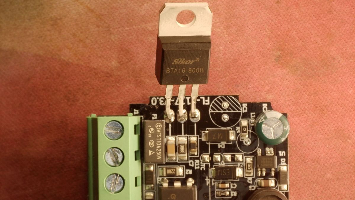

    Photo of an electronic module with components such as capacitors, a green terminal block, and a blue module labeled CB2S.
    PCB model: FL-S117A-V2.2
    Image of PCB model FL-S117A-V2.2 with various electronic components, including capacitors and a green connector.
    PCB of FS-05R switch from Aliexpress

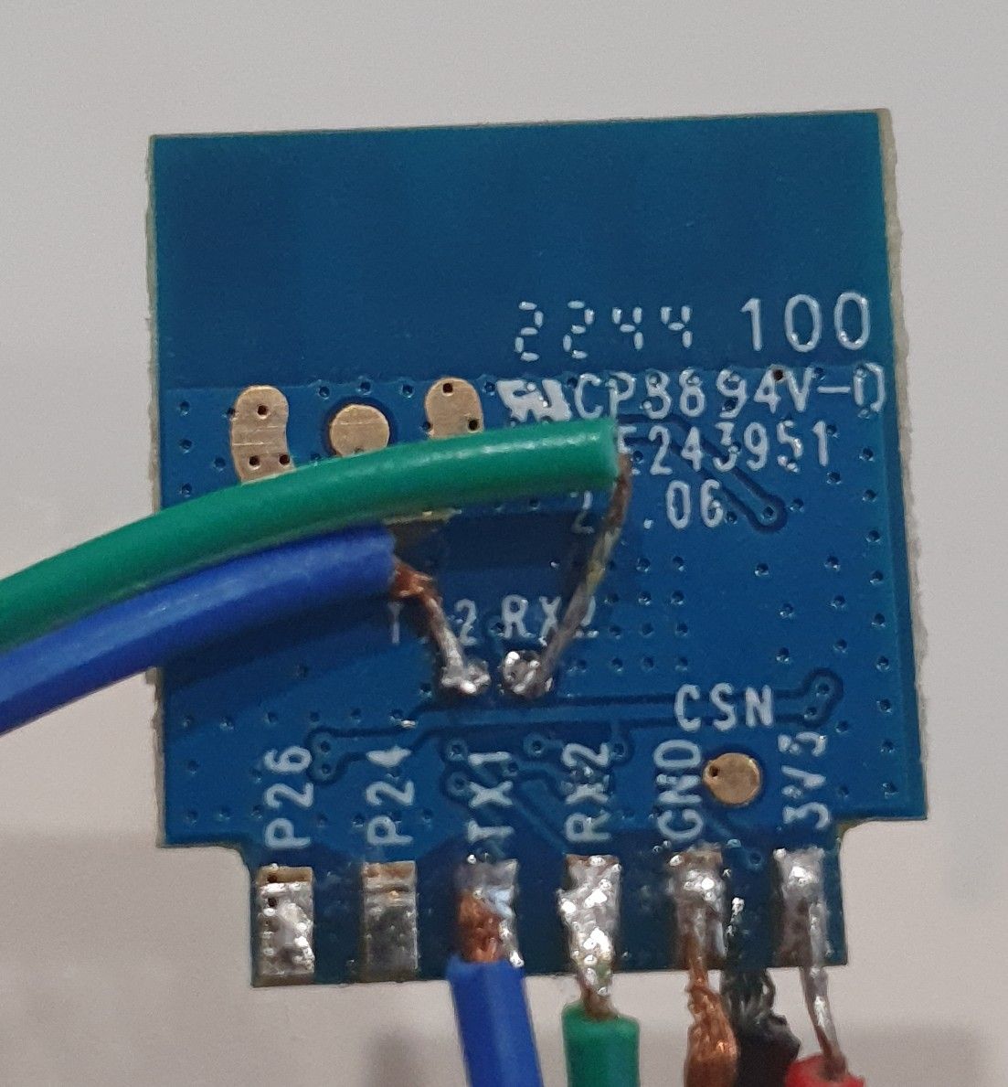

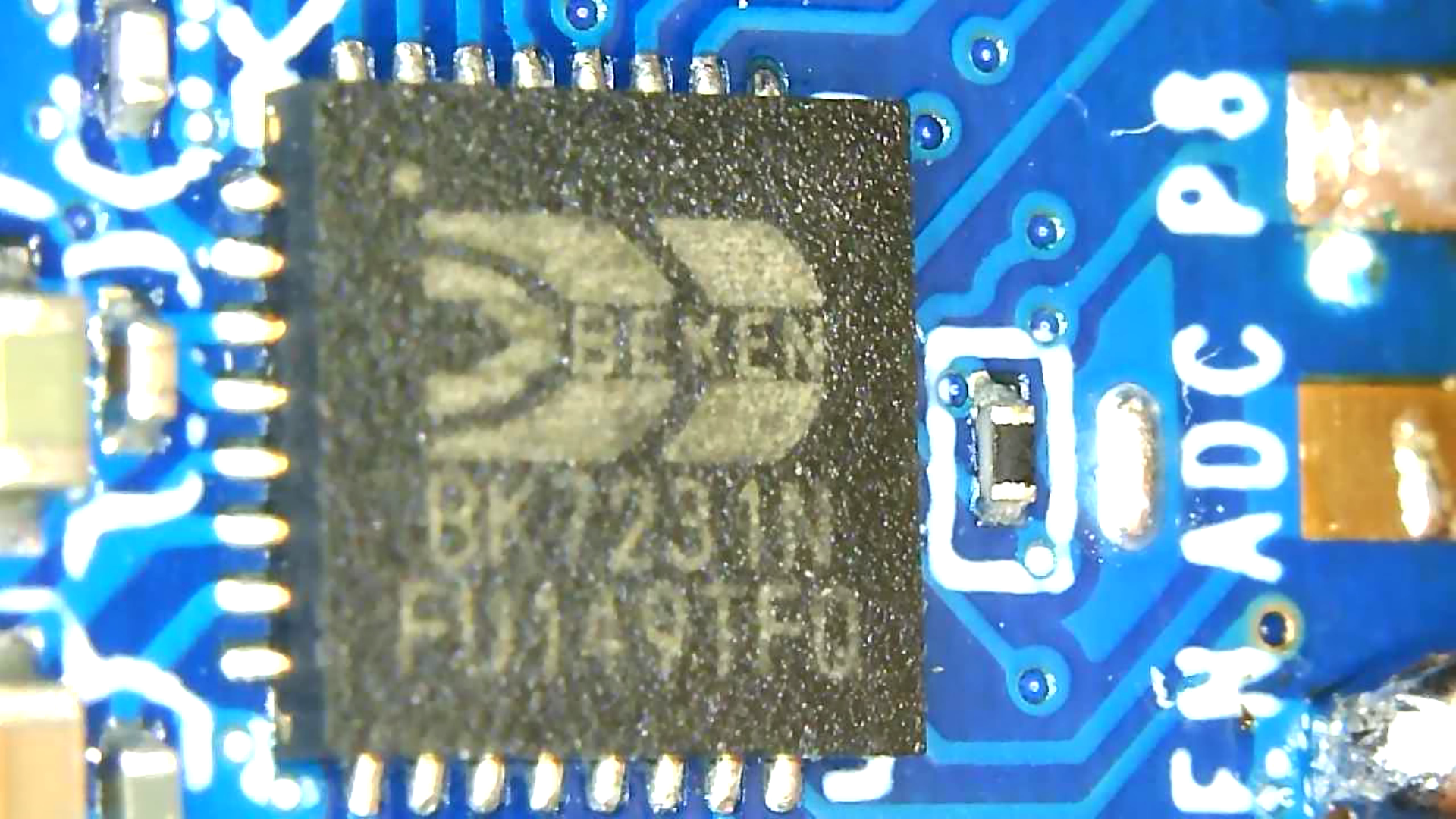

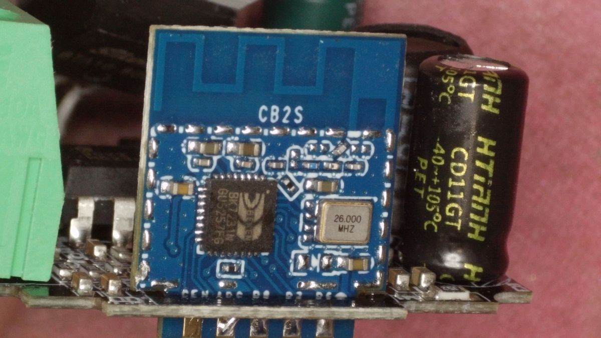

    Having desoldered the CB2S and connected to a USB-TTL there was no response to the BekenWriter and no amount of shorting the CEN pin to ground (or the CSN pin) made any difference.
    Watching the serial data, the device seems to just spam
    <0xff><0xff><0xff>......
    to eternity.
    That on both the TX1/RX1 pins as well as the TX2/RX2 pin

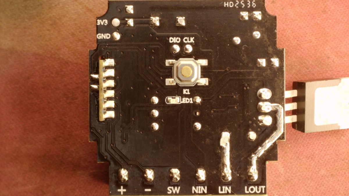

    Giving up, I decided to replace the chip with an ESP or other alternative, only to notice that the entire PCB seems to be printed mirror imaged to all the documentation.

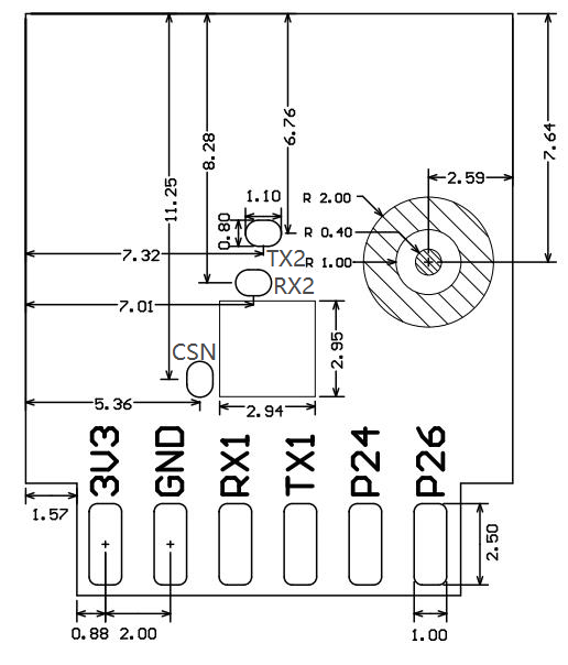

    All data I find on the internet shows the CB2S pins: 3V3 - GND - RX1 - TX1 - P24 - P26 from left to right, this one seems to be same order, but right to left.
    Close-up view of a PCB with connected wires.
    PCB labeled CB2S with visible components and connecting wires.
    Close-up of a Beken chip on a blue PCB.
    Also noting that the RX is actually labelled 'RX2', not 'RX1', I assume that's a typo.
    The mirroring makes any replacement, with something like an ESP-02S TYWE2S impossible.
    Has anyone come across this before?
    Is there something I'm missing?
    Also I've successfully flashed CB3S chips with OpenBeken in the past, so I'm not sure what I'm doing wrong here.

    Yes. I know this issue. I have experienced it myself already at least two times before.
    For example, in this topic:
    https://www.elektroda.com/rtvforum/topic4039890.html
    which is, actually, also about the FS-05R.
    The silkscreen on this device is incorrect. You need to ignore that.
    You need to assume the classic pinout like on Tuya docs:
    Interior of the FS-05R
    The first thing that catches your eye after looking inside is: invalid CB2S description layer : :
    Close-up of a blue PCB with a green screw terminal block and visible silkscreen showing pins.
    Location of 3.3V (VDD) and GND is incorrect .
    I`ve checked it many times, and it`s not the first time I`ve come across a poorly described CB2S, and I know that the correct schedule is available on the Tuya website:
    Pin layout diagram with dimensions for an electronic module.

    Oh wow.
    So simple, so logical and yet, I don't think I would have thought of this myself.
    But for anyone with the problem in the future....ignore the screen print, go with the connections as per datasheet.
    Thank you, and you've also just solved the next step of figuring out the TuyaMCU comms with your link.

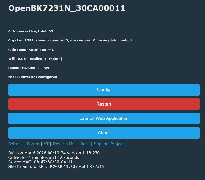

  • #5 21014712
    iotflasher
    The autoexec.bat script worked beautifully.
    A simple copy paste from your post and the dimmer worked as should.
    Thank you
    I did also add a couple of features (double click, click hold, etc) for the buttons.
    Making it work reliably from remote, as from local.

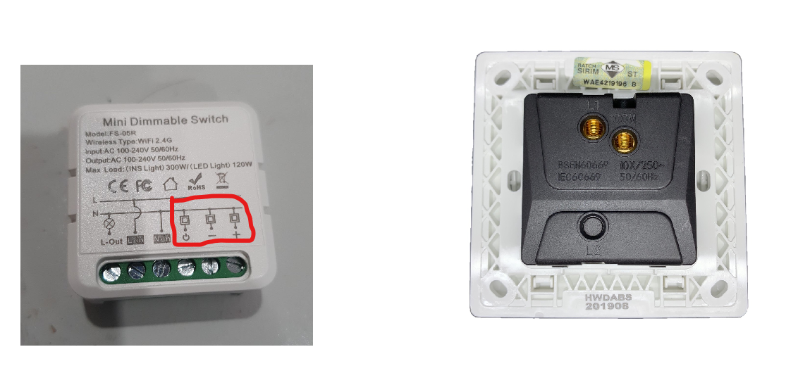

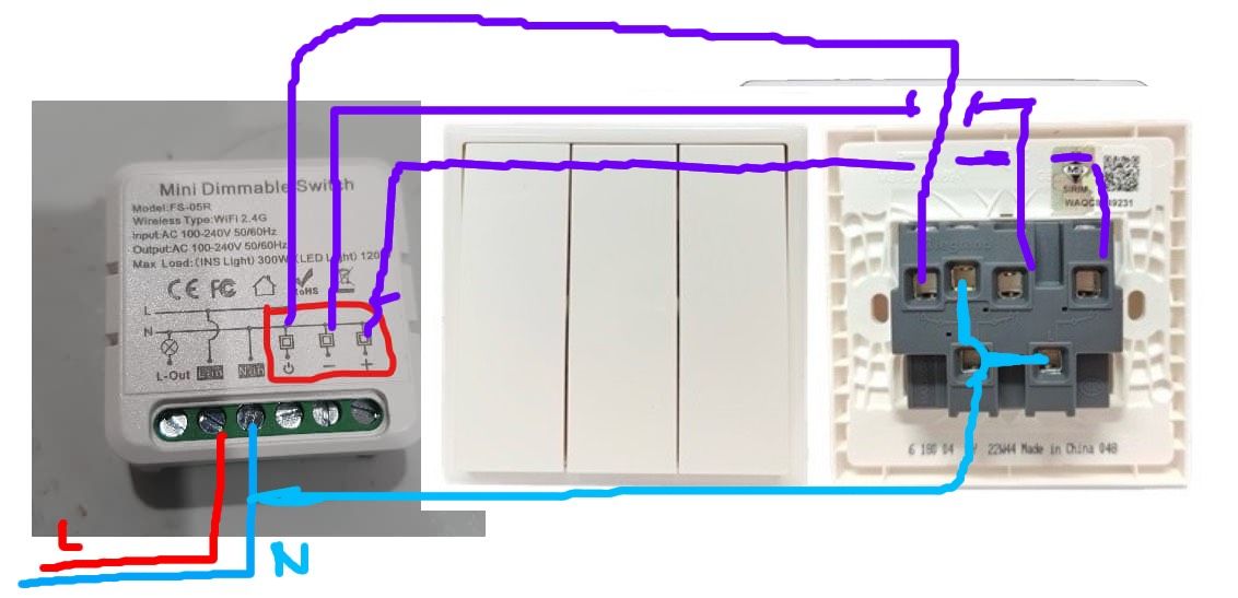

    Hi, how do you connect the dimmer to a momentary switch (with single pole)?
    Do you mind sharing the wiring connection? I'm not quite sure how to connect the 'power' terminal next to the '-' terminal.
    The image shows a mini dimmer switch and a single-pole momentary switch with connection terminals.
    Also, thanks for confirming that multipress works with tuya mcu, so you just can't decouple the relay for this dimmer right?

    I just need to figure how to wire it to momentary switch since I plan to use it for 2 way
  • #11 21200816
    Posts: 14611
    Help: 655
    Rate: 12629
    Wire it as in manual:
    https://obrazki.elektroda.pl/3676728400_1709365334.jpg
    and then set the role for appropriate OBK pin to "Button", I guess...

    @p.kaczmarek2 hi, it’s this pic I posted in previous post
    It’s a 1 gang momentary switch with 2 terminals in the back, unless i need a different switch for the dimmer
    Mini dimmer and momentary switch at the back with two terminals.
  • #15 21201830
    Posts: 14611
    Help: 655
    Rate: 12629
    Sure, so the configuration steps are:
    1. turn off the power
    2. connect a momentary switch between gpio output and N, like on image:
    Wiring diagram of a momentary switch to GPIO terminals.
    So there will be only two wires to the switch and switch will connect them when pressed.
    3. in OBK, set the Button role for the appropriate pin. You can also try using GPIO doctor if you are not sure which pin is used. But, as far as I know:
    so if "plus" pin is 26, then you can connect momentary switch as I said to 26, and it should work with Button role in obk. You can also use dInput role for debugging.
    Please try the following steps and let me know if it works, if not, we'll investigate.
  • #16 21202968
    ferbulous
    Posts: 419
    Help: 8
    Rate: 56
    @p.kaczmarek2
    Hi, is this the correct way to wire to the switch?
    It looks like I’ll need to use 3 button switch similar to other tuya dimmers for separate power, brightness up and dimming
    Two touch dimmer switches, black and white, compatible with Tuya, Smart Life, Amazon Alexa, and Google Home. Wiring diagram of a dimmer switch with highlighted wires.
    From the diagram it looks like the neutral’s bridged to the switch?
  • #17 21203044
    Posts: 14611
    Help: 655
    Rate: 12629
    It seems ok. How your switch looks like from front? It has 3 momentary buttons?
    With some more scripting, it should be possible to use one button - click to turn on/off, hold to adjust brightness.

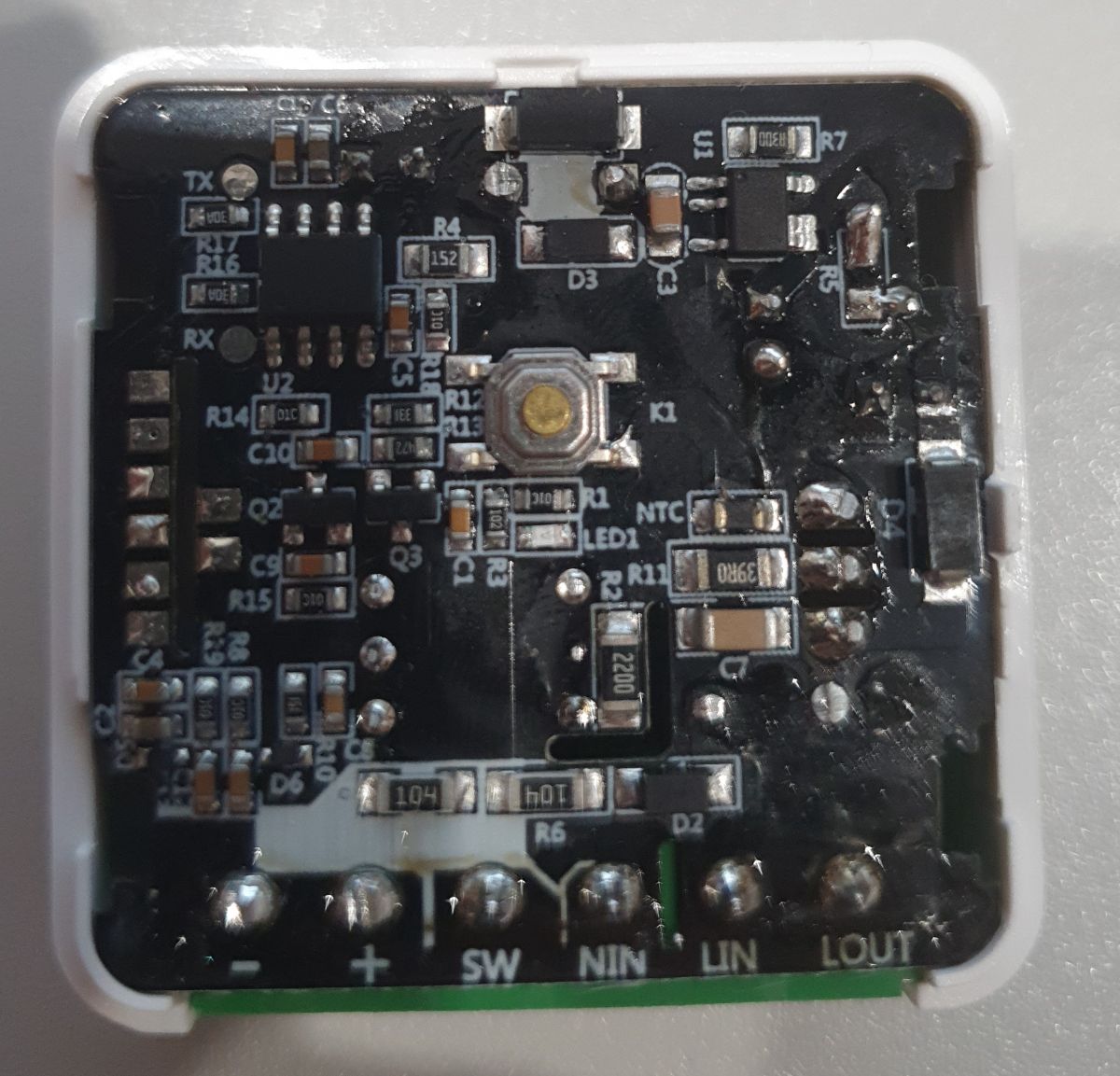

    So I don’t think my unit working
    This is straight out of the box with stock firmware and wiring just neutral & live doesn’t seem to turn it on/no led
    I’ll have to claim for replacement

    @p.kaczmarek2
    Haven’t wired it to the switch, but it doesn’t seem to turn on at all with just Lin and Nin wired.
  • #21 21204021
    Posts: 14611
    Help: 655
    Rate: 12629
    Uh, sorry, I didn't read your message well! Now wait a minute.
    It does not have a relay, so you won't hear a click.
    Can you connect a classic, dimmable (a LED one won't work unless marked as dimmable) bulb to the output and try again? How does the panel look in the app?
  • #22 21205179
    ferbulous
    Posts: 419
    Help: 8
    Rate: 56
    @p.kaczmarek2
    Doesn’t get detected by the app at all and there’s no led indicator blinking or anything.
    I’ve already got the refund, so I’ll open it up anyway if and flash openbeken if it does anything.

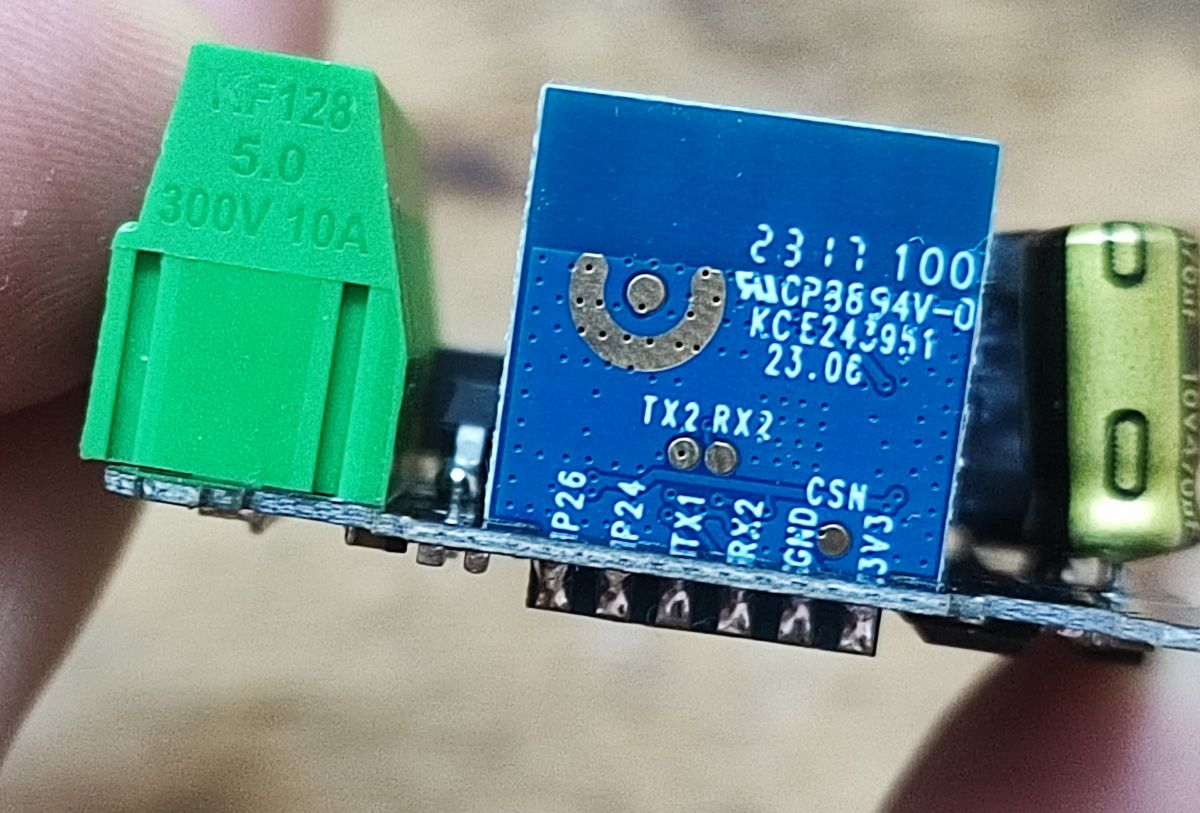

    I think I have a newer revision of the PCB.
    Blue CB2S PCB module with antenna trace and 26.000 MHz crystal next to a black capacitor Close-up of a PCB with a green screw terminal block and various electronic components Black PCB with K1 push button and pin labels: 3V3, GND, SW, LIN, LOUT Close-up of a PCB with a “BTA16-800B” triac and a green screw terminal block Close-up of a “Mini Dimmable Switch” housing with specifications and wiring diagram
    I'm not as knowledgeable as you. Is there no template setting for this device? I don't see a ready-made template for importing into the web app in this thread.
    no need to set any GPIO via template?
    now in the config I have:

    OpenBK7231N status screen with Wi‑Fi and chip temperature info and Config/Restart buttons
