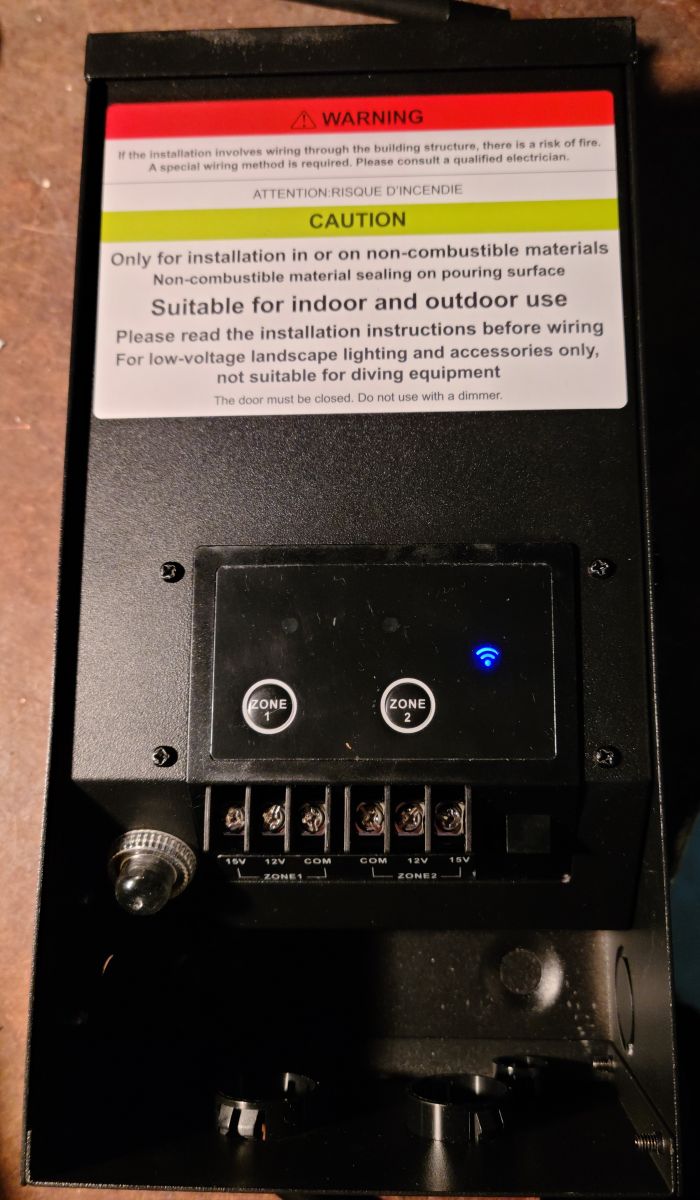

    Added after 32 [minutes]:
    Low-voltage transformer housing with warning panel and control buttons. Main board of a Wi-Fi transformer with visible connectors and electronic components. Close-up of a motherboard with soldered wires and visible components.

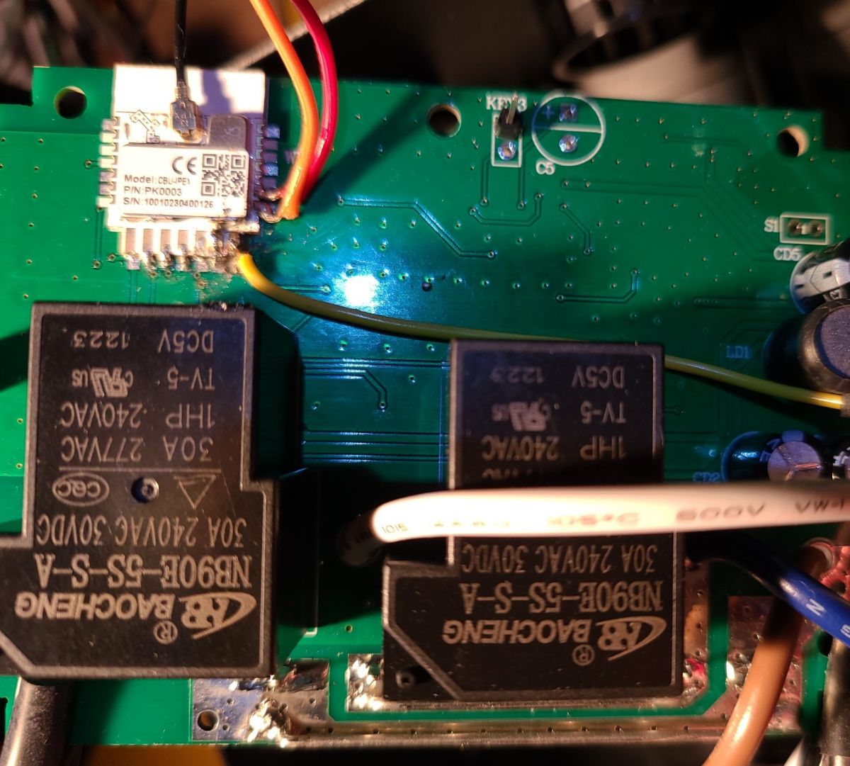

    It's easy to open the case and access the mainboard, taking care not to damage the antenna cable that runs from the antenna at the top of the enclosure. It can be disconnected by prying it off.
    To flash, I soldered wires to the module's pin 14 (3V3), 15 (TX1), 16 (RX1), and GND by soldering a header pin to one of the unpopulated through-holes at KEY3. I could also have soldered pin 18 (CEN) for good measure since it's needed for flashing, but ended up just touching a wire to the pad.
    The SoC pins are connected as follows:
    P6 WiFi LED (inverted)
    P7 Zone 1 button
    P8 Zone 2 button
    P24 Zone 1 relay and LED
    P26 Zone 2 relay and LED
    And the config:

    Well, if flashing worked in N mode, then T will not work anyway, because N mode sends a flash unlock packet that is not handled by T. Anyway, that's not imporant anymore since I can see you managed to get it running. Good job!
    This device have many more accessible pins, it seems you could easily use them to extend the functionality, add DHT11 or anything.
