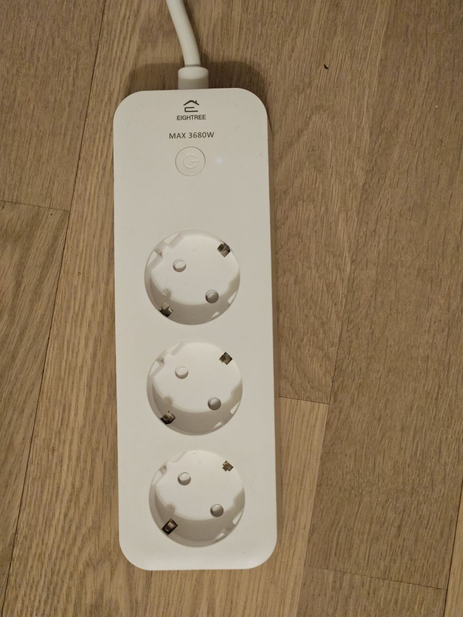

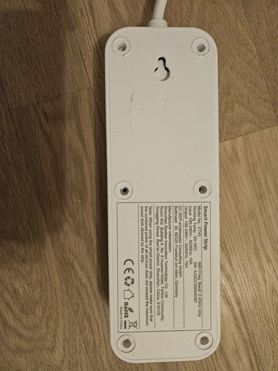

    Teardown of Eightree Smart WiFi Power Strip with 3 AC Ports, 16A.
    Bought on Amazon in December 2024, ASIN: B0C6X3YWTZ.
    It has 3 independent AC slots and energy consumption monitoring.

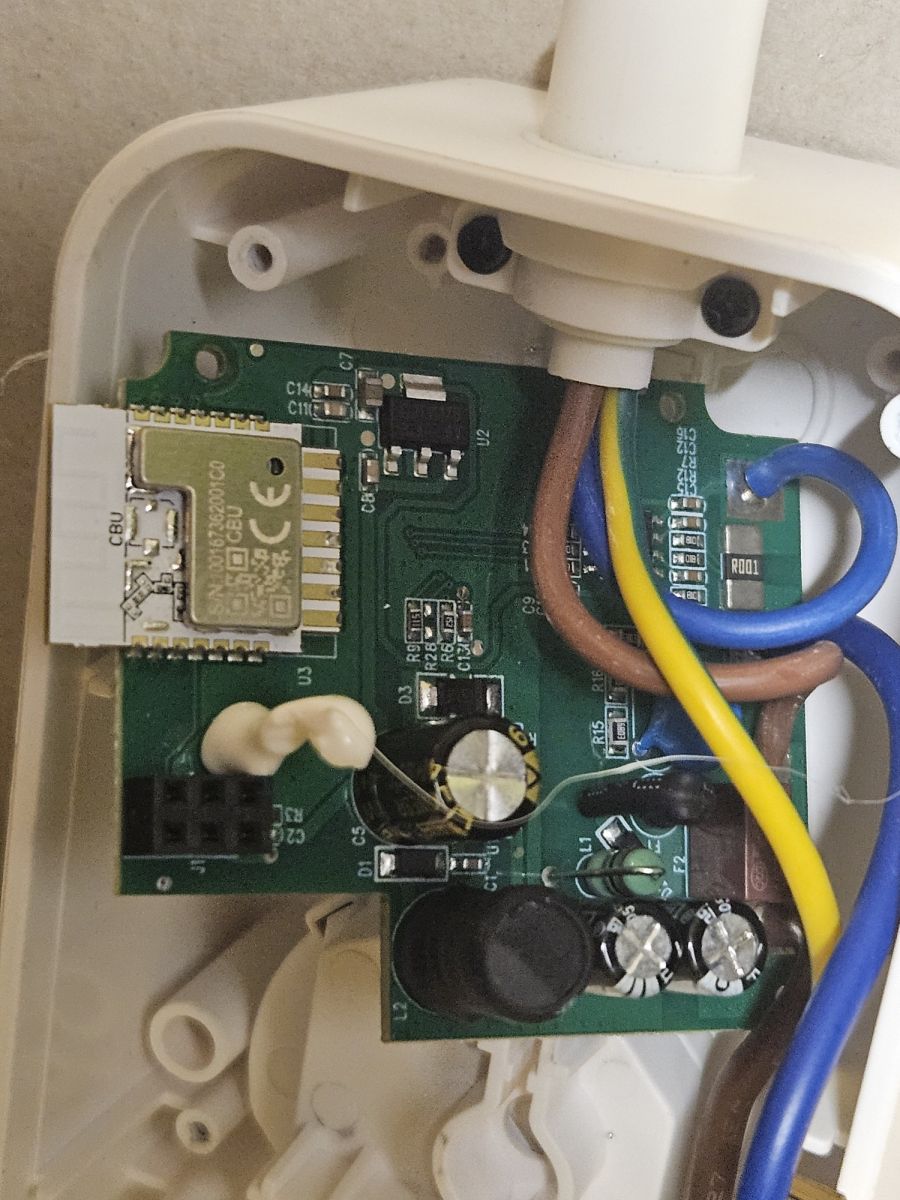

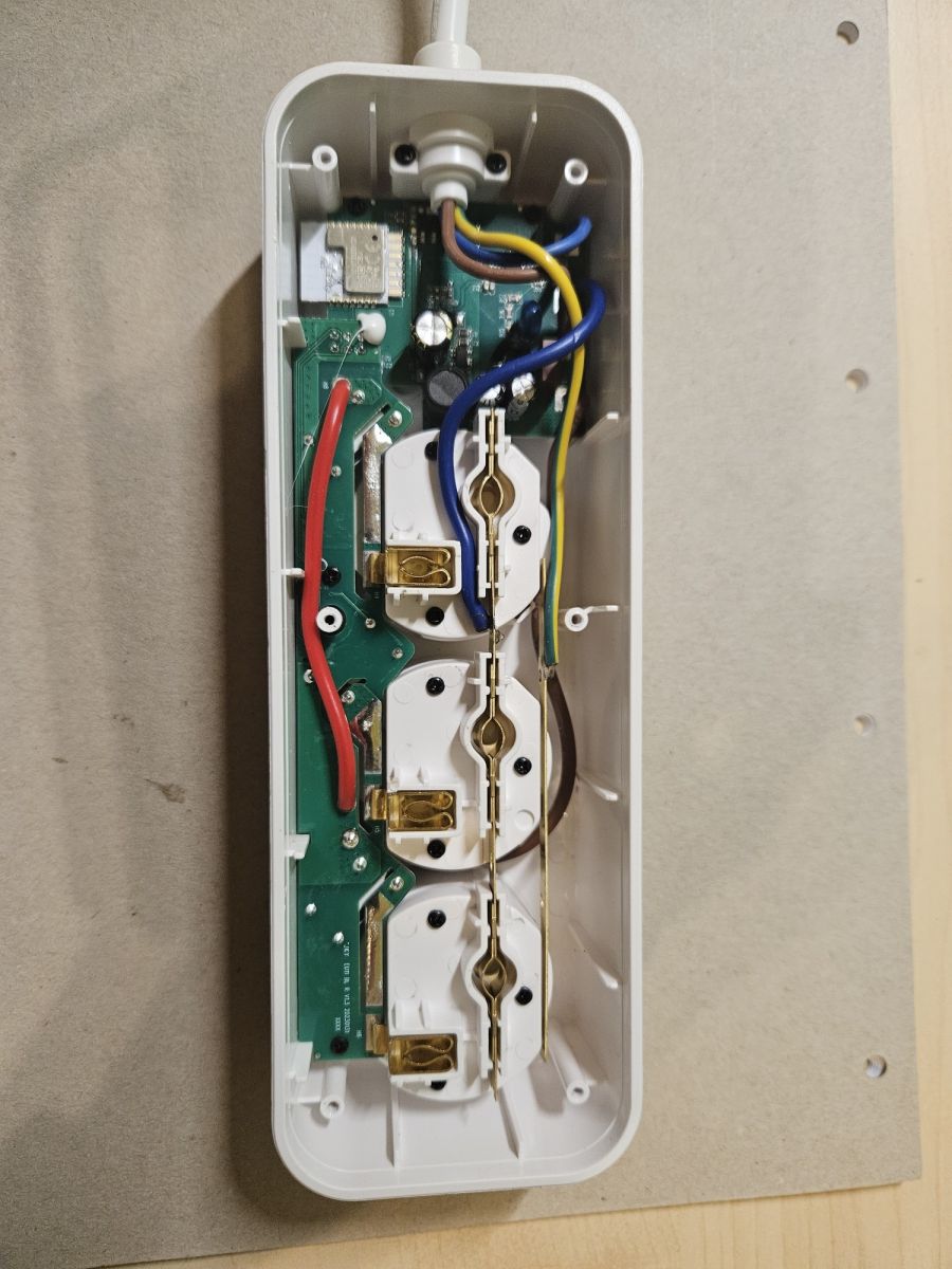

    To open the device, remove the white pads and the 6 tri-angle (TA) screws.

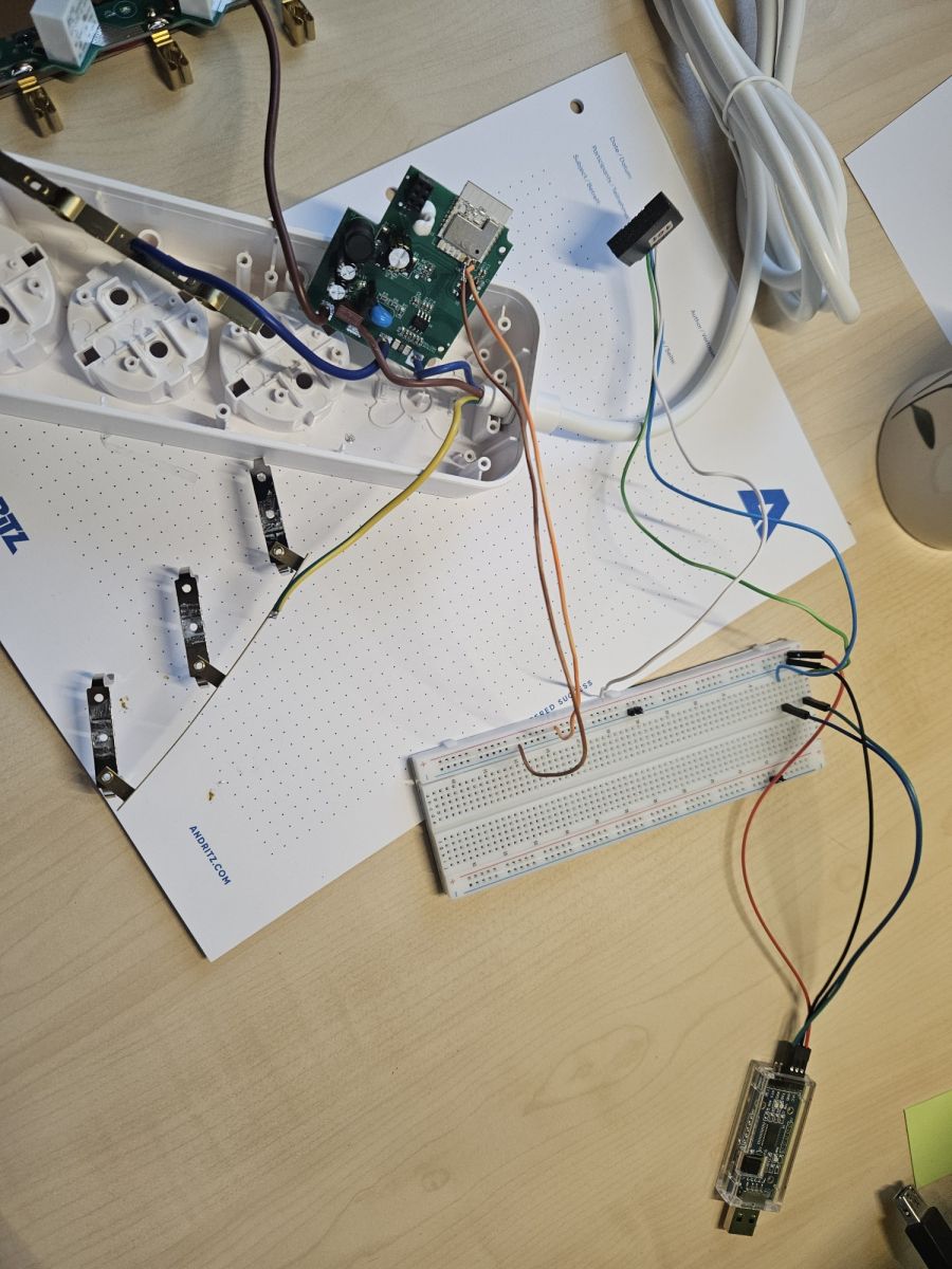

    Flashing
    Was able to flash using a USB to Serial Adapter and BK7231GUIFlashTool.
    The schema from here seems correct:https://docs.libretiny.eu/boards/cbu
    I tried it without soldering using this flashing jig (https://www.printables.com/model/763948-tuya-cbu-flashing-jig) but was not successful.
    Soldering VCC and GND and for RX, TX and CEN holding it with the flashing jig worked. Reboot by connecting CEN (PIN18) to GND.

    Device seems to be using CBU module, which is using BK7231N.
