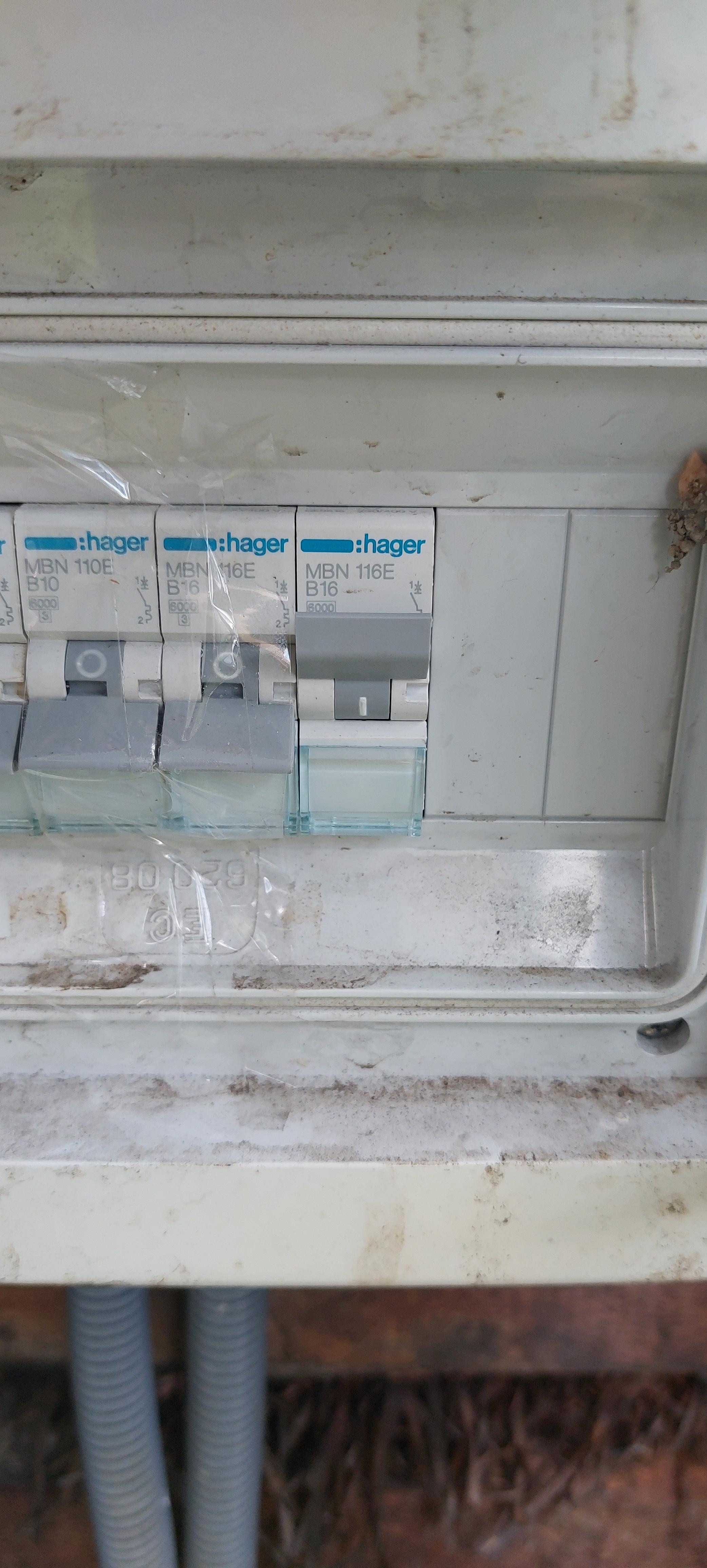

    Hi. I have a box like the one pictured and now I want to replace the last switch with another - with wifi which I can control from anywhere. And now the question is whether such a switch as in the link will pass the test?
    Link
    And maybe you have some other solution? I would like to be able to switch on and off mobile as well as physically on site or can you suggest what kind of wifi switch would work? Thank you in advance

    Yes, that's what you're looking for.
    For the safety of the powered circuit, I would recommend not removing the existing overcurrent protection, just add this circuit breaker on WiFi in series.
    In the middle you only have a relay without a short circuit arc extinguishing circuit. He is a fuse in name only.
    In the switchgear you have 2 free spaces so do not deprive the circuit of proper protection.
