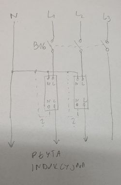

    I am planning to implement in the switchgear. I would like to keep it relatively simple and at a relatively low cost. Space is also limited. The board is connected to a 3-phase network. Standard, that is, in fact, to two phases (2x230V, L,N), the oven and microwave are powered from the third.
    I have found single-phase wifi modules with current/power measurement and shutdown. Of course you will need two. E.g. such:
    Monitoring and switching off the induction hob over wifi (2 phases). How to implement?
    https://pl.aliexpress.com/item/1005005625395611.html
    In principle, judging from the description, these are "230V sockets with wifi", only that they are DIN rail mounted. However, I have doubts about the connection and "will it even work", which I have shown in the diagram below:
    As you can see, the power "enters" via a B16 three-phase fuse. Then two phases to the board via the modules, each input "at the top" connected to the correct L and N. And here is the dilemma - the N "goes" towards the kitchen, past the fuse, as one common wire.
    The L output "at the bottom" of the module - known, to the board.
    But what about the N output on the module? Leave it unconnected? What about current/load measurement then? Will it work? (presumably depending on where the measuring shunt is located - "in L or in N"?) Or also connect to the neutral wire running to the board? That is, de facto short circuit to the N connected to the input ("at the top") of the module, as I have drawn a line with a question mark?

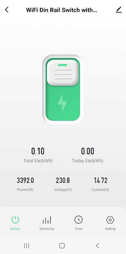

    Since it has been said a , it would be appropriate a , or even b ;-) Small report for posterity.

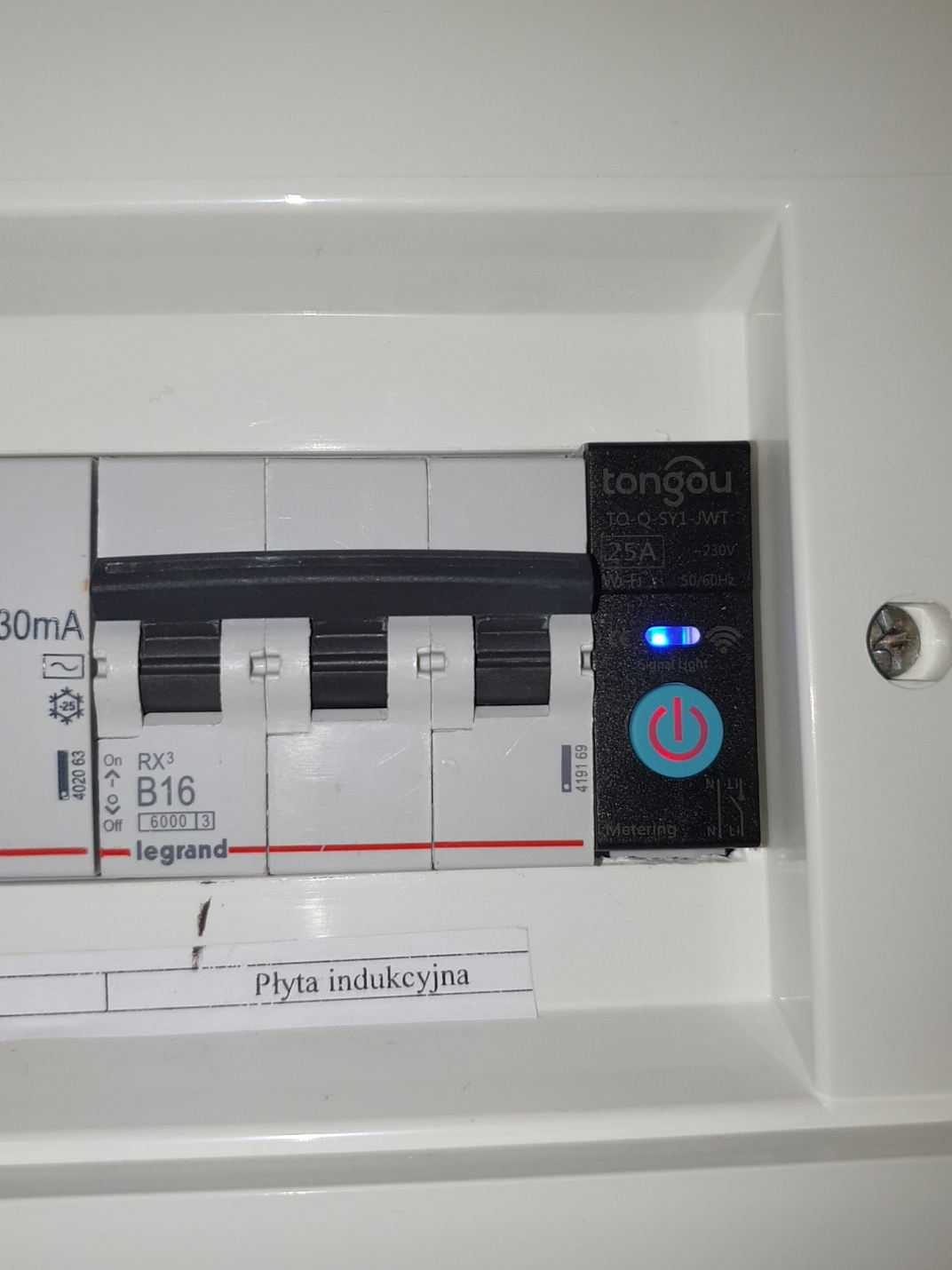

    The switch has arrived, mounted in the switchboard for a good few days. I ordered the 25A version with metering, such as shown in the first picture in post #1. I hope the Chinese amps will "do the job" since the overcurrent protection is 16A. I bought one module for the time being, as even with a 2-phase power supply to the board it is enough to disable ("reset") the control. I mentioned in a previous post. My doubts from the first post about the connection of the neutral wire were also clarified. It turned out that the "N" input and output are permanently connected inside the switch. This is even drawn on the front panel, I had not noticed when looking at the offer.
    Close-up of the front panel of an electrical switch with N and L markings.
    N output side in my case I left unconnected of course. There are even versions of similar modules (I already noticed after ordering) that do not have N on the output. That is, you can see right away that all switching and current measurement takes place "in phase" and the neutral is only used to power the device. Example:

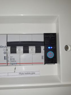

    Well, the switch just... works. It seems to meet my expectations. I just configured it to always set itself to "ON" after a power failure/recovery, and always apply power to the board in that situation.
    Because the module has a power/voltage/current measurement, I have tried a little as an exercise to create scenes in Tuya that will switch off the hob after a certain time after switching it on (for now I am starting to play "with these blocks" in general, i.e. smart-house elements in general) . My induction hob does, admittedly, have factory safeguards of this type, but they are dependent on the power setting. At maximum power and user inactivity it will heat for 1h, at minimum 6h. Regardless of the power setting, I would like to limit the time to, for example, about 1.5h. An interview with a person who uses ;) most frequently showed that such a time is very rarely exceeded, even when cooking on "low heat".
    While the first tests still on the workbench with the light bulb were promising, unfortunately not so much with the actual load, as I expected. The point is that induction works on an "impulse" basis, in the sense that the average power is achieved by alternately switching the heating on and off. Similar to an iron or oven. In such a system, the switching on and off of the hob is detected repeatedly during cooking. However, for the time being, I have made a simple scene that detects the power consumption and sends a notification to the phone. And the fact that it sometimes does this a few times while the hob is running - hard, I don't mind. At least for now ;)
    Here as a curiosity: as I mentioned several times, the module is installed on one of the phases, so it measures/controls the power of half of the hob (two fields). However, I noticed that if I start heating on the fields connected to the other one phase, i.e. theoretically not covered by the measurement, nevertheless the module starts to show power in the order of a few dozen watts. That is, in this case too, I get the information that the board is on, something is happening. And that is enough for me :)
    Finally: I realise that the idea and application is rather niche. I may never have to use the remote shutdown option (hopefully). On the other hand, the implementation is simple and at a relatively low cost, circa PLN65. A few years ago, it would have been perhaps not impossible to do "something like this", but certainly more difficult and expensive. And almost certainly not of this size and mounted on a standard DIN rail.
    Footage of the module in the switchgear:
    Tongou switch module installed in an electrical distribution board.
    Screen from the application, when both fields of the phase board controlled by the module are switched on to maximum. As you can see the power is ;-) Screenshot of an app displaying a WiFi DIN rail switch with power measurement. .
