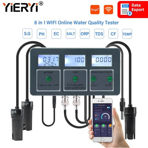

    BluesBlossons
    Product:
    Yieryi PH-218 / GLGAX-055230
    https://th.aliexpress.com/item/1005005050891706.html
    Chip: CB3S
    Easy flashable.
    Pin 3 needs needs to be shorted to start read/write
    3.3V to the motherboard needs to be removed for successfull reading or writing.
    View of the interior of an electronic device with a PCB and WiFi module. Yieryi 8-in-1 WiFi water quality tester with LCD display and smartphone app.
