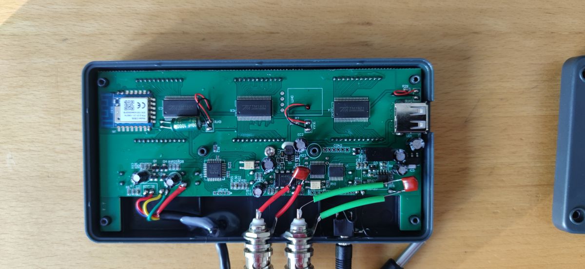

    Hi there,
    I am interested to change Firmware of my PH-W218.
    There is an CB3S Chip on the Board.

    What is the best way, to start with that new Device? I am already familiar with ESPHome and Home Assistant.
    Close-up of the interior of a PH-W218 device showing a CB3S chip. Display of a PH-W218 water quality tester with three screens.

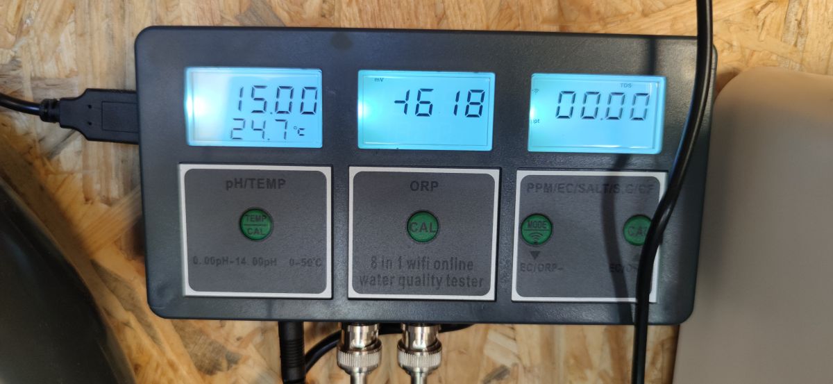

    Good morning,
    First of all, thank you very much for your support.
    I still have a question that is bothering me and to which I have not found an answer.
    The device has 3 displays. Do I have to control these via Openbeken or will the display remain as it is with the original firmware?
    Can this be answered in general terms from other projects?
    Have attached a new Image in the First Post.
  • TuyaMCU keeps display working after OpenBeken flash

    Please consult TuyaMCU guide:
    TuyaMCU flashing, setup and configuration guide - configure dpIDs for Home Assistant
    TuyaMCU devices works in such a way that WiFI module only does the communication and the secondary MCU does all the processing. So, displays will keep working after migrating to OpenBeken, as in the original firmware, we just may need to configure OBK to send the require data to displays, but most of the data should be handled by the MCU itself.

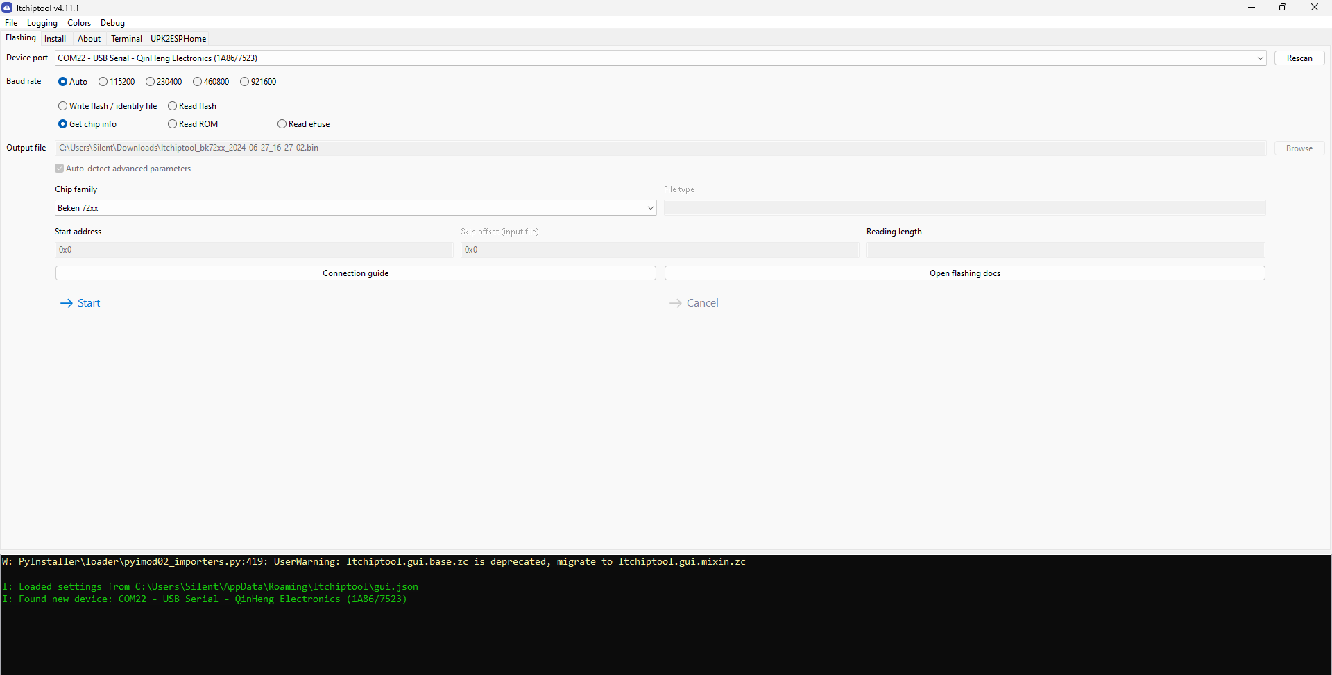

  • ltchiptool wiring and chip info steps for CB3S
    #8 21134490
    Nordlicht77
    Posts: 67
    yes, everything can still be operated on the display
    After you do that TuyaMCU guide have processed
    Please download ltchiptool
    And connect the following pin
    CB3S FTDI
    TX -> RX
    RX -> TX
    GND -> GND
    VCC -> VCC
    Then try the following setting, see picture
    Screenshot of ltchiptool v4.1.1.1 program with settings for device operation.
    Press start and then pull VCC from FTDI
    If you also receive a window with chip data, we are one step further
    Try with 3 volts and if it doesn't work with 5 volts
    I want to know if it was just a coincidence for me, make sure the Get Chip Info item is selected

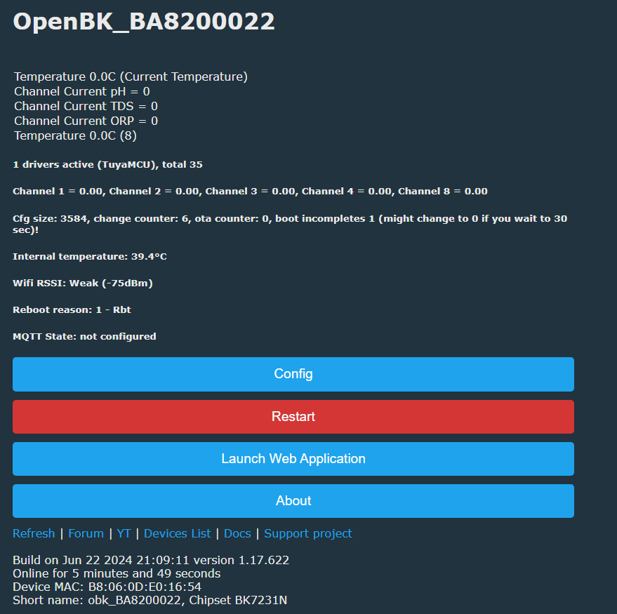

  • TuyaMCU outputs still read as zero values
    #13 21134942
    Upright6771
    Level 4  
    Posts: 20
    Yes, I have a backup, but device was connected with tuya cloud.
    My first autoexec.bat looks like:
    // Start TuyaMCu driver
    startDriver TuyaMCU
    // set TuyaMCU baud rate
    tuyaMcu_setBaudRate 9600
    // set TuyaMCU default wifi state 0x04, which means "paired",
    // because some TuyaMCU MCUs will not report all data
    // unless they think they are connected to cloud
    tuyaMcu_defWiFiState 4
    // temp_current
    setChannelType 1 temperature
    setChannelLabel 1 "Current Temperature"
    linkTuyaMCUOutputToChannel 6 val 1
    // ph_current
    setChannelType 2 ReadOnly
    setChannelLabel 2 "Current pH"
    linkTuyaMCUOutputToChannel 106 0 2
    // tds_current
    setChannelType 3 ReadOnly
    setChannelLabel 3 "Current TDS"
    linkTuyaMCUOutputToChannel 111 0 3
    // orp_current
    setChannelType 4 ReadOnly
    setChannelLabel 4 "Current ORP"
    linkTuyaMCUOutputToChannel 131 0 4
    But the Result:
    Screen of the OpenBK_BA8200022 interface displaying channel data and configuration options.
    Questions:
    1) Why are all values = 0?
    2) Where is Temperature 0.0C (8) come from? <- solved by myself by define the Channeltype in the Config Tab
    In the Log Browser, I can see some things like this: Info:TuyaMCU:Received: 55 AA 03 00 00 01 01 04
  • Incorrect channel types causing pH and TDS scaling errors
    The 0 here (raw) does not look correct.
    Can you try adding quering the state to see if it updates the values? tuyaMcu_sendQueryState
    You don't need tmSensor on non-battery powered device I guess.

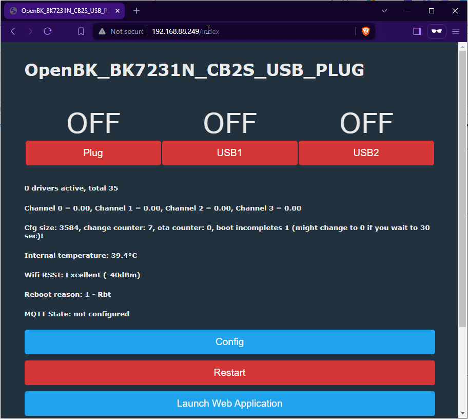

    Posts: 5213
    Help: 446
    Rate: 914
    you could always upload the config file though
    OpenBK_BK7231N_CB2S_USB_PLUG user interface with control options for the plug and USB ports.

    I think you also have the values ​​problem with the point and that
    Apparently PH TDS and other water data icons are missing in the firmware
    There will definitely be more different devices to come
    I wrote about it in my config as it currently is in Gui
    and underneath as it should be
    //currently : Temperature 389.0C (PH current)
    //correct: 3.89 PH (PH current)

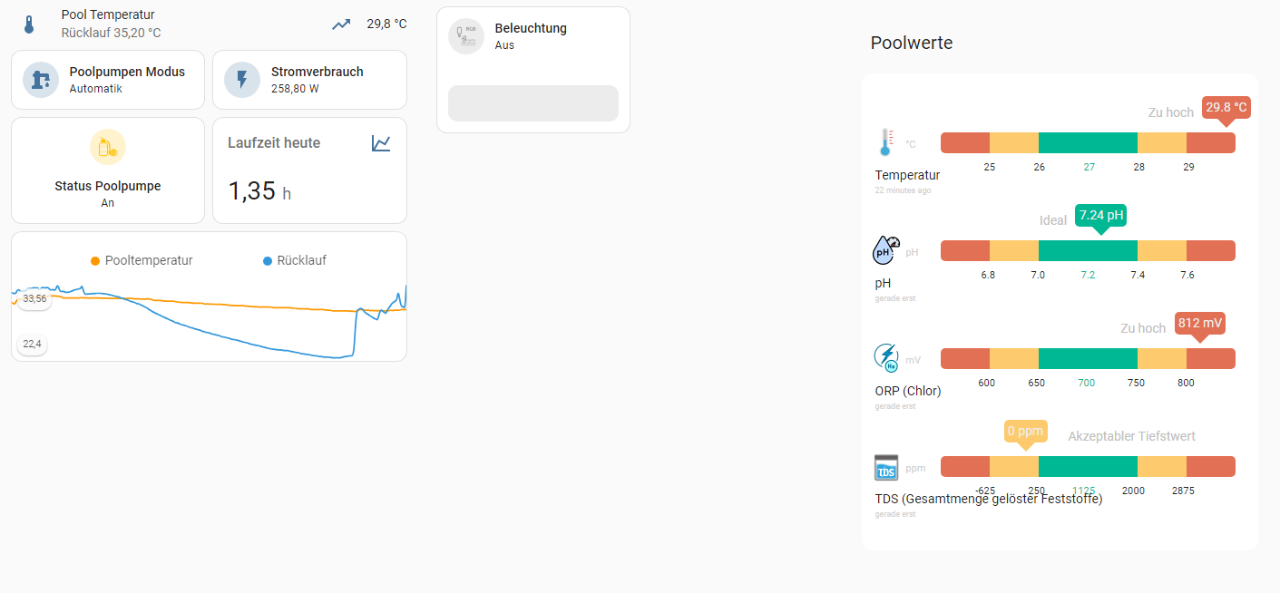

    Hinzugefügt nach 2 [Stunden] 15 [Minuten]:
    New Update.
    I can set tuyaMcu_defWiFiState 4, but nothing happens (log say OK)
    BUT: After I configure my mqtt credentials, the CHannels will be filled with values.
    Now I have configured all Channels. Maybe it could help, that there are readOnly_div10, readOnly_div100, readOnly_div1000. After that we can finetune, to add new types for orp, salt and so on :-)

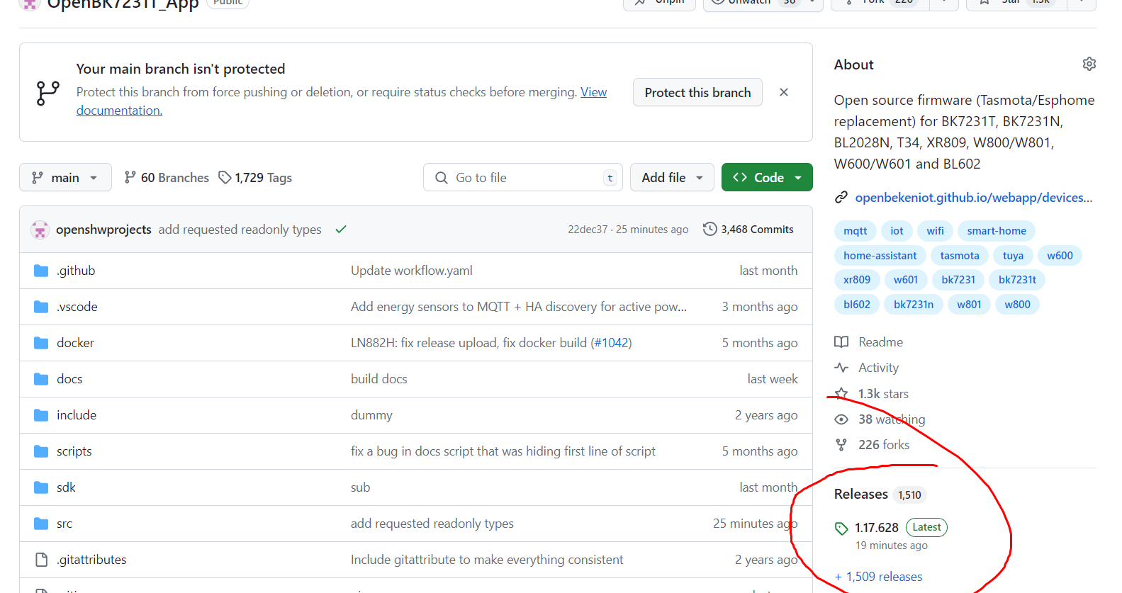

    Posts: 14756
    Rate: 12881
    This is a public commit, so you can just do OTA to latest release:
    Screenshot of a GitHub repository showing file and release information.

  • TuyaMCU heartbeat and product info invalid
    #30 21139852
    Nordlicht77
    Posts: 67
    I no longer get any data via sendQueryState
    clearConfig didn't work either
    tuyaMcu_sendRSSI
    Info:CMD:[WebApp Cmd 'tuyaMcu_sendRSSI' Result] OK
    Info:MAIN:Time 474, idle 190057/s, free 73584, MQTT 0(29), bWifi 1, secondsWithNoPing 400, socks 2/38
    Info:CMD:[WebApp Cmd 'tuyaMcu_sendQueryState' Result] OK
    Info:MAIN:Time 703, idle 206017/s, free 73400, MQTT 1(41), bWifi 1, secondsWithNoPing 629, socks 2/38
    It could be that something is wrong here
    ExtraDebug:TuyaMCU:TuyaMCU heartbeat_valid = 0, product_information_valid=0, self_processing_mode = 1, wifi_state_valid = 0, wifi_state_timer=0
