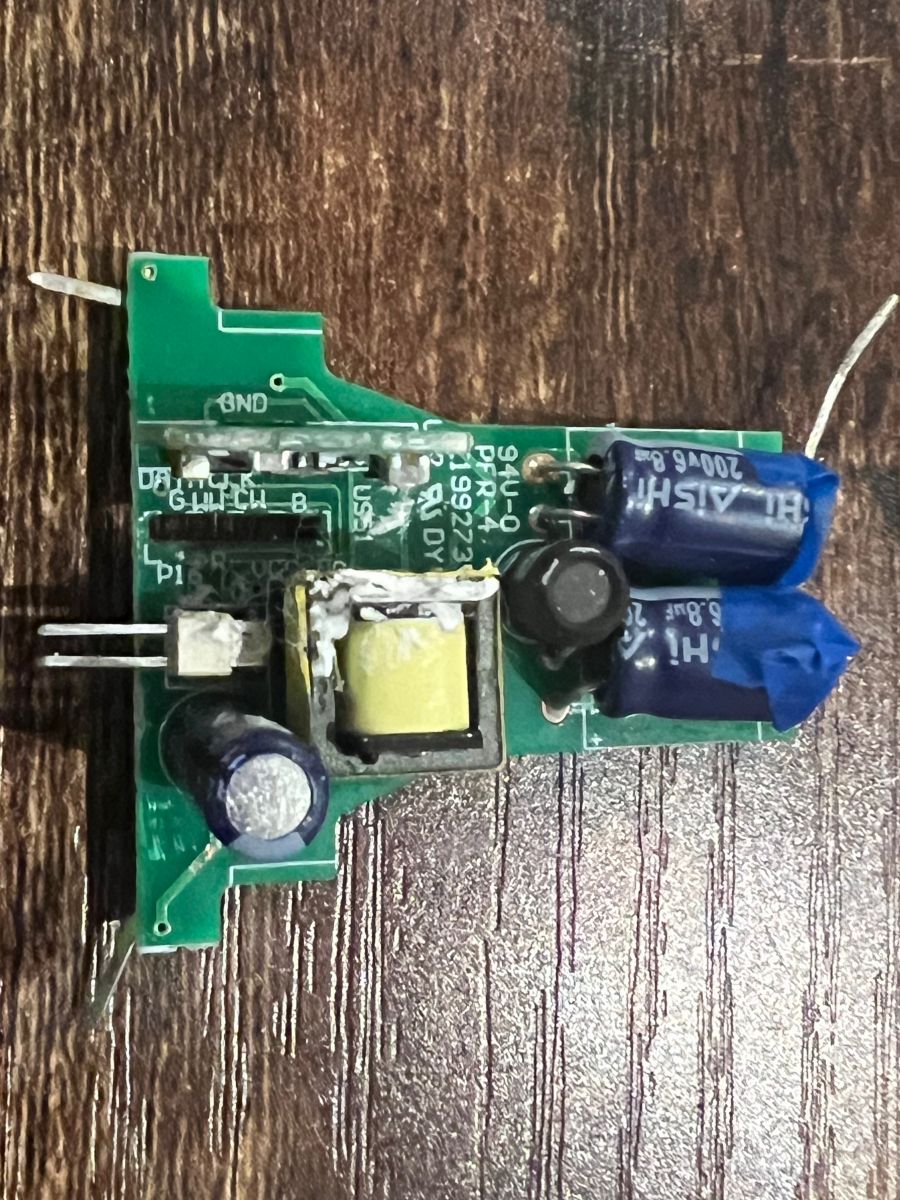

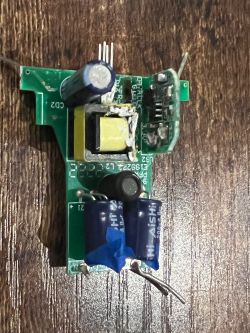

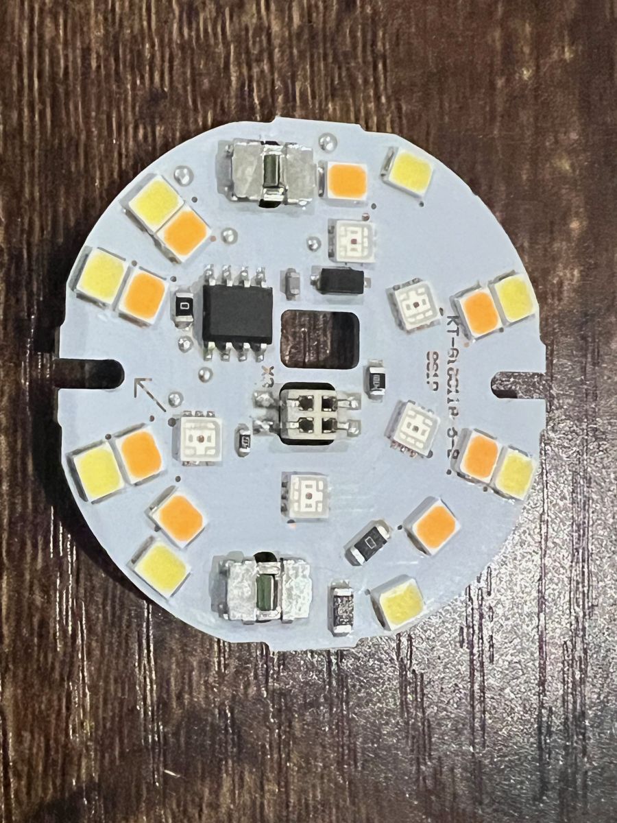

  • The Anwio AN-G250-1XD W 120V LED bulb with Tuya WBLC9 was torn down and flashed.

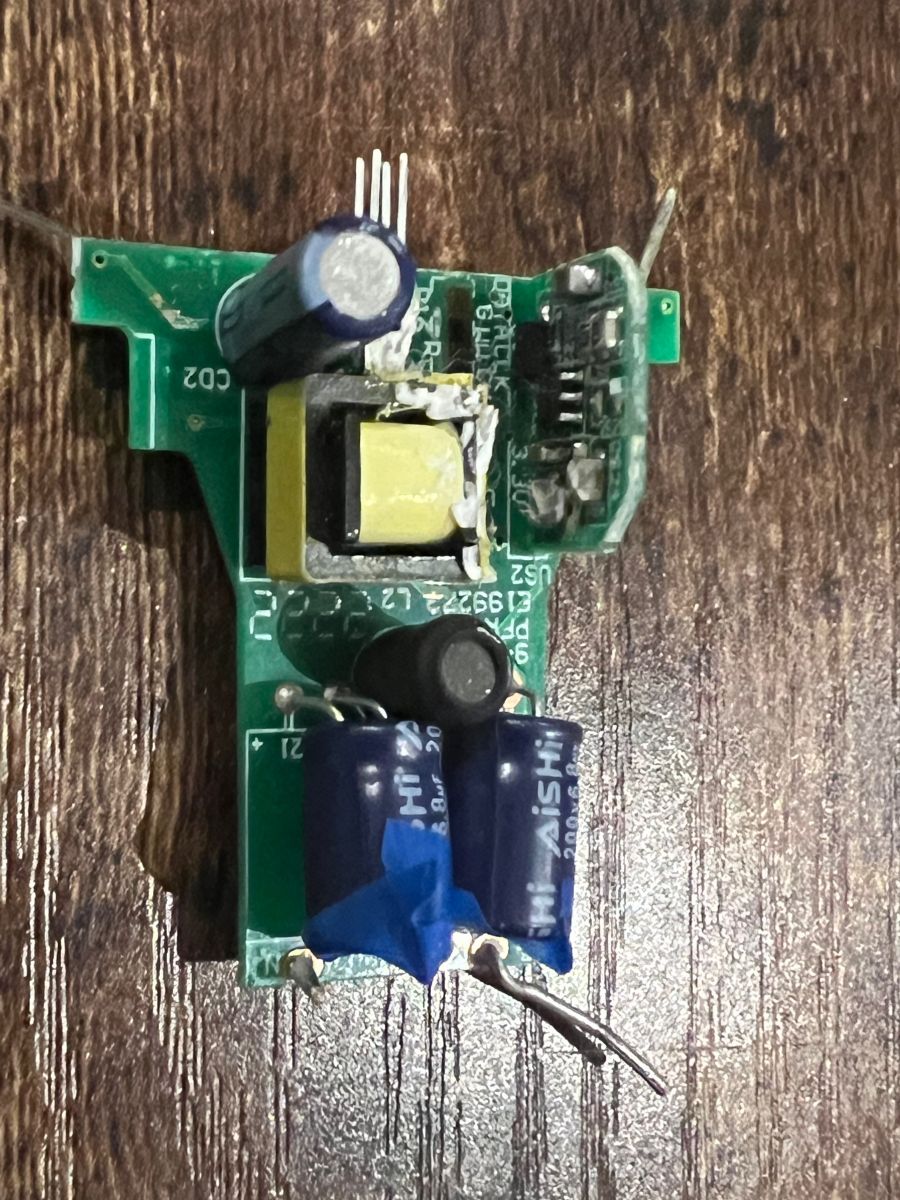

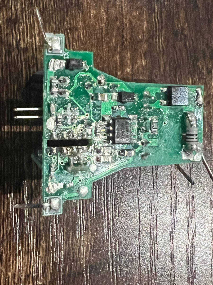

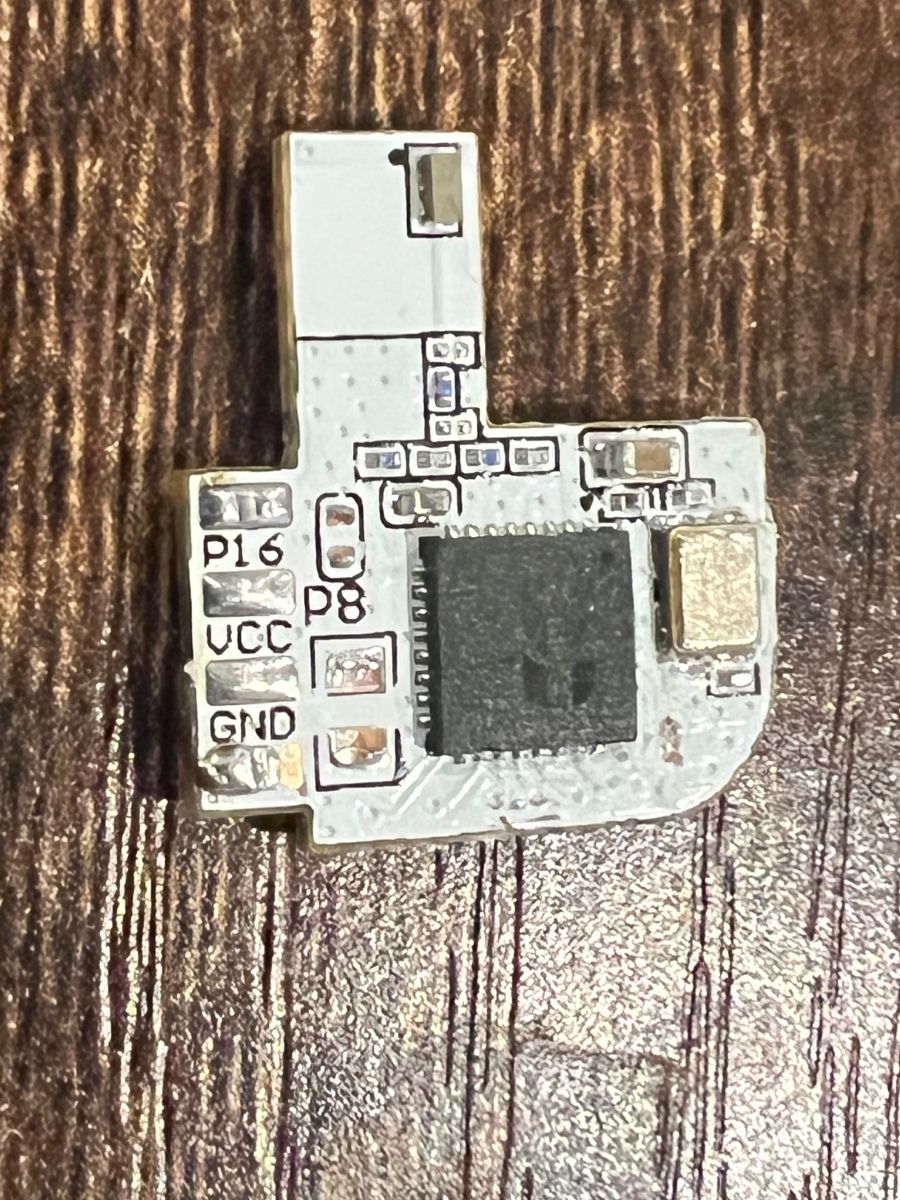

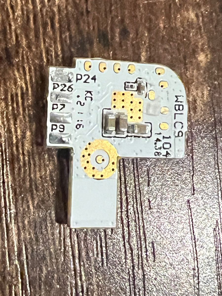

  • Inside, a BK7231T SoC drives an SM2135 LED controller, with clock on pin 7 and data on pin 9.
  • The bulb is rated at 120VAC, 4.9W, 72mA, 2700K-6500K, and 350 lumens.
  • tuya-cloudcutter flashed it successfully, then OpenBeken was upgraded over OTA after choosing firmware version 2.9.16.
  • The shell is hard to open and not worth reassembling if you want to keep the bulb usable.
  • This is a quick teardown of the Anwio AN-G250-1XD W 120V Y 4.9W 72mA 120VAC @ 60Hz 2700K-6500K 23/22K @ 350 Lumens. I picked these up in a 2-pack on Amazon (ASIN B08TGZ5F92) for $8.69 USD. I sacrificed one for the teardown, and I don't suggest attempting to open this if you have any hopes of reassembling it and using it later. Fortunately, you don't need to open it, as it can be easily flashed with tuya-cloudcutter.
    Basic Info:
    The bulb is powered by a Tuya WBLC9 with a BK7231T SoC. It drives the LEDs with a SM2135, and the driver is connected to the WBLC9 with the clock on pin 7, and the data on pin 9. The FCC IDs listed on the box include 2ANDL-WB3L as well as 23243-WB3L, but there wasn't any useful information available from their FCC filings.
