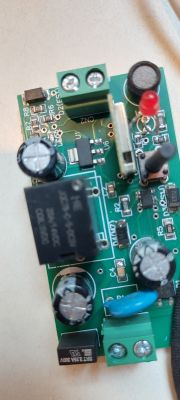

    There isn't much on the photos. I can see only the top side of the board. I can also see a possibly AMS1117-3.3V LDO. I can also see an empty space for WiFi module... did you desolder it? Or was it always empty? If there a QFN BK7231 on the bottom side of this board?

    Sorry my bad... uploaded the wrong photos.
    Will upload the homemate smart breaker photos soon.

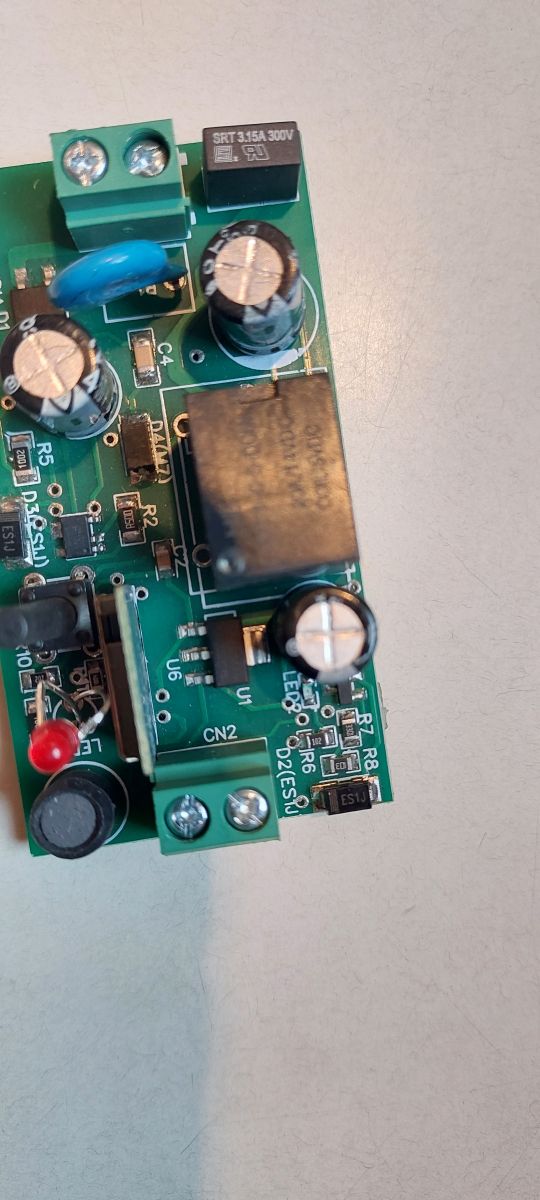

  • Correct PCB photos posted for identification
    #10 20791632
    ciknururko
    Posts: 44

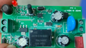

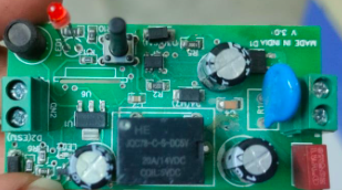

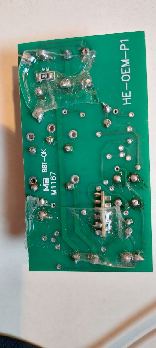

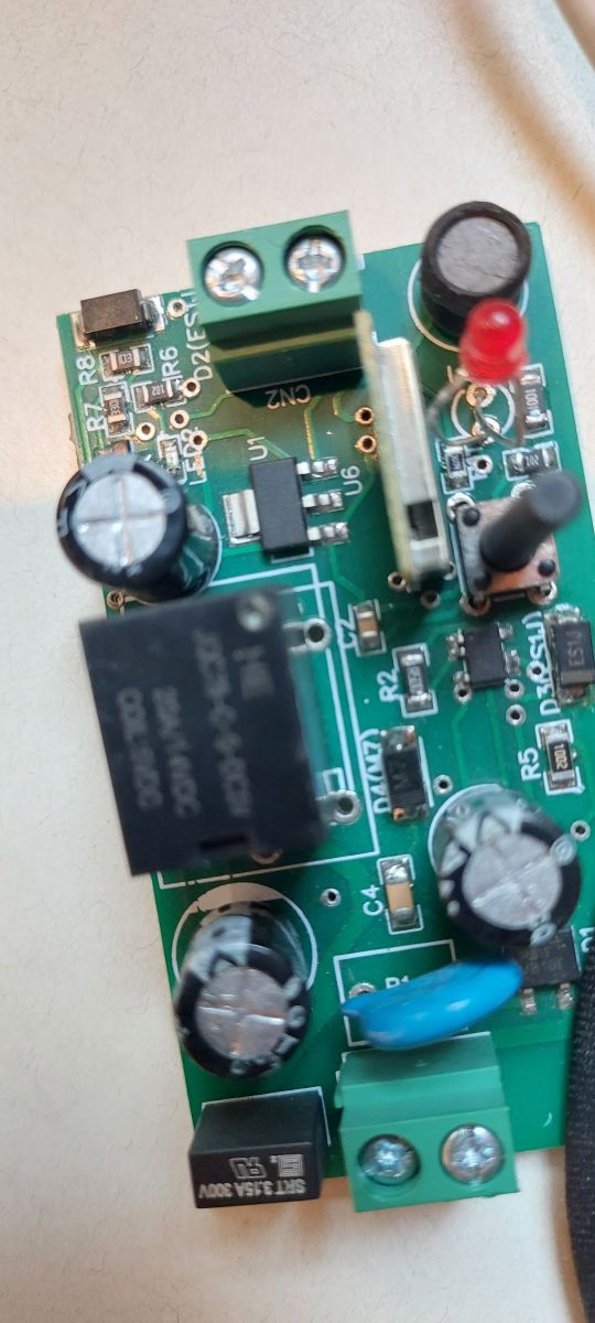

    Circuit board with electronic components on a white background. Green circuit board with markings HE-OEM-P1 and various components. Switch circuit board with various electronic components. >>20784507
    Sorry, earlier I posted the pics of wrong pub of some other switch. I was out of town after that.
    Please find the correct images of the PCB board of the switch. Please let me know if any other detail is needed.
  • #11 20791701
    Posts: 14746
    Rate: 12841
    What module is used there?
    Watch this video:
    You can desolder module that way and flash it outside circuit

    Posts: 44
    the module is CB2S.
    Can you plz guide me which USB to TTL programmer should I buy?

  • #13 20791747
    Posts: 14746
    Rate: 12841
    CB2S is also used on the video I linked, so it should work.
    You can use the same USB to UART converted we have on the video, but also remember that you need a stable 3.3V source. 5V would damage CB2S.
