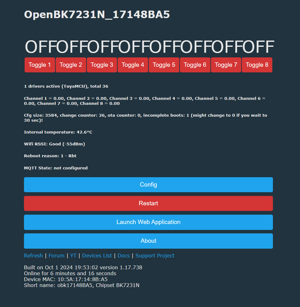

    @io2345
    Update to latest build - 1.17.738 and use the following autoexec and please respond back.

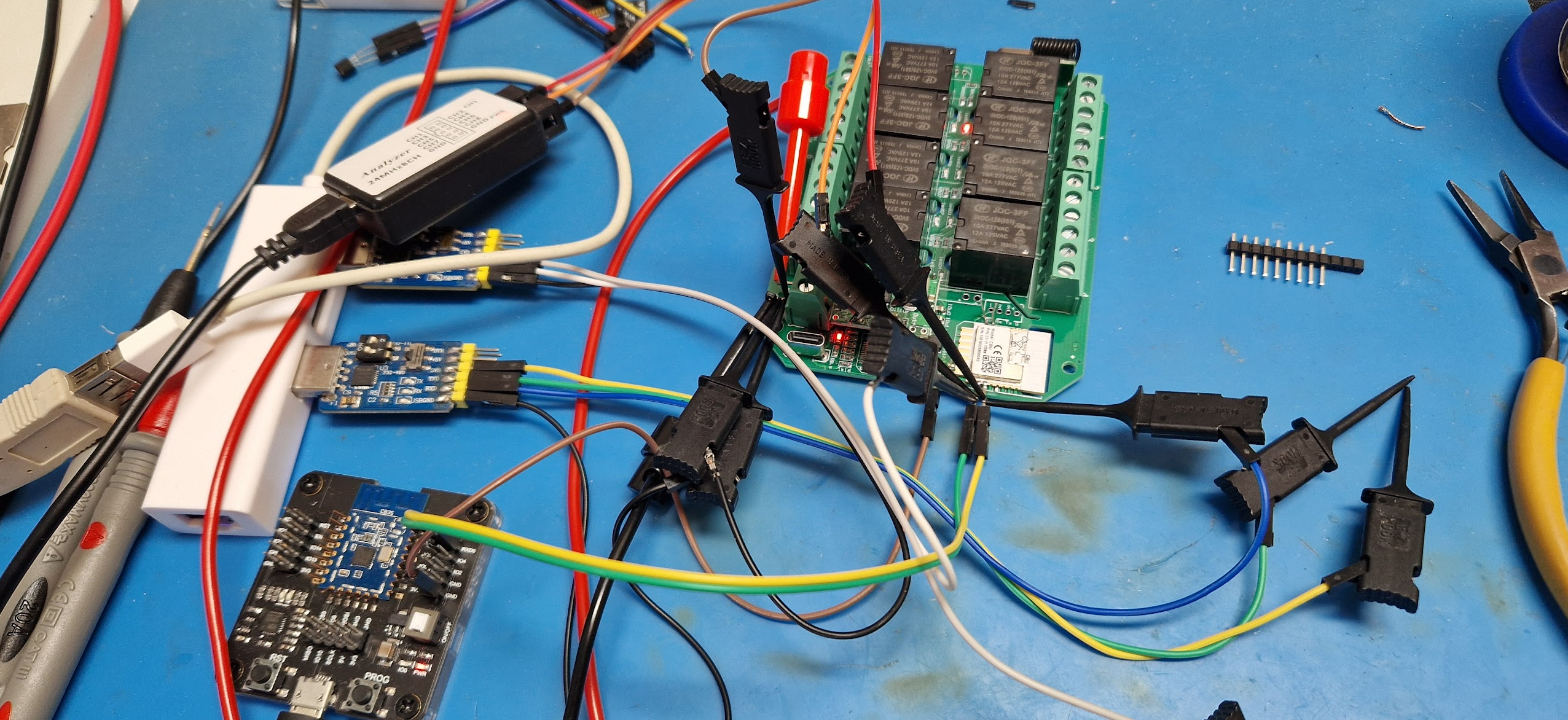

    Some pictures of the progress on my end:
    Dashboard of the OpenBK7231N device with eight toggle buttons and system details.
    Electronic setup with multiple cables, wires, and modules on a blue workbench.

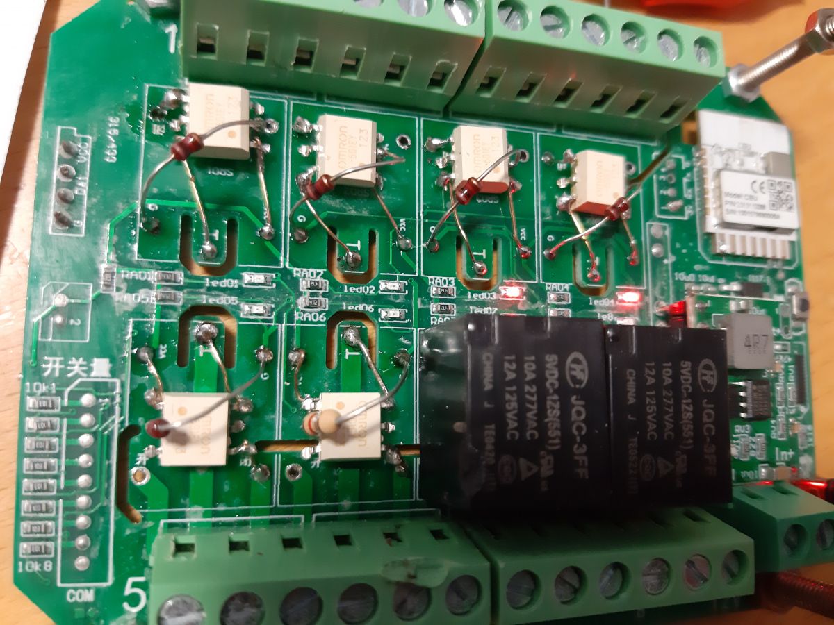

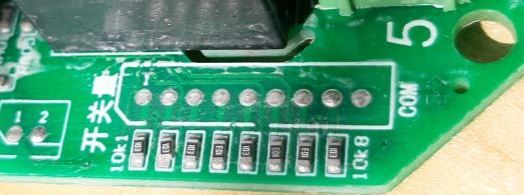

    I would need input lines, and thought it might be possible to use the COM Port connectors
    Close-up of a circuit board with visible pins and COM label.
    But connecting Pin-Holes 1 and 9 or connecting Pins to ground doesn't switch anything (using stock firmware).
    Any idea, if these are of any use for input purpose?

    Posts: 14771
    Rate: 12914

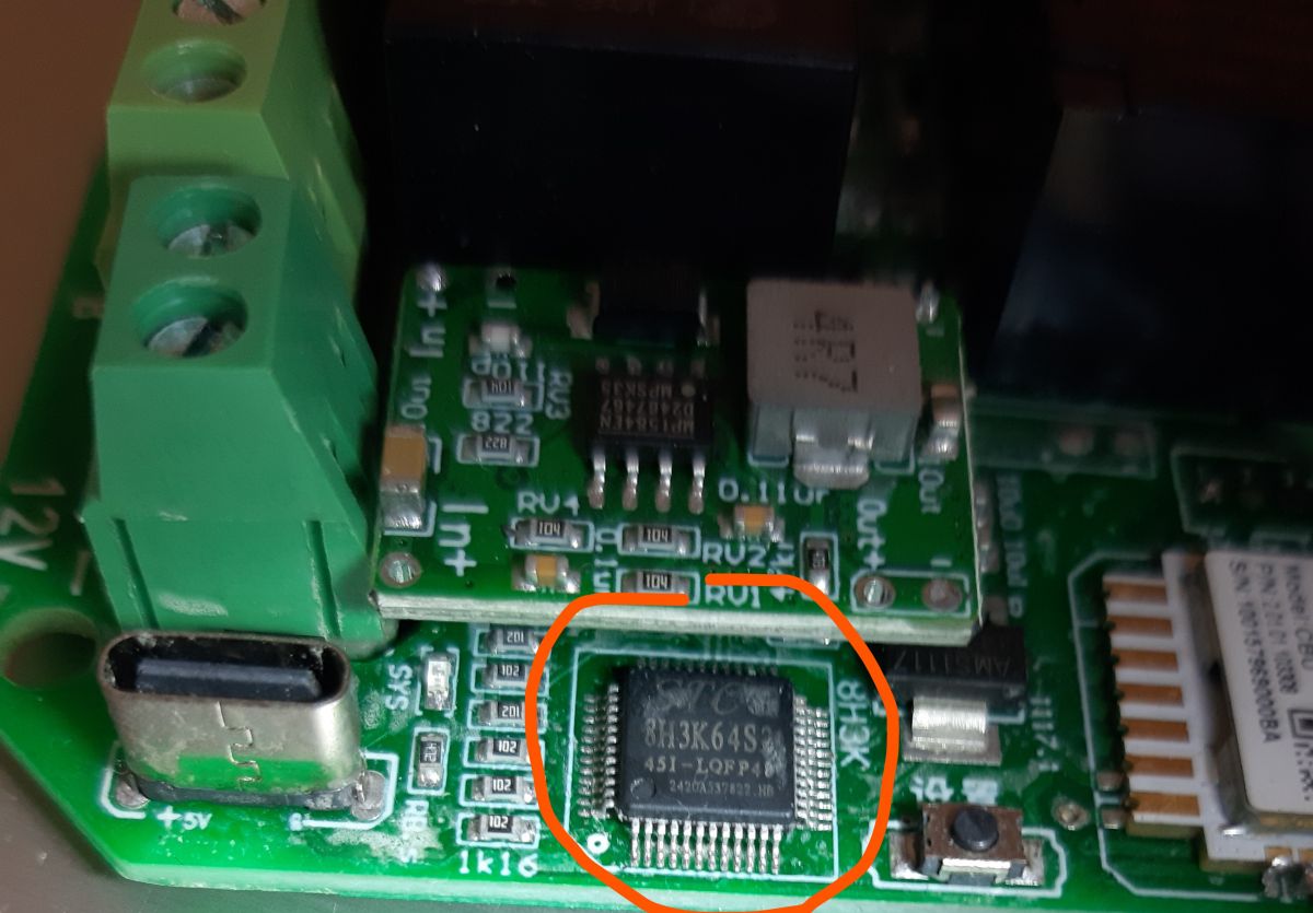

    Where are those pads connected? To MCU or to WiFi module?
    I think you need to connect to WiFi module pads directly. Then you can script them in OBK.

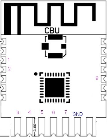

    >>21270089 I Think it is the MCU, see picture. Close-up of a circuit board with an integrated circuit labeled 8H3K64S2.
    If I can connect it to the CBU module, it would be fine for me (just have to find out how to be safe with 230V input - maybe opto-coupler with 230V line detection. Something like that: AliExpress 230V Optocoupler module). Can I use any of the CBU-pins that are not connected to the mainboard? There are 14 pins without visible connection. Those would be:
    Pin 3 - P20, Common GPIO (Pin 20 of the IC)
    Pin 4 - P22, Common GPIO (Pin 18 of the IC)
    Pin 5 - P23, ADC (Pin 17 of the IC)
    Pin 6 - P1, UART RX2 (Pin 28 of the IC)
    Pin 7 - P0, UART TX2 (Pin 29 of the IC)
    Pin 8 - P8, IO with PWM hardware support (Pin 24 of the IC)
    PIN 9 - P7, IO with PWM hardware support (Pin 23 of the IC)
    Pin 10 - P6, IO with PWM hardware support (Pin 22 of the IC)
    Pin 11 - P26, IO with PWM hardware support (Pin 15 of the IC)
    Pin 12 - P24, IO with PWM hardware support (Pin 16 of the IC)
    Pin 17 - P28, Common GPIO (Pin 10 of the IC)
    Pin 19 - P9, Common GPIO (Pin 25 of the IC)
    Pin 20 - P17, Common GPIO, can be reused as SPI_MISO (Pin 14 of the IC)
    Pin 21 - P15, Common GPIO, can be reused as SPI_CS (Pin 13 of the IC)
    The UART Pins are probably not suitable, but the others should be useable.

    Of course you can use them, but remember, they are 0-3.3V levels, not even 5V, nor bigger. What do you want to do with them?

    >>21272301 The inputs will receive the signal of the room thermostats and (as standard function) switch on the relays whenever the thermostat switches on. Remember, that I want to use this device as control center for floor heating valves? With it's help I should be able to supply functions like negative logic for the thermostats in summer (for cooling purpose) or warm-overload the floor heatings screed concrete by one degree when the sun provides electricity for free for the heat pump. ;-)
    Can you give me an example for one channel how to do the input detection by script? Let's say Input 1 (for control of relay 1) should be on Pin 1 of the CBU (Symbol P14, corresponds to Pin 11 of the IC). Signal HIGH on that Pin should switch relay 1 on.
    Set dInput role to mirror relay channel logic
    #76 21273718
    Posts: 14771
    Rate: 12914

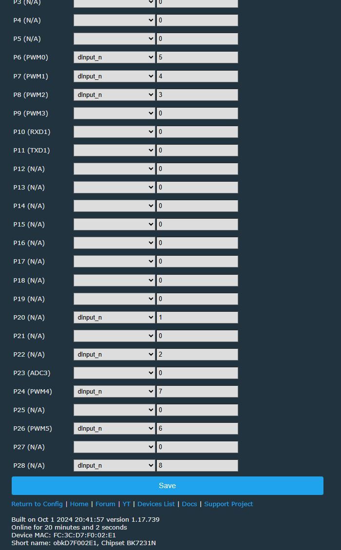

    If you have digital input on, let's say, P15, then you just need to set the P15 role to dInput (this will have internal pull up resistor enabled), and set the target channel to the same channel that your relay is using. Then, automatically, HIGH state on P15 will set Relay to HIGH state, and LOW state on P15 will set relay to LOW state.
    If you want to inverse the logic, then change dInput to dInput_n (negated).

    For those who want to achieve the same. This is what you have to do: First, create an autoexec.bat in Web Application and insert the code shown in Thread 61 ("save, reset SVM and run file..."). Set Config as shown here ("Save"):
    Screenshot of a web application interface configuration with pin settings.
    If you connect now these CBU Pins to GND, the appropriate relais will switch on:
    Diagram of an electronic module with pins labeled CBU and GND.

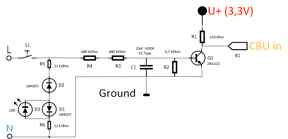

    As there are no important user controls (other than the reset button on the device - don't use it when connected to 230V): once installed in a safe plastic box, you can as well do the 230V input detection the easy way. The chinese devices use a similar method:
    Diagram showing a circuit for detecting 230 V with components like diodes, resistors, and a transistor.
    You will need the same for every input that you want to do 230V detection for.
    R5, R6, D1, D2 and LED are optional, as LED will only show if S1 is switched on or not. R1 and connection to U+ can be skipped, if the input on the CBU has pullup activated, which is true for the config in Thread #77.
    As always when connection to high voltage is present: Be careful, 230V can kill you. Preferably use the optocoupler module mentioned in Thread #73

    Are you sure about this circuit? Would it also work correctly in case of a voltage spike on L?
  • #81 21275597
    Posts: 14771
    Rate: 12914

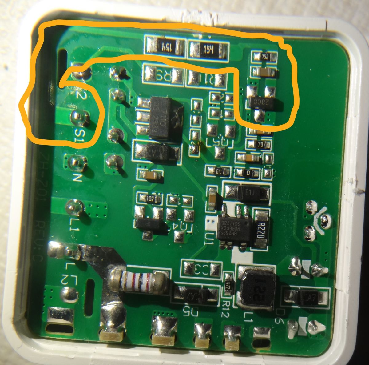

    Maybe a varistor could help. Tuya device manufacturers also sometimes put one, but they also often just leave an empty place on PCB for it.

    >>21275592 Can't test it, don't have the necessary components at hand. But I opened a switch I had lying around, and they do very much the same here, only that they are using a MOSFET instead of a bipolar transistor:
    Close-up of a circuit board with electronic components, including resistors and SMD transistors.
    They have R3, R4 at only 150 kOhm, R2 at 7,5 KOhm. Transistor is a 2300 SMD. The capacitor I can't measure (but according to the above link in #80 it should also be 100nF). Doesn't look like X2 at all. Under normal working conditions there shouldn't be more than 10 Volt at the capacitor anyway.

  • #88 21422892
    io2345
    Posts: 273
    Rate: 7
    Pimped version with MOSFET relays instead of mechanical ones (I use only 6 channels). No significant power usage and noiseless.
    Close-up of an electronic circuit board with components, including MOSFET relays and screw terminals.
    As you can see, I also stripped off the RC-part, as I have no use for that.
    Idea was born here: Link
  • #89 21422925
    Posts: 14771
    Rate: 12914
    What is the maximum power for each channel now?
  • #90 21422968
    io2345
    Posts: 273
    Rate: 7
    >>21422925 With this version of "relay" (Omron G3VM-601EY) you can switch 23 watts (100 mA).
    Omron G3VM-601CR/FR would allow up to 140 watts.
