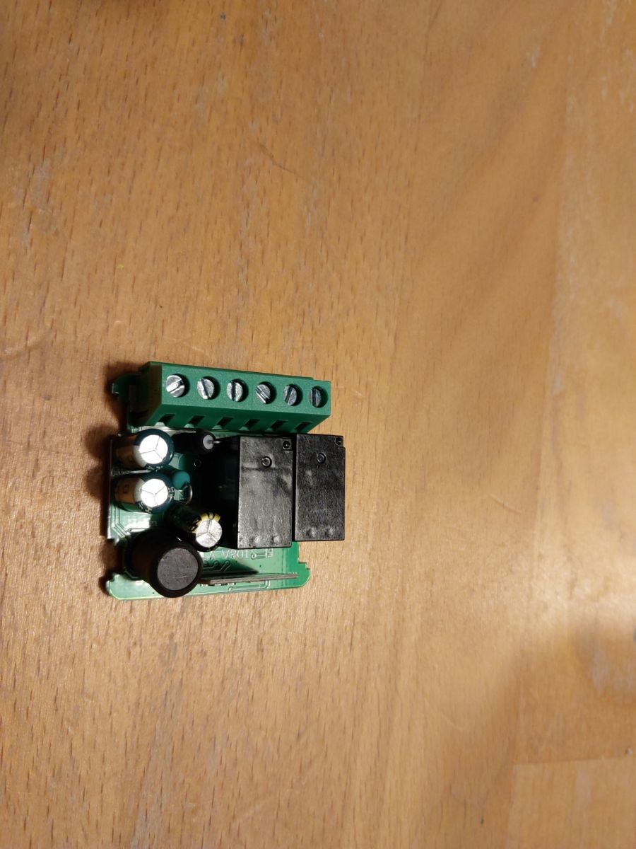

    I have acquired such a controller for roller shutters:
    Roller blind controller with manual on a table. Roller blind controller on a table Roller shutter controller on a wooden table. Photo of an electronic controller circuit board on a wooden surface. Side view of a shutter control module.

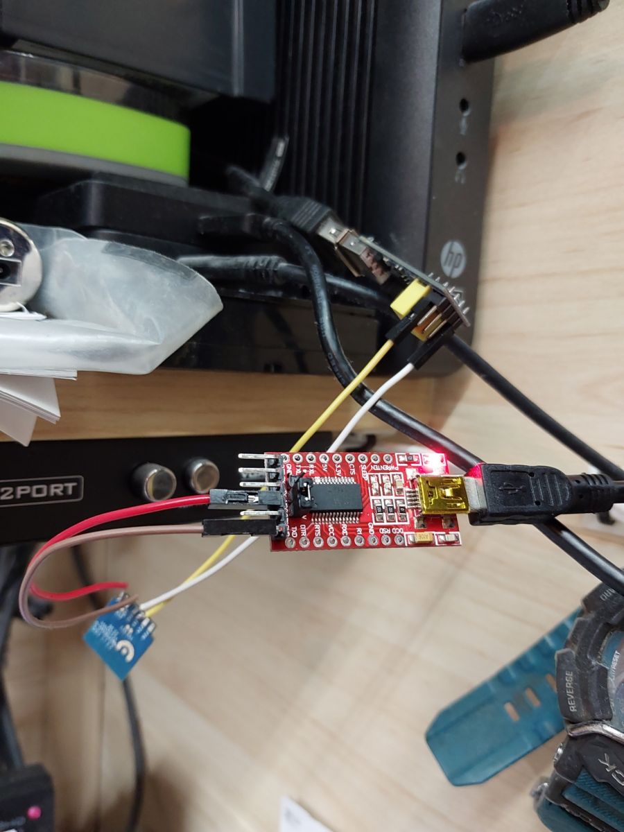

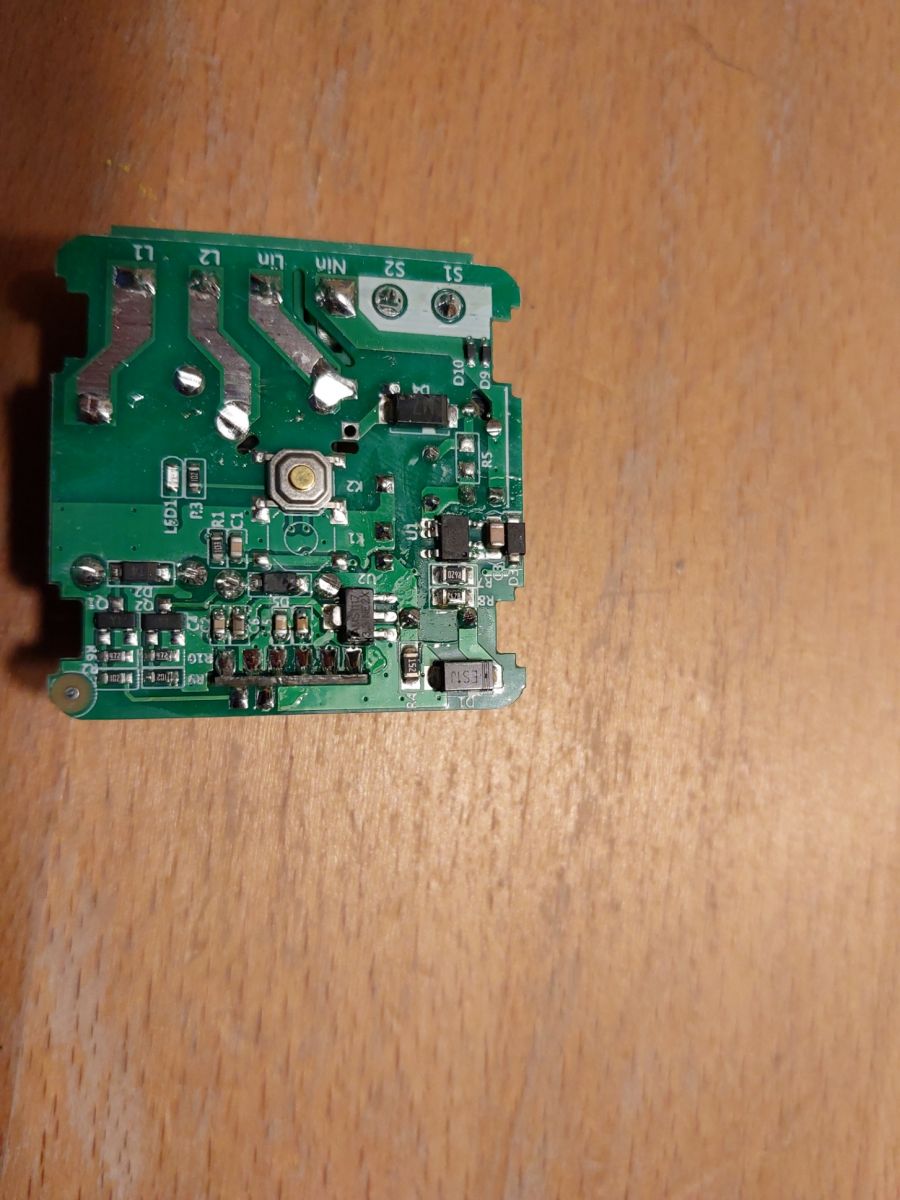

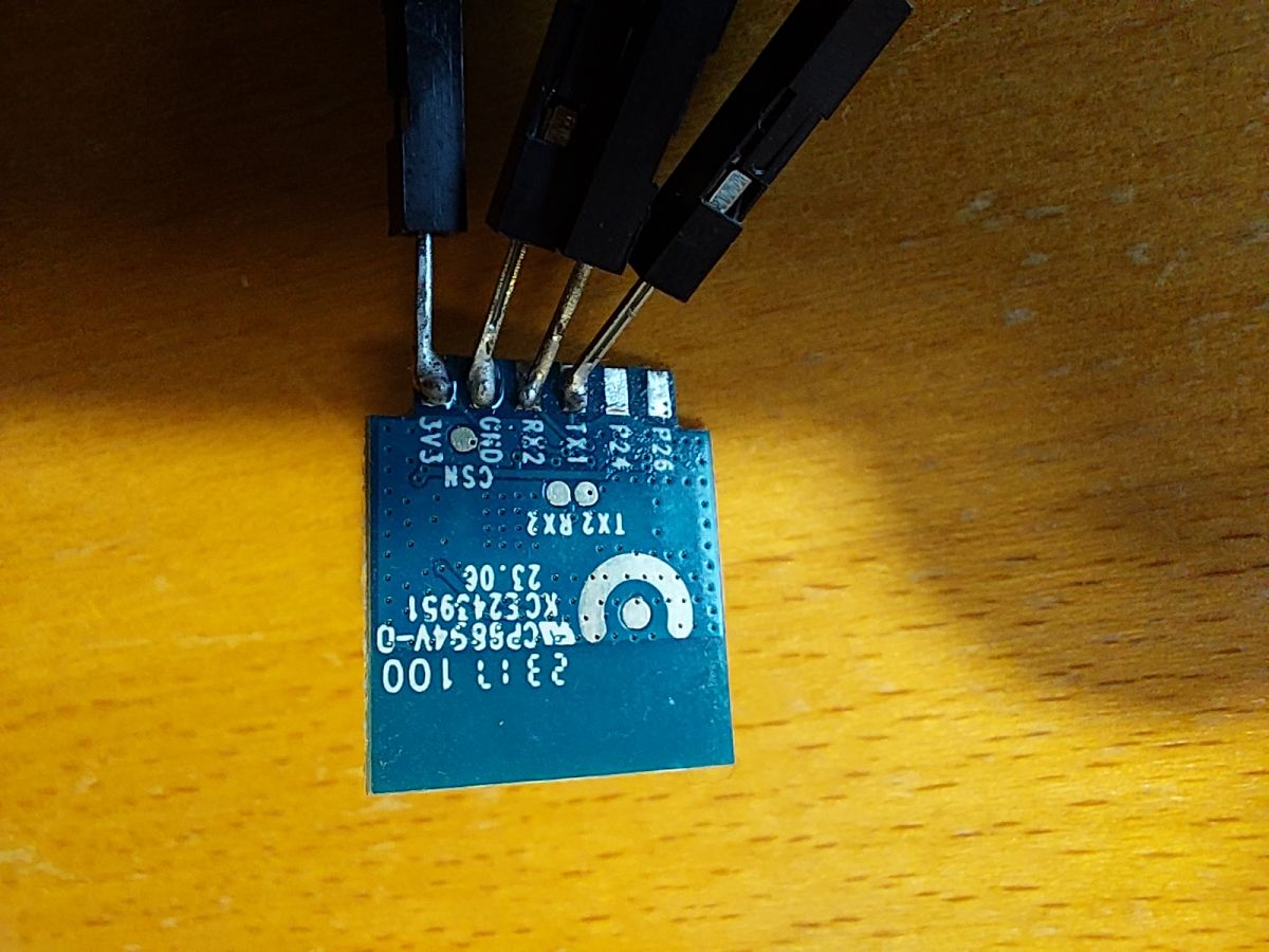

    I soldered the chip, connected it to the programmer:
    Microcontroller with connected wires on a wooden background. Blue circuit board with various electronic components. Roller shutter controller with connected wires and tools on a table.
    I backed up with BK7231Flasher and started uploading OpenBK7231N_QIO_1.17.291.bin.
    After a while the program dumped me something like this:
    Writing sector 0x00... ok! Writing sector 0x1000... ok! Writing sector 0x2000... ok! Writing sector 0x3000... ok! Writing sector 0x4000... ok! Writing sector 0x5000... ok! Writing sector 0x6000... ok! Writing sector 0x7000... ok! Writing sector 0x8000... ok! Writing sector 0x9000... ok! Writing sector 0xA000... ok! Writing sector 0xB000... ok! Writing sector 0xC000... ok! Writing sector 0xD000... ok! Writing sector 0xE000... ok! failed with serial.BytesToRead 0 (expected 15)
    The beginning of buffer in UART contains  data.
    Writing sector 0xF000... Writing sector 61440 failed!
    Writing file data to chip failed.
    I tried to upload the backup - same thing.
    I tried to upload BK_writer:
    Flash ID:0x00000000
    Time:15.594s
    Speed of Programm:921600bps
    Init...FAILED
    I have no idea.

  • Suggest lowering baud rate and shortening wires
    #2 20787862
    Posts: 14770
    Rate: 12913
    Hello, have you tried reducing the baud rate?
    And maybe hid_download_py will work?
    [youtube]
    https://www.youtube.com/watch?v=0V0kaRVnk18
    [/youtube]

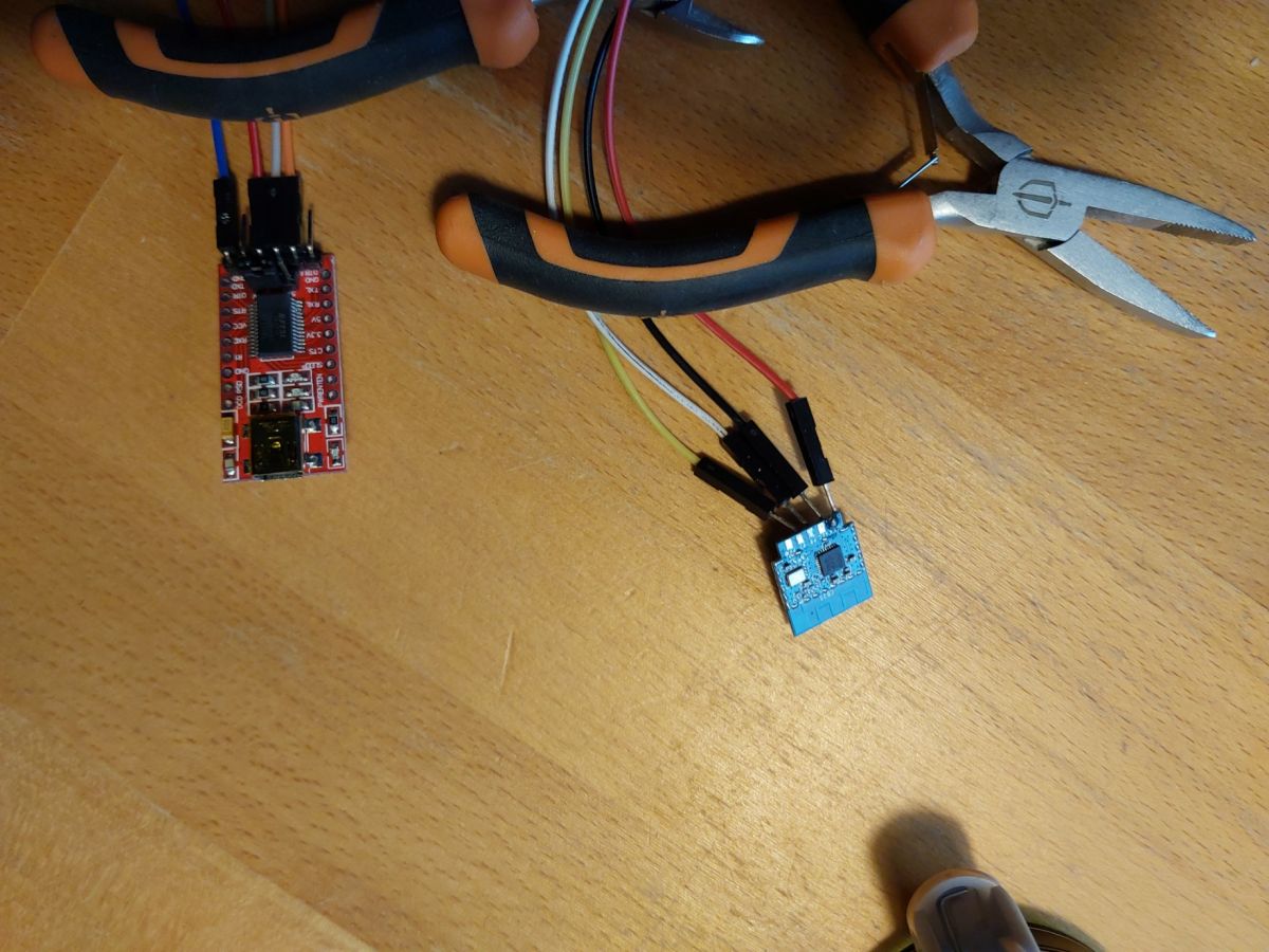

    And also those wires.... It might be worth shortening them a bit. There have already been situations on the forum that it was the length of the wires that got in the way.
    And the power supply on the 3.3V picture comes from some good LDO providing sufficient current or where from?
  • #3 20788010
    Nargo
    Posts: 495
    Help: 45
    Rate: 206
    Only on such a cobweb was it possible to upload this OpenBK7231N_QIO_1.17.11 soft
    Microcontroller connected to a computer via USB cables and electronic wires.
    CRC matches 0x1A2FDBD2!
    Writing file data to chip successs.
    Then I will solder in the circuit and check if it works properly.

  • Mirror-image power pinout on the module side
    #7 20788044
    Nargo
    Posts: 495
    Help: 45
    Rate: 206
    I don't know myself.
    I powered from the programmer to the ESP-01, didn't go. (The previous one did.)
    Powered from the power supply for the contact boards, it did not go.
    Powered from the WEMOSd1Mini, it did not go.
    It only worked on the programmer from the ESP and the power supply from the latter (YP-05).
    And also not versions 1.17.291 and 1.17.15, but versions 1.17.11
    Also black magic is at work, but I have already recently succeeded with Tasmota and the drivers for AHT20.

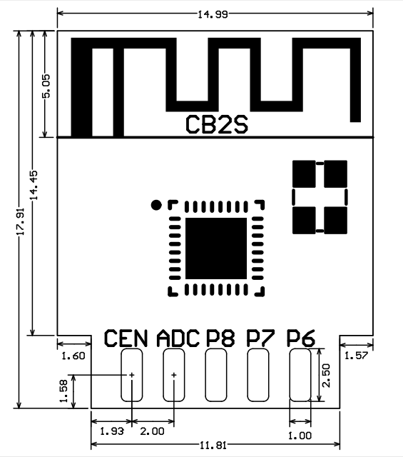

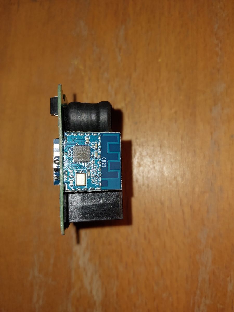

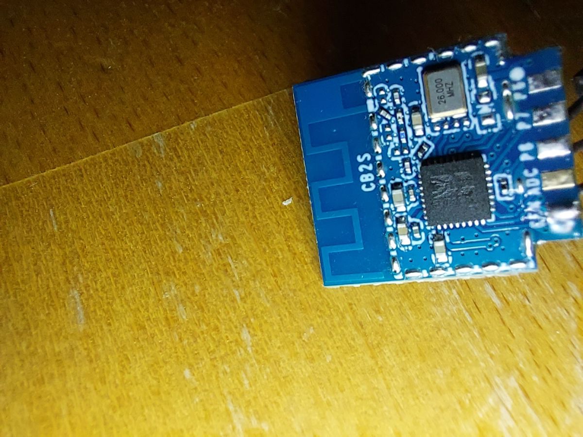

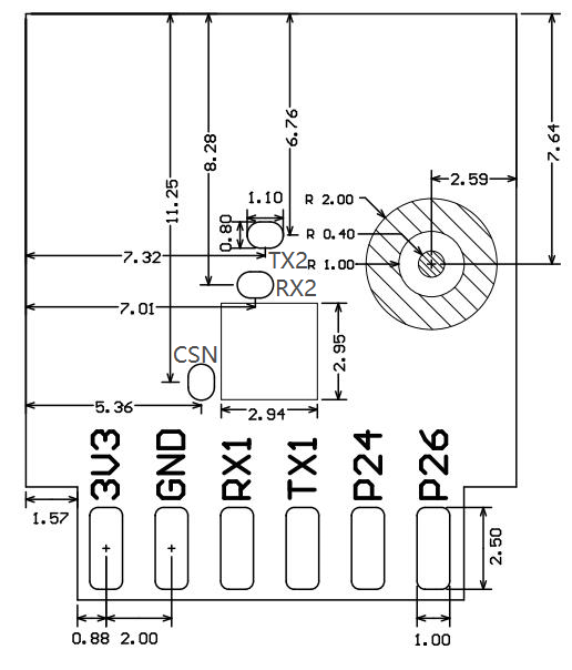

    I am looking at the pictures and it appears to me that this module is a mirror image of CB2S on the power side.
  • Mislabelled CB2S pinout may have caused damage
    #8 20788085
    Posts: 14770
    Rate: 12913
    Nargo wrote:
    Yes I'm looking at the pictures and it appears to me that this module is a mirror image of the CB2S on the power side.
    Wait, the lettering on the description layer doesn't match those on the Tuya documentation?
    If so then please check how it was soldered! Diagram of the CB2S integrated circuit with labeled pins: CEN, ADC, P8, P7, P6. Diagram of a board with pin labels 3V3, GND, RX1, TX1, P24, P26. Diagram of a board with pin labels 3V3, GND, RX1, TX1, P24, P26. I am familiar with this problem. I have seen a series of devices with CB2S where there was a bad description layer reflected, the pins were wrongly signed, so GND was not GND, and 3.3V was not 3.3V
    Wrong connection of such a module can damage it!
    Please check and verify everything with where the 3.3V and GND on the motherboard.
    @Nargo in my opinion you have a module with a badly bounced description layer, in Tuya's documentation there are correct leads, if you haven't burned it yet it's just a fart, thanks to the fact that GPIO has protective diodes to ground and power supply

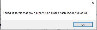

    Error message stating that the given binary is an erased flash sector, full of 0xFF. .

    Then take the first backup you have and drag and drop it onto the flasher
  • Flash dump appears erased with 0xff bytes
    #13 20788283
    Nargo
    Posts: 495
    Help: 45
    Rate: 206
    Failed to extract Tuya keys - magic constant header not found in binary
    It seems that dragged binary is full of 0xff, someone must have erased the flash

    Open the file in a hex editor. It looks like it is full of 0xff itself. This is not a valid backup.
    Maybe better to use GPIODoctor and by method of elimination check what of the CB2S pins are not used yet. Also delete the ones that are not soldered on the PCB. There won't be many options left.

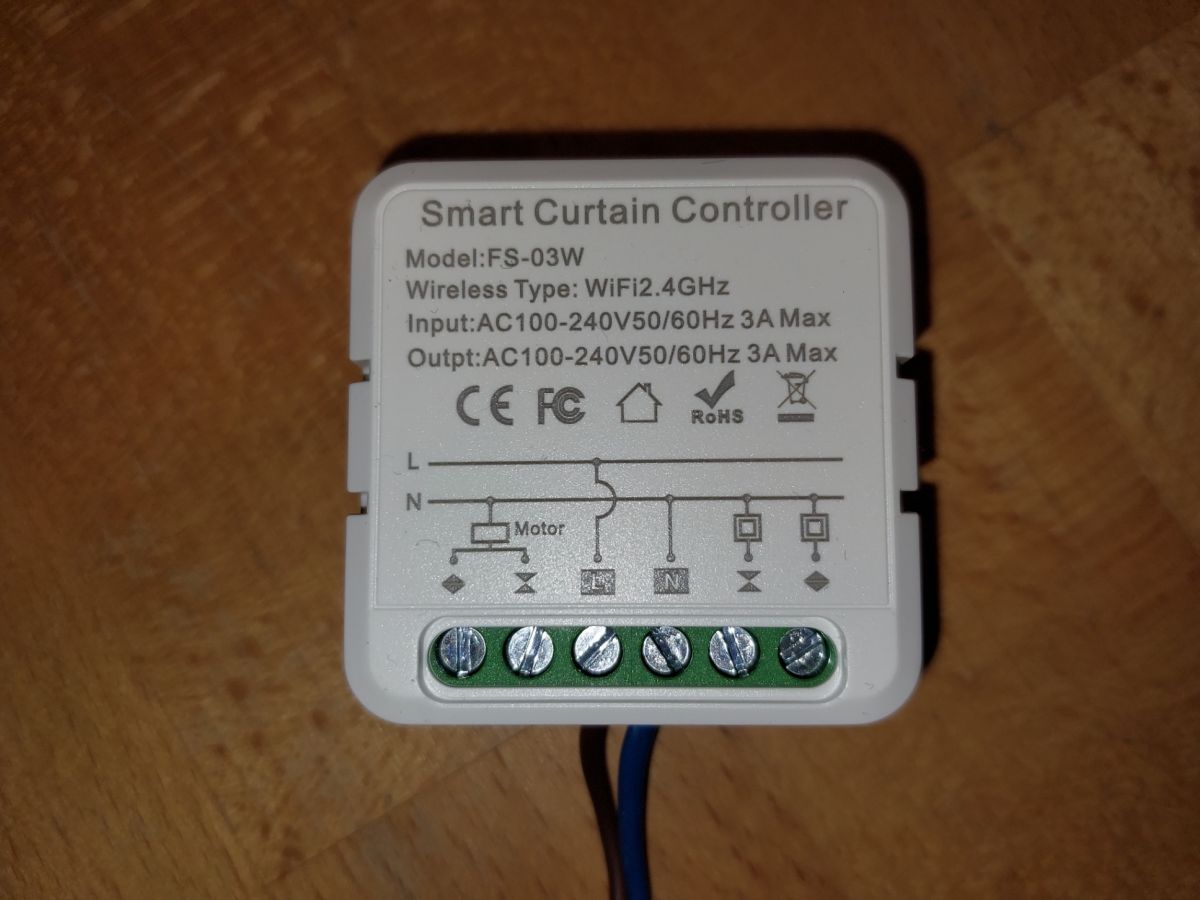

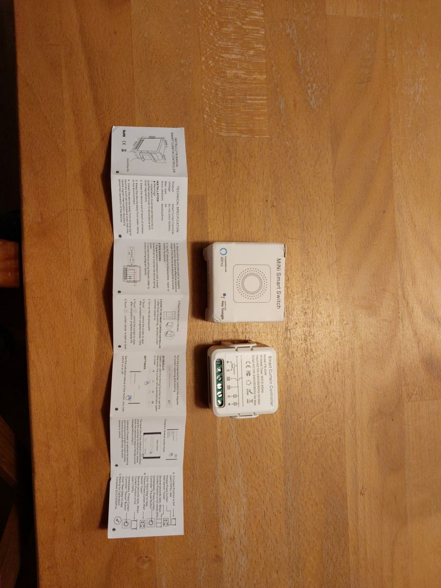

    And what device model is written on the housing of this relay?
  • #15 20788321
    Nargo
    Posts: 495
    Help: 45
    Rate: 206
    Smart curtain controller model FS-03W with technical specifications and connectors.
    Smart Curtain Controller
    "pins": {
    "6": "Rel;1",
    "7": "Rel;2",
    "10": "dInput_n;1",
    "11": "dInput_n;2",
    "24": "LED_n;3",
    "26": "dInput;0"
    Now still to find how to configure this as a roller shutter controller and it will be GIT.
  • #16 20788350
    Posts: 14770
    Rate: 12913
    FS-03W, this is important information. Model name.
    We do not have a ready-made system for roller shutters in the firmware. I do not have roller shutters at my home so I had no way to prepare it. We can either e.g. prepare it together (if you know C or at least want to test a bit) or we can use ready scripts from other users:

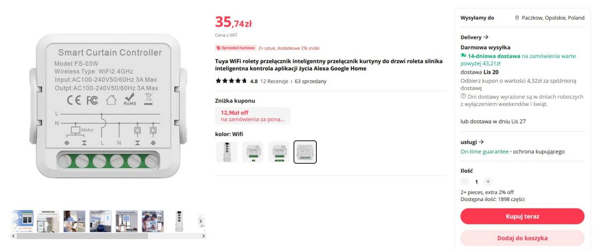

    Auction photo
    Image of a smart curtain switch on an online auction with price and description.
    Link to purchase
    I purchased together with AHT20+BMP280 modules on 14 day delivery. Purchase 8-09-2023 delivery 18-09-2023.

    At the moment I have raising/lowering 100% with stopping at any time from physical buttons as well as from HA
    Channels 1 and 2 physical buttons
    Channels 5 and 6 roller shutter relays

    After testing, it appears that the above code does not work as intended.
    I rewrote everything
    alias akcja1 backlog stopAllScripts; startScript autoexec.bat rusz1
    alias akcja2 backlog stopAllScripts; startScript autoexec.bat rusz2
    alias akcja3 backlog setChannel 6 0; setChannel 5 1; setChannel 10 1; setChannel 60 25
    alias akcja4 backlog setChannel 5 0; setChannel 6 1; setChannel 10 1; setChannel 60 25
    alias akcja_stop backlog setChannel 6 0; setChannel 5 0; setChannel 10 0; ; setChannel 60 1
    alias akcja50 setChannel 60 7
    //Channel 1 - wejście 1
    //Channel 2 - wejście 2
    //Channel 5 - wyjście 1
    //Channel 6 - wyjście 2
    //Channel 10 - stan 1 jakiekolwiek wyjście ON/ stan 0 jakiekolwiek wyjście OFF
    //Channel 60 - czas pełnego otwarcia 25s
    //Channel 60 - czas częściowego otwarcia 8s
    //Channel 60 - czas po zatrzymaniu 1s
    addChangeHandler Channel1 == 1 akcja1
    addChangeHandler Channel2 == 1 akcja2
    //Przyciski
    startDriver httpButtons
    setButtonEnabled 1 1
    setButtonLabel 1 "Open"
    setButtonCommand 1 akcja1
    setButtonColor 1 "#ff0000"
    setButtonEnabled 2 1
    setButtonLabel 2 "Close"
    setButtonCommand 2 akcja2
    setButtonColor 2 "#ff0000"
    // nic nie rób
    goto start
    return
    rusz1:
    setButtonColor 1 "#0000ff"
    if $CH10==1 then akcja_stop else akcja3
    delay_s 0.1
    delay_s 1
    if $CH1==1 then akcja50
    delay_s $CH60
    akcja_stop
    return
    rusz2:
    setButtonColor 2 "#0000ff"
    if $CH10==1 then akcja_stop else akcja4
    delay_s 0.1
    delay_s 1
    if $CH2==1 then akcja50
    delay_s $CH60
    akcja_stop
    return
    start:
    akcja_stop
    return
    Now it works as follows:
    Short press (up to 1s) roller shutter up/down 100% (25s)
    Long press (over 1s) roller shutter up/down about 40% (8s)
    Second click with any key during operation stops roller shutter motor.
    As soon as there is enough time before the kids return from school, I will install and check on the roller shutter.
  • Clarifying P10 and P11 pin mapping on CB2S
    #23 21547844
    io2345
    Posts: 273
    Rate: 7
    Nargo wrote:
    - Button (channel 1) on P10
    - Relay (channel 3) on P7
    - Pair/Toggle All Button on P26
    - WiFi LED on P24
    - Button (channel 3) on P11
    - Relay (channel 1) on P6
    Device seems to be using CB2S module, which is using BK7231N.
    What I don't understand: How can the device use P10 and P11, if there are no P10 and 11 on a CB2S available (see Tuya Schematics above in #8)???
The discussion centers on uploading the OpenBK7231N firmware to a roller shutter controller identified as FS-03W CB2S (BK7231N). Initial attempts involved soldering the BK7231N chip and using BK7231Flasher to upload OpenBK7231N_QIO_1.17.291.bin, encountering partial success with sector writes but firmware versions 1.17.291 and 1.17.15 failing, while version 1.17.11 succeeded. Issues with wiring length, power supply sources, and possible reversed pinouts due to mirrored PCB silk-screening were highlighted, emphasizing the risk of incorrect 3.3V and GND connections. Backup dumps initially appeared invalid (filled with 0xFF), but a valid first backup was later recovered, revealing pin assignments for relays, inputs, LEDs, and buttons. The device is a Smart Curtain Controller with pins such as 6 and 7 for relays, 10 and 11 for digital inputs, 24 for LED, and 26 for button input. There is no ready-made roller shutter firmware in OpenBK7231N; users discussed adapting scripts and configurations, including aliases and channel mappings, to replicate roller shutter control functionality similar to commercial controllers like the Zamel SRP-02. The controller was identified as similar to the Spacetronik SL-SC-01 model. Further development involves testing and refining scripts for open, close, and stop commands, with attention to channel assignments and timing parameters. Questions remain about the use of pins 10 and 11, which may not be physically available on the CB2S PCB, indicating possible discrepancies between documentation and hardware. The community suggests using tools like GPIODoctor for pin identification and encourages sharing purchase sources and auction screenshots for device cataloging.
