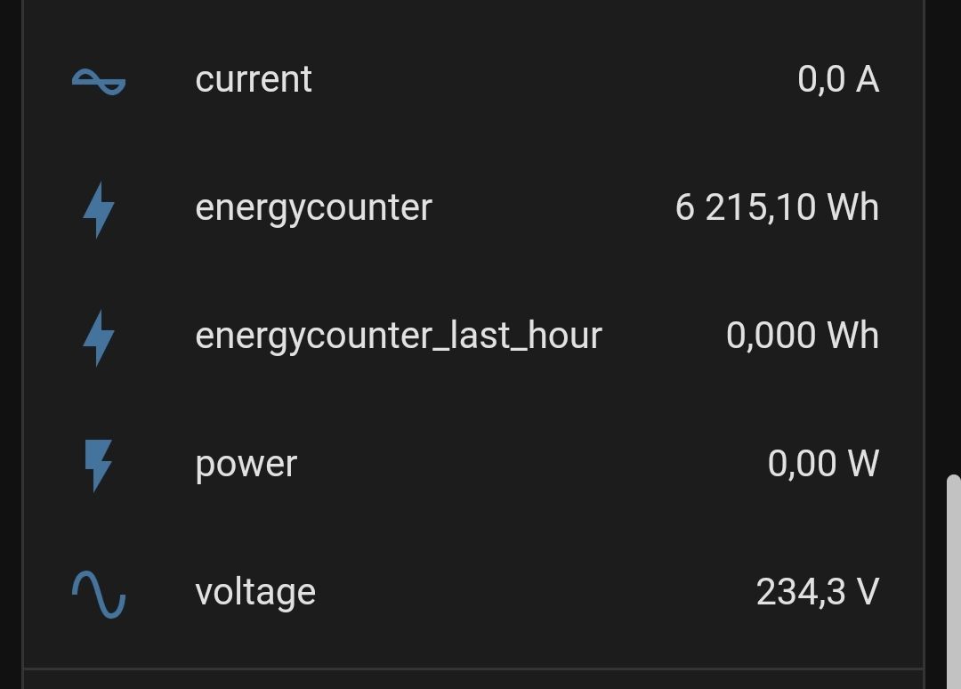

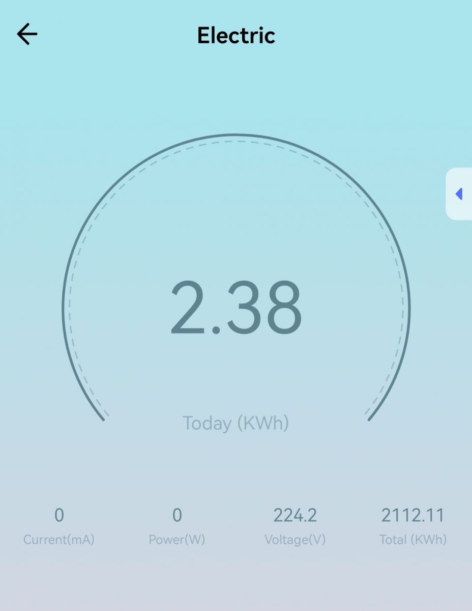

    Hello. There is a problem with all mini smart switches, after flashing to OpenWrt it does not show the network voltage correctly, but in the native Tuya firmware it shows correctly. The total deviation is more than 10v. How can I fix this? The image shows an Aubess mini smart switch with technical specifications. Electric app screen displaying 224.2V voltage and 2.38 kWh usage. Screenshot of an interface showing electrical parameters: current, energy consumption, power, and voltage.

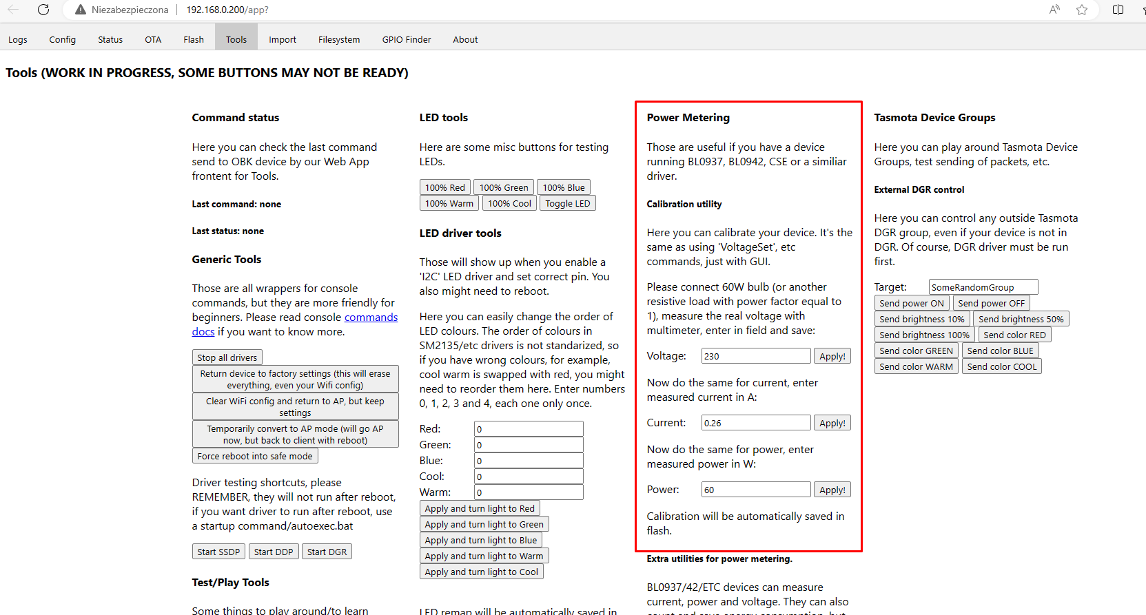

    Hello @mistikdonbass , have you performed the Calibration process, just like one would do on Tasmota?
    Screenshot of power metering and calibration tools for devices with BL0937, BL0942, CSE.
    You can use also console commands for that, name VoltageSet, CurrentSet, PowerSet

    Thank you very much, I didn't know about this.

    The calibration process is the same as in Tasmota, even our commands are the same, so you should be able to look up any Tasmota tutorial to do this.
