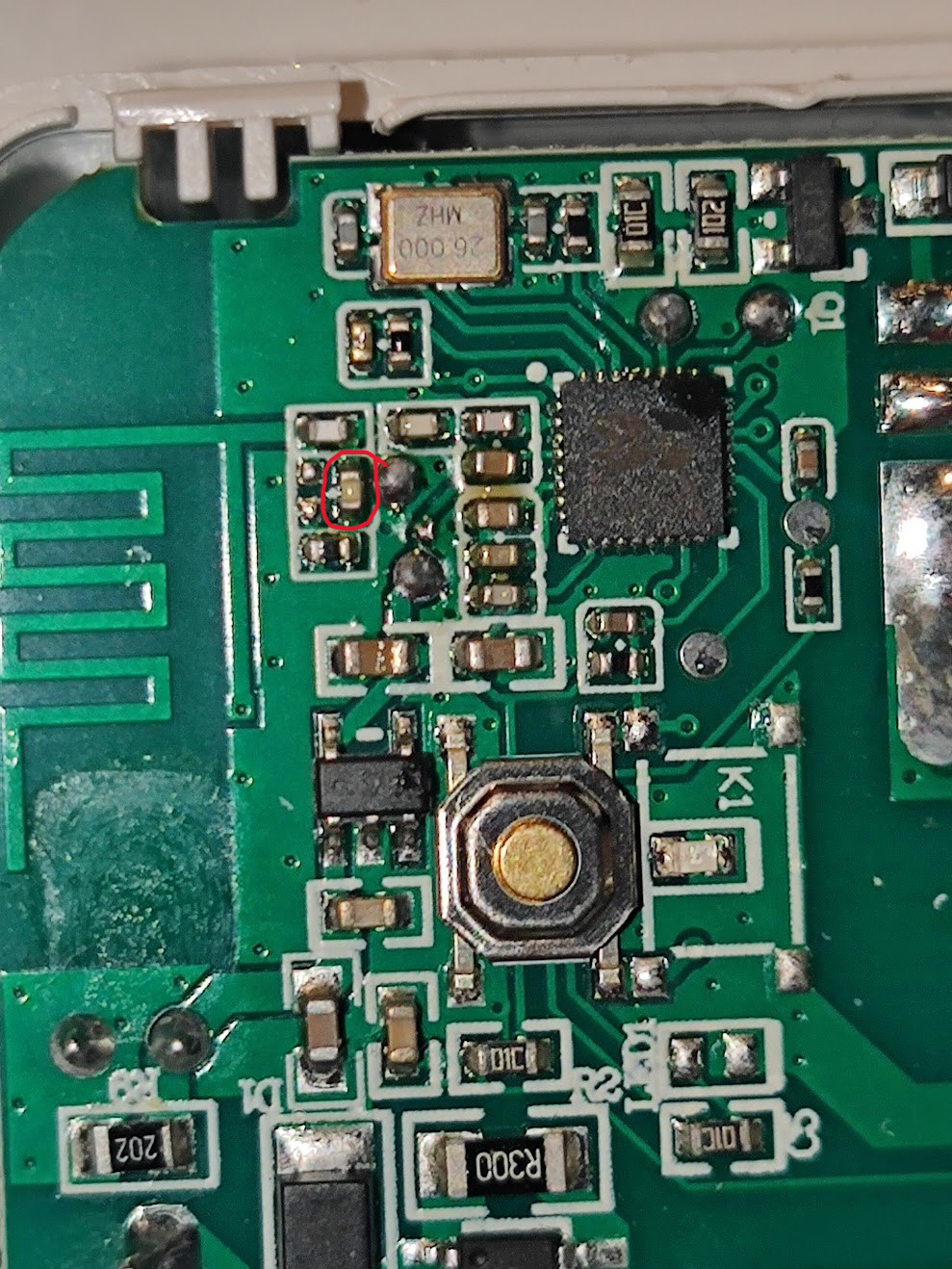

    So using a new USB-UART TTL converter did the trick, I successfully managed to flash the chip with new firmware.
    However, on desoldering the wires I accidentally desoldered an SMD component and then it sprung off my PCB when I tried to resolder it and I lost it haha, pretty stupid!! Just hooked it up and it did set up an access point, I'll see if the missing component results in real noticeable errors :3
    I do have 2 more chips to flash and it was only a few dollars, still a shame though lol. At least I know the flashing works! See attached image for the component I lost circled in red.. I'll update after I flash some firmware on them and test them with home assistant.

  • #7 21106091
    Posts: 14771
    Rate: 12914
    Looks like a part of WiFi antenna circuit, is your WiFi range still ok?

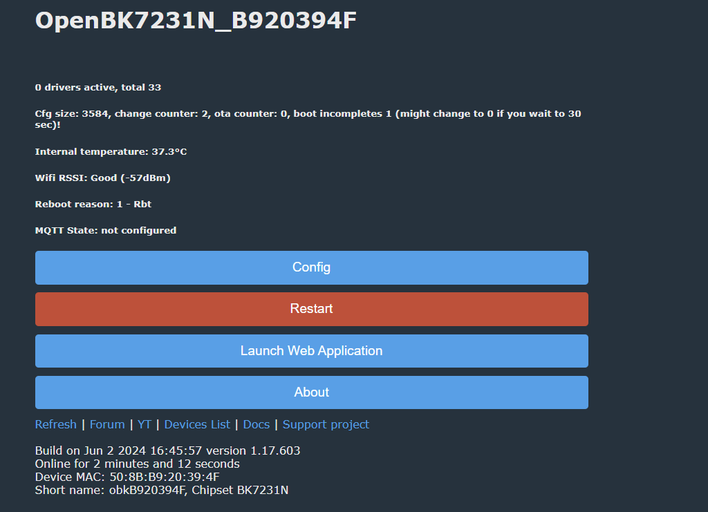

  • #8 21106112
    donut343
    Posts: 18
    Hmm so the access point is showing up (full bars) but I can't connect to it with my MacBook.. With my phone I can, but then can't reach it over 193.168.4.1 - tomorrow I'll try flashing the other identical chip I have and be more careful with the near components 😅
  • #9 21106131
    Posts: 14771
    Rate: 12914
    That's strange, but still, you can configure your device WiFi via our flasher itself.
  • #10 21106151
    donut343
    Posts: 18
    I'll resolder the wires and check it out tomorrow, unfortunately I have no more time tonight, I'll keep you posted on my progress!

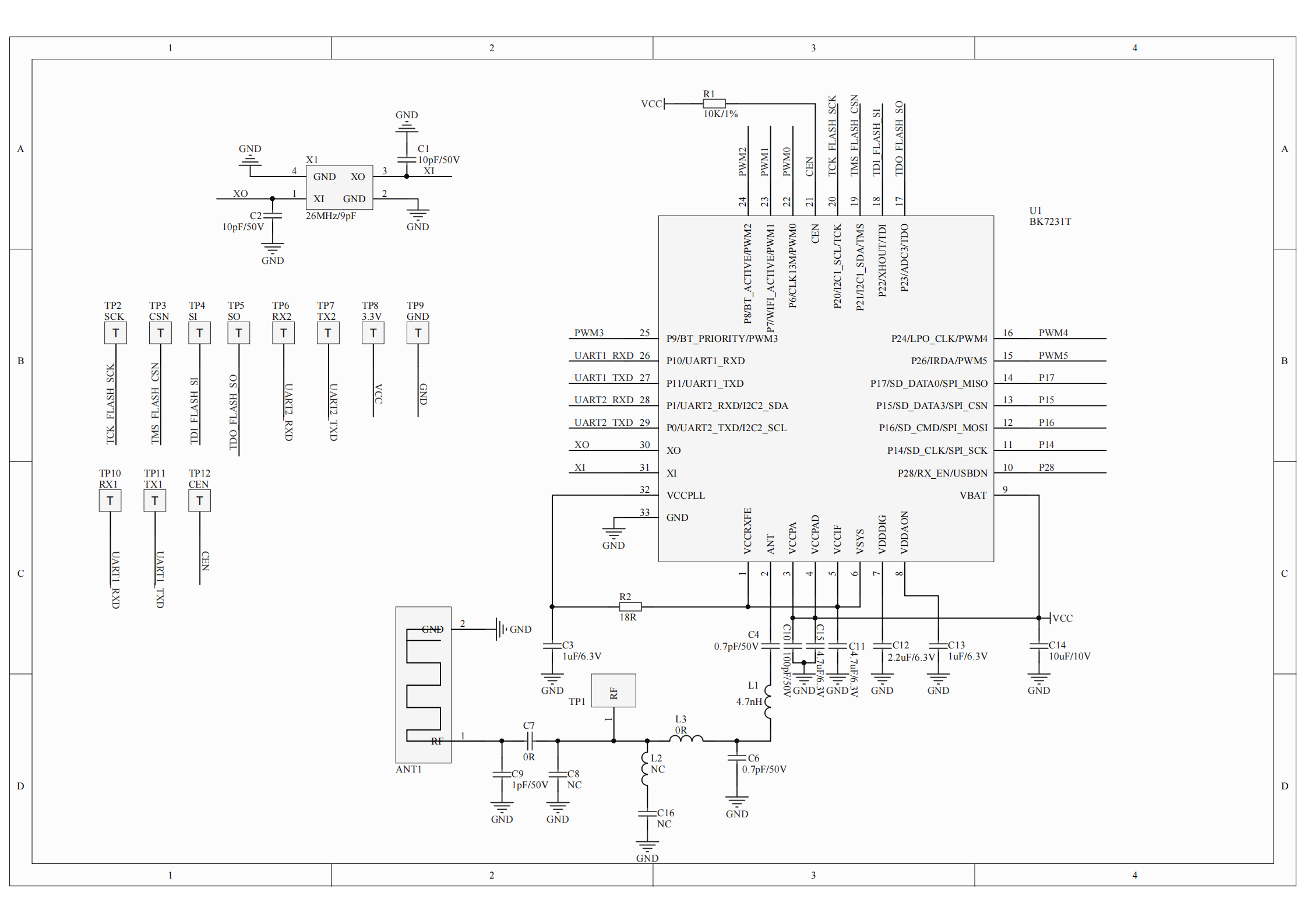

  • #11 21106241
    Posts: 14771
    Rate: 12914
    Still, issue is most likely caused by missing capacitor. Can you solder a replacement? Here is a schematic:
    Electrical schematic with a missing capacitor.

  • #13 21106265
    Posts: 14771
    Rate: 12914
    Nice spotting, it could have been a typo, let's wait for @donut343 to recheck...
  • #14 21106318
    donut343
    Posts: 18
    yes, sorry, that was a typo indeed haha. Thanks for the schematic, hope I can locally source a capacitor or I'll have to wait for a while. Would that be c9 or am I misreading the schematic you sent over? Sorry for my oblivious questions, I'm quite inexperienced with all this stuff.
  • Windows desktop worked for Tuya Wi-Fi setup
    #15 21107467
    donut343
    Posts: 18
    Okay so for some reason my (android) phone and macbook didn't work, but my windows desktop did, using a wifi dongle I had plugged in a rpi, I just changed wifi ssid / pass in settings and seems to connect fine, wifi signal seems okay! Now to flash the actual firmware and test :)
    Thanks for all the time you spent on helping me, regardless! Much appreciate, I've been recommending your tool / forum to interested people around me!
    OpenBK7231N control panel with system information.

I knocked off a tiny SMD near the antenna—will Wi‑Fi suffer?
Yes. That part is likely an RF matching capacitor in the antenna circuit. Missing it can break or weaken Wi‑Fi. Replace the capacitor per the shared schematic guidance for stable RF. [Elektroda, p.kaczmarek2, post #21106241]
Can I set Wi‑Fi credentials without connecting to the AP page?
Yes. You can configure the device Wi‑Fi directly from the flasher tool. This bypasses client AP issues during initial setup. [Elektroda, p.kaczmarek2, post #21106131]
