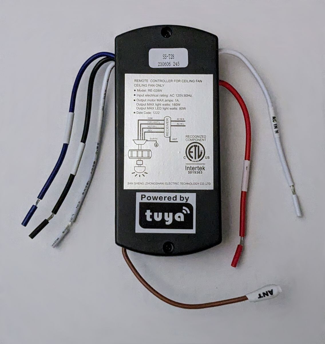

    Manufacturer: San Sheng (Zhongshan), but it is branded [or unbranded] under various names.
    Model: RE-028W
    Chipset: CB2S
    Module Firmware: V2.1.6
    MCU Firmware: V1.0.0
    Replacement: ESP8685-WROOM-03-H4
    Notes: The unit connects electrically to load and neutral without a ground.

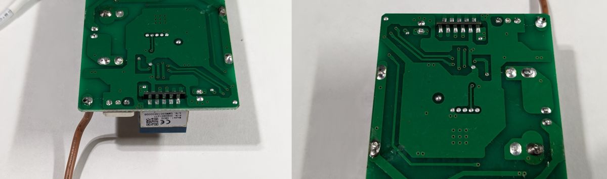

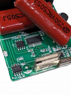

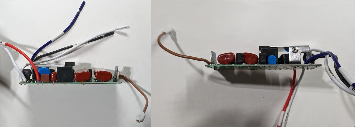

    About the board
    The unit ships with a Beken BK7231N on a CB2S:
    On the front of the chip, only CEN pin was soldered to the board.
    On the back of the chip, all pins were soldered to the board.
    However, the only important pins seem to be Tuya_Rx and Tuya_Tx.
    ESP8685-WROOM-03 is a direct drop-in replacement just with different pin names.
    CB2S : CEN || 3v3 | GND | RX1 | TX1 | P24 | P26
    ESP-x : _EN || 3V3 | GND | RX_ | TX_ | IO5 | IO4

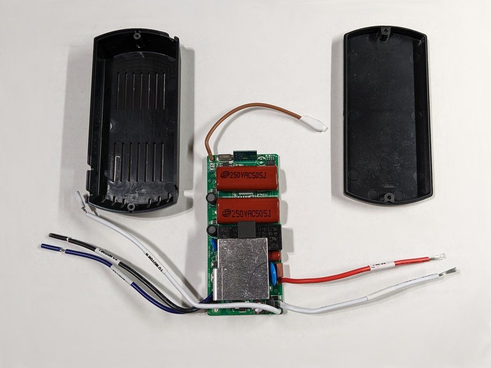

    Open smart ceiling fan remote control with internal components exposed. PCB with electronic components, including a CB2S module and two large capacitors. Close-up of a circuit board with electronic components. Close-up of a circuit board with electronic components and capacitors. Circuit board of a ceiling fan remote control showing capacitors and components. Electronic module for ceiling fan control.
    Printed circuit board inside a device casing with protruding wires.
    Printed circuit board with various electronic components and wires.
    View of the circuit board of a ceiling fan remote module.

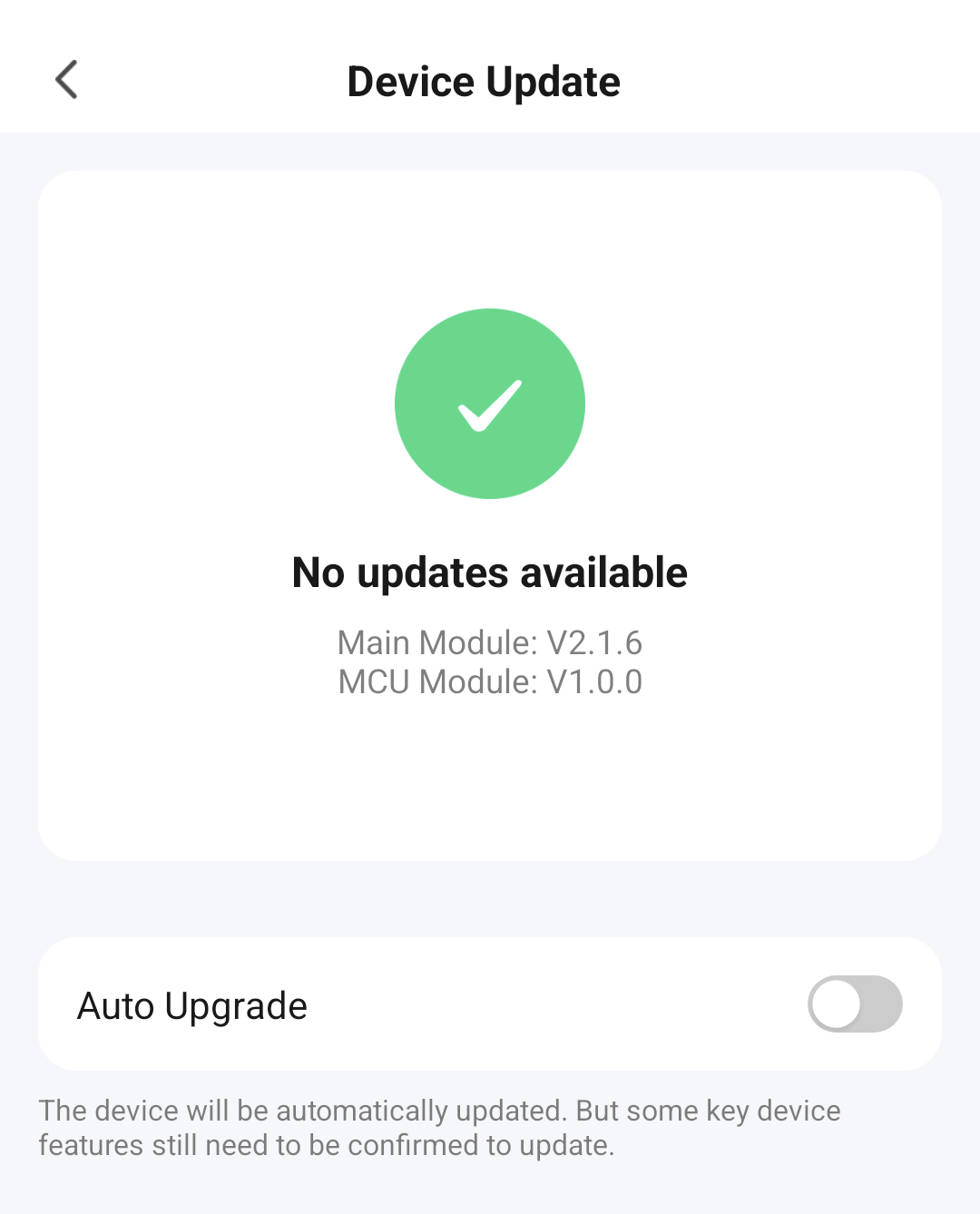

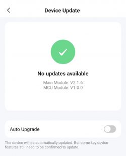

    Tuya Cloud Controls and Device Info:
    Prior to flashing the device, I tried to gather as much information I could regarding the stock functionality.
    Below are the features available in the Tuya Cloud app and Version Info provided.

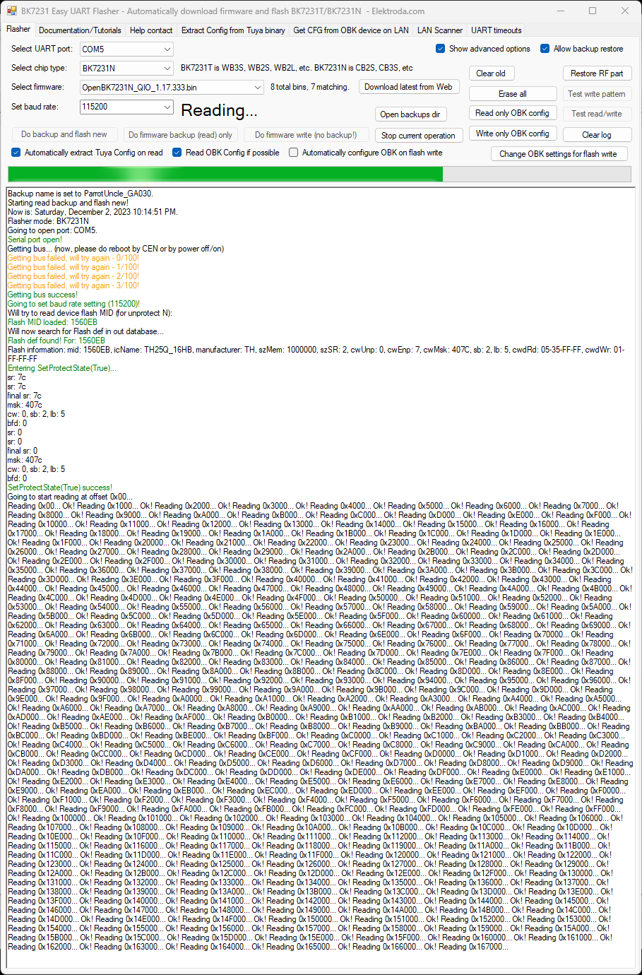

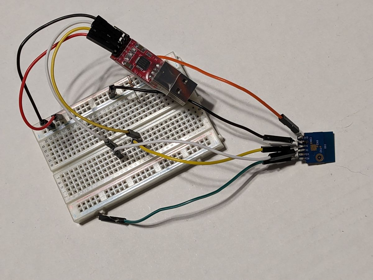

    Once I acquired all of the data I believed to be available, I desoldered the CB2S from the unit and flashed it using bk7231flasher_1.1.2.
    Controller module mounted on a breadboard with wires and a USB programmer.
    Getting the module into flash mode was easy; simply tap the CEN pin to ground while bk-flasher is first attempting to read the bus.

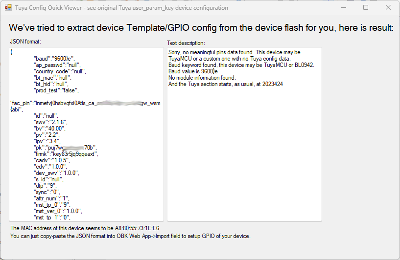

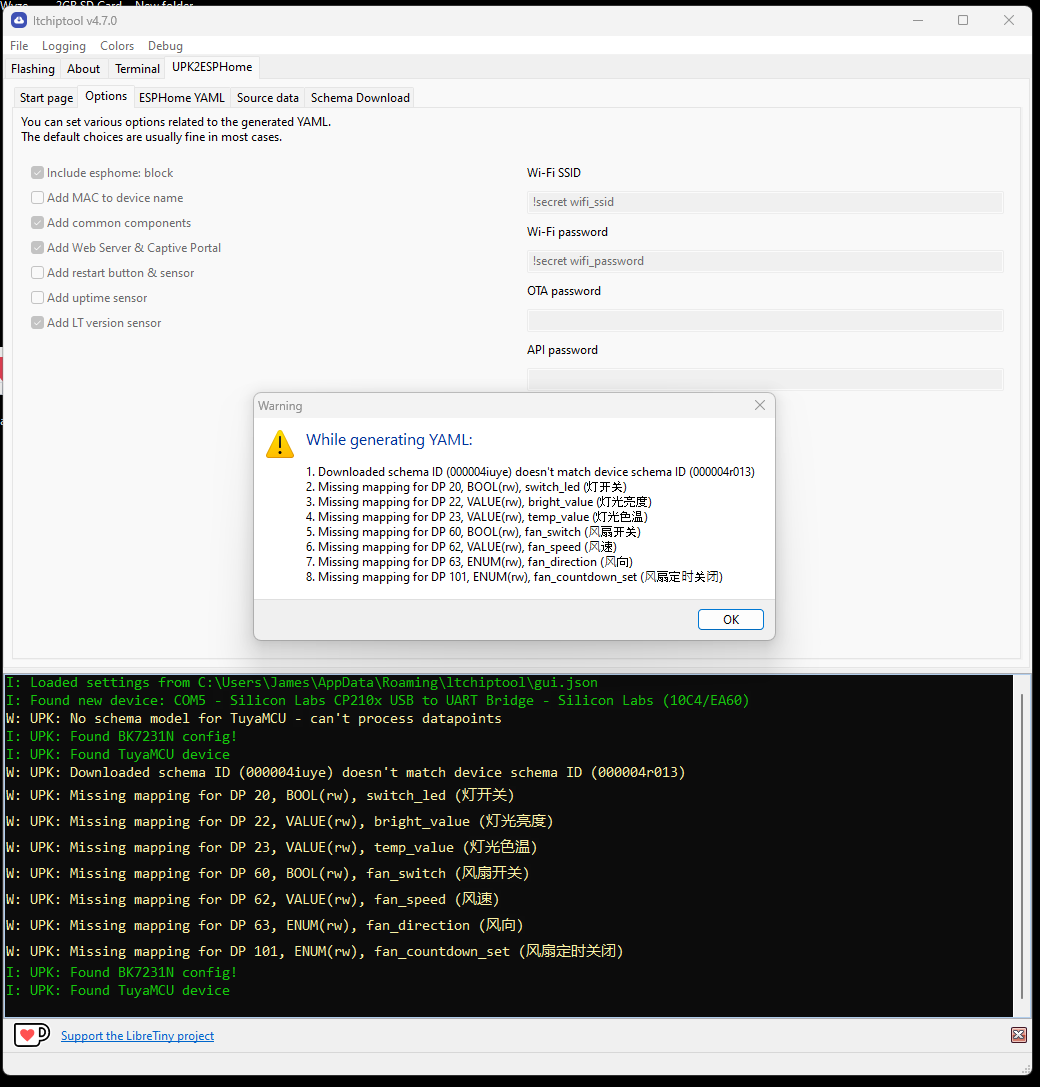

    Reading the output for the Template/GPIO config had me concerned.
    Device configuration with Tuya Config Quick Viewer
    Dumping the config from ltchiptool yielded similar concerns.
    Screenshot of ltchiptool showing a list of warnings during YAML generation.

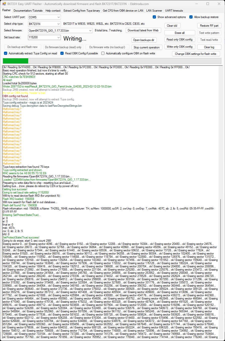

    I proceeded with the flash.
    Screenshot of the BK7231N Easy UART Flasher tool with operational log of a flashing process on a processor. Screenshot of BK7231 Easy UART Flasher tool during device flashing.

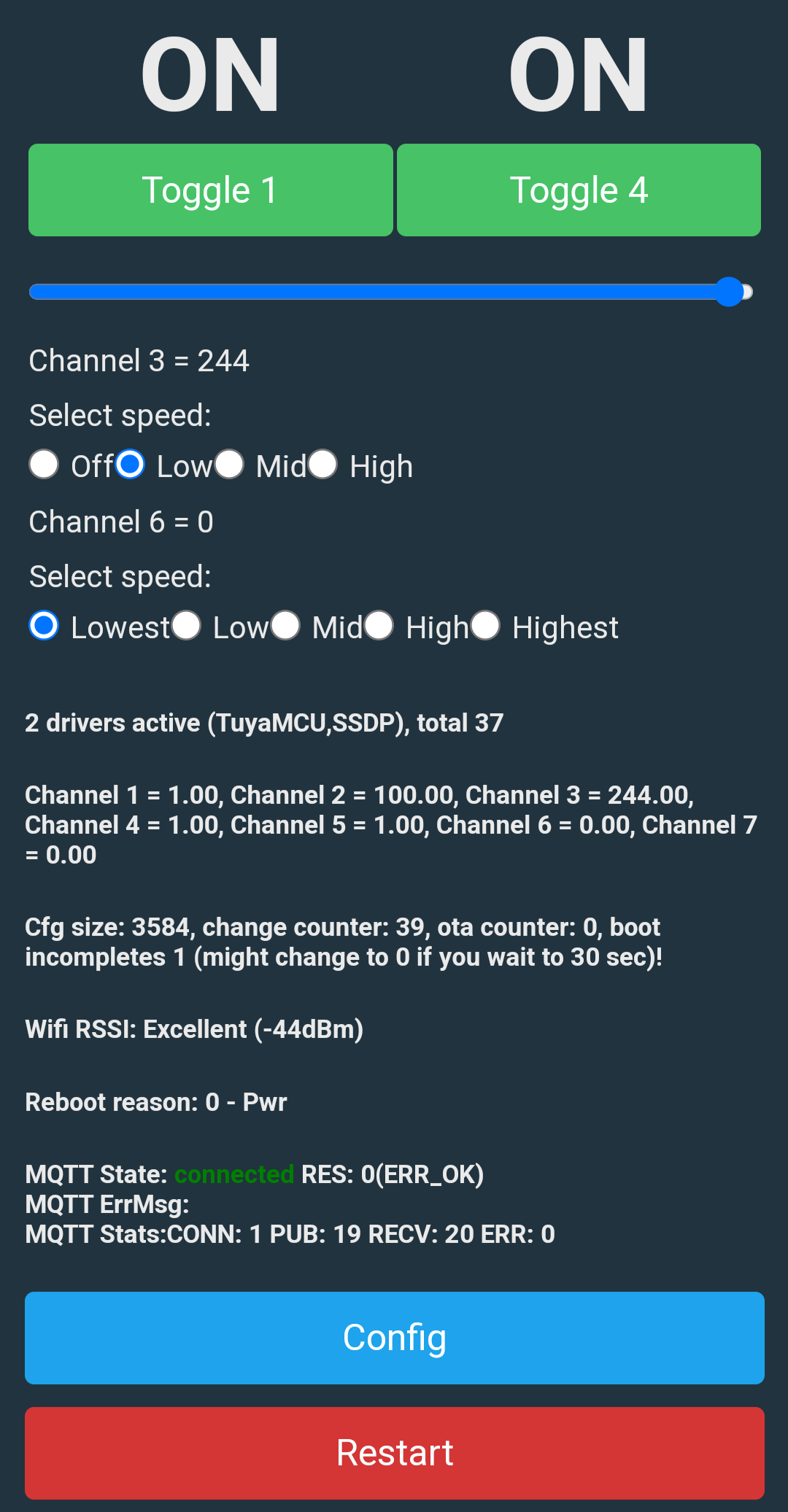

    It turns out that OpenBeken communicated with the TuyaMCU out of the box without needing to configure any pins. The rest of the pins do nothing and all of the configuration is Channel based using the autoexec.bat.
    After much debugging and button-presses on the RF remote, I was able to develop the below autoexec.bat
    autoexec.bat should contain the below content and be uploaded to the file-system of the OpenBeken flashed device.
