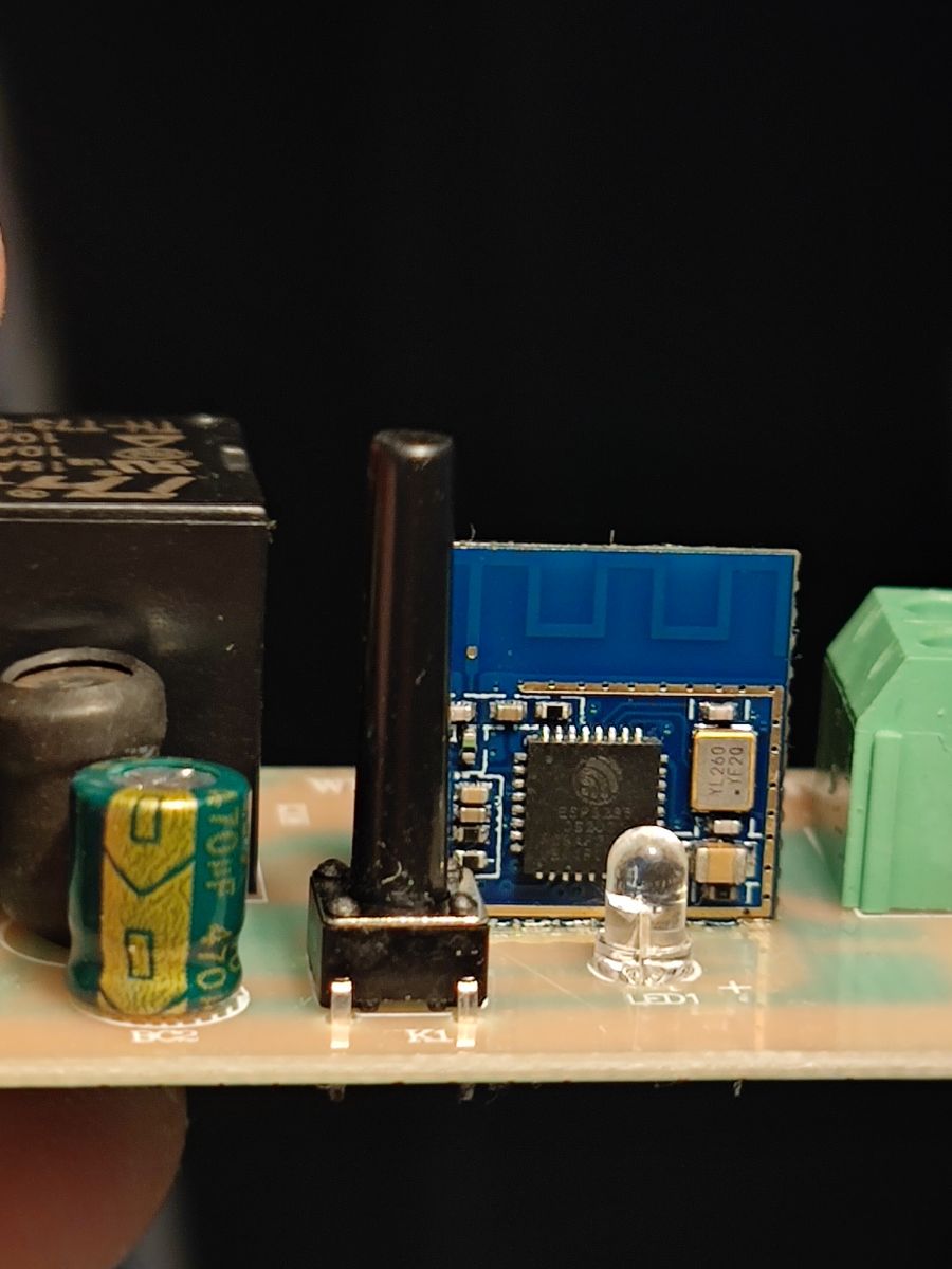

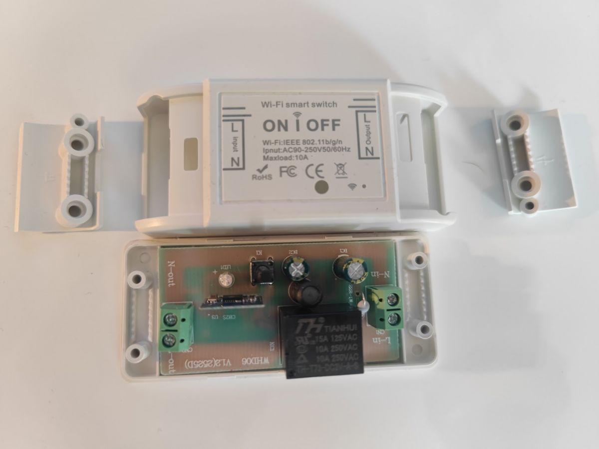

    This is a 10A smart breaker that I got off AliExpress. It has an ESP8285 chip inside for which the GUI flashing tool didnt work, nor did cloudcutter. Software I believe was 1.1.8 but I have no way to check anymore and I forgot to write it down!

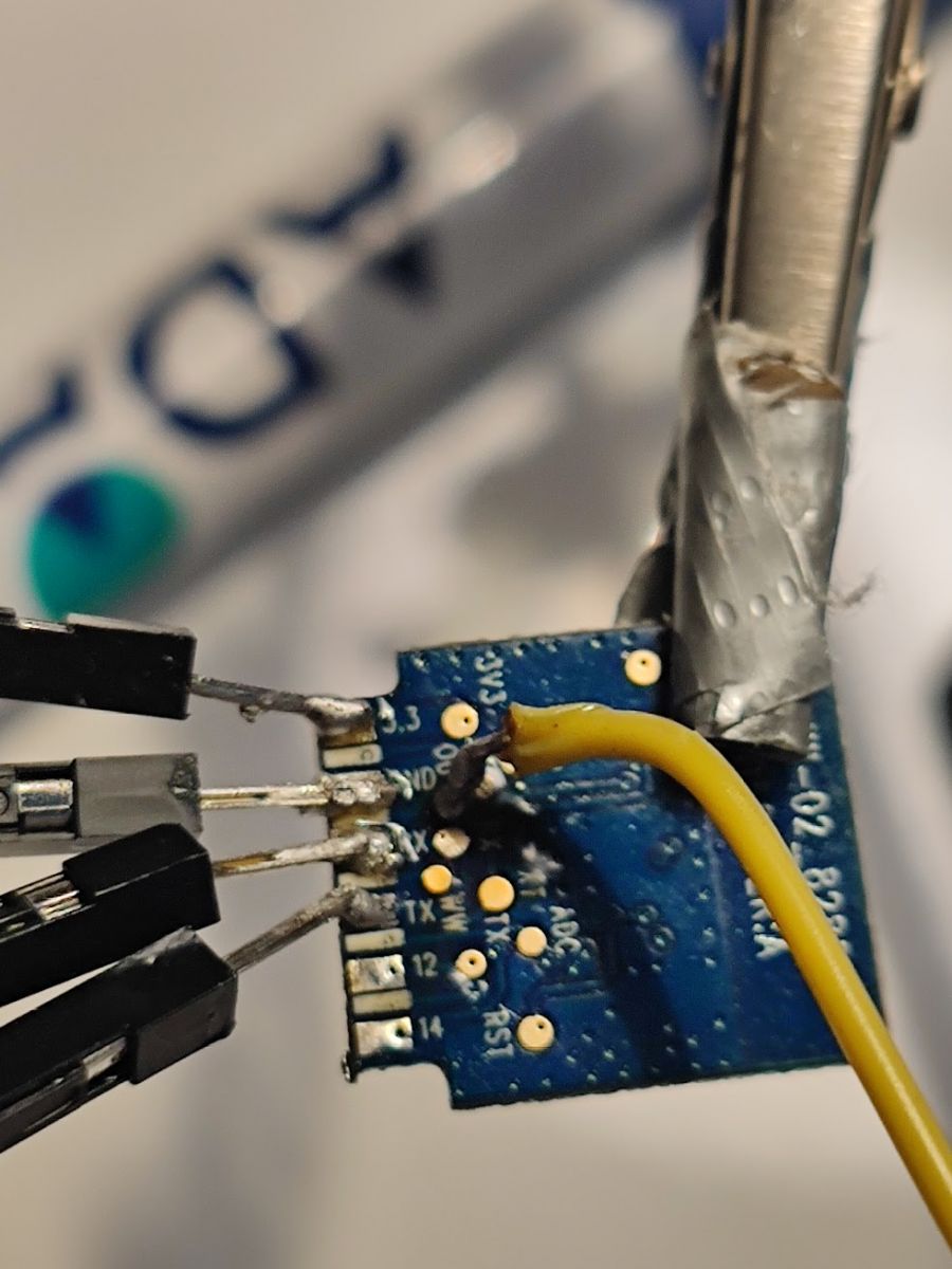

    To flash the chip, I desoldered it from the pcb and connected rx, tx, 3.3v, gnd and gpio pins to a usb-uart ttl converter. I tried flashing without desoldering but think the capacitors messed up the timings..
    I flashed the chip with EspHome using the EspHome wizard (see https://esphome.io/guides/getting_started_command_line.html) and extensive esphome docs to guide me. Finally, I flashed the following config.yaml after some trial and error to get the relay, button and wifi-led set up:

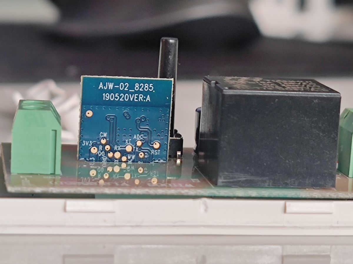

    That's a very interesting module, is it TYWE2S? It doesn't look like so. What's the marking on the front of it?
  • #3 21114089
    donut343
    Posts: 18
    So this module doesn't really have a marking:
    Close-up of an electronic module with the ESP8285 chip and unreadable markings.
    The chip itself says esp8285 and the rest I cannot really read! If you Google AJW-02_8285 you can find some more info though
