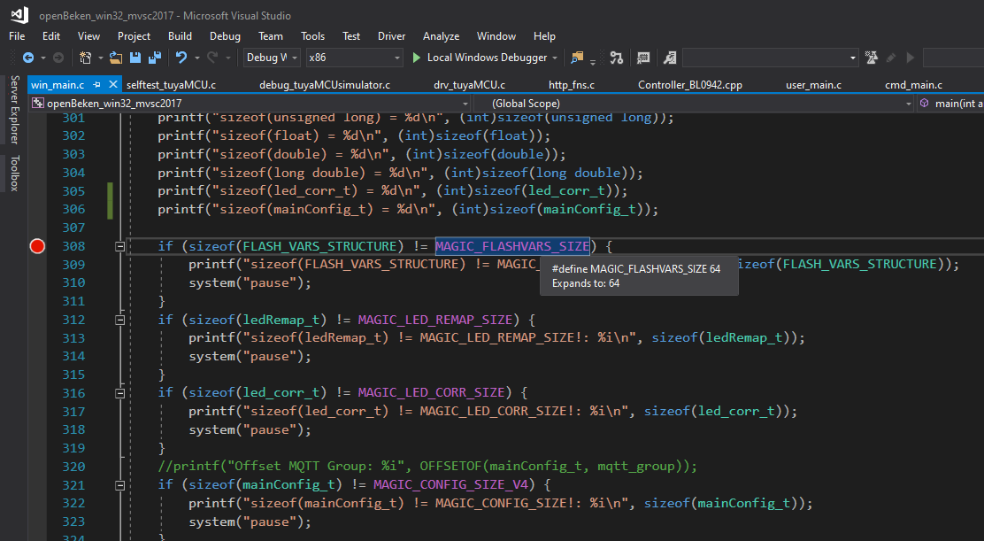

    mainConfig_t size is currently 3584 bytes (or similiar), I don't think it will ever grow beyond single page - 4096 decimal (0x1000 hexadecimal). If we assume that, we still have 0x7000 (7 pages) for Flashvars, which change often. But flashvars size is 64, and page is 4096, so we do one erase cycle per.... 4096/64 = 64 , per 64 flash var changes. And that is distributed over 7 pages. I hope it can be enough to ensure that flashvars won't wear flash too early?
    LittleFS should have at least the option to grow very big so people can host size. If possible, we can make small LittleFS by default at the end of some kind OTA partition and allow users to grow it with the drawback that OTA will erase LittleFS - that's what happens on Beken. I'm not sure if it's possible here.

    >>21364456 Flashvars are 80 bytes, because time_t is 64bit in arm-none-eabi-gcc in ubuntu 20.04 (gh actions). So it is that, + whatever else easyflash will add.
    + on tr6260 0x3000 was not enough for cfg without flashvars

    I see... it seems that Flashvars have grown outside of my control. In my Windows selftest code, I am still using 32-bit time_t (there is a define for that on Windows) and the following check passes:
    Screenshot showing code in Visual Studio with highlighted if conditions for FLASH_VARS structure.
    I didn't take in account easyflash, but I have nothing against using it. In the past I've been considering moving our BK flashvars method to shared source and only call HAL for flash, but I don't think it's worth it. We need to just support new platforms, we can use EasyFlash if it makes progress faster.

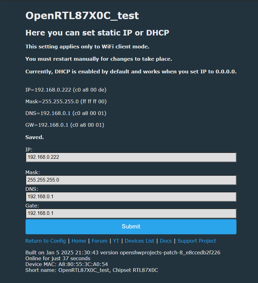

  • Static IPs simplify access for nontechnical users
    #105 21369879
    DeDaMrAz
    Posts: 620
    Help: 34
    Rate: 130
    Argument for static is that it is hard for people without any knowledge of LAN, so they can set the address and just go there, without having to know how to find what their DHCP assigned to that device or run a flasher to look through LAN scanner etc.
    But for initial release it is plenty good enough I would say.
    At some point we will run out of chips to support :) and than we can jump in and polish those details.

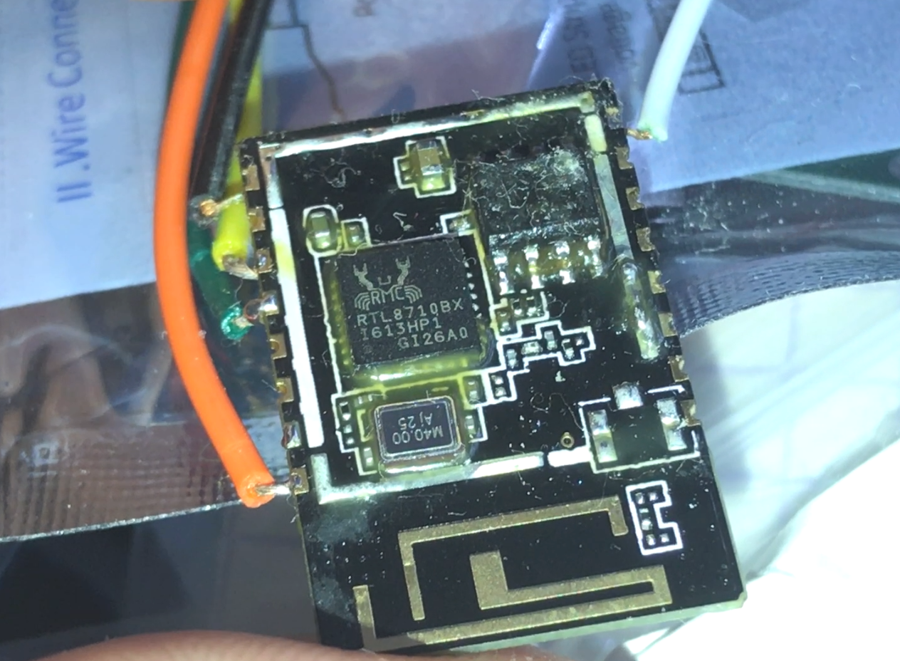

    Is it this chip?
    Close-up of a microchip labeled RTL8710BX with soldered wires.
  • #107 21369897
    insmod
    Posts: 1432
    Help: 168
    Rate: 455
    >>21369894 I haven't ran any sdk example, but sdk is latest master amb1_sdk, which LT uses too.
    Yes, i have a T102_v1.1 module with BX chip.

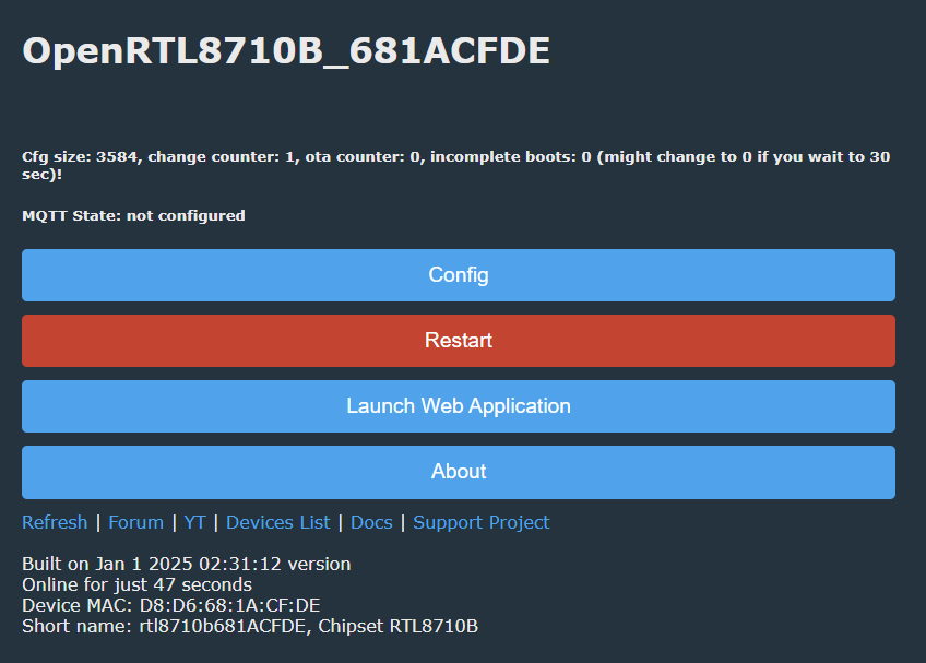

    OpenRTL8710B configuration screen with option buttons.
  • WBR3 UART routing to CH340 on NodeMCU board
    #109 21371465
    Posts: 14756
    Rate: 12881
    Very good! What was wrong before?

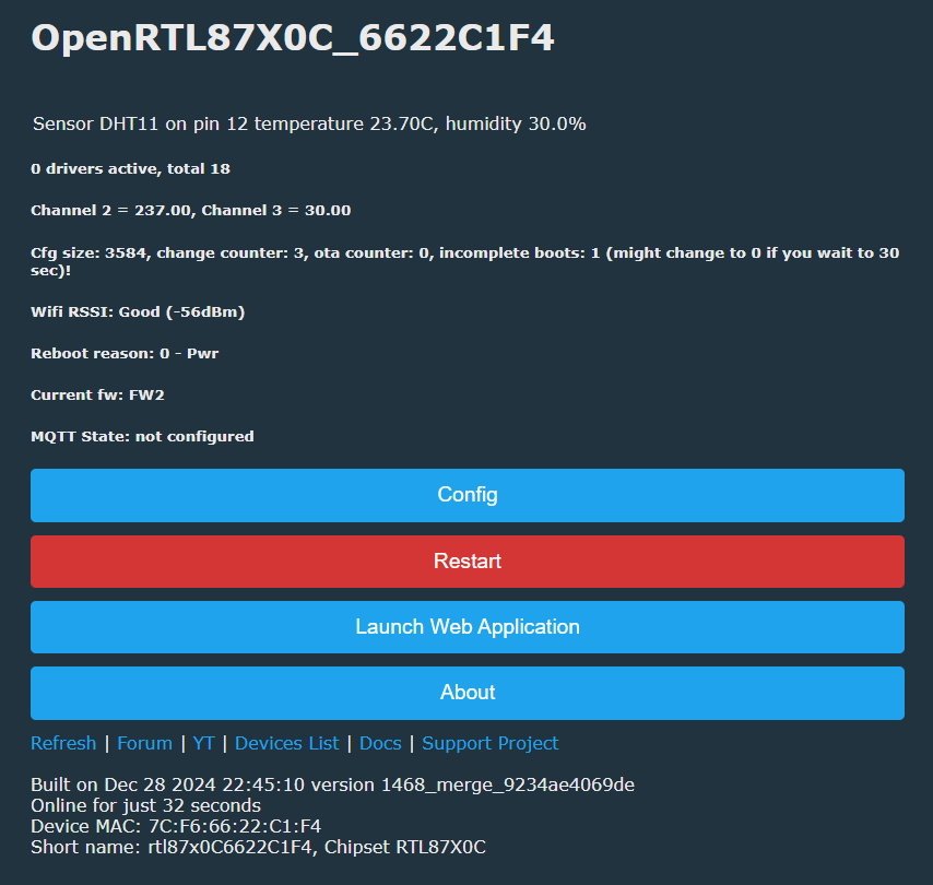

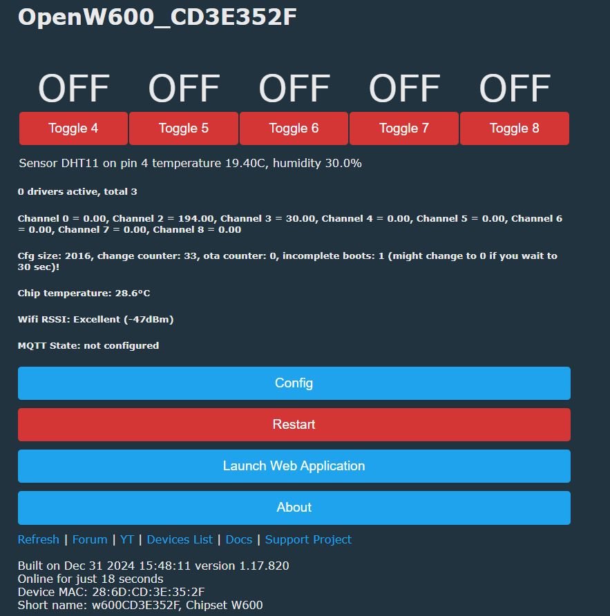

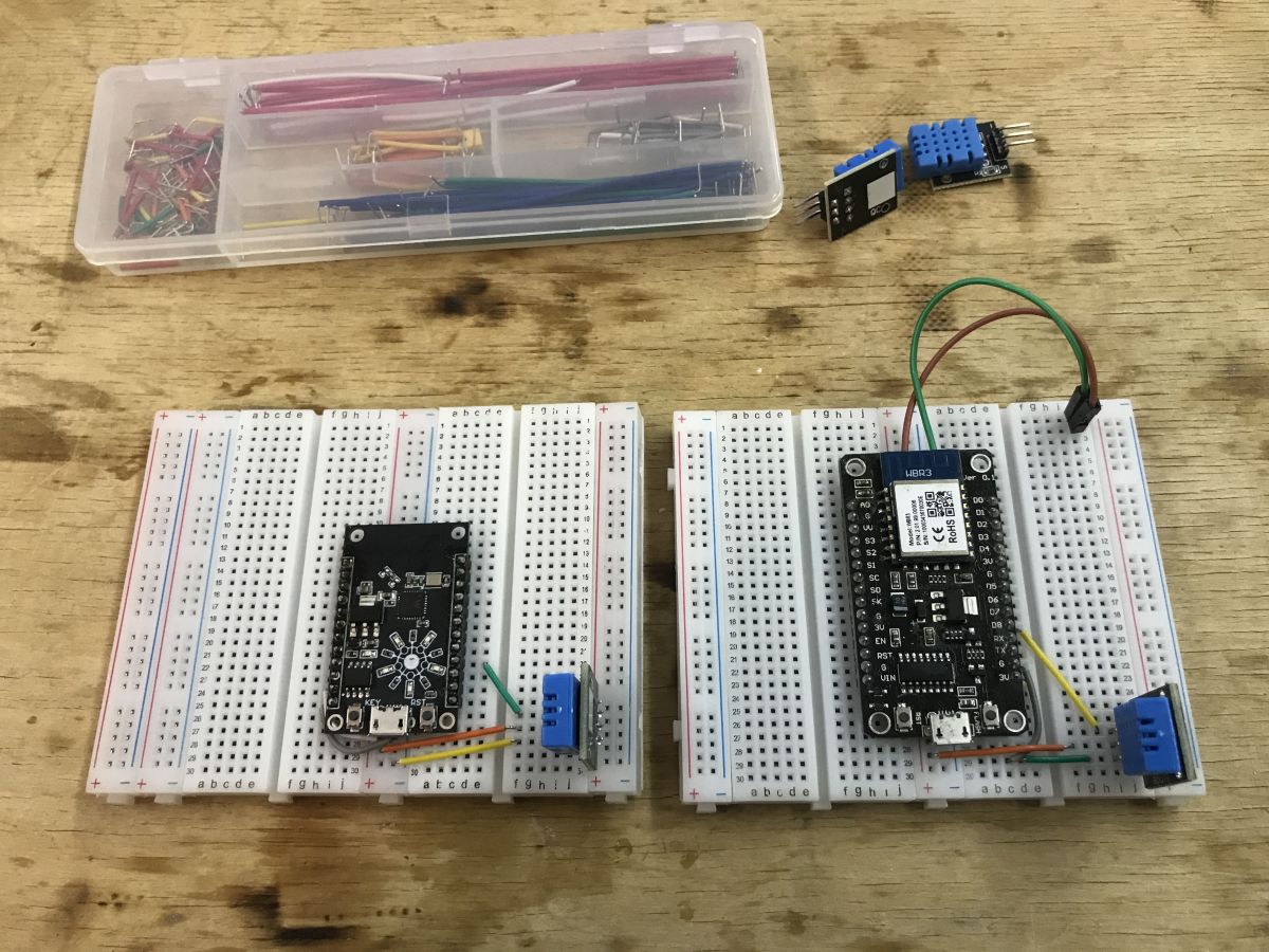

    I also have some progress, my DHTs and dev boards arrived:
    Breadboards with electronic modules and accessories
    User interface displaying device status for OpenRTL87X0C_6622C1F4.
    OpenW600 control panel with active toggles and temperature information.
    WBR3 is soldered into NodeMCU board. I think it may be possible to route WBR3 UART to CH340 on this PCB. Not sure about the pins that should be pulled high... in worst case the pull would have to be manual (with extra wires).
    I'm waiting for 10x DS18B20 shipment as well.

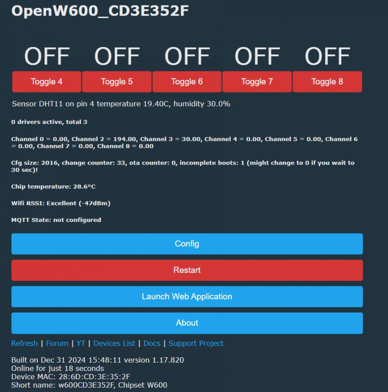

    Is anyone able to do any more tests like today or tomorrow? W600+DS18B20, W800+DS18B20, etc?
    Just tested W800+DS1820 driver (LN882H+DS1820 was already proved working fine):
    Works like a charm, in my opinion W800 used to be the most reliable platform regarding timing and DS1820 and I can confirm, it's still working very well (more than 10 minutes with temperature readings every 2 seconds and not a single error!)

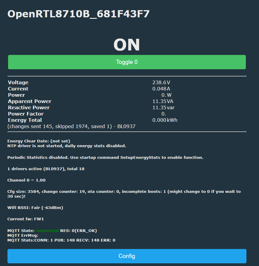

    Screenshot of the OpenRTL8710B user interface showing the device in the on state with energy data and statistics.
    Pins and interrupts are working.
    Powersave: 1 is like on rtl8720c (wifi_enable_powersave), 2 is the same + rtl8710b specific rtw_wlan_low_pw_mode's + half the cpu frequency and pa_gain, 3 is quarter the frequency (31.25mhz) and pa_gain /3. Powersave 3 breaks interrupts (values are halved) and sleep (ms and us, both are mitigated with sleepfactor 2).

    IP configuration interface with static and DHCP settings for OpenRTL87X0C_test.
    Based on the PR 1492, static IP works an the device is accessible but I have a WiFi LED set up and it is still blinking.
The discussion confirms that OpenBeken support applies to the RTL8720CF-based Ameba Z2 family, including WBR3 and BW15 modules, but not to RTL8710BX, which belongs to a different AmebaZ/Ameba1 family and is unsupported by the RTL87x0C port. The port initially provides Wi‑Fi, GPIO, flash config/vars, LittleFS, WDT, OTA, and UART support, while several issues are investigated and fixed during development, including heap drain in TCP servers, MQTT authorization, PWM reboot freezes, static IP, and timing-sensitive sensor drivers such as DHT11 and DS18B20. Flashing procedures, UART pinouts, and tool compatibility are also discussed, including use of PG Tool, CH340G, and later BK7231GUIFlashTool for read/write support. The thread evolves into broader RTL87x0C port testing, Tuya config extraction, partition layout adjustments, and validation on WBR3/BW15 hardware.
