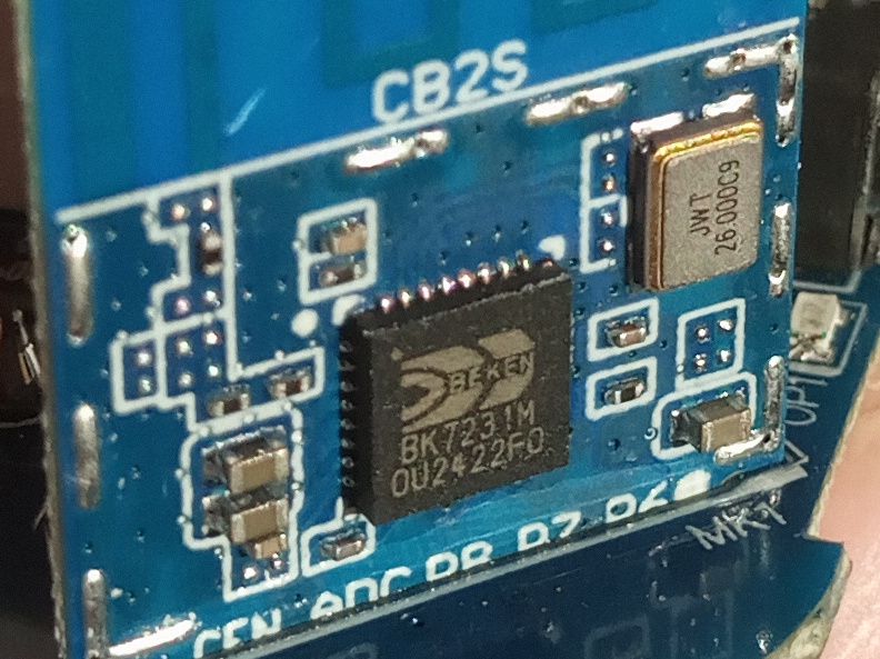

    Hi all. I'm trying to flash Aubess plug via serial adapter. Flashing completed successfully, but no open AP was created. LED lights dark, after 30-60 seconds it starts to light bright.
    $ sudo ./uartprogram ../OpenBK7231N_QIO_1.17.308.bin -d /dev/ttyUSB0 --unprotect -w --startaddr 0x0
    UartDownloader....
    program....
    Write Successful: ||[ 15.3k/s]
    flashing 1.14.1 like in similar thread here https://www.elektroda.com/rtvforum/topic3926632.html had same results
    what did I wrong?
    P.S. chip looks like BK7231M (marking is unclear)

  • Bootloader likely at fault; considering SPI flash dump
    #6 20850697
    nitr0mankr
    Yes, I saw this topic. It seems like the trouble is more likely in the bootloader, not in the chip itself. Just because the serial dump is unencrypted and doesn't look like firmware with a bootloader, it looks like an app module. And the dump is flashed back successfully and works OK. Maybe there's a difference in bootloader dump/restore handling (something like BK7231T).
    I can try to dump flash via SPI (I have ch341, AFAIR there's ch341 SPI driver for Linux).
  • #7 21109473
    Posts: 14754
    Rate: 12875
    Thanks to the reader who send me BK7231M, I've been able to solve the flashing issue. This BK7231M requires a binary built with different encryption keys. Here is final solution:
