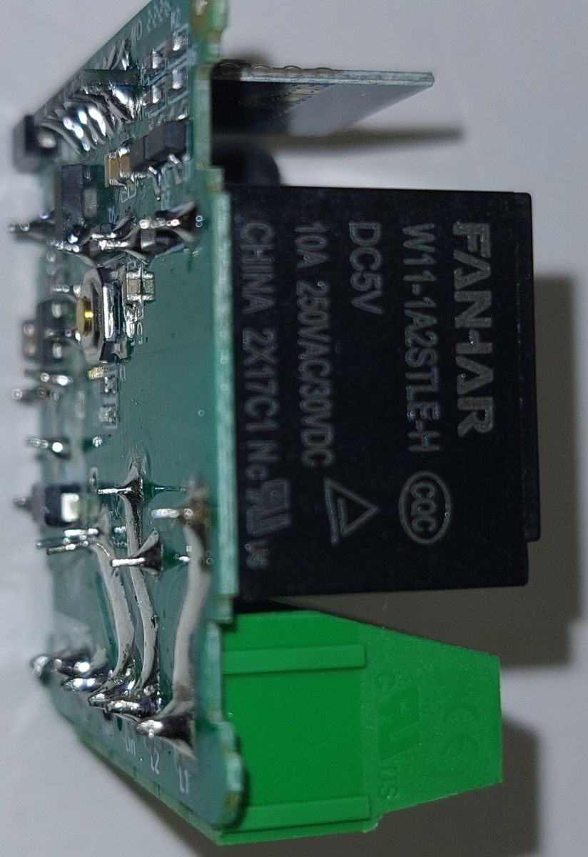

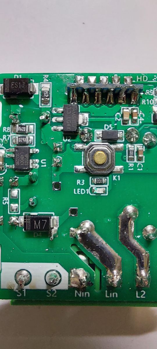

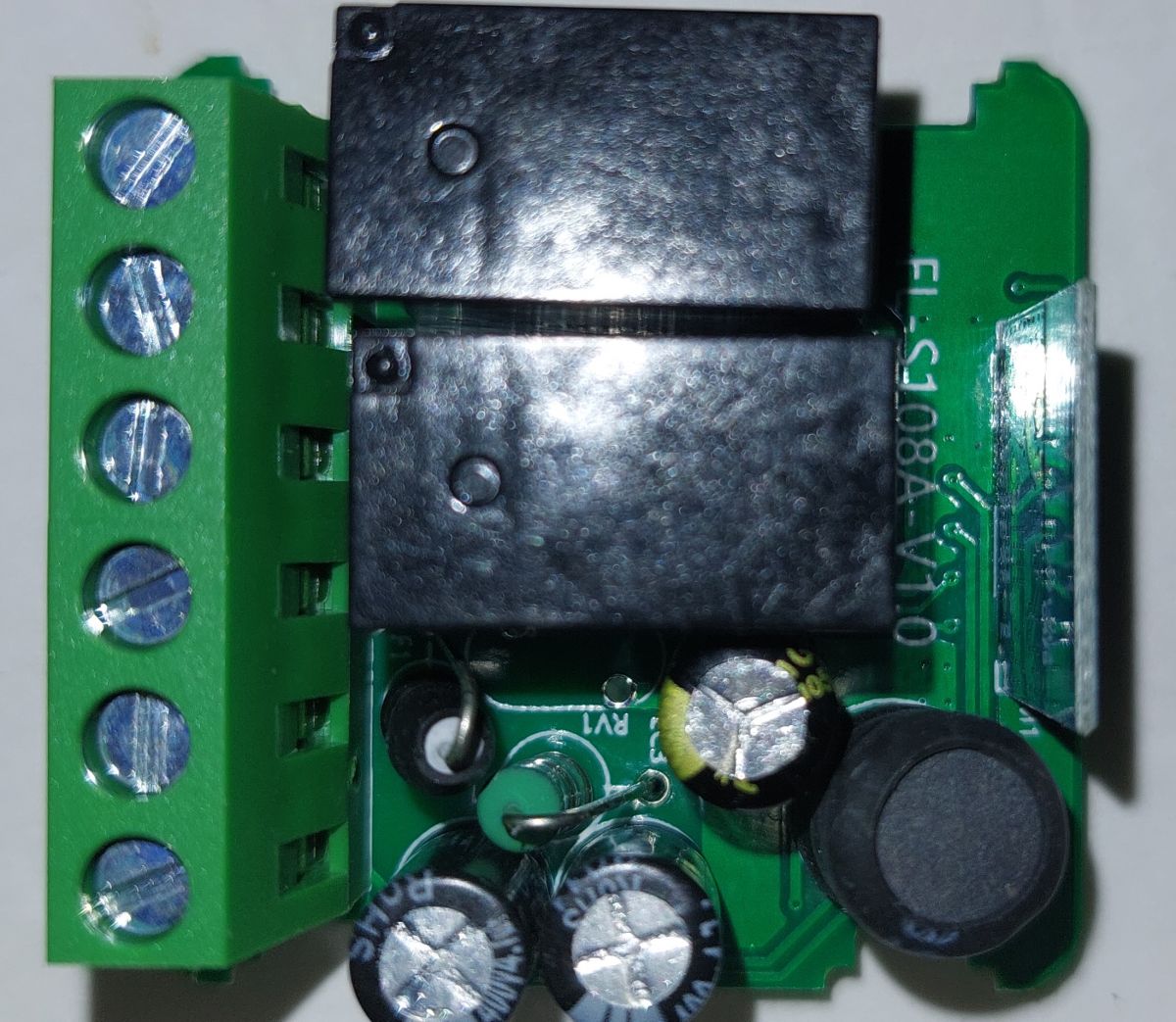

  • An Aubess 2gang Mini Smart Switch based on BK7231N/CB2S is converted to OpenBK7231N firmware.
  • The flash uses hid_download_py uartprogram from a TTL-USB adapter, with CEN briefly shorted to GND to trigger read and write mode.
  • The example uses Python 3.8.10, com35, and a 0x200000 backup size before writing OpenBK7231N_QIO_1.15.149.bin.
  • Backup and reflashing complete, but the CEN-to-GND step can fail and may require several attempts.

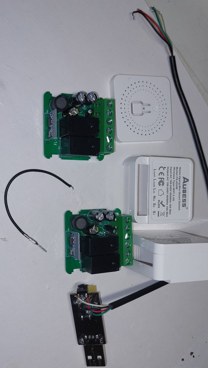

    For firmware, I use the ESP-01 firmware module with a piece of soft cable from the keyboard.

    Running the command line cmd.exe
    Going to the root of the disk: cd\
    I go to the directory with the program: cd hid_download_py
    By this point, it is already necessary to know which port number the TTL-USB converter has.
    I read the firmware, I have com-port35, with the command: python uartprogram backup_2mb_default_02_switch_2ch.bin -d com35 -r -l 0x200000
    After pressing "enter", I briefly connect CEN and GND, the firmware is read and the file specified in the command is created in the hid_download_py folder.
    The connection of CEN to gnd should be short-lived, casual. It may take several workouts and still won't work the first time.
    After reading, we load the necessary file with the command: python uartprogram E:\BK7231\OpenBK7231N_QIO_1.15.149.bin --unprotect -d com35 -w --startaddr 0x0
    where E:\BK7231\OpenBK7231N_QIO_1.15.149.bin the path to the file and its name.
    the procedure with CEN is the same as when reading.

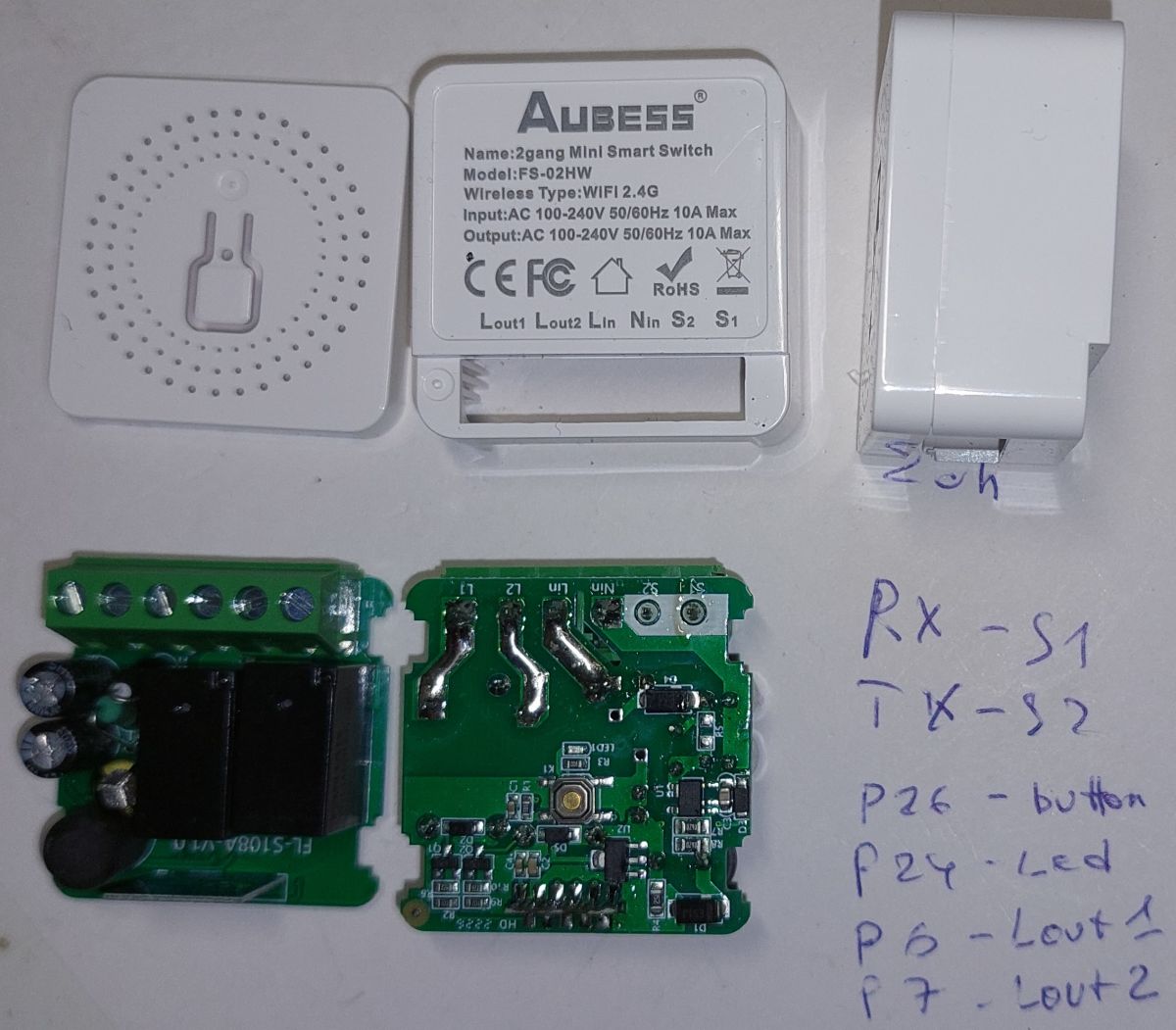

    Pin assignment
    P6 - Lout1
    P7 - Lout2
    P10(RX) - S1
    P11(TX) - S2
    P24 - led
    P26 - button

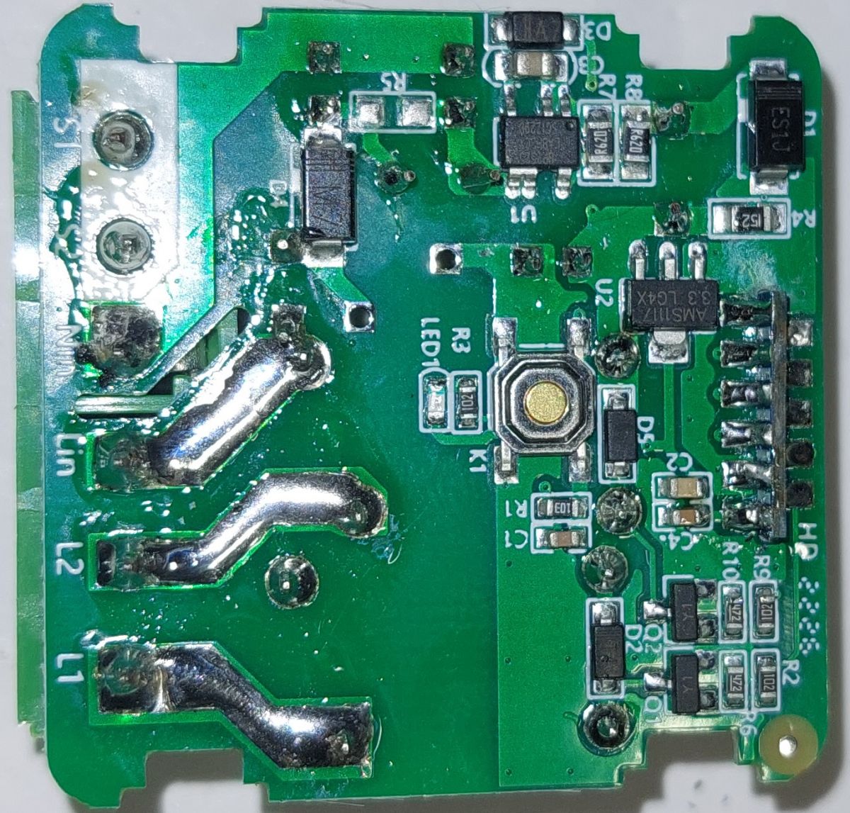

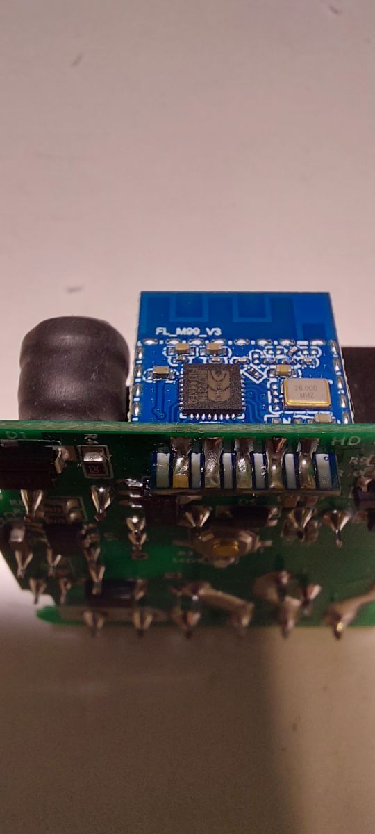

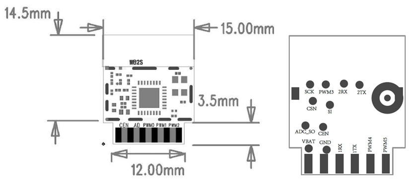

    The WiFI module here is interesting. I can see label: FL_M99_V3 . Is it the same as WB2S?

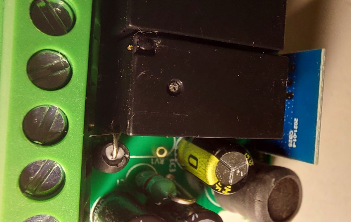

    there is a marking on the back of the module cb2s, BK7231N

    Ah, sorry, so it's N and not T. That's good to know. Oh indeed, I can see a small CB2S marking on the back of the module. Hmm. That's interesting.
    btw FL_M99_V1 was supposedly BL2028N :
    Aubess 2gang Mini Smart Switch BK7231N /CB2S
    Related: https://www.elektroda.com/rtvforum/topic3930515.html
    You are finding very interesting things, @omelchuk890 . It gives us a glance at the Tuya modules history.
