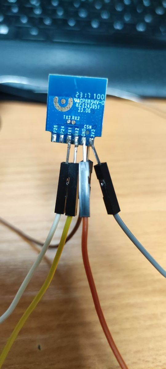

    Hi,
    I bought 2 of these controllers: https://es.aliexpress.com/item/1005005872942237.html

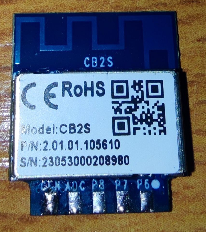

    They had a CB2S inside, I desoldered it:
    Close-up of CB2S module with model and serial numbers visible on the label.
    Close-up of a printed circuit board with visible pin labels.

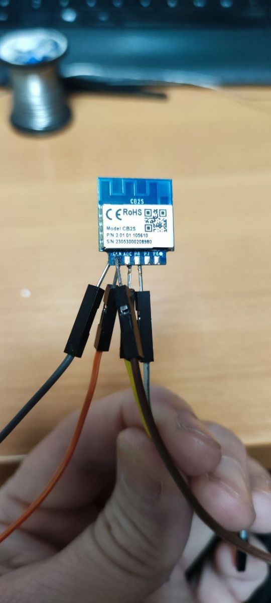

    I soldered some dupont cables:
    CB2S module with attached Dupont wires.
    Close-up of an electronic board with soldered Dupont cables.

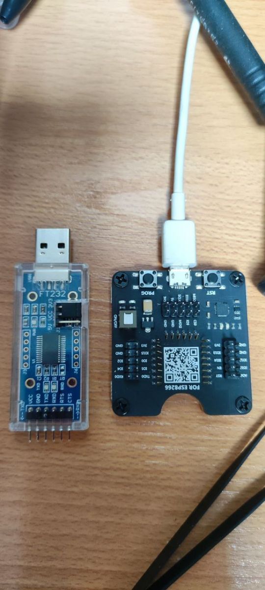

    And I'm using both of these programmers:
    Two electronic programmers, FT232R USB on the left, and a board with a PROG button and micro USB port on the right.

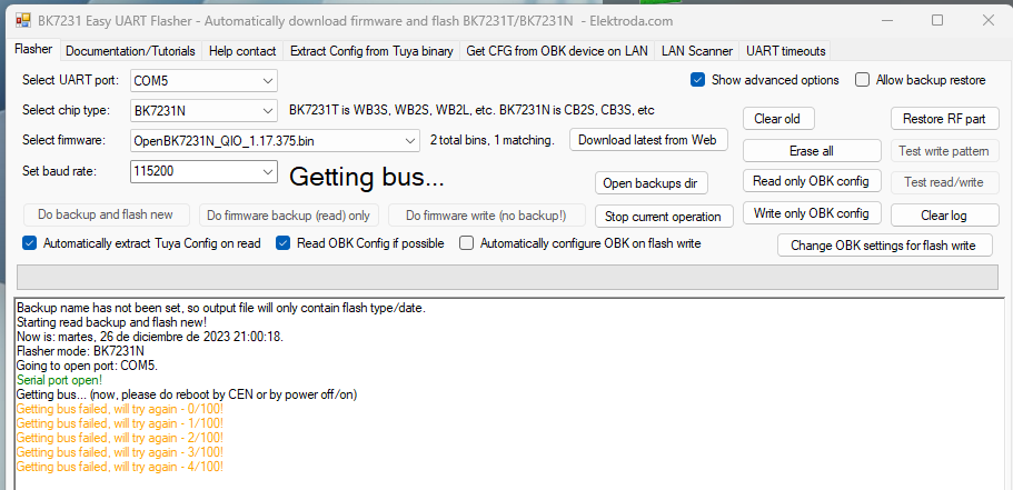

    But... it's impossible to flash OpenBK.... (BK7231Flasher 1.1.6 used.)
    Screenshot of BK7231 Easy UART Flasher with firmware flashing interface.

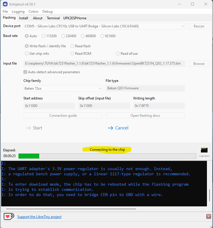

    Tried Itchiptool 4.10.1, and the only success is when I short the CEN pin with Ground, the Connecting to the ship (in yellow at the photo), changes to software reset / hardware reset.
    Screenshot of Itchiptool 4.10.1 program attempting to connect to a chip.
    But nothing at all, no connection...
    Any idea? I just can see that there is NO RX1, it's only RX2, and it doesn't seem like a typo...
    Edit: more info: Tx light is blinking like if the program is sending data but the RX light is always off, only lights minimal when I short CEN to ground.

    You are connecting your wires incorrectly.
    I had this module.
    It has misleading silkscreen. The 3.3V and GND are not where you think they are.
    Please double check with your PCB.
    I think the real 3.3V and GND pads are as shown here:
    Module schematic with incorrectly labeled 3.3 V and GND pins.
    Your module has mixed pad markings and they are misleading. Again, please double check, but I already had module looking exactly like yours and I flashed it the way like I would flash old CB2S...
    PS: To be honest, when you look at the pin marked as "P24", you can see it's really a ground pour plane:
    Close-up of a board with pin labels, with two arrows pointing to pins P26 and P24.
    So I think my idea checks out.

    Oh my god...
    I was so tempted yesterday to do this...
    Thanks a lot, it's working on the first try!

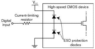

    I am glad to hear your issue is resolved. I had exactly the same module as you, and I checked it well against the traces on the main PCB. The silkscreen is wrong, just as I said.
    You're lucky that you haven't damaged the module, but luckily they have protection diodes at all GPIOs, something like this (without resistor):
    Block diagram of a CMOS device with ESD protection diodes.
