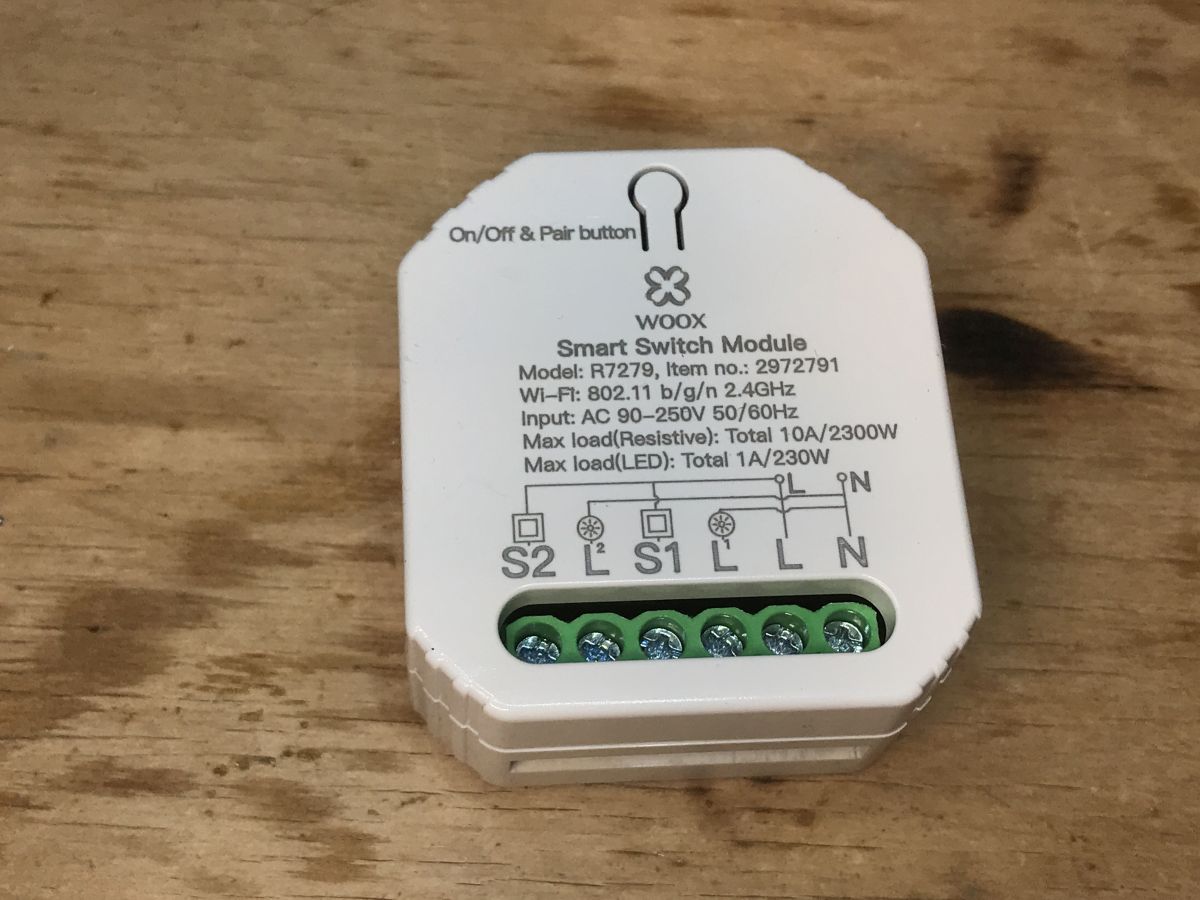

    Packaging and description of the Woox R7279, a dual in-wall WiFi relay module.
    Specification:
    Woox R7279 module with technical specifications.

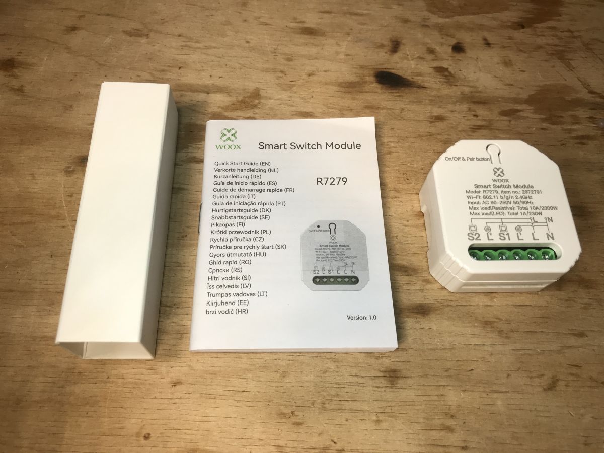

    R7279 works with the Woox application, but here I will show you how to change its firmware.
    This is what we get in practice:
    Packaging of the Woox R7279 dual relay module Side of the Woox R7279 module packaging with Google Play and App Store apps. Woox R7279 module packaging with information about no subscription required. Side of the Woox R7279 module box with technical data. Woox R7279 relay module with instruction and packaging
    Interestingly, there is a code on the packaging: 2972791.

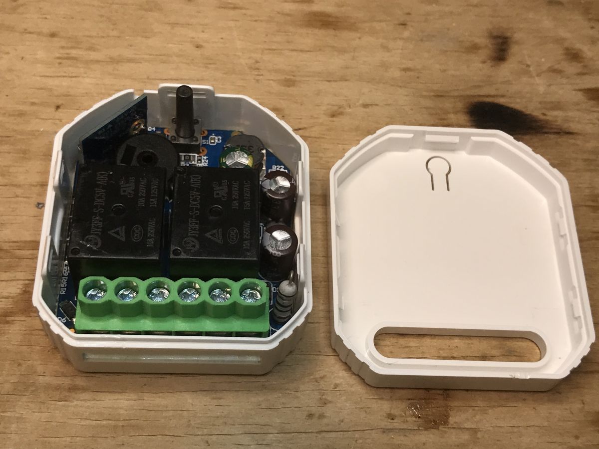

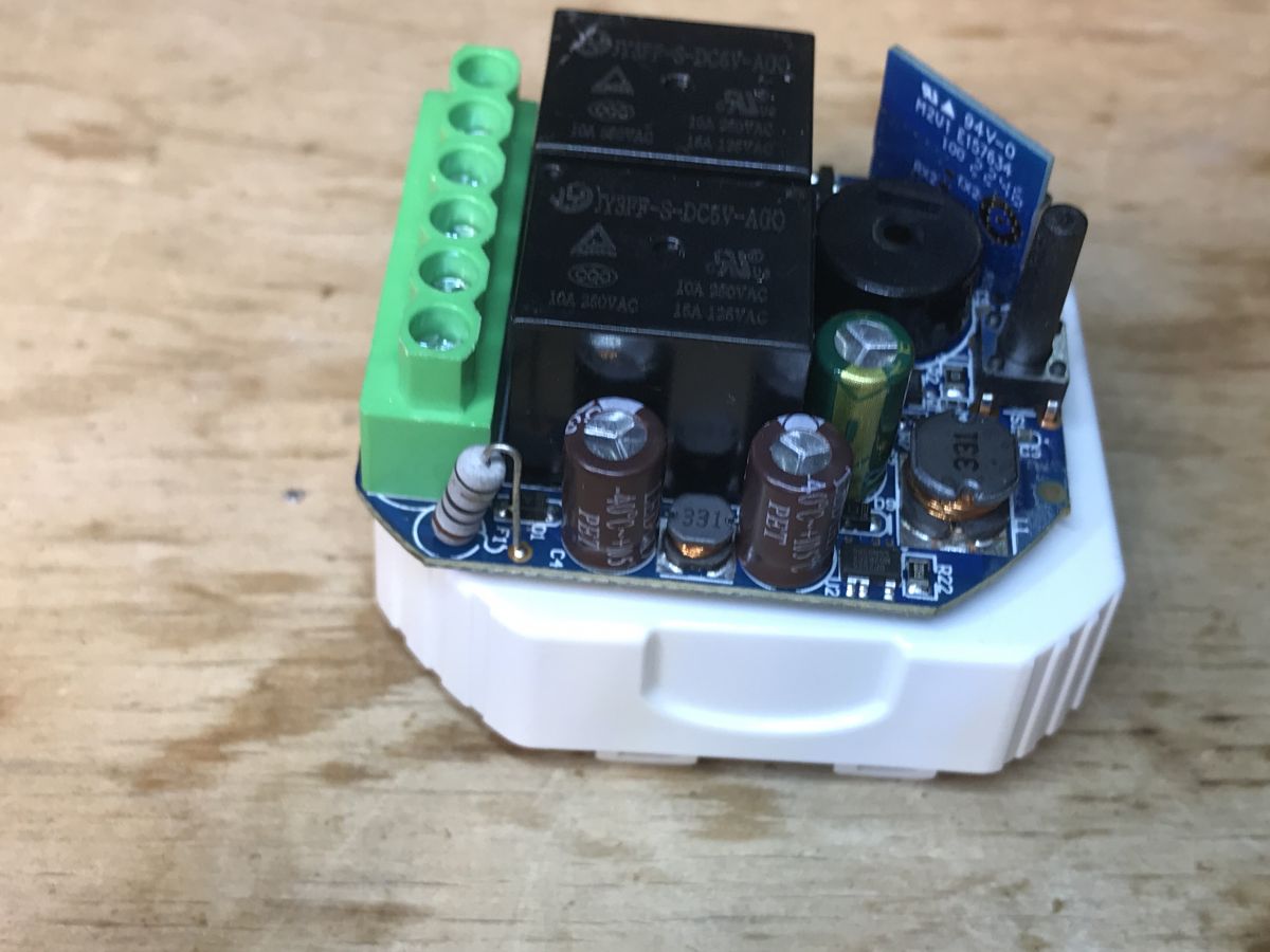

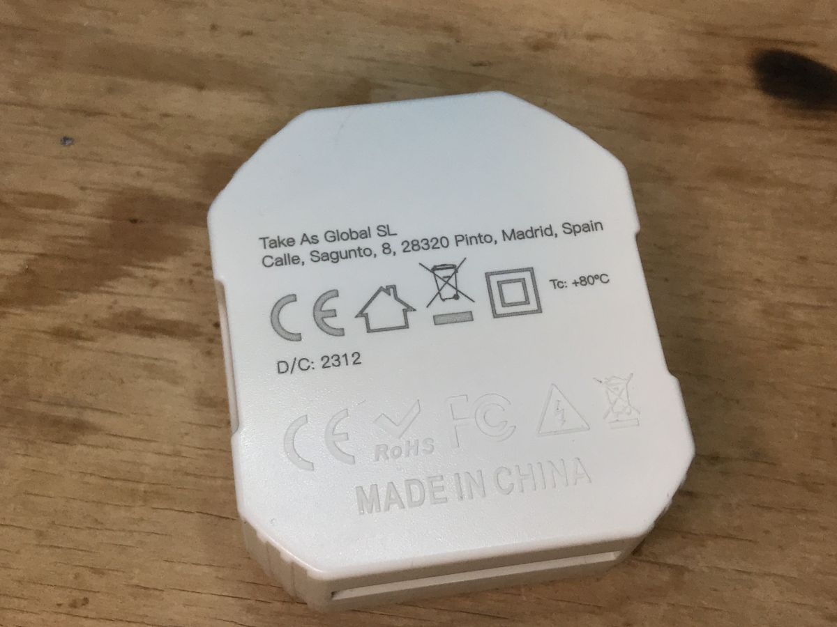

    R7279 interior
    Normally, you just need to pry the casing off. There are no screws.
    Interior of the Woox R7279 relay module with buzzer White Woox R7279 module with markings on the casing. Back of Woox R7279 module with manufacturer labels and certifications.
    At first everything looks standard:
    Interior of Woox R7279 relay module with buzzer

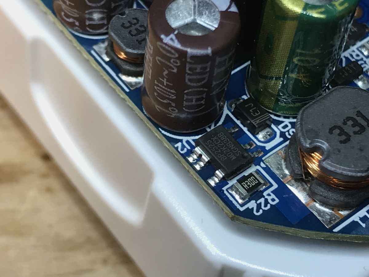

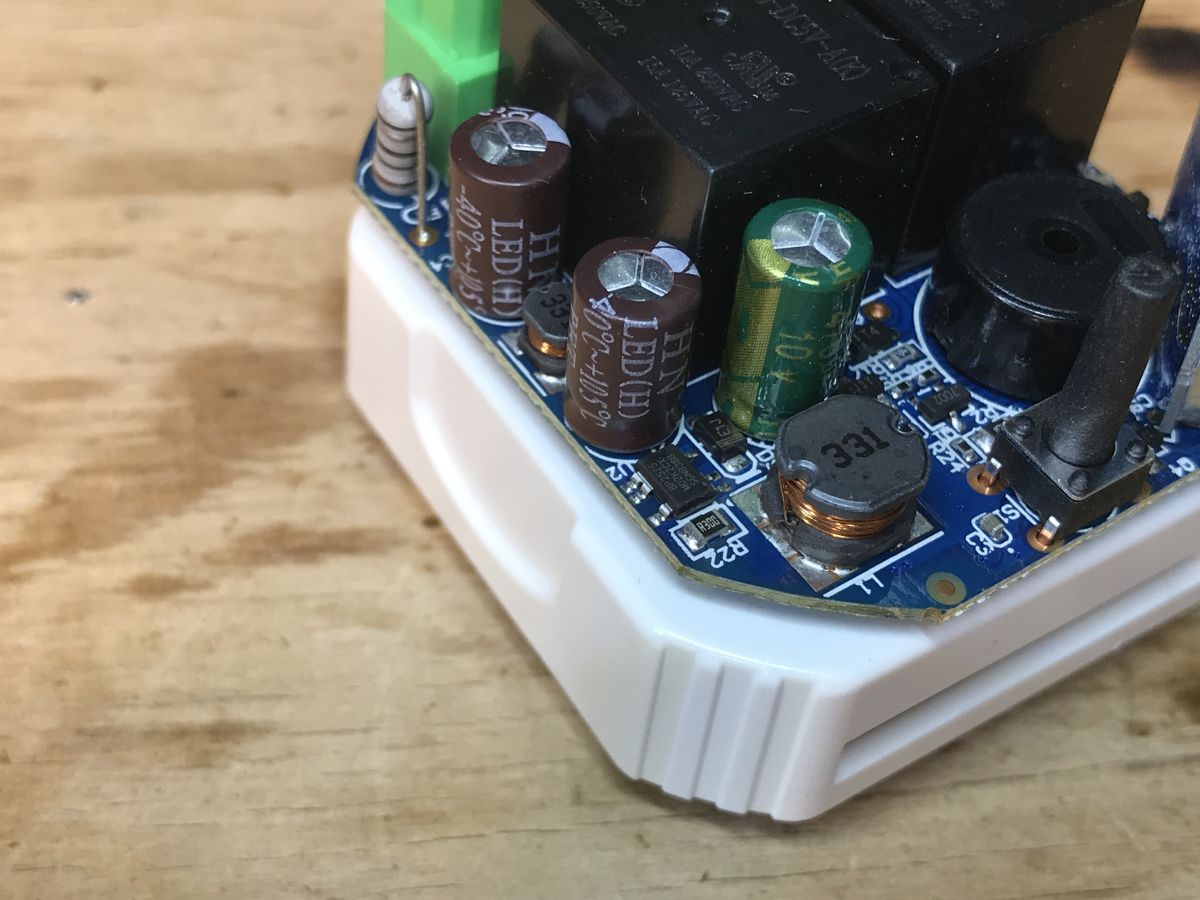

    The input has a fuse resistor and a filter with two electrolytic capacitors and a choke:
    Interior of the Woox R7279 relay module with a buzzer.
    The power supply is non-isolated and based on BP2525 as usual:
    Close-up of internal components of Woox R7279 relay module Section of the Woox R7279 relay module interior with visible electronic components.

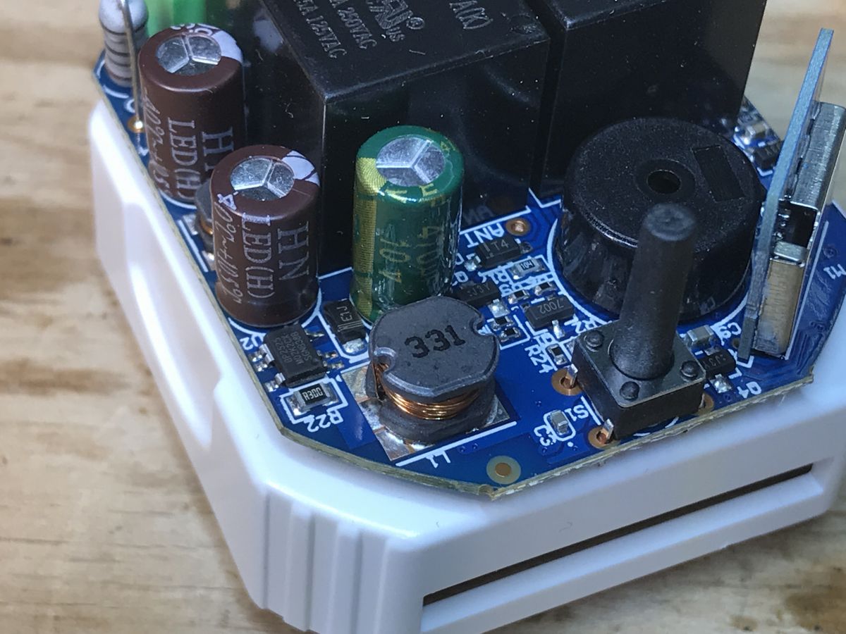

    But inside, apart from two relays and a WiFi module, there is also a buzzer:
    View of the interior of relay module R7279 with electronic components.

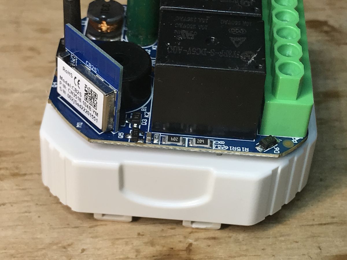

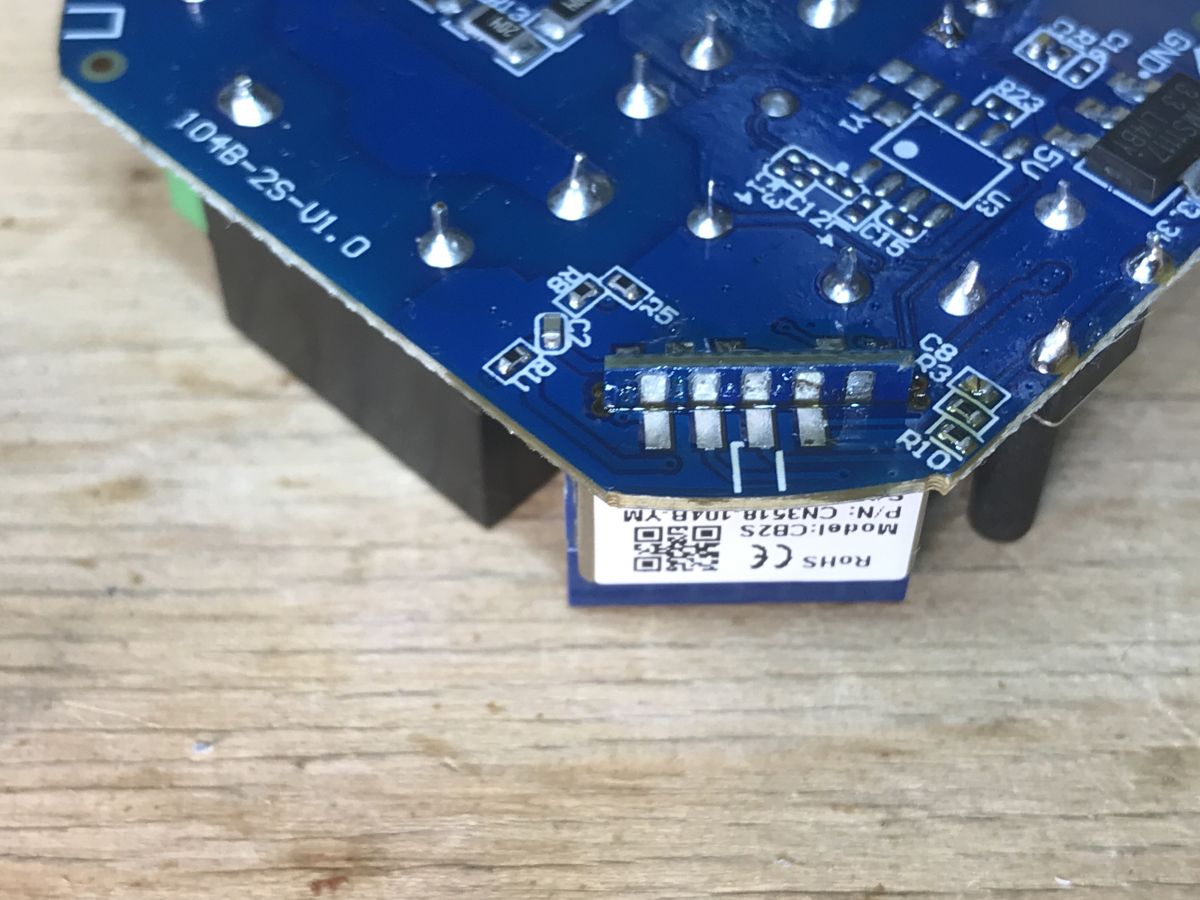

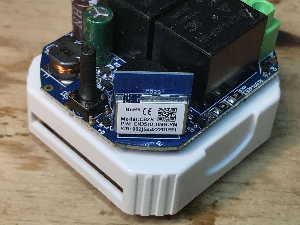

    The WiFi module itself is CB2S, i.e. BK7231N:
    Interior of Woox R7279 relay module with visible CB2S module. Interior of the Woox R7279 dual relay module with a buzzer.
    At the bottom of the PCB there is a 3.3V LDO and a place that I suspect is intended for an energy measurement system (BL0942, maybe?):
    Close-up view of the PCB board of the Woox R7279 relay module.

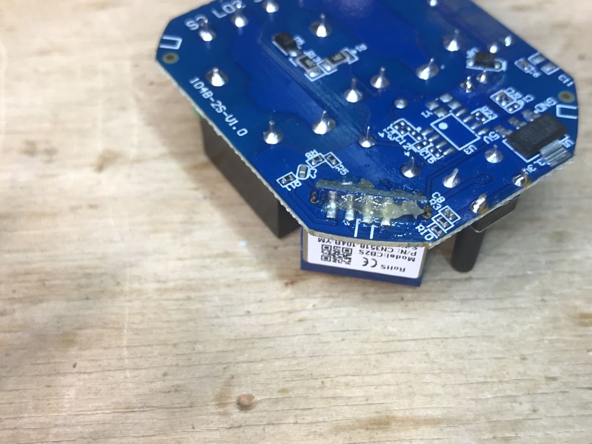

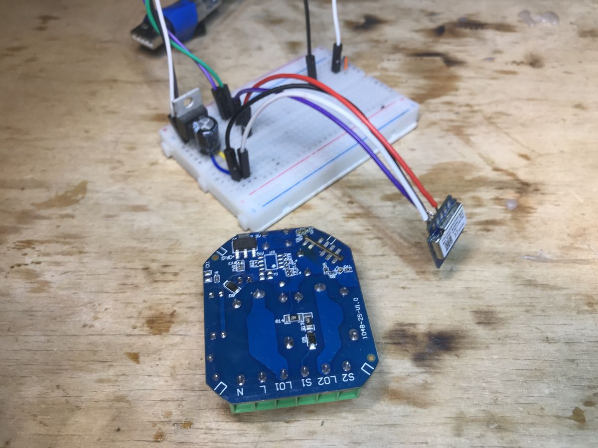

    I desoldered the entire CB2S:
    Close-up of the internal part of the Woox R7279 relay module on a blue PCB with visible soldered pins. PCB of the Woox R7279 relay module with a buzzer on a wooden table. Close-up of the bottom part of the Woox R7279 module PCB with visible tracks and electronic components.
    According to the flasher instructions, RX, TX and GND and 3.3V from a good 3.3V LDO were enough. I rebooted by cutting off the power.

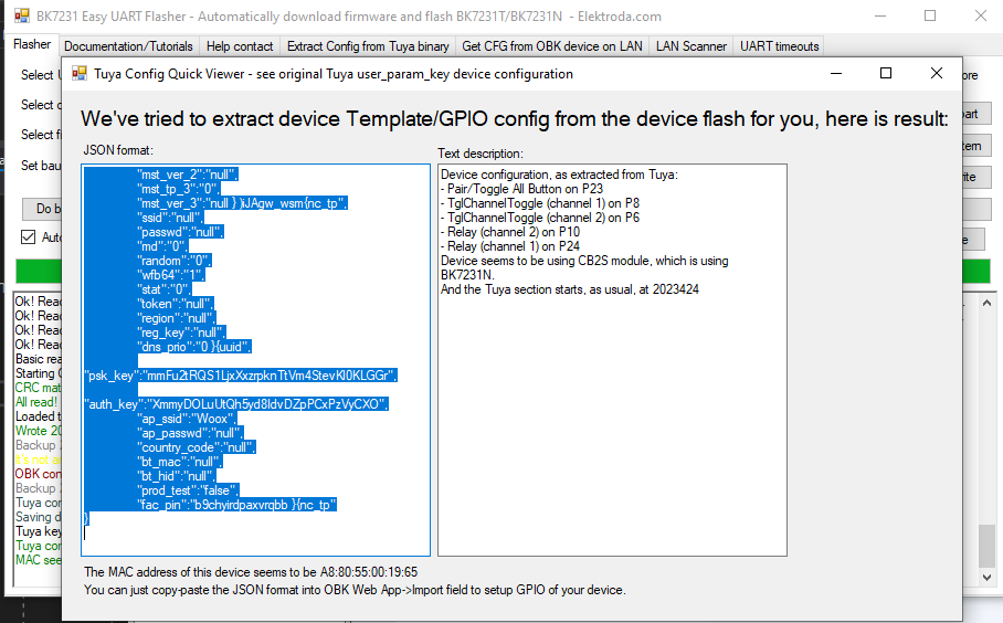

    Flasher imported the device configuration:
    Screenshot showing the configuration of the Woox R7279 device.
    Here is Tuya's JSON:
    You can see information about what is on which pin, e.g.:
    	"buzzer_io":"26",
    Verbal description:
    Device seems to be using CB2S module, which is BK7231N chip.
    - Relay (channel 1) on P24
    - Relay (channel 2) on P10
    - TglChannelToggle (channel 1) on P8
    - TglChannelToggle (channel 2) on P6
    - Pair/Toggle All Pin on P23
    Additionally, the buzzer is on P26.
