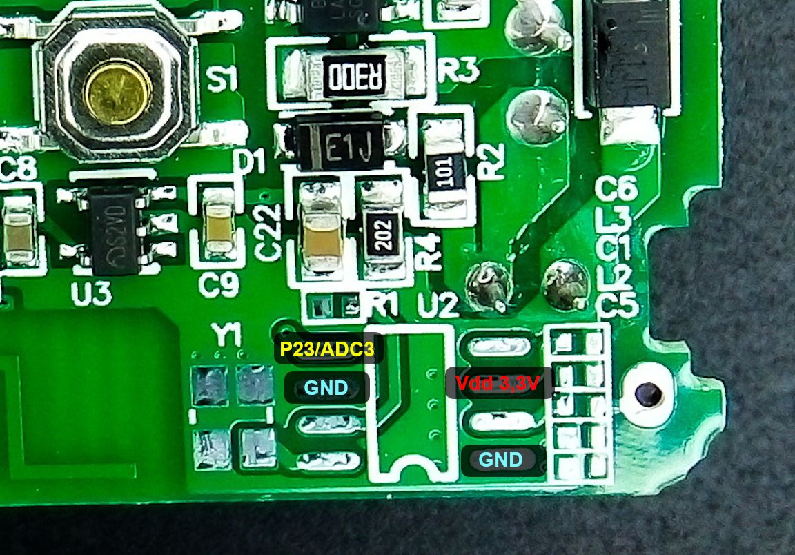

  • Need help locating 3.3 V connection on BK7231N board
    #31 20403068
    khafif
    Posts: 16
    -Apology, it is my typing error.

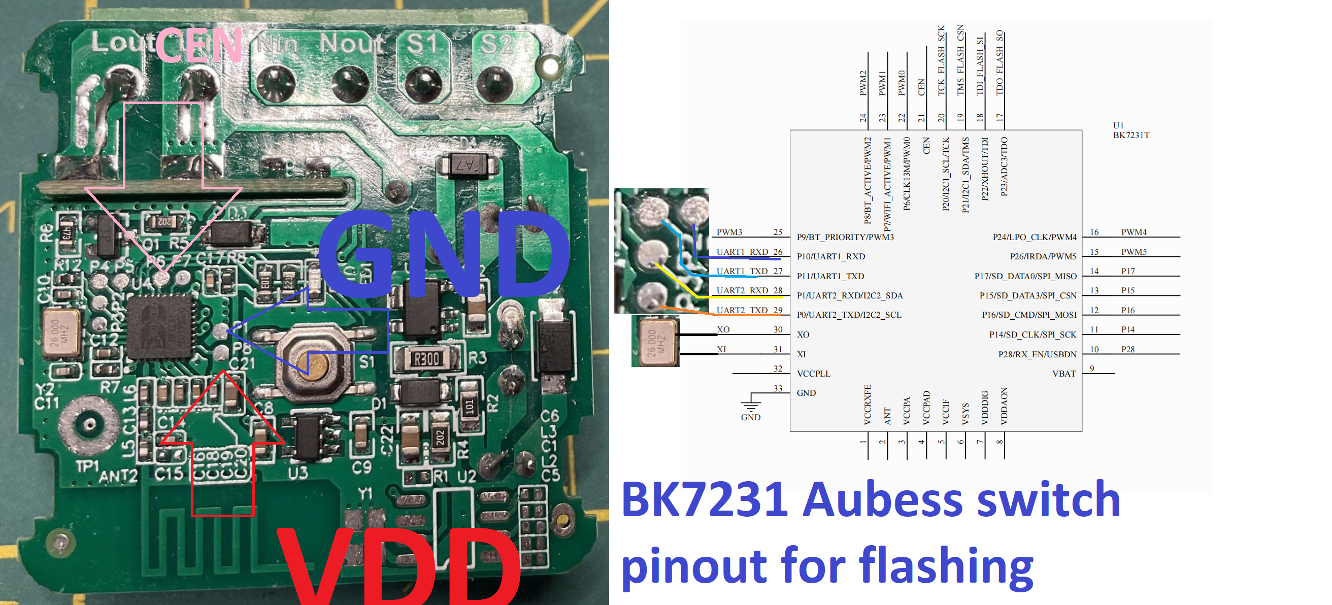

    khafif wrote:

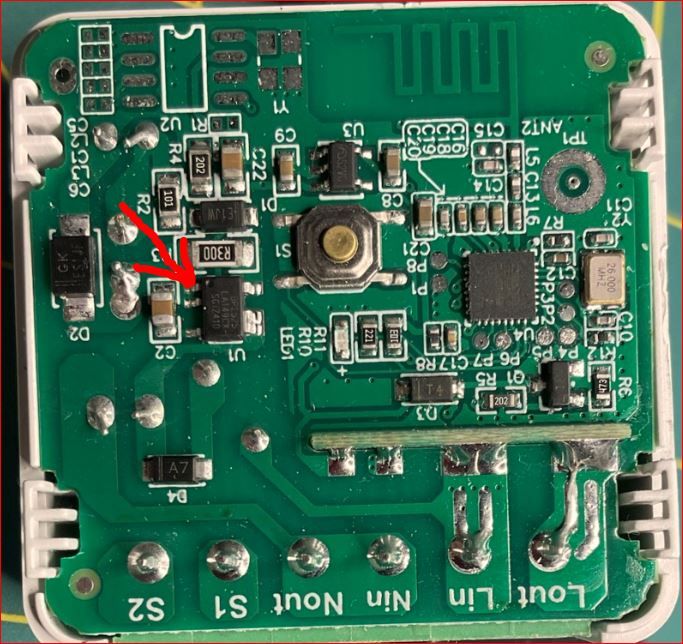

    Please can you mark on the above screenshots where do I have to connect the 3.3v on the WiFi board.
    I have the BK7231N on board wifi chip. I cannot locate the 5v or 3.3v LDO connection.
    [BK7231N] Aubess Mini Switch 16A
    I did see the video, it is another board, not the same.
  • #32 20404932
    Posts: 14768
    Rate: 12911
    Hello, please see modified image:
    I have added my markings and BK7231 pinout image.
    NOTE: marked VDD is 3.3V, not 5V!!!

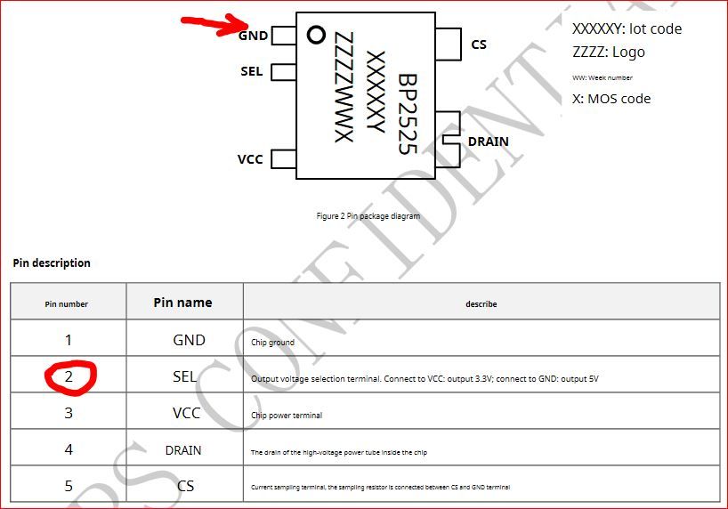

    Thank you for the detailed drawing.
    I found BP2525 diagram and I used my TTL/3.3V to BP2525 GND and pushed the board reset bottom for 7 seconds. Backup and flashing done in less than 30 seconds.
    [BK7231N] Aubess Mini Switch 16A [BK7231N] Aubess Mini Switch 16A

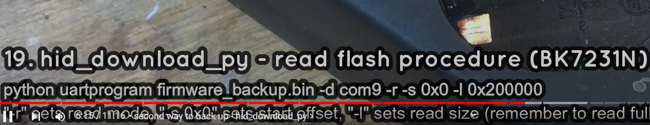

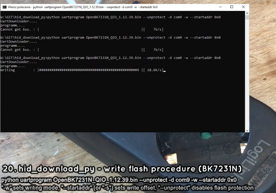

  • Full 2 MB backup required for BK7231N flashing
    #39 20455470
    Posts: 14768
    Rate: 12911
    @janek_wro the new flasher has some weird problem in exceptional situations, I'm not sure what it depends on, please provide information what you use for flashing. A few people have already reported this, but I can't determine what's breaking, because it works for me (Windows 10).
    The old flasher reads well, the CRC error is due to the unfinished software (Beken changed the CRC calculation algorithm), but if you want to make a backup, you have to load the whole 2MB, not only:
    Wrote 119000 bytes to firmware-read.bin
    Please backup the entire 2MB:
    Like here:
    https://www.youtube.com/watch?v=7MyfSgxLAOo&ab_channel=elektroda.pl
    Put a backup here, maybe it will be useful to someone, and upload OpenBeken:

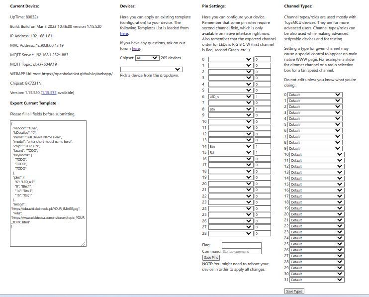

    OK, I added it to startup.
    I don't think anyone here has given the distribution of ports from this version of the board yet.
    It looks like:
    P6 LED_n
    P8 Button (internal in housing)
    P14 Button (output on terminals S1/S2)
    P15 Relay
    PCB version as from the first post of this thread, (user Pretoriano) having IC BK7231N on the main board, and the relay soldered on the additional board.

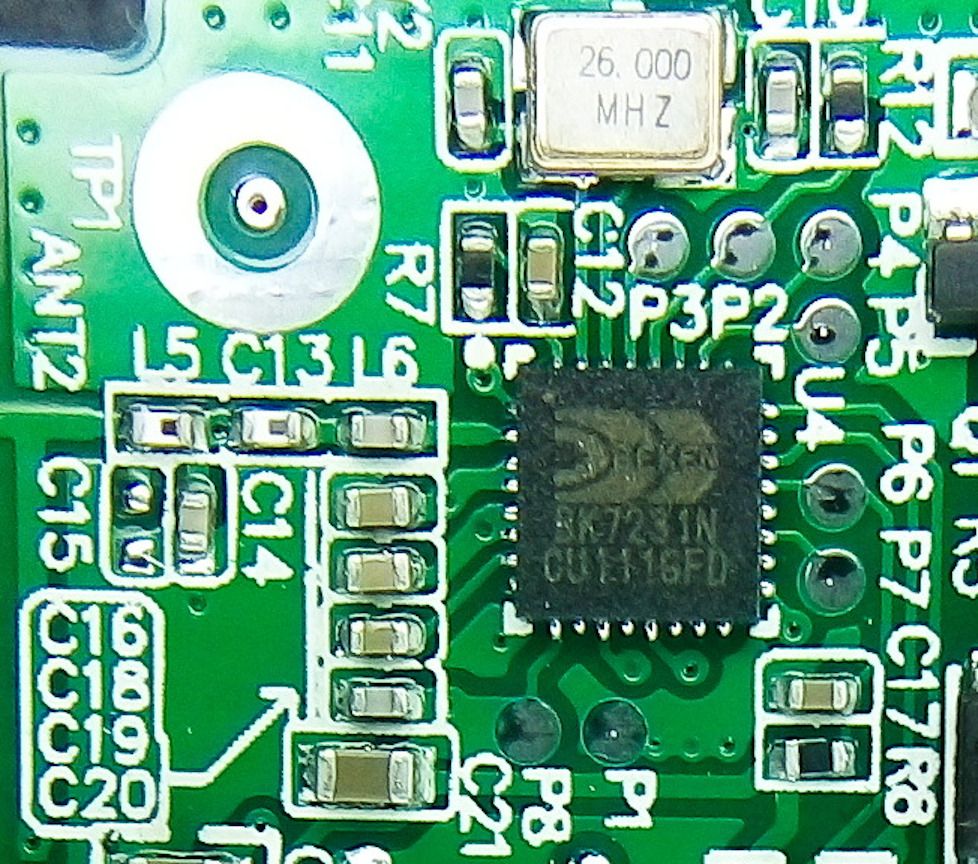

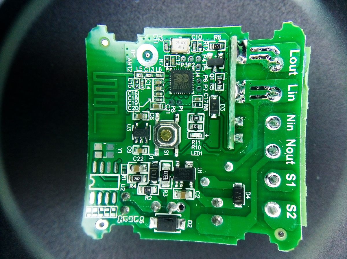

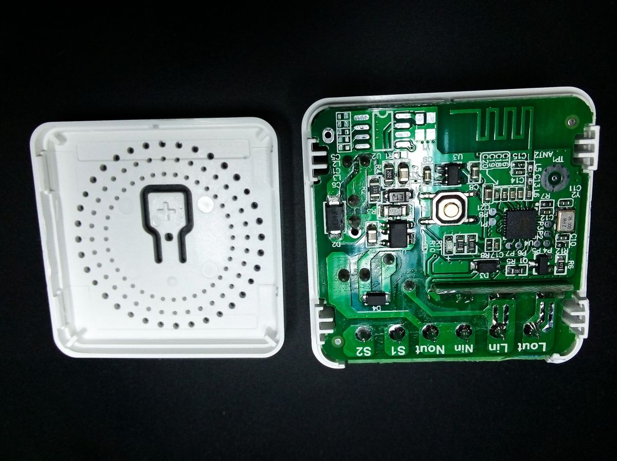

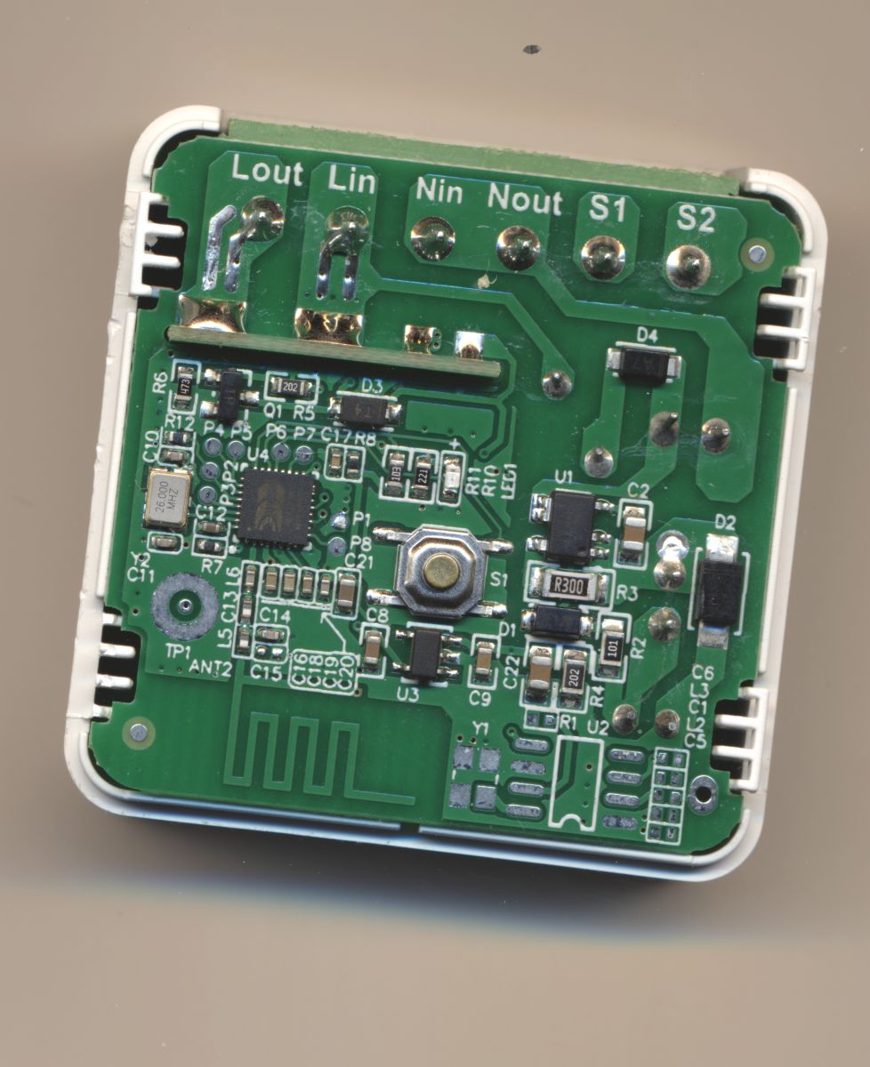

  • Board photos and test-pad pinout for BK7231N switch
    #43 20458111
    janek_wro
    Posts: 1281
    Help: 123
    Rate: 291

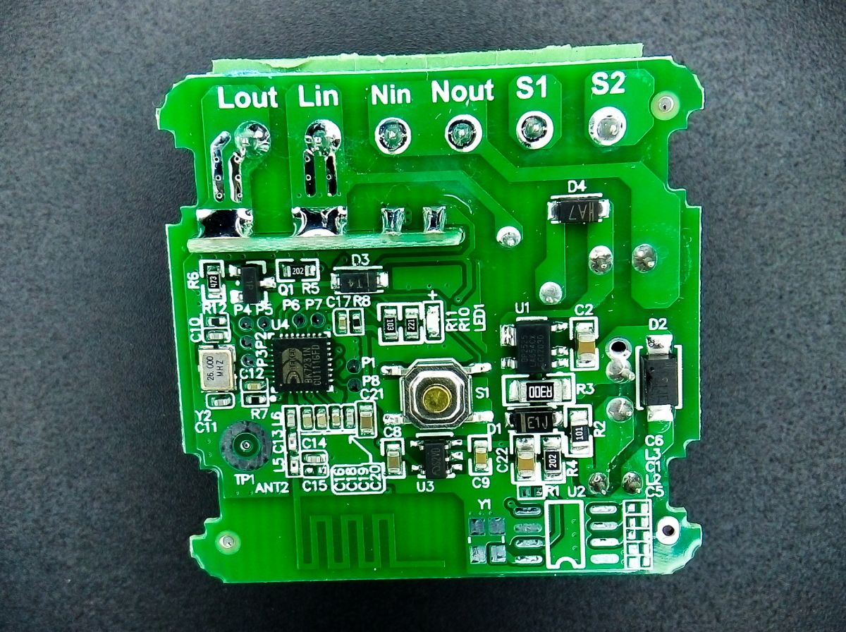

    I will add photos taken while opening the case.
    Two copies already flashed on openbeken.
    In the lower corner of the board you can see an unoccupied place for IC U2. Probably in the "richer" versions there was supposed to be a 433MHz remote control receiver, I believe. On the other side of the PCB is the ANT1 pad
    You can take advantage of the "benefit of this lack", because on pin 5 of this system U2 is connected to U4 (BK7231N) and its P23/ADC3 port is available. I guess you can use it if someone wants to stick with something extra. on pin3 U2 is "on hand" Vdd (3v3), pin1 and pin6 = GND
    Maybe a description of the test-pads from the board.
    P1 GND
    P2 UART2 RXD
    P3 UART2 TXD
    P4 UART1 TXD
    P5 UART1 RXD
    P6 PRICE
    P7 P21
    P8 VDD 3.3V

    Wauw what a blazing speed in answering! thanks.
    As stated i am a noob. I can see there are two btn adressed to a pin
    how could i change the chanel to ToggleChannelOnToggle?
    Is this done in the thanel type configuration? and if so wich btn should set to ToggleChannelOnToggle?
    If i change this setting is this a direct change or should i update over OTA?
  • #52 20479341
    Posts: 14768
    Rate: 12911
    This is a pin role. You should set it for a pin, and then this pin will toggle channel when it's toggled. No OTA needed.

    #60 20524353
    Posts: 14768
    Rate: 12911
    I have split the topic. The no-neutral modification (very cool idea, btw, but I wouldn't recommend doing this mod for beginners and amateurs, because it relates to mains voltage) is now in separate topic:
    Make any smart relay no-neutral? Simple modification help
    In general, please try to keep discussion on the topic, and this topic is about flashing OpenBeken to Aubess Mini Switch 16A.
    If you want to see more detailed flashing guide, please visit:
