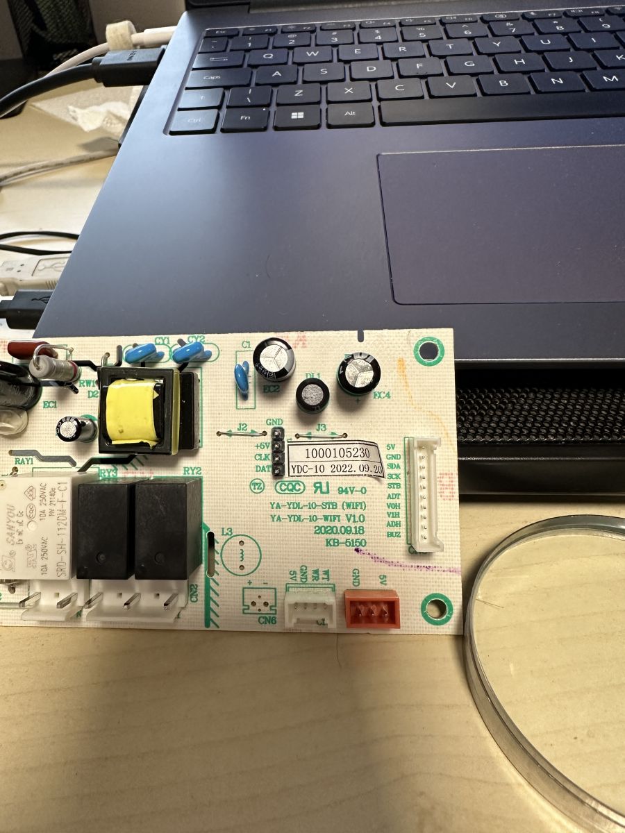

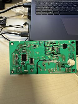

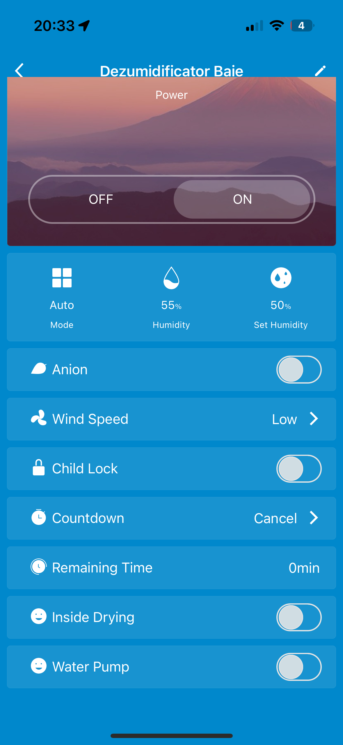

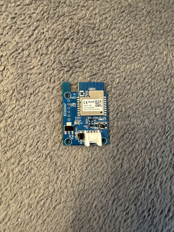

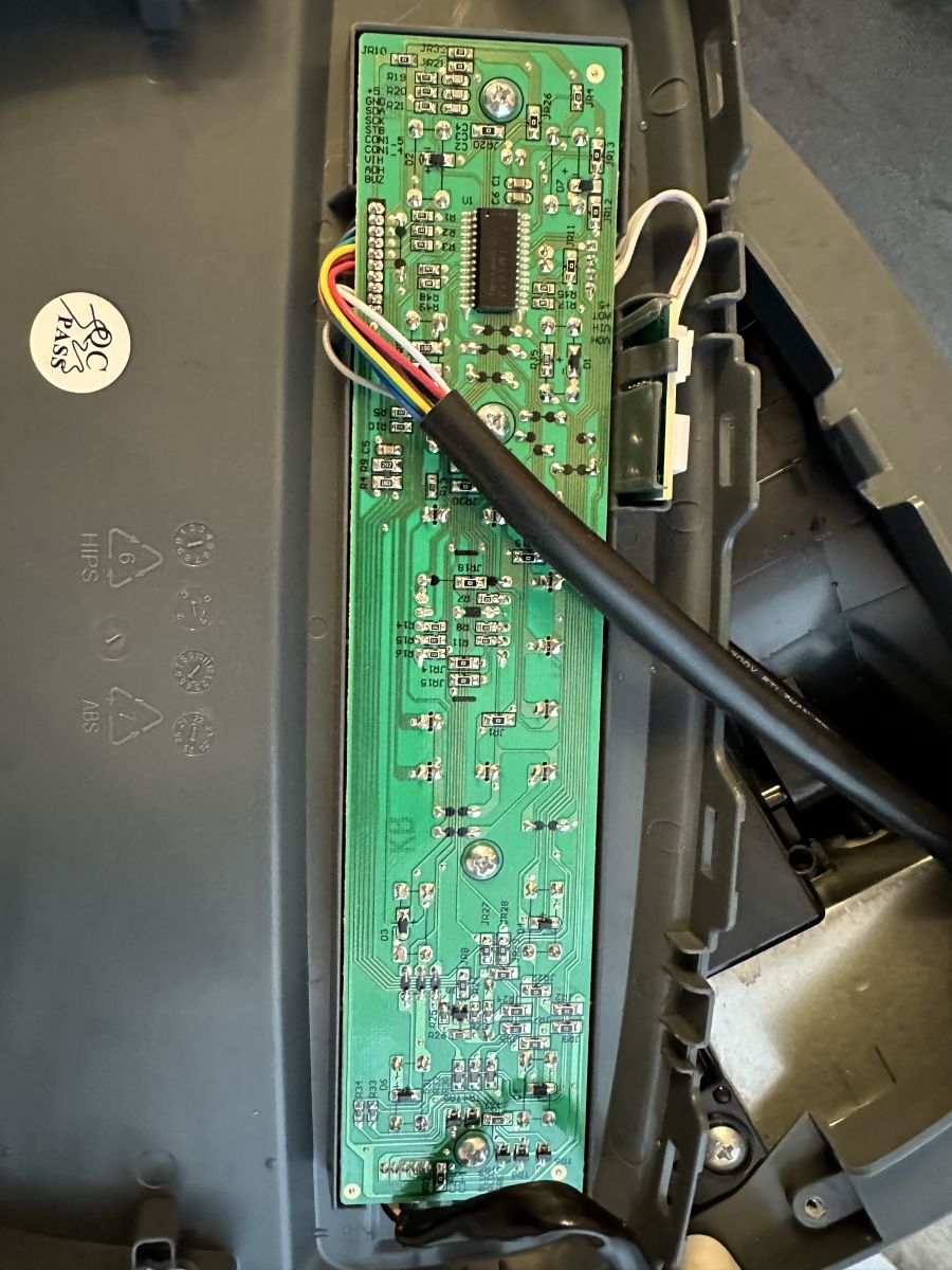

    Anyone figured out how to read this chip:
    https://developer.tuya.com/en/docs/iot/wbr1-module-datasheet?id=K9duisiao4qpa
    I tried connecting to RX, TX, GND, and 3V but nothing. I think this is an AmebaZ2.
    Moderated By p.kaczmarek2:
    2025.01 update - this chip is now supported. See step by step guide:
    WBR2, WBR3, WBRU, W701-VA2-CG pinout, datasheet, flashing for Home Assistant

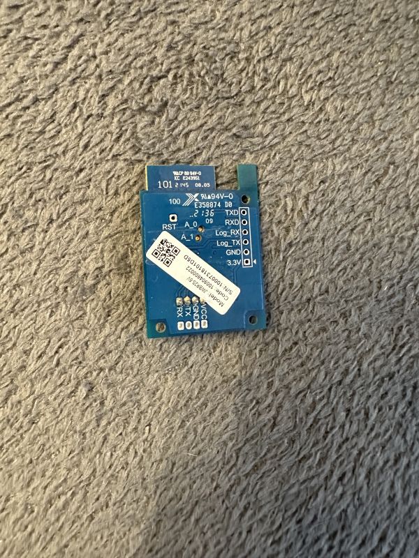

    Then I tried to connect to LOG_RX and LOG_TX but still nothing.

    I'm tinkering with a WBR3 module myself, trying to get ESPHome firmware onto it. Unlike your board, it wasn't on a nice breakout board and I had to desolder it to get to the A_0 pad on the back of the SoM.
    I believe the missing information you need is here: https://developer.tuya.com/en/docs/iot/burn-a...utions%20for%20flashing%20and%20authorization
    Namely, use the Log UART, make sure User RX is not low, and tie A_0 high

    I read chip but there is a problem, they communicate via TX and RX so no pins for configuring this dehumidifier, I will try much more maybe I will find something.
    This is a backup of flash read.
    Thanks
    • ltchiptool_ambz2_2023-12-20_15-58-39.bin (2 MB) You must be logged in to download this attachment.

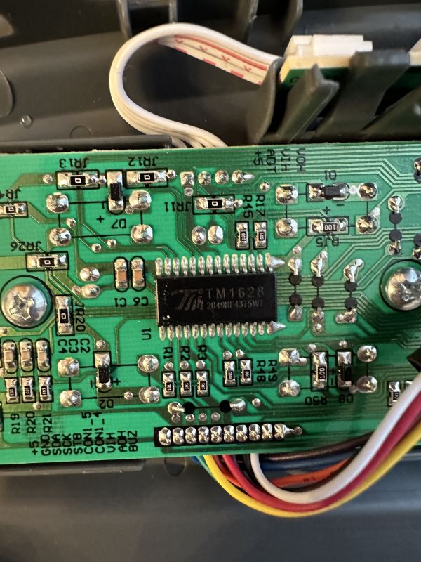

    I saw that there is a TM1628, so I think it is not supported now on OpenBeken.
  • JWBR2S-5V module likely bridges 5V serial to 3.3V TTL
    #5 20871609
    calvinium

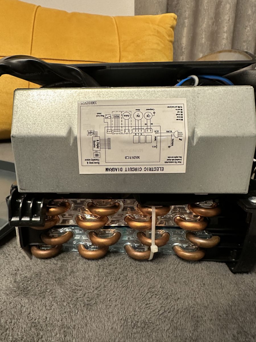

    That complete module, JWBR2S-5V, has its own page:
    https://developer.tuya.com/en/docs/iot/jwbr2s5v-datasheet?id=K9mxm59oqep1q
    Looks like it's for converting 5V serial to 3.3V TTL. From the way it looks like the module is oriented in the 3rd photo, it is connected to the main board via the 4 contact connector with the following arrangement:
    JWBR2S-5VMain Board
    RXVOH
    TXVIH
    GNDADT
    VCC+5V
    The tracks all head off down the other end of the board, away from the TM1628 chip you highlighted, which by the way appears to be an LED driver, the kind used for 7-segment displays. I don't think this is interfacing directly with the Wi-Fi module. I'd take a look at the other side of the board, to see if there's some other microprocessor the Wi-Fi module is communicating with over serial. It might even be not on the main board, as there are at least 2 other multi-connector cables connected to the main board. The one directly below the LED driver, for example, has "+5V" "VOH", "VIH" and "ADH" pins, similar to the 4 wire connector from the Wi-Fi module, as well as maybe an I2C bus (SCK, SDA)
    At the end of the day, it looks like your Wi-Fi module is interfacing with the rest of the device over serial and doesn't have any GPIO or analog signals going directly to it. As such, you'd need to know what it's talking to and to sniff the serial bus to figure out what it is saying if you're wanting to customize the firmware on the module.

    This is what he do:

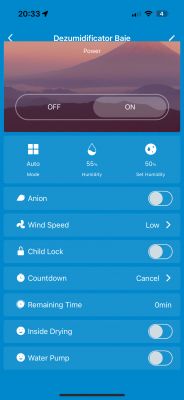

    Mobile app screen for controlling a dehumidifier
    And what i saw communication is via RX and TX that means is via uart like in this example:
    uart:
      tx_pin: 1
      rx_pin: 3
      baud_rate: 9600
    Added after 20 [minutes]:
    I opened now and i saw there are another board who communicate with this chip , i will try to open much more to see what is on the next side of board
    Added after 28 [minutes]:
    The chip from this board is this:
    F8216ADBN
    https://vi.aliexpress.com/i/1005004865957429.html?gatewayAdapt=glo2vnm
    In attach is PDF fro this F8216ADBN
    There are another one smaller then this:
    https://datasheet.lcsc.com/lcsc/1809191954_UTC-Unisonic-Tech-ULN2003G-P16-R_C91443.pdf
    ULN2003G is another one
    Electrical circuit diagram on the metal casing of a device. Electronic board with a laptop charger in the background. Circuit board with electronic components on a desk

    Another picture with schema:
    Printed circuit board with pin labels next to a laptop.

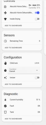

    And this is all what is now on HA with Tuya Local because Tuya not give what need on this device
    Control panel for AlecoAir D16 dehumidifier in the Tuya Local application.
