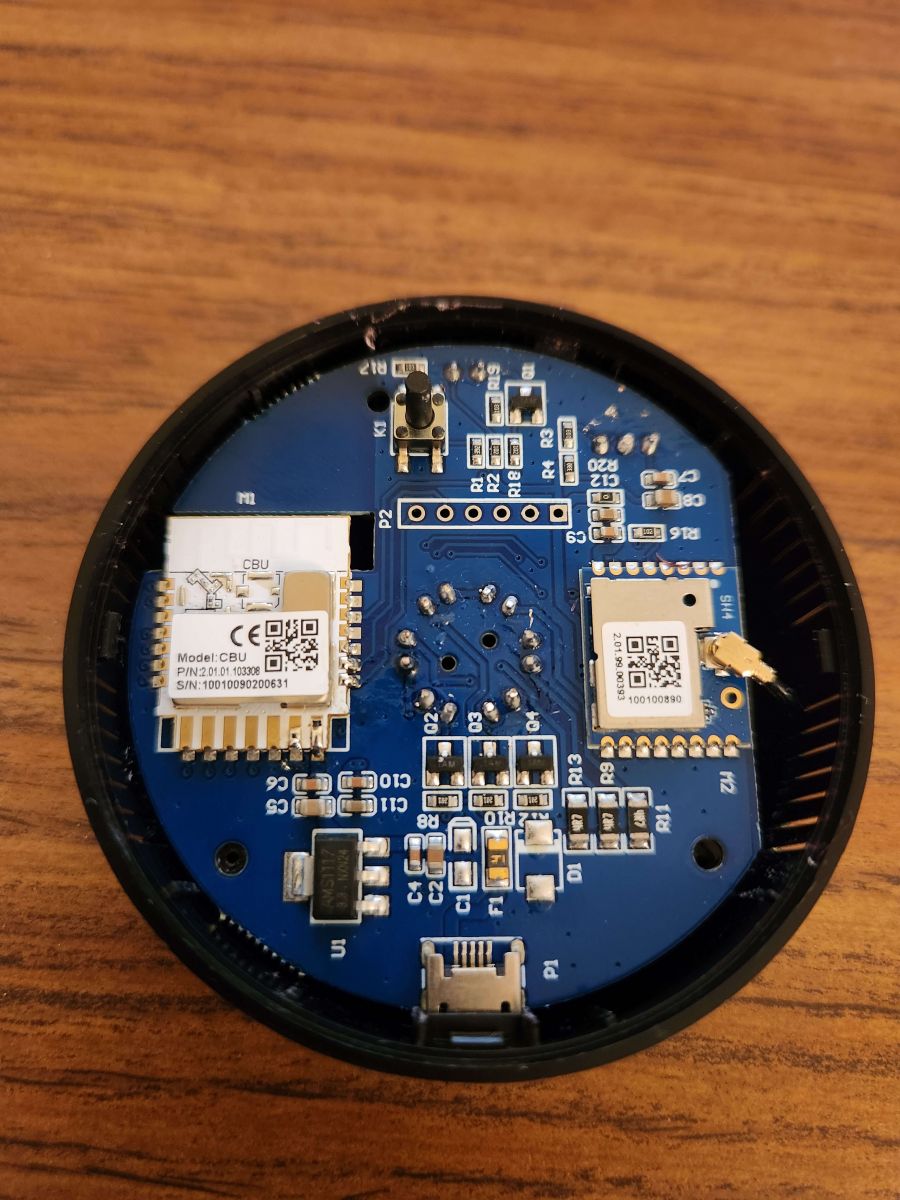

    Printed circuit board of a universal infrared remote with electronic components. Printed circuit board of a universal infrared remote with electronic components.

    Hello, have you tried to read 2MB backup of firmware and to determine the pinout? What is the role of second module? Is it RF?

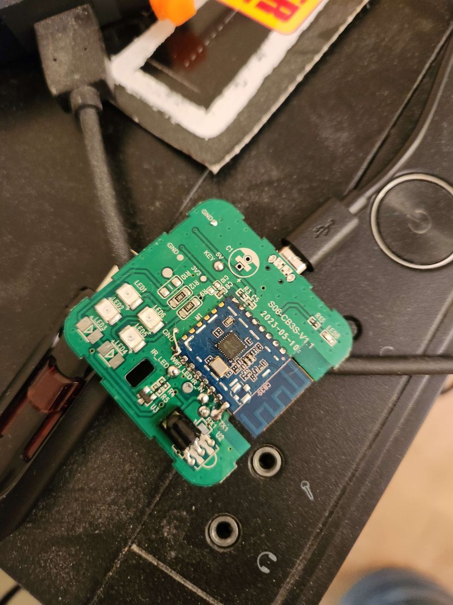

  • #5 20749955
    Zain00
    Posts: 61
    Rate: 20
    I have a few of these IR blasters but I was never able to make it work with my GREE AC.
    Has anyone been successful in making it work?
    I receive codes as IR_PulseDistance but I can't send these codes to my AC.
    A blue printed circuit board with electronic components mounted in a round casing. Close-up of an electronic circuit mounted on a printed circuit board, connected by a USB cable. Interior of an electronic device with visible components on a printed circuit board.
  • #6 20750029
    fazull0
    Posts: 7
    Uhmm.. but those are not the same devices I posted. They might do the same thing (RF transmitter/receiver) but the integrated microchips are different.

    This means that you have to check the GPIO roles manually. Inspect the traces on the PCB.
  • #10 20750613
    fazull0
    Posts: 7
    Is there a paper that explains how to do that? Or at least where should I write the mapping.

  • #16 21431190
    tarekamin
    I own the same device. After performing continuity tests, I identified the following connections:
    SH4 FCSB → WB3S P7
    SH4 CSB → WB3S P6
    SH4 SCLK → WB3S P20
    SH4 GPIO2 → WB3S P24
    SH4 GPIO1 → WB3S P14
    SH4 SDIO → R24 → WB3S P24
    IR RECEIVER → WB3S P8
    IR TRANS → R2 → Q1 → WB3S P26
    Next, I attempted to install ESPHome on the device using the tuya_rf library (https://github.com/olivluca/tuya_rf), which was originally configured for the CBU module. However, I encountered the error: "Pin number '16' is not usable for the WB3S board."
    To resolve this, I modified the pin configuration in the __init__.py file within the tuya_rf component directory (https://github.com/olivluca/tuya_rf/tree/master/components/tuya_rf). After reflashing, the device successfully connected to Wi-Fi but failed to communicate with the Home Assistant (HA) API or the local web server.
    Could anyone provide guidance on adapting tuya_rf to work with the WB3S module? Any insights into resolving the HA API/web server connectivity issue would be greatly appreciated.
