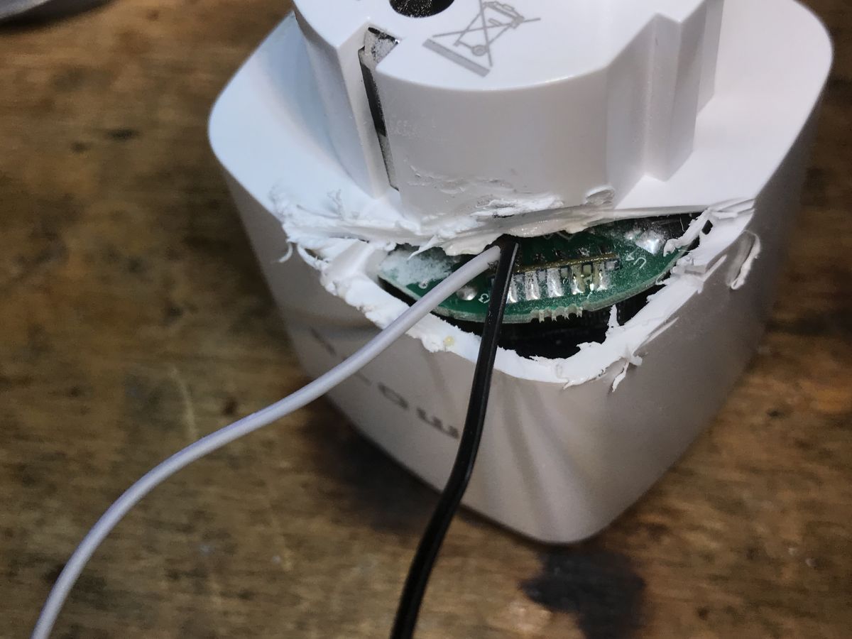

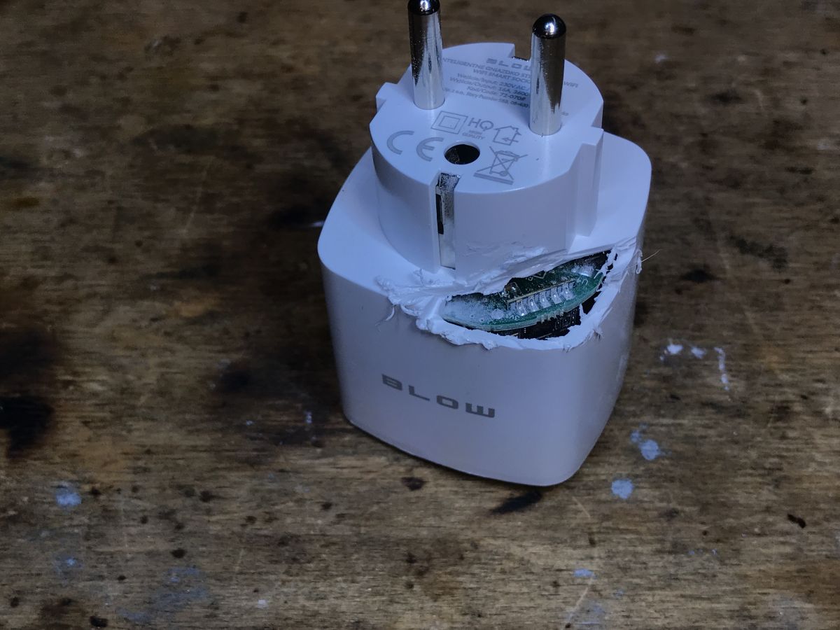

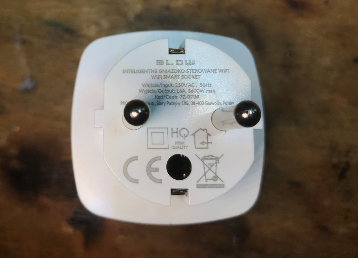

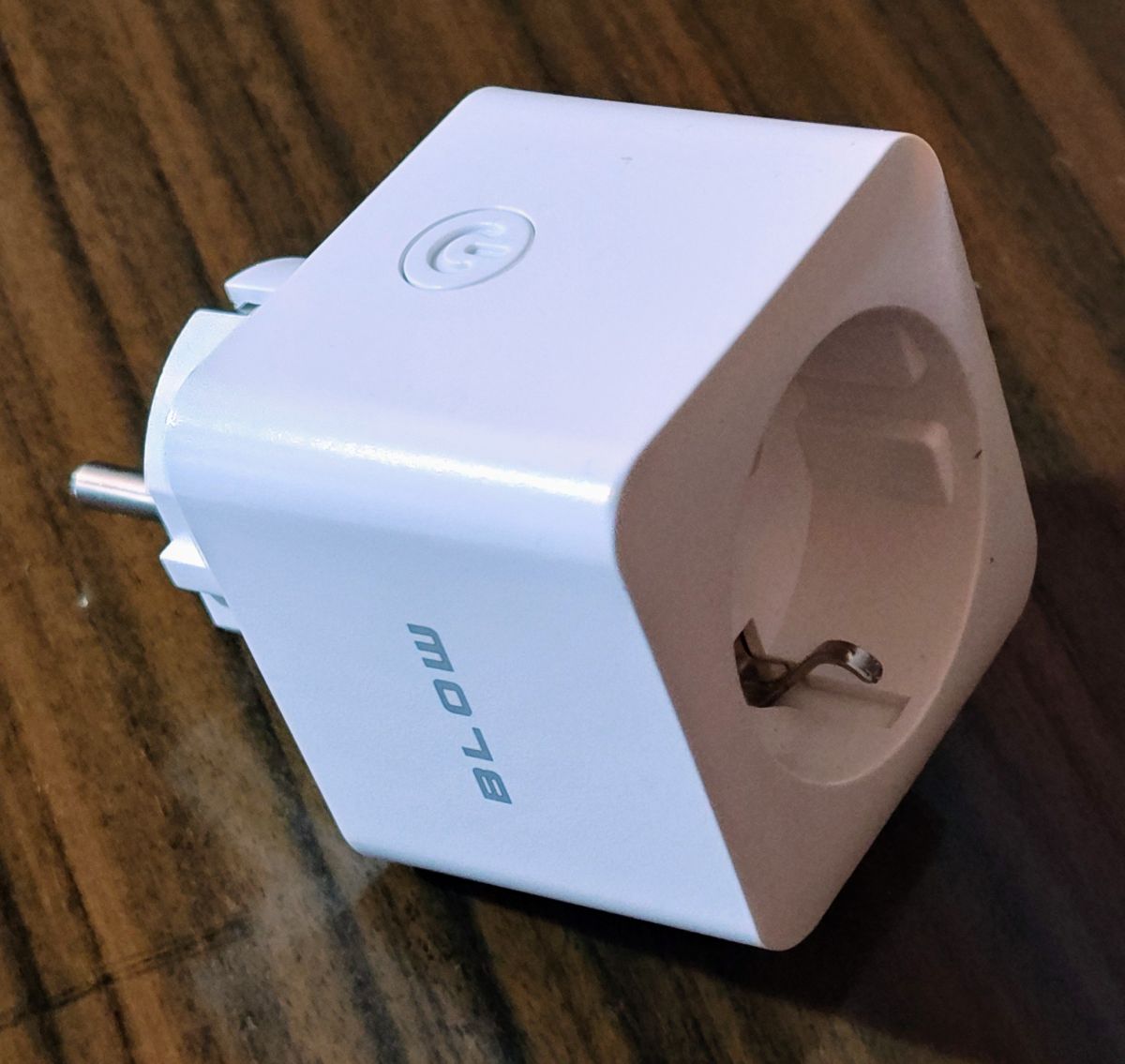

    I recently test-purchased a SMART socket of the Polish brand BLOW.
    This is a Smart Life/Tuya socket. Experimenting with it with Home Assistant - localtuya I came to the conclusion that it is a CB2S platform.
    I tried to take this socket apart without destroying it, but unfortunately I did not succeed.
    I would love to convert it to a completely local :-) .
    Back view of a BLOW smart socket showing visible scratches. White smart socket from the BLOW brand on a wooden surface, with visible minor damage on the casing.
    The damage seen in the left image is the result of my attempts to take the object apart. But I did not find any attachments/mounts in these areas near the edges. I was not able to bend the contact at the corners. The plastics are hard, and I don't want to (yet) break this case.
    Maybe someone has already done this, or met with a similar case?
    Greetings!

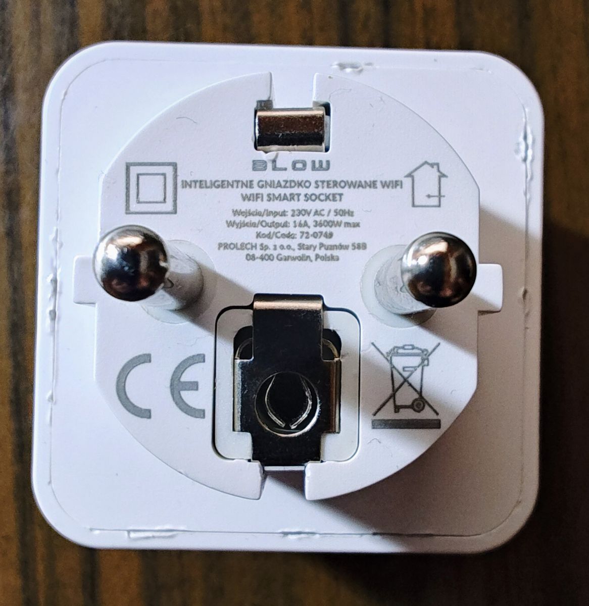

    Hello, unfortunately I don't recall this particular housing, although I've disassembled many such products....
    Even from Blow not long ago, at the request of someone, I uploaded an OBK to the sockets, but there were some:
    Damaged electrical socket with exposed PCB and wires. Back view of a Blow smart socket with visible technical markings. Dismantled Blow electric socket on a wooden surface. Disassembled electrical plug with visible interior and circuit board. Disassembled Blow brand socket with visible interior. I see, that you have a slightly different model, but in the case of my Blow it was not even possible to remove the PCB and I had to simply drill a hole at the bottom of the socket and solder the wires to the CB2S feet. Then I still had to secure it after flashing.

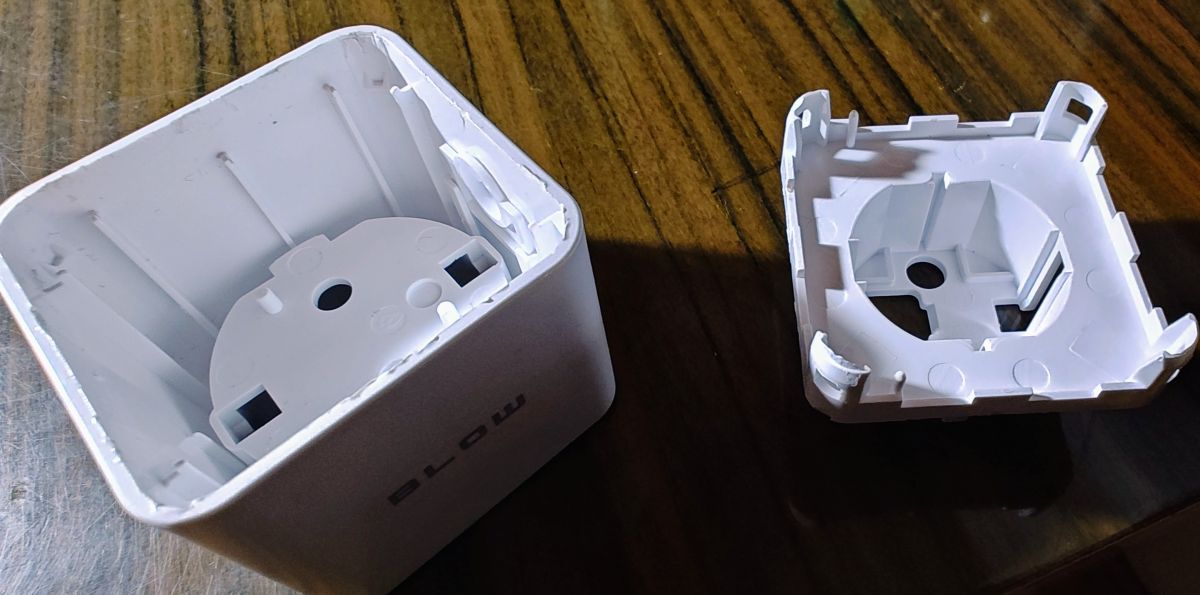

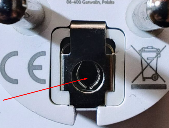

    Maybe there is a hidden screw like in Blitzwolf sockets? I'm just guessing, I could be wrong:
    Close-up of an electrical socket with a metal bracket and CE symbol. But Blow has rather not very detachable sockets
  • Corner fixings exposed for non-destructive opening

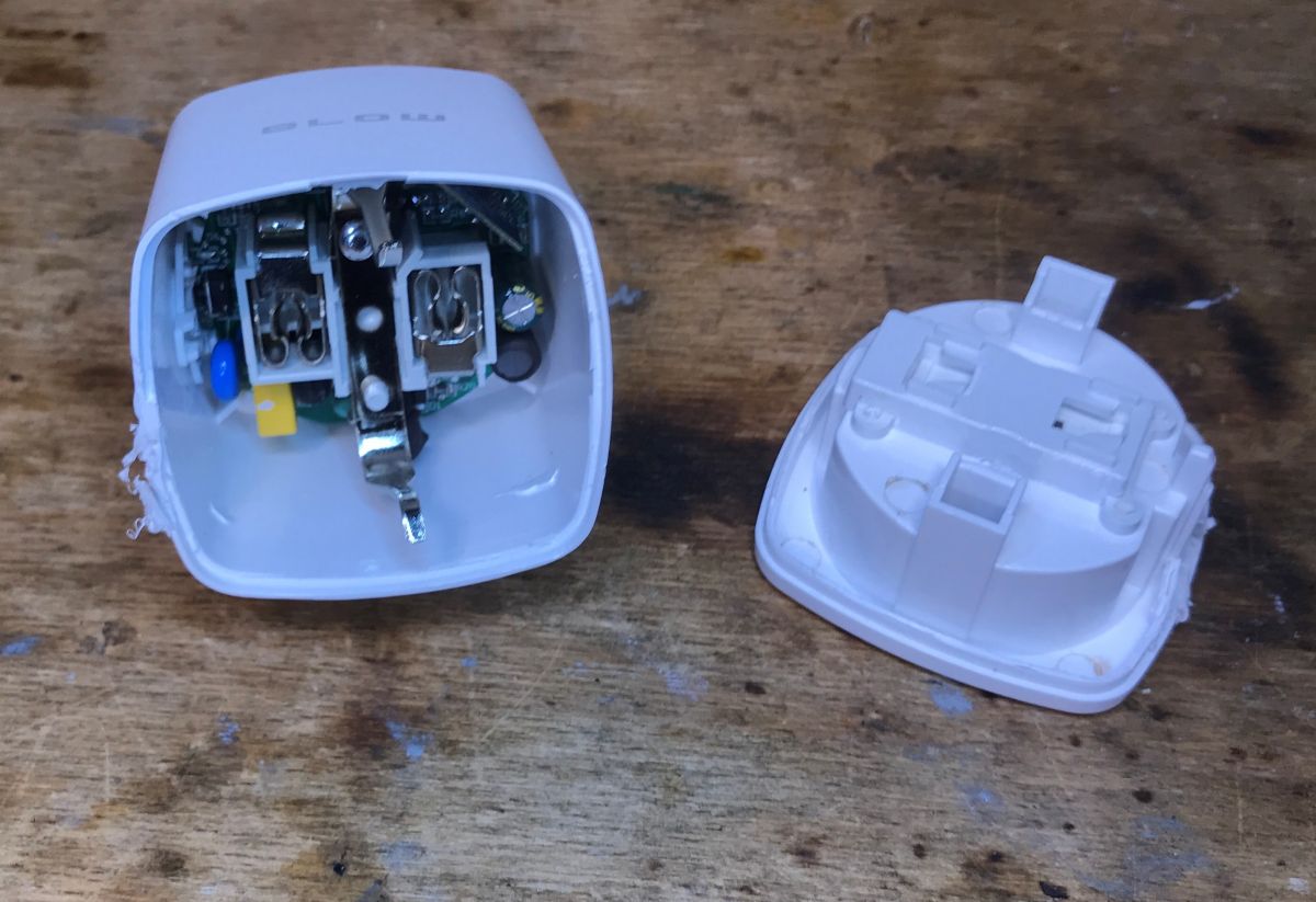

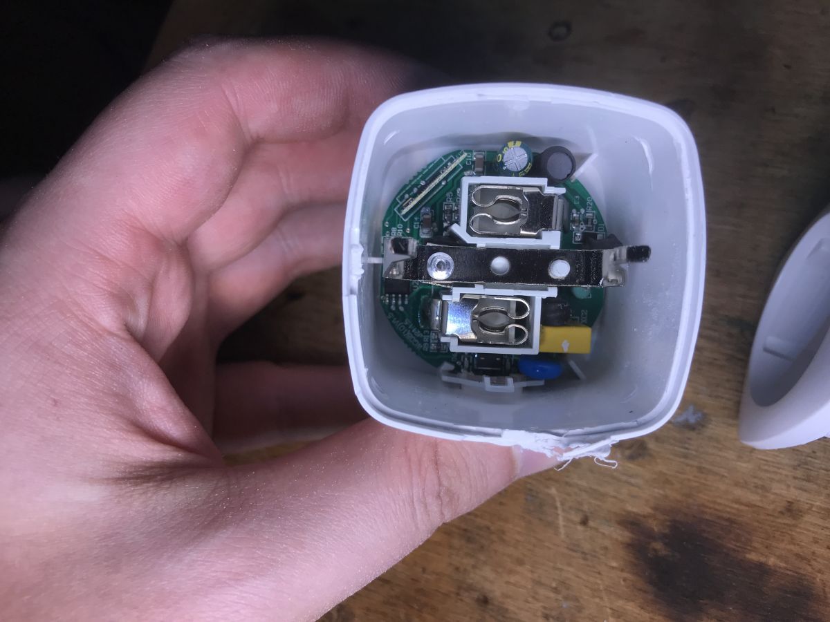

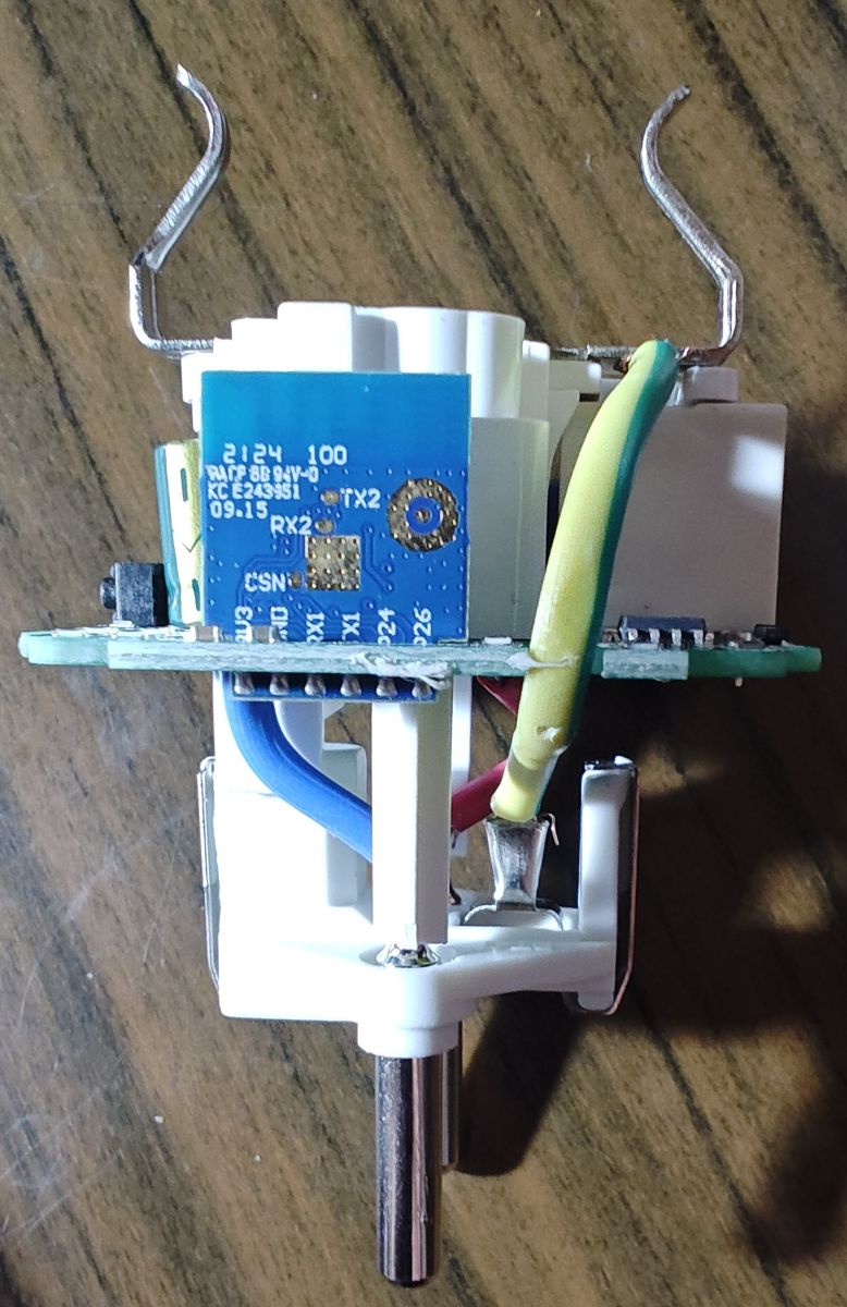

    It worked! Without destroying the case!
    Photo of a white plastic device casing disassembled into parts. Electronic circuit board with visible cables and RX, TX labels. As I thought, the fixings are in the corners. You can see them in the pictures. It wasn't easy.
    I soldered in RX, TX and GND and now have to read the backup and flashing procedure.
    I am 100% sitting under Linux. There are tools for Penguin
    In the pinhole the screw is not there. I have checked before :-) .

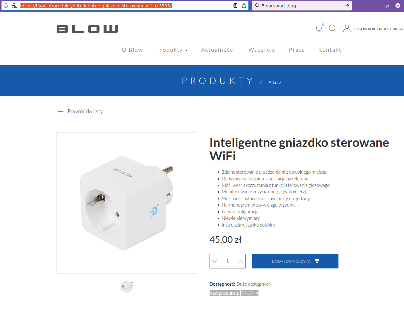

    What is the manufacturer's code for this device, can you post a screenshot of the listing where you bought?
  • Identifying the Blow smart socket model and links
    #5 20863053
    MK-dugi
    Posts: 12
    This is a BLOW socket Manufacturer code: 72-074#
    https://blow.pl/produkty/inteligentne-gniazdko-sterowane-wifi-d-3505/
    BLOW smart WiFi socket on the product page.
    I bought on Allegro a set of 2 pieces for 66PLN:
    https://allegro.pl/oferta/2x-programator-czas...-life-tuya-timer-watomierz-zestaw-12305980816
    Blow smart socket 2-pack with Tuya app on smartphone.
    I will try to draw.

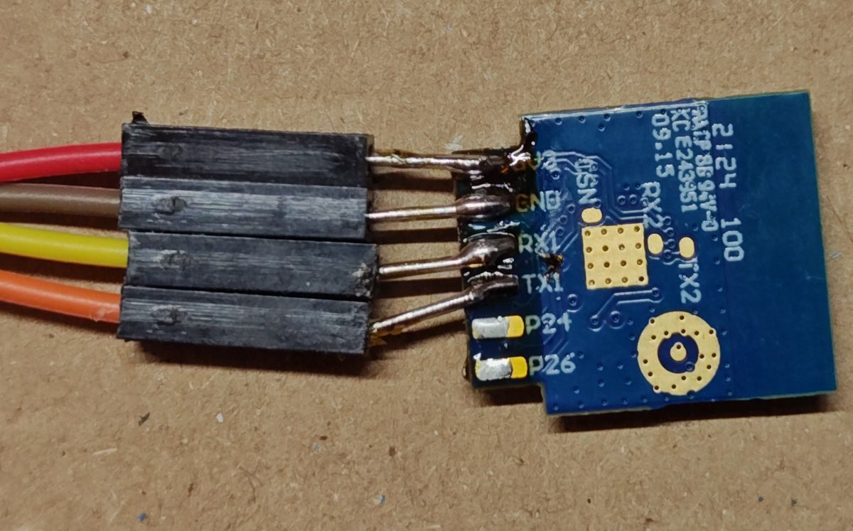

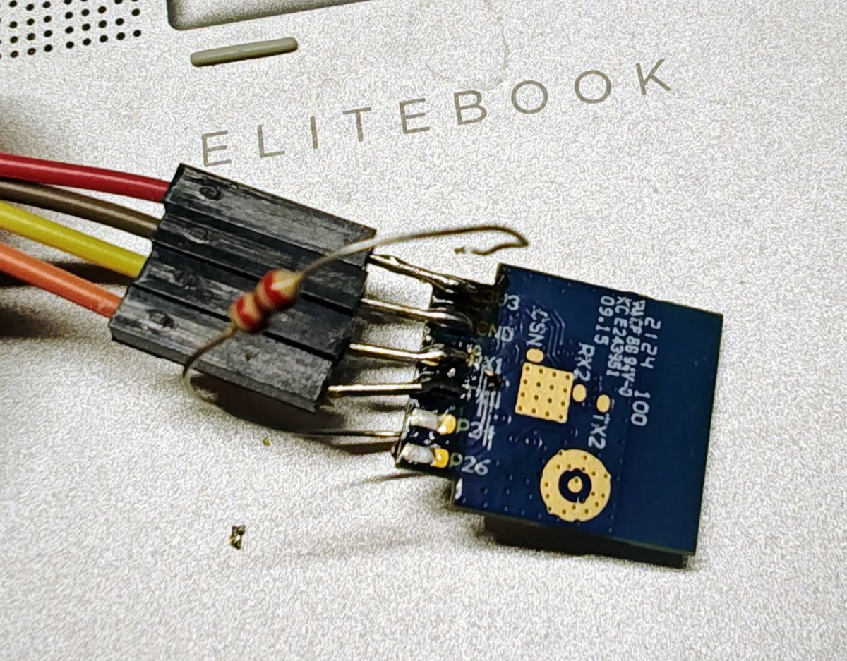

    I soldered the CB2S module from the "motherboard" and soldered the wires to it.
    I found it easier than knocking out capacitors, cutting paths, etc...
    I added a reset resistor to the CEN.

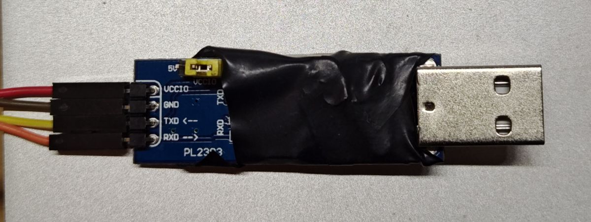

    I connected it to my USB-UART (PL2303). It came out neatly :-) .CB2S module with attached wires and a resistor on an EliteBook laptop. CB2S module with soldered wires connected to a terminal. Wires soldered to a USB-UART PL2303 module wrapped in electrical tape.
    To make it easier for myself I ran bk_writer1.6 under Win and fiddled with the flash reading.
    The file came out small - 1.1 MB.
    As I fiddled with the address ranges, it came out 2 MB, but each different.... (different checksum). When I fiddled even more with the addresses, I was able to download up to 3 MB. I did not try more.
    Another approach - hid_download_py.
    This program (already under Linux) downloaded me .... 1.1 MB and the checksum agrees with this small file downloaded by bk_writer1.6.
    I am posting the small file. Please let me know if such is enough to extract the GPIO configuration or maybe something more...
    Greetings! BLOW-plug_..074.bin (1.1 MB)You must be logged in to download this attachment.

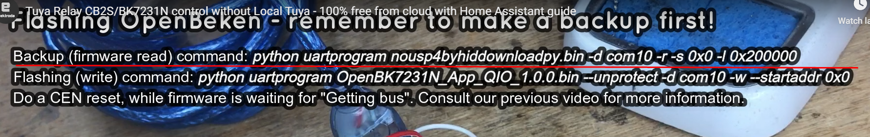

    Unfortunately you need a 2MB file, as written in the linked tutorial:
    Screenshot showing instructions for flashing OpenBeken on a Tuya Relay CB2S/BK7231N device with several console commands.
    In older tools you have to manually type in 2MB, regardless of the checksum.
    There is also a newer tool, but it officially only works on Windows, although people have reportedly run it with mono:

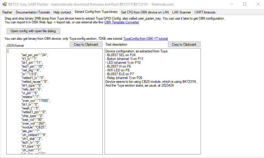

    This file looks correct:
    Interface of BK7231 Easy UART Flasher with Tuya JSON configuration
    Tuya JSON:
    Word description:
    - BL0937 SEL on P24
    - Button (channel 1) on P11
    - LED (channel 1) on P10
    - BL0937 VI on P6
    - WiFi LED on P8
    - BL0937 ELE on P7
    - Relay (channel 1) on P26
    Device seems to be using CB2S module, which is using BK7231N.
    Tuya JSON can be imported after flashing like this:
    Tuya JSON.
