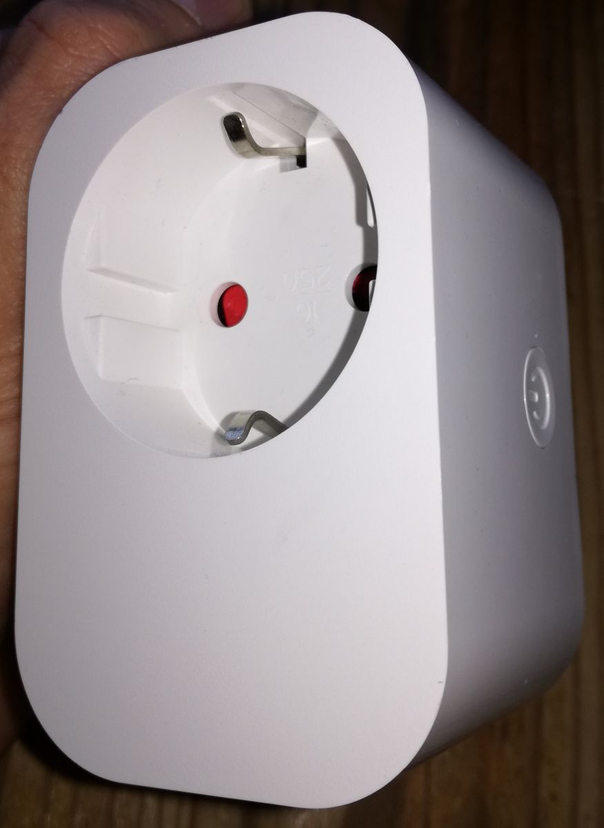

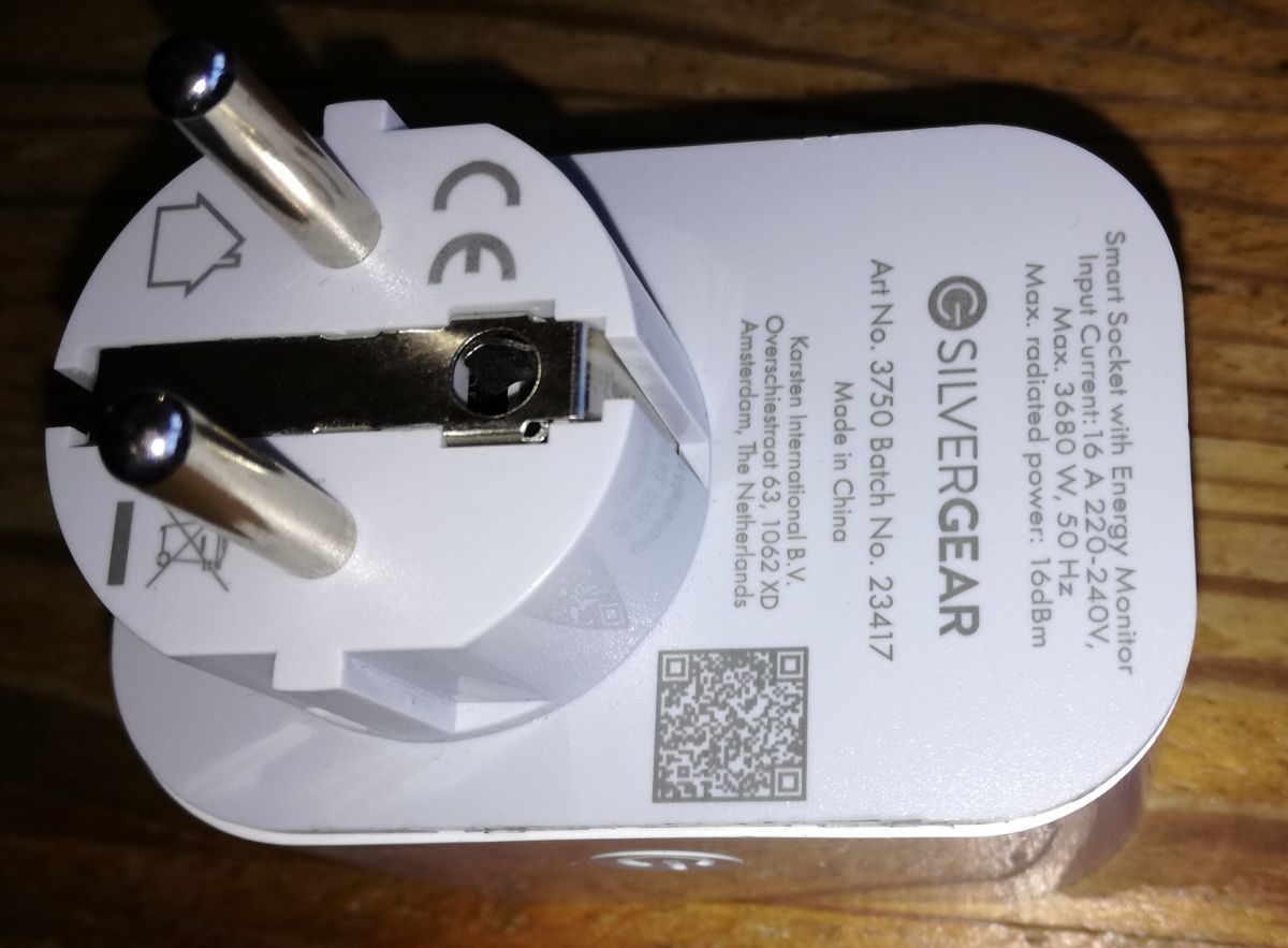

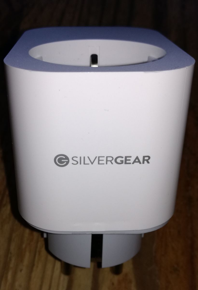

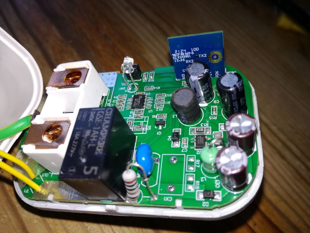

    A friend gave me this Tuya Smart Socket
    SILVERGEAR Smart Socket ArtNo. 3750 with CB2S
    I could not find it on your list.

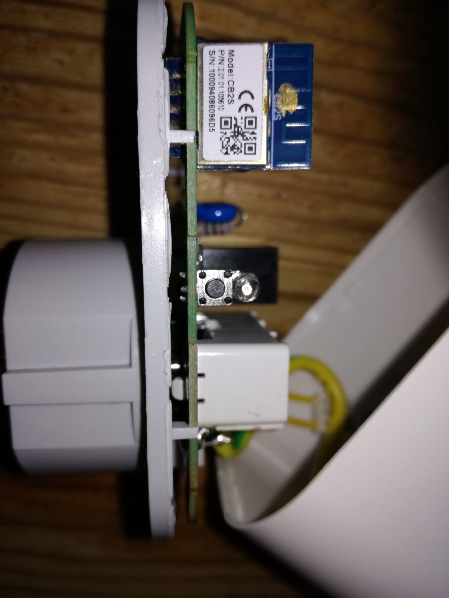

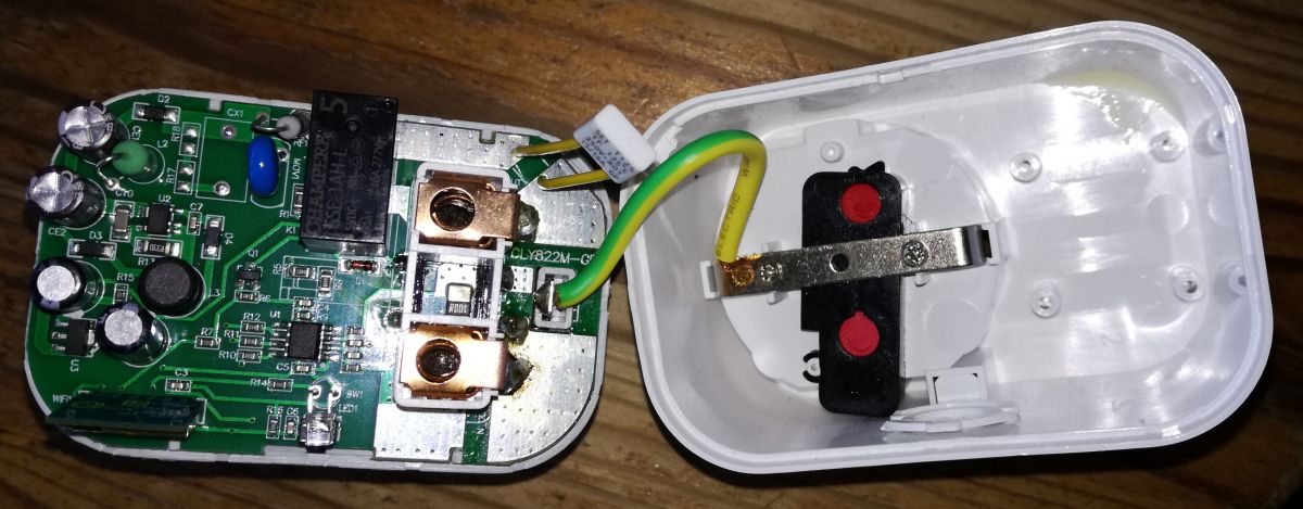

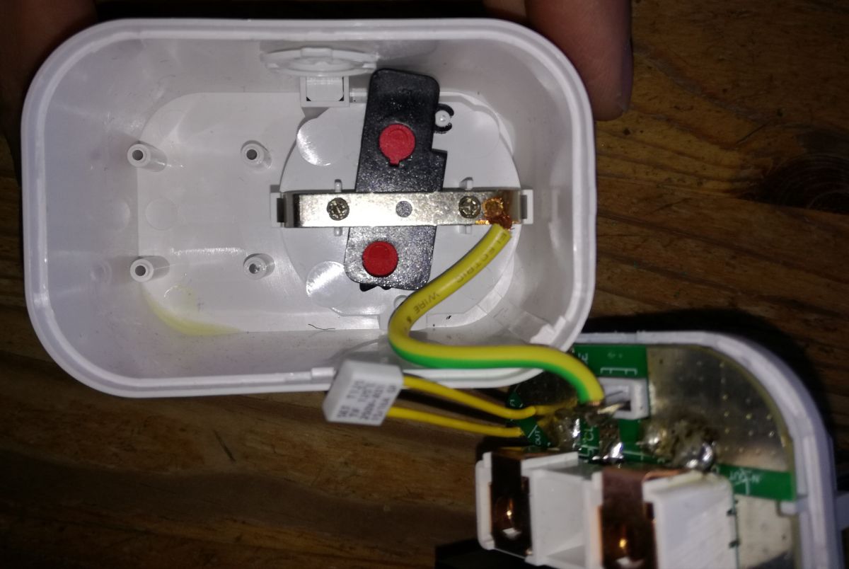

    I popped it open but I was not able to separate the PCB from the socket base to unsolder the CB2S and flash it.
    So I was thinking about using the Cloudcutter tool to flash this device. But as of now, I am only having a Win10 laptop and never used a Linux system before.
    Do you have any advice on how to separate the PCB from the base? Or is it less complicated to use the Cloudcutter tool on a Linux Live distribution?

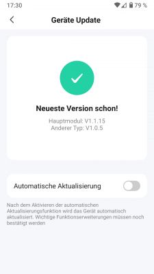

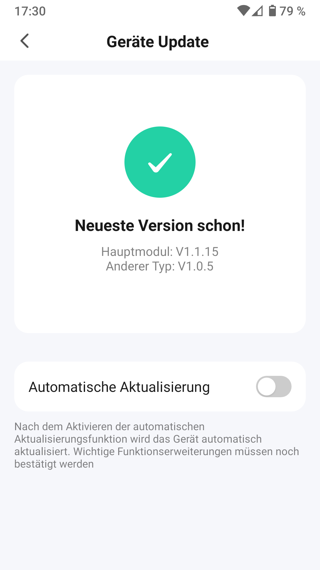

    And somehow his SmartLife screenshot seems to be helpful for you/new devices:
    Device update screen confirming the latest version is installed.

    AI: Can you describe any specific steps you've already tried to separate the PCB from the socket base?
    I tried to use some force to push the 2 big pins through the socket base

    Desolder mains contacts to access module pads
    Sadly firmware v1.1.15 is on the known patched list so Cloudcutter won't be an option anyway.
    https://github.com/tuya-cloudcutter/tuya-cloudcutter/wiki/Known-Patched-Firmware
    As with many plugs I've done, the main contacts with the PCB will need de-soldering in order to access all contacts on the module. It helps greatly to mix the existing solder with additional 63/37 lead to reduce the melting point. Otherwise you run the risk of warping/melting the plastic surrounding the prongs. eg https://www.elektroda.com/rtvforum/topic4103427.html

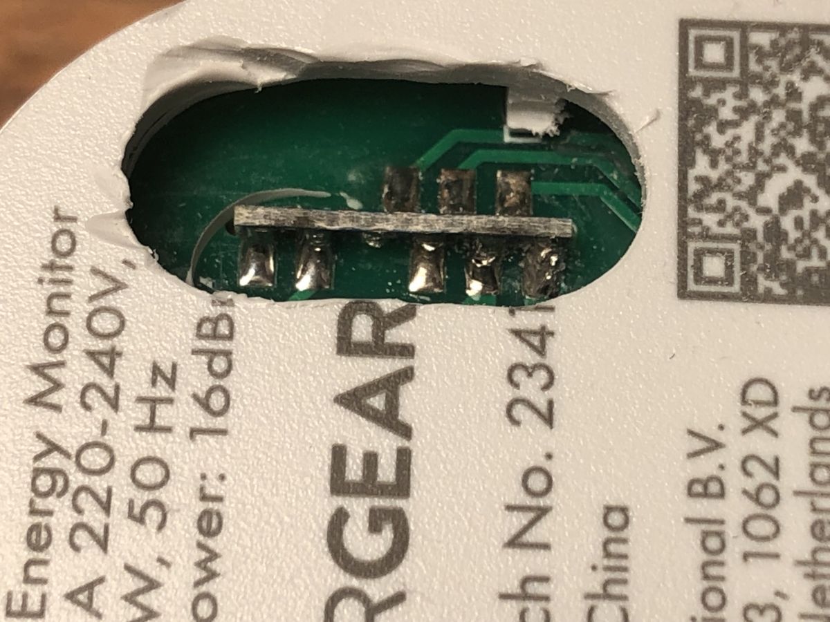

    Unfortunately I wasn't able to get the 63/37 lead.

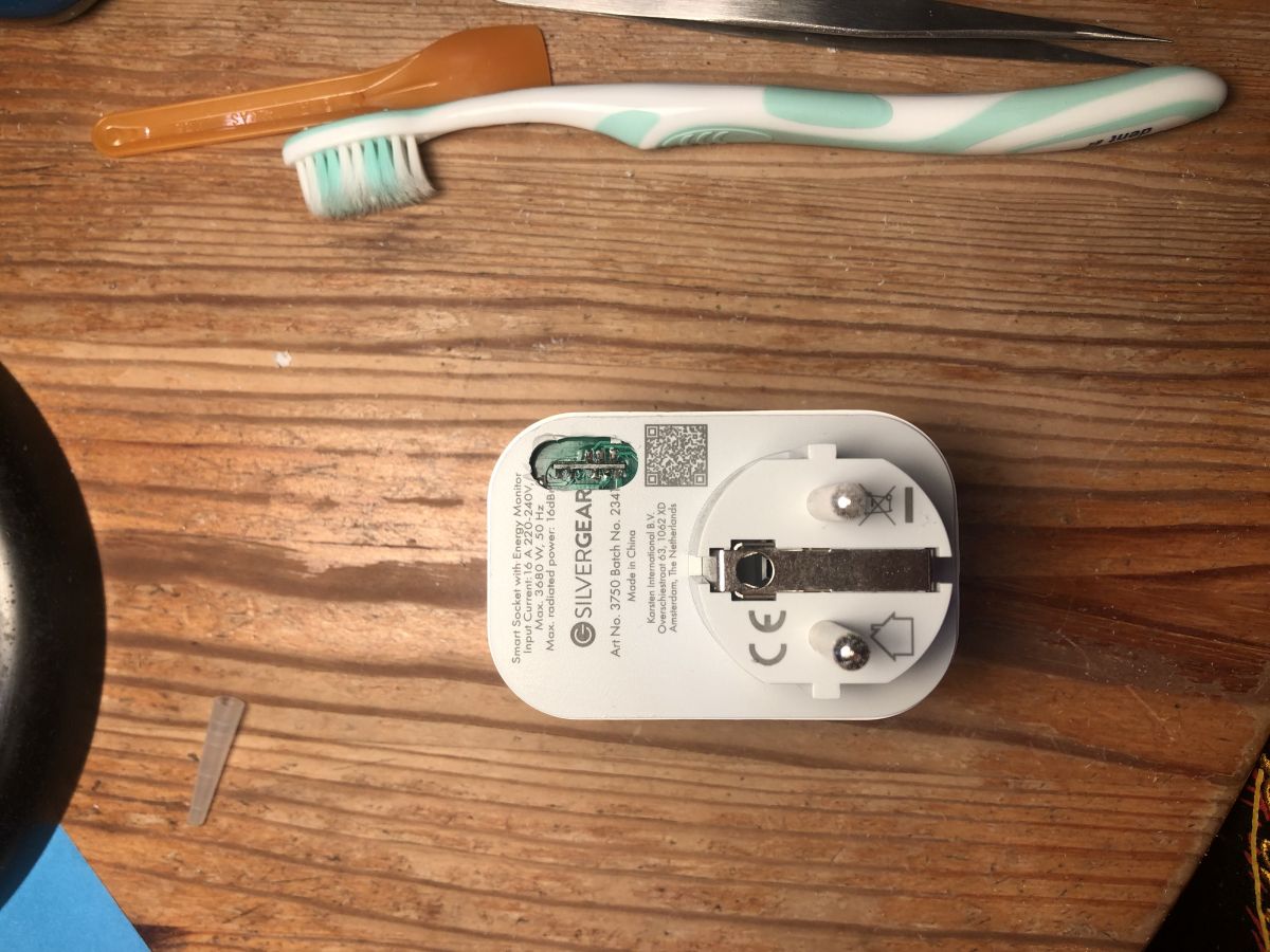

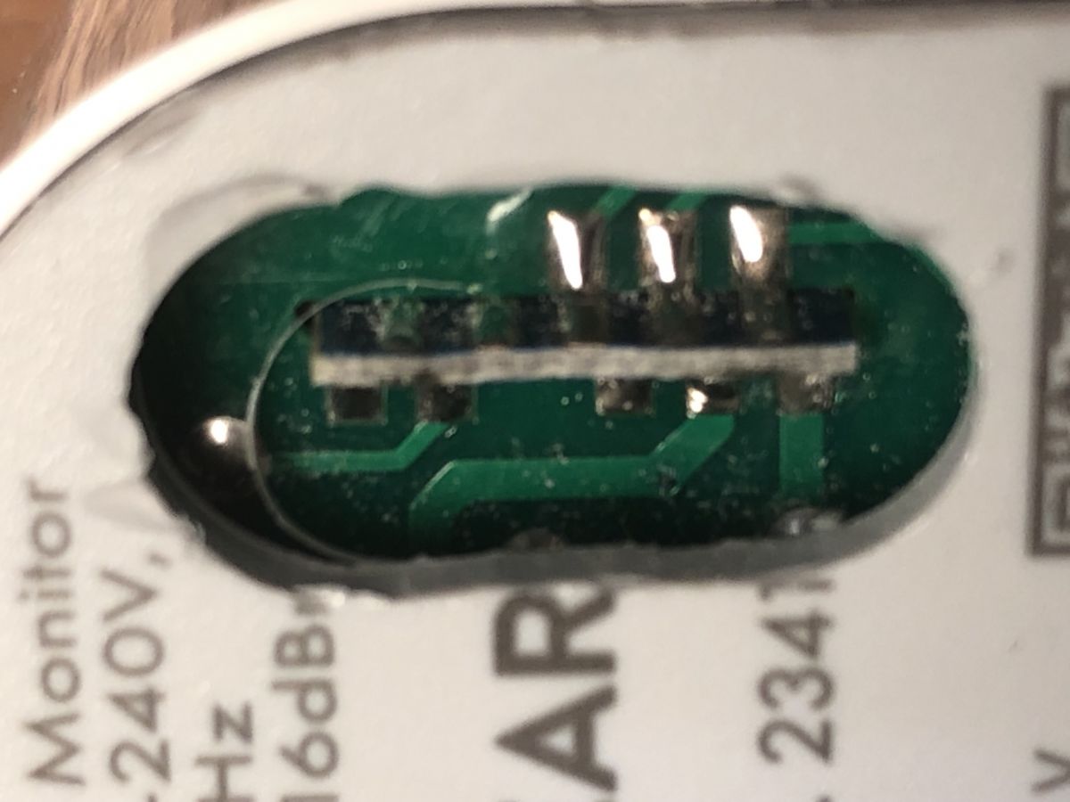

    So I used a DREMEL to grind a gap into the case just above the CB2S Module.
    Toothbrush and adapter with Silvergear logo on a wooden table.
    Close-up of a green circuit board visible through an opening in the metal casing of a device with partial technical specifications text.
    A part of an electronic device with a visible circuit board through a cutout in the casing.

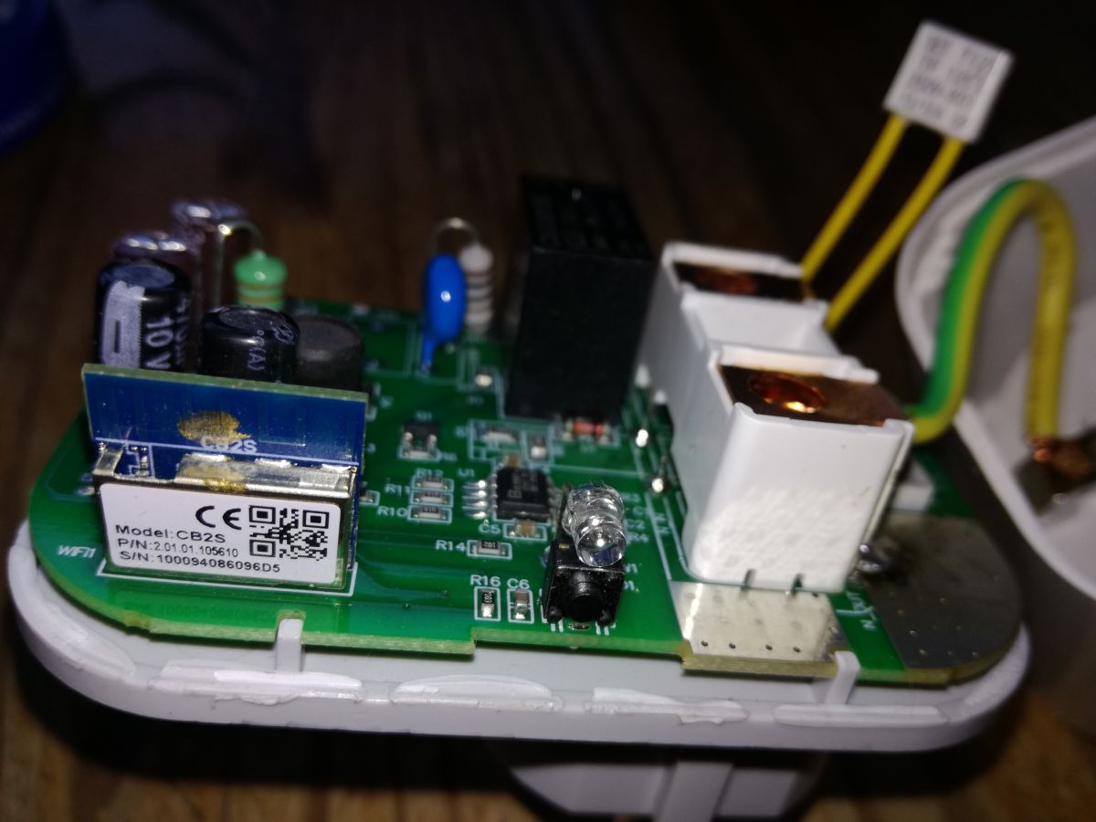

    After that, I was able to unsolder the CB2S Module and flash the BK7231N successfully using the BK7231 Easy UART Flasher.
    Unfortunately I have not taken any backup of the original firmware.
    Now it is time to configure the device and find the correct Pin settings.
    Using the "GPIO Finder" I found out that P10/RX triggers the LED on the switch.
    Low=LED is Off
    High=LED is On
    I identified P26 as the button.
    And P24 is switching the relay.

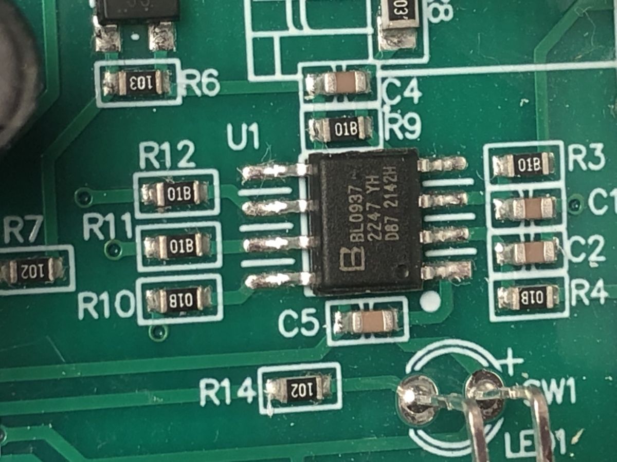

    How do I find out which ones are for the power metering?
    And do I need to add a certain command to load the driver for the BL0937?

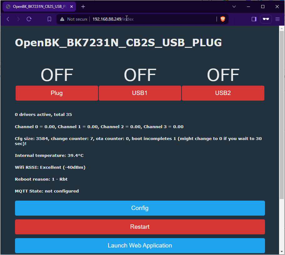

    if you took a backup Easy Flasher should be able to extract the pin assignments or if you didn't take a backup you can pull the Tuya config from OBK and run that through EF
    https://www.youtube.com/watch?v=WunlqIMAdgw
    Web interface of the OpenBK_BK7231N_CB2S_USB_PLUG device with Plug, USB1, and USB2 ports turned off.
    Added after 35 [seconds]:
    no. with BL0937 pins assigned the driver will start automatically on next reboot
