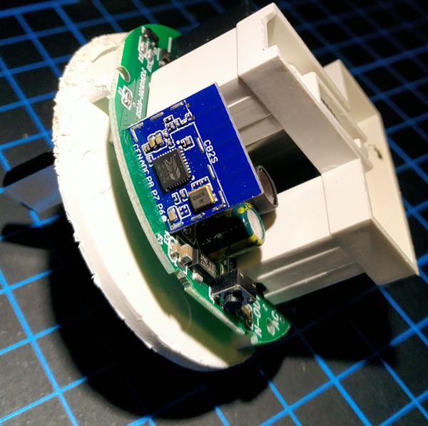

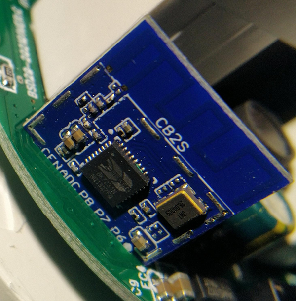

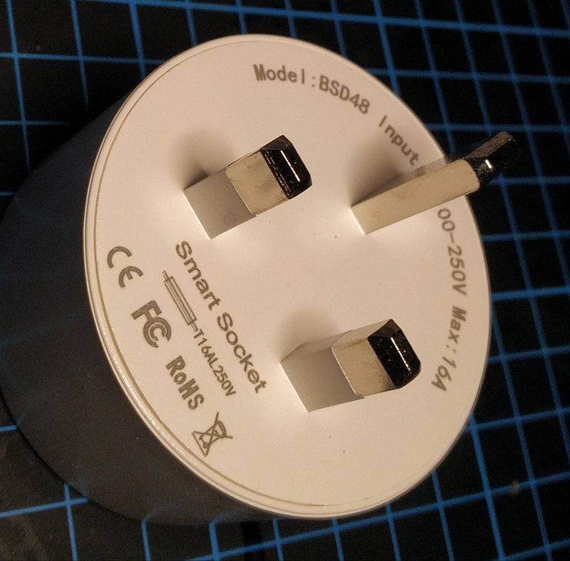

  • Tear down a BSD48 CB2S BK7231N UK smart plug with two button LEDs and a BL0937 energy monitoring chip.
  • Flashing required direct 3.3V/GND connection to the BL0937 chip, while TX/RX pads on the daughter board faced inward.
  • Soldering the inward-facing TX/RX wires was difficult, so a molten solder blob on the wire end was used for a quick attach.
  • The first opening was rough, and the re-closed plug looked horrible, though the CEN pad faced outward and caused no problem.
  • BSD48 CB2S BK7231N Sumart plug UK Tear Down

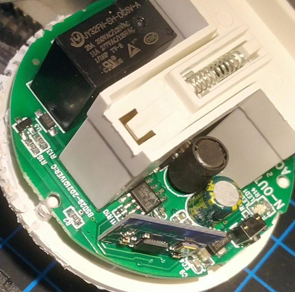

    Contains two LEDs at the button (RED/BLUE) and has BL0937 Energy Monitoring Chip

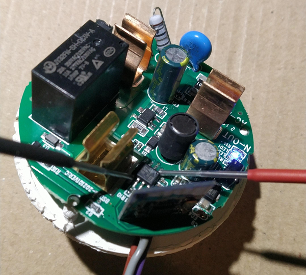

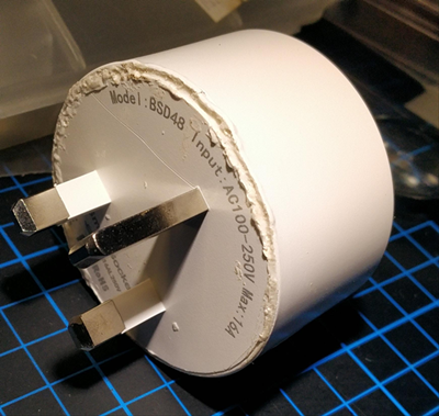

    My first attempt to open a such device was rough!

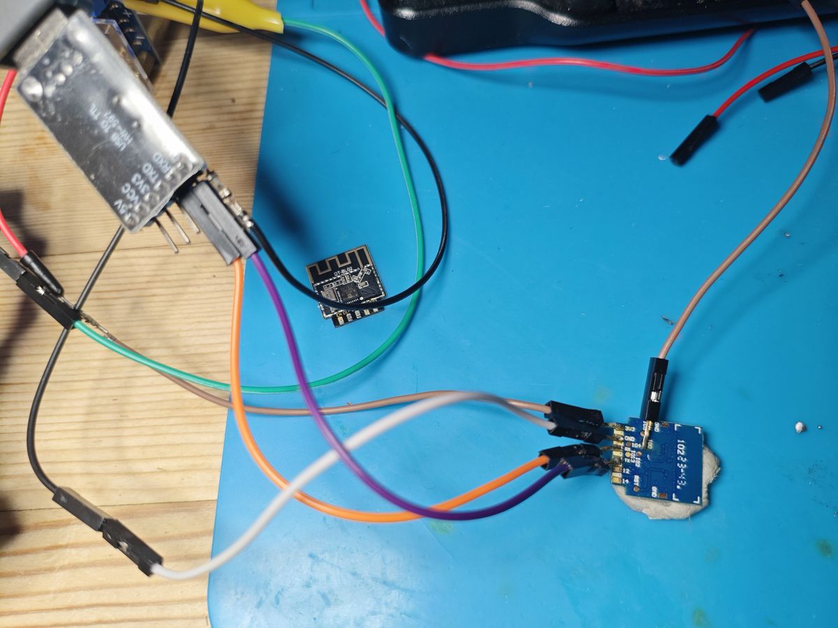

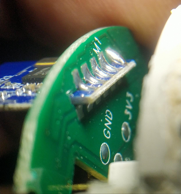

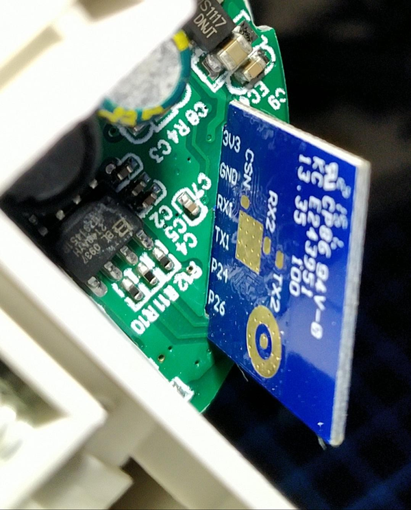

    Flashing Setup:
    1. 3.3V/GND direct to BL0937 chip

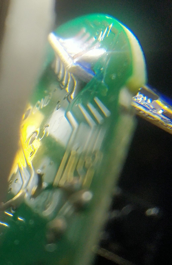

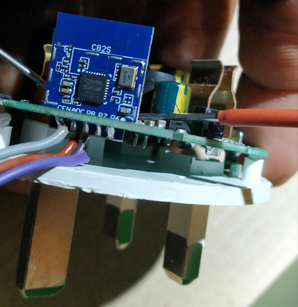

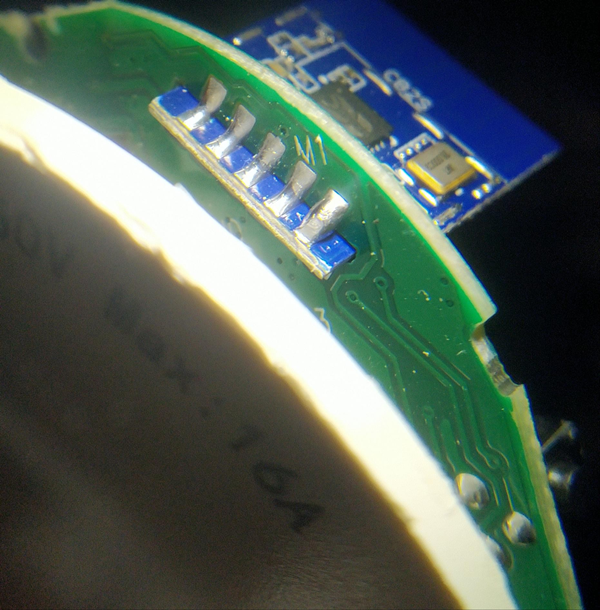

    2. Since the TX/RX connections were facing inwards on the daughter board, getting two wires soldered was tough! What I did was hold a molten solder blob at the end of the wire and quickly place it as there was hardly any space for a soldering iron to do soldering.
    This is how it looked through the small gap:
    CEN was facing outside so no problem there,

    Re-closed product looked horrible (not bad for my first attempt I suppose).

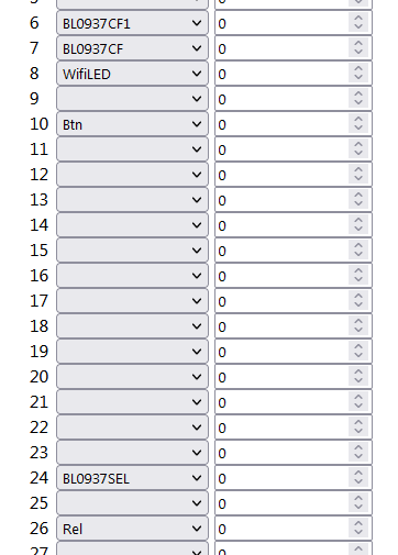

    Configuration:

    Remember to do a voltage/current/power calibration later. Just like in Tasmota, with "VoltageSet", "CurrentSet", "PowerSet" commands.
    Can you provide the IO configuration for relay, button and maybe WiFi LED?

    Hi, you could try applying some heat around the seal with a heat gun and gently lift it up with a thin knife.
    Might help with minimal damage teardown

    Thanks for the idea.
    Above was my first try :-)

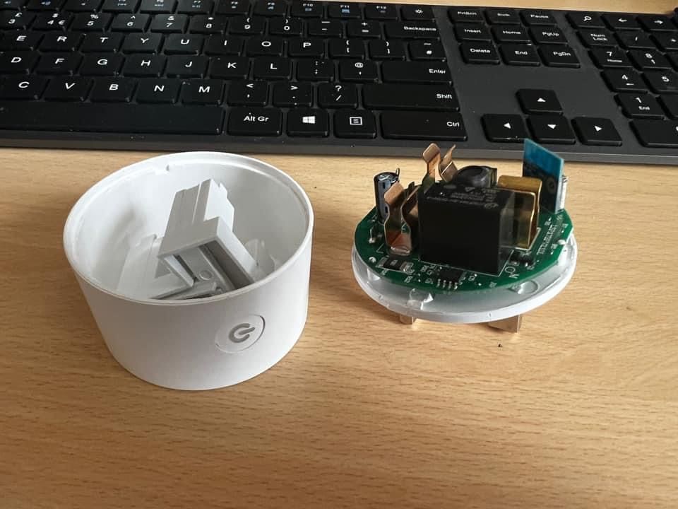

    For a different plug I also tried a C-Clamp to gently push and loosen around the edges similar to what others have done using bench vise. After some effort, the cap just popped out. Need to wrap the plug with a cloth to prevent scratch marks.

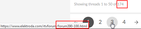

    I did not want to waste another topic for reporting this but there seems to be a navigation issue beyond Page 2 of posts listing.
    forum390-100.html gets redirected to forum390.html though there are 171 items in the list.

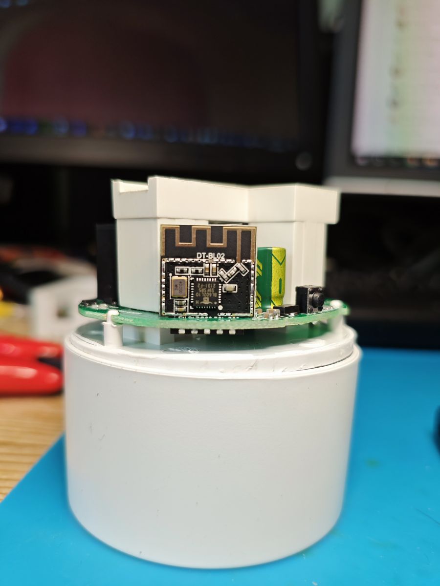

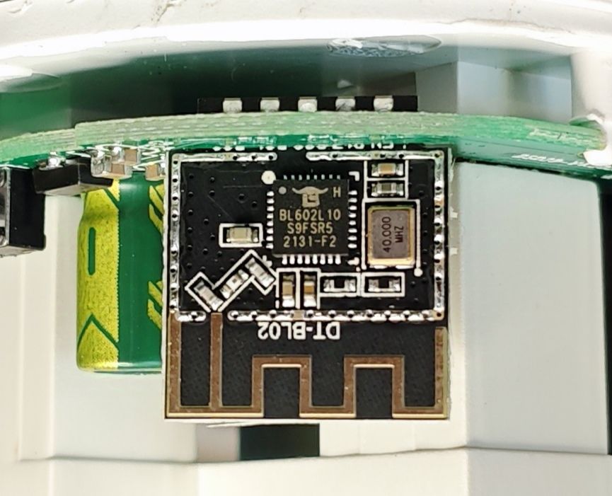

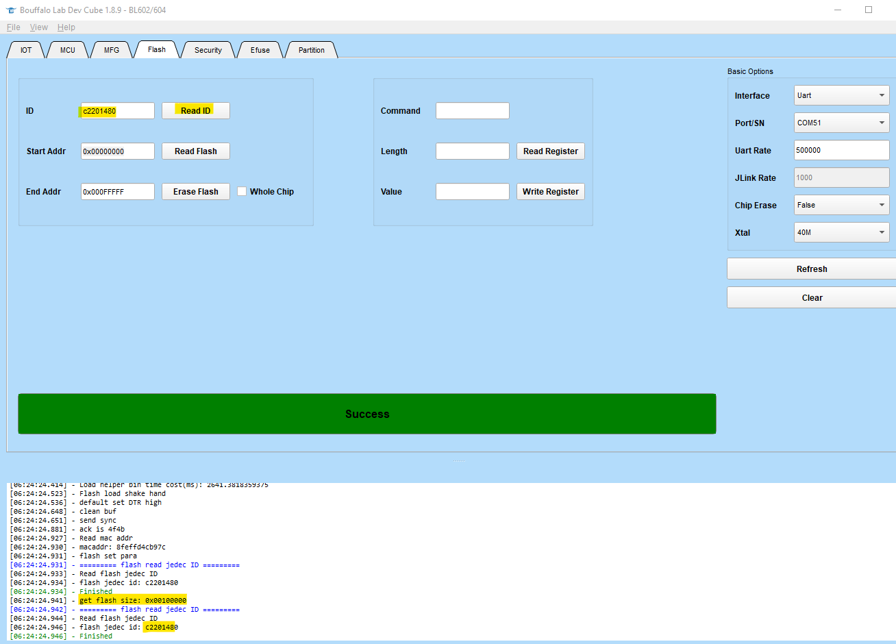

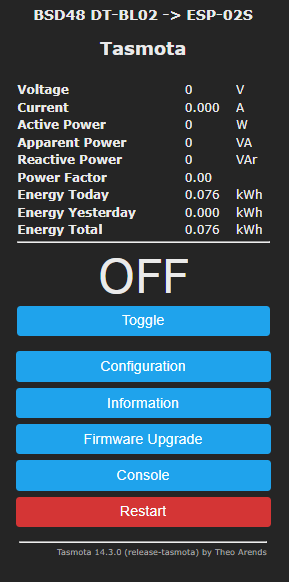

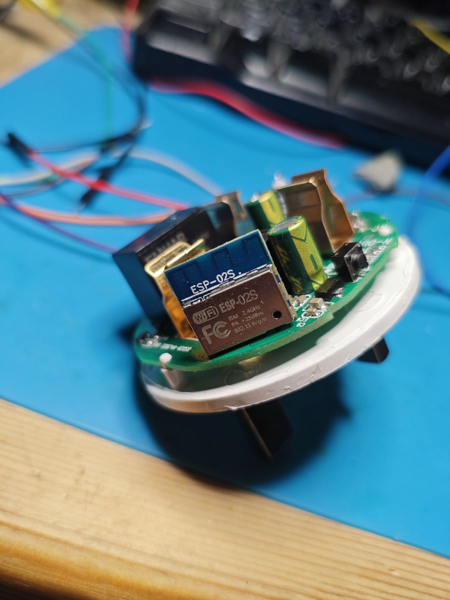

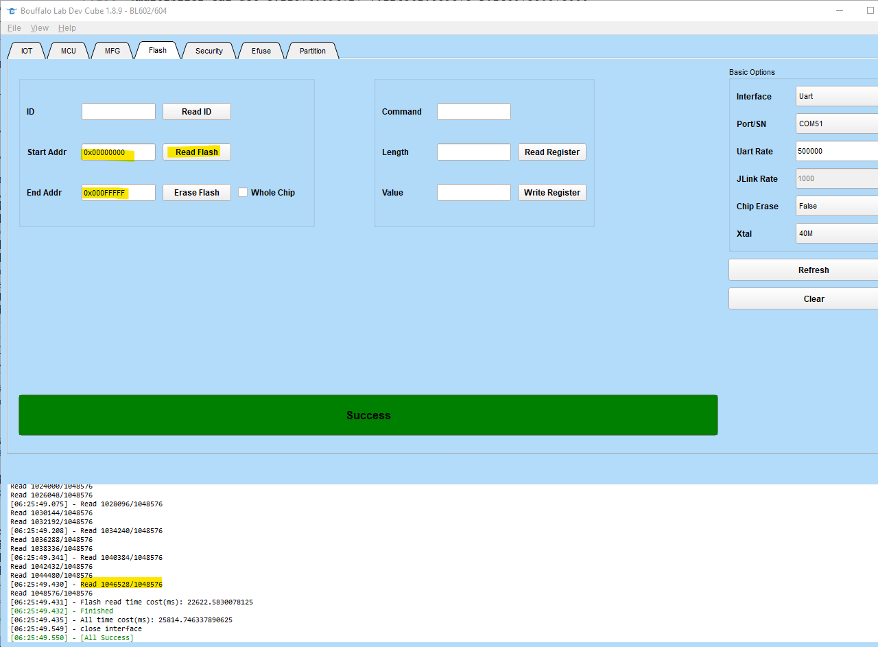

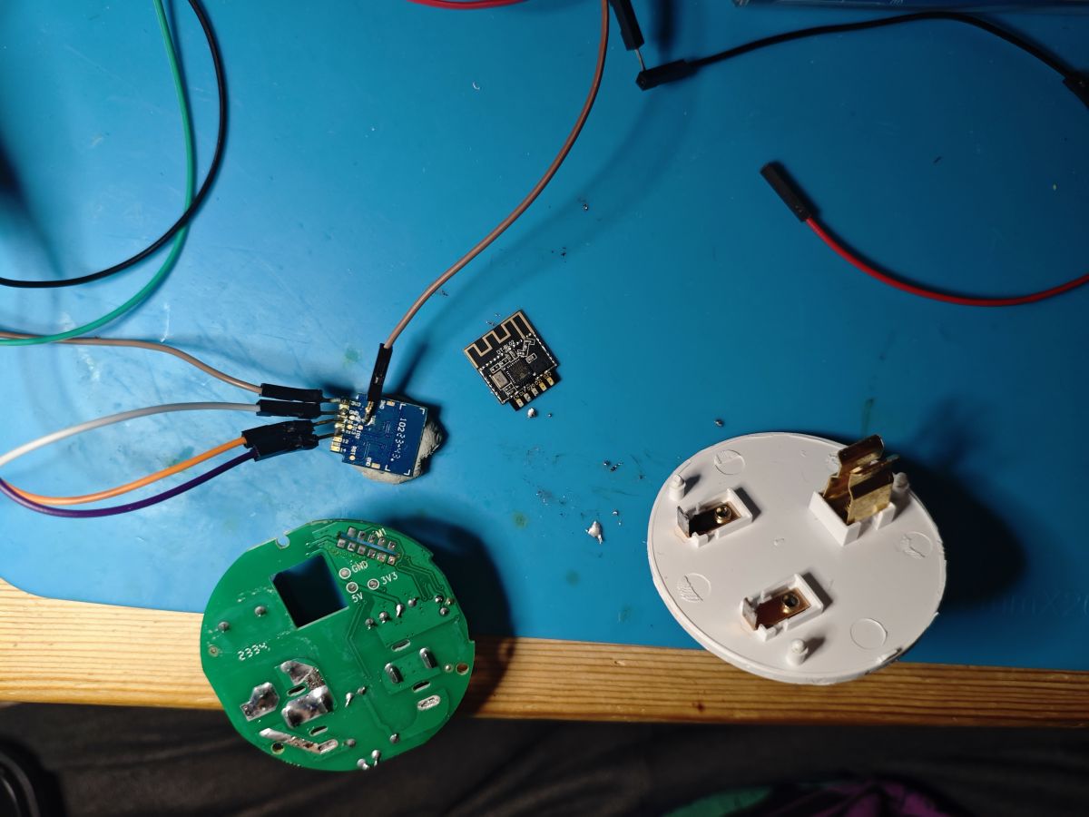

    If you're unfortunate enough to get a Cozylife BSD48 with a 1mb BL602L10 DT-BL02 module, you can easily transplant a Beken CB2S or a WB2S into it or any of these other modules https://templates.blakadder.com/ESP-02S.html. In my case I had an ESP-02S (ESP8266 2mb) module lying about spare so used that. OpenBeken does not (currently?) work on 1mb BL602s.
    Close-up of a DT-BL02 module with a BL602L10 chip mounted on a circuit board. DT-BL02 module mounted on a PCB, placed inside a white casing. Electronic circuits on a workbench with connecting cables. Wiring connections between various electronic modules on a blue surface.
    ESP-02S module mounted on a circuit board with several other components.
    Note the pin assignments do not match the template for this CB2S variant nor they do they match the BSD48 already on the Tasmota device list. The below works:
    Tasmota user interface for BSD48 DT-BL02 with ESP-02S.
    Added after 8 [hours] 31 [minutes]:
    A little more info about the original DT-BL02 module that shipped with device.
    TX boot log:
    Bouffalo Lab Dev Cube software interface with Success message
    unpaired factory firmware backup attached
    Screenshot of Bouffalo Lab Dev Cube software displaying flash read settings.
    another experience, but with 2mb DT-BL02 can be seen here: https://www.elektroda.com/rtvforum/topic4065570.html
